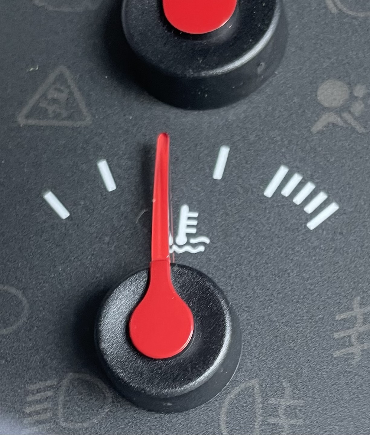

Is this a normal place for the temp gauge to sit? I feel like it’s higher than it should be but could be wrong!
Are 197’s prone to have noisy a/c pumps? As mine is super loud!
Martin_172
Yeah that's the normal location for the needle to sit.
