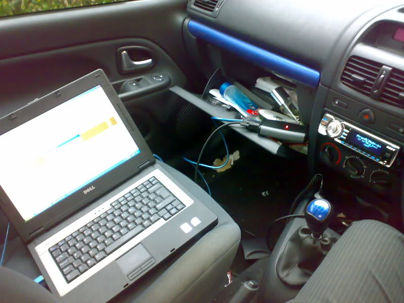

The setup

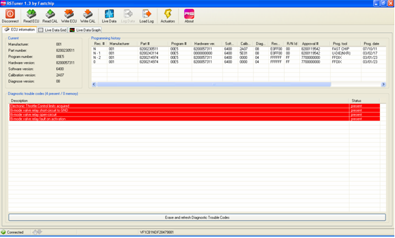

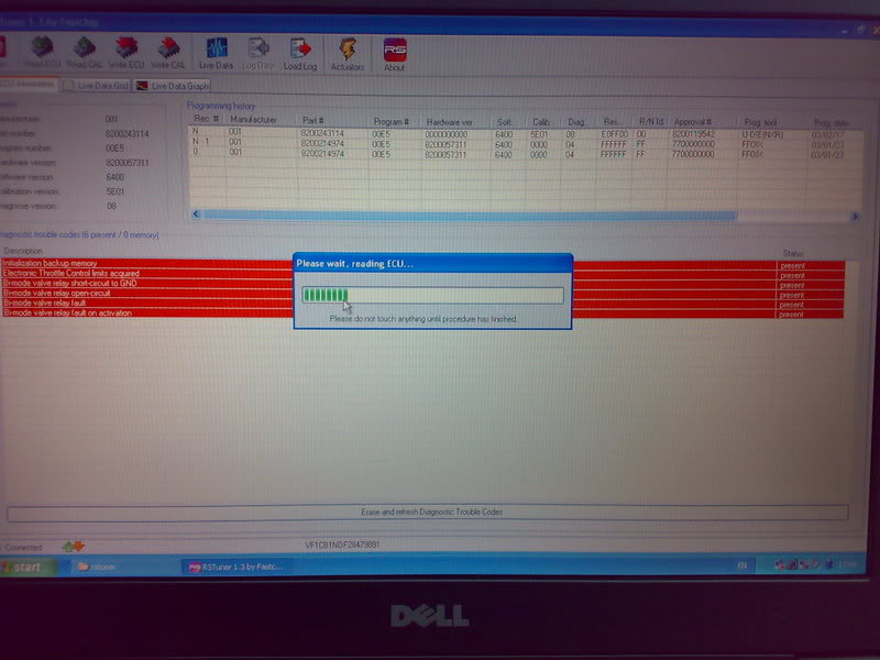

ECU backup

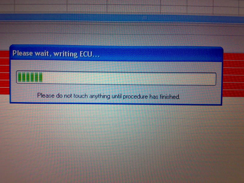

Writing the group n map

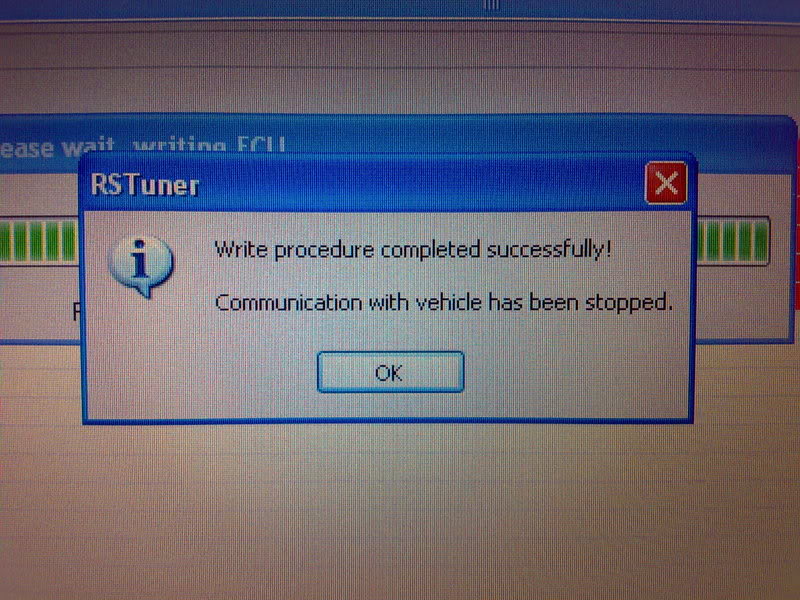

Successfully installed
New map at top of list
