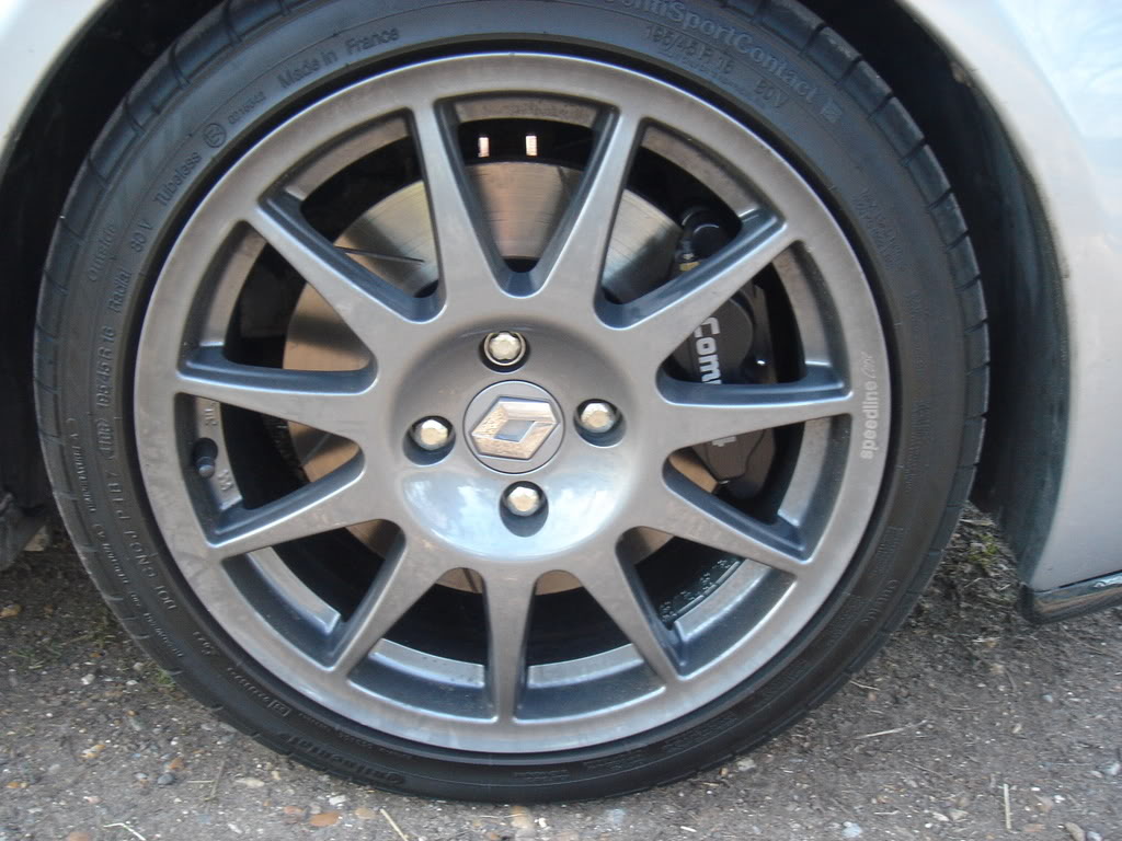

I just found this picture - noticed it when I was posting this!
Apologies to the person whose picture it is!
Thats an aftermarket speedline with renault cap?
Who says it's etched ? Could be and probably is just an aftermarket decal .
And perhaps thats not even a rim, but a huge plastic frizby which looks like a rim, that someone has photo shopped a tyre onto!

I'm not being cynical , i'm merely stating that it could be an aftermarket decal . There was someone on here a while back selling them .
Wow that looks great
I bought these anthracite speedline wheels from Renault...
