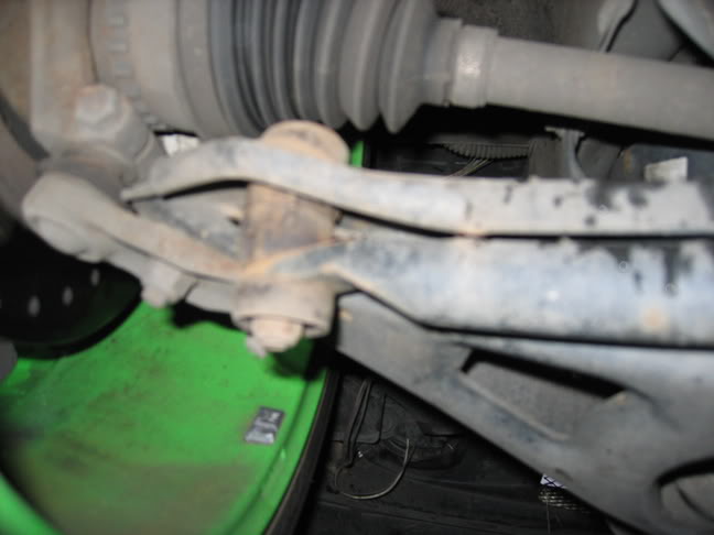

Jacked up back of my Mk2 Ph1 Clio (1.2 8v) cause i thought backbox was blowing. It wasn't. But when i glanced along the underneath of the car, i realised that the driver's side of the anti-roll bar was sticking down about 4 inches!
It makes a knocking noise from the front end also, but i assume this to be bush related, which will be sorted in next few weeks.

Somebody please be technicall and tell me exactly whats needed to refit/repair this. I'm assuming a nut and some new bushes/washers will do?

this bush you mean

I'm almost 100% certain thats the one, looks like a hole with a nut popping out of it.
Well on mine, it looks to have broken the 'spacer' between the lower arm and roll bar.

You can replace it pretty easily. Get a new one and get a 13mm nylock nut to go with it. Get it jacked up and on stands, get the wheel off, Pull the arm down, put the centre part in, let the arm go, put the top bush on, slide the bolt throught it, get the jack under the anti roll bar, jack it up - carefully, don't tip the car over lol. Get the bottom part on and start the nut, tighten up.
Some can be tight as hell, using grips if you can to try and squeeze the bush up whilst you attempt to start the nut. If you get stuck about how it goes refer to the other side.

Thanks mate, seems detailed enough. My Dad might drop it round his mates workshop tomoz in morning if he can do it, cause i have to be in college and he's gotta work. If not, i'll more than likely do it tomoz after college...

The bush is quite difficult to mount. At least the lowest part of the bush. You have to press the nut real hard to screw it back unto the bolt. The lowest part of the bush have to be pressed together lik fuc*. It can be a pain in the ***. It was to me.

Just to update, my car was sorted with both sides being replaced, and just found out the driver's side nut has snapped again!!
Am i right in thinking something isn't quite right?? Seems to dodgy to be broken so soon after replacing, and being same side as last time...
