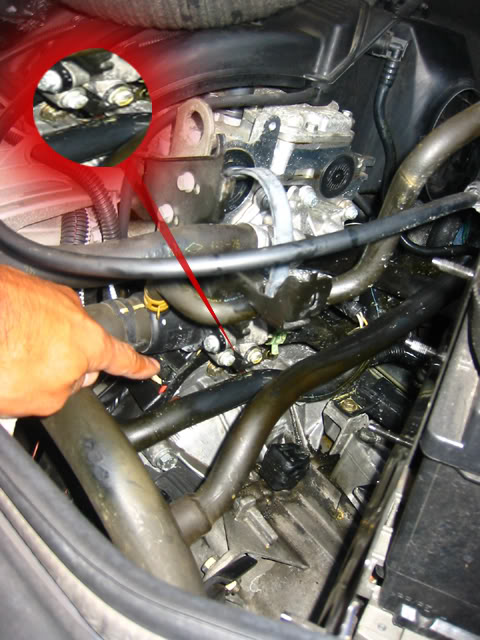

post a pic of your engine bay and i will point it out
If its taking 10 trys to start it theres a chance It'll show on CLIP lol

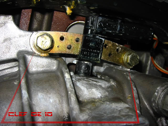

This is where its located - same place on all Clios
TDC sensor
Not my pics
