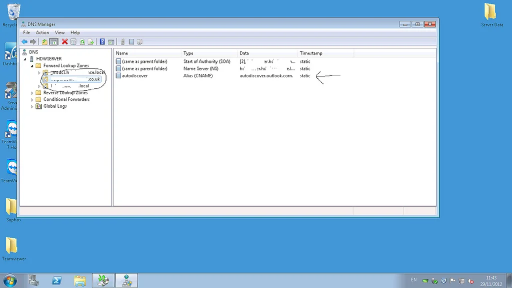

Cheers guys, If I were to run the following command echo %logonserver% from cmd. Find the server it is reporting back on and create a CName alias for autodiscover.outlook.com within DNS onthat server. Will that make sense?

Cheers guys, Thanks for all your help. I had sorted it with putting in a CName record on our internall DNS servers as per Longy suggestion. However, each and everyone of your contributed to helping me resolve it as each of you filled in a blank which I was missing. Really greatful guys. thanks again.
