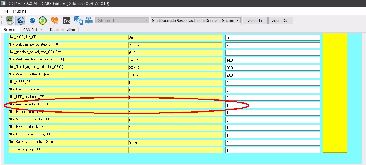

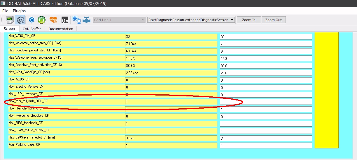

Hey.
Hope you can help. how do you enable Rear Tail lights lit with DRL lights on.
Hi, I dont know what version of emm edison lighting ECU you have but mine is EMM EDISON DDT2000 SW15_2 v1.0 (i wouldnt change anything under SW13 as I think some people say it breaks the lights and the ECU has to be re-programmed by renault)
here is the setting you need Nbx_rear_tail_with_DRL_CF - enable that with a '1'

  Clio 4 sport tour
