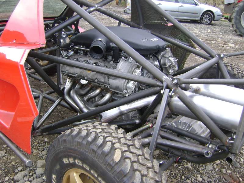

That's the 5.0L V10 out of one the old M5's,

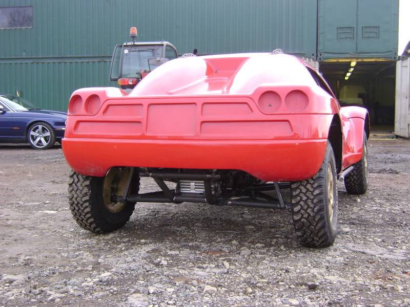

There you go, that's that one looking a bit more like:

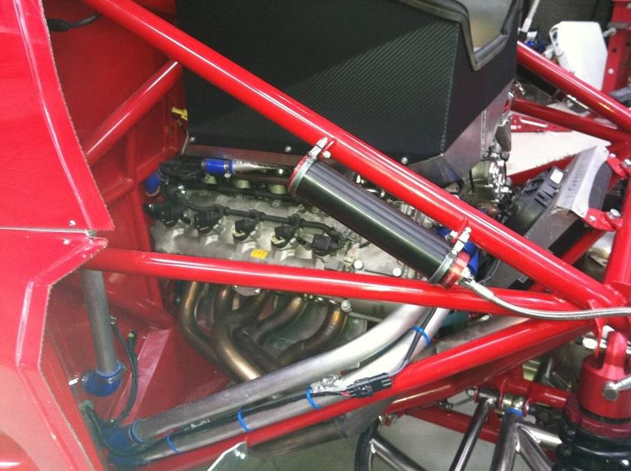

's one of the V6 ones on the newer shell (never liked this shell tbfh, this car now has a Mini shell sat over it instead)

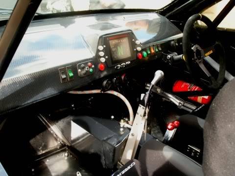

Inside:
A v6 car naked:

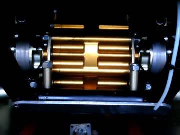

Then all the racks, diffs, etc, we machined ourselves:
