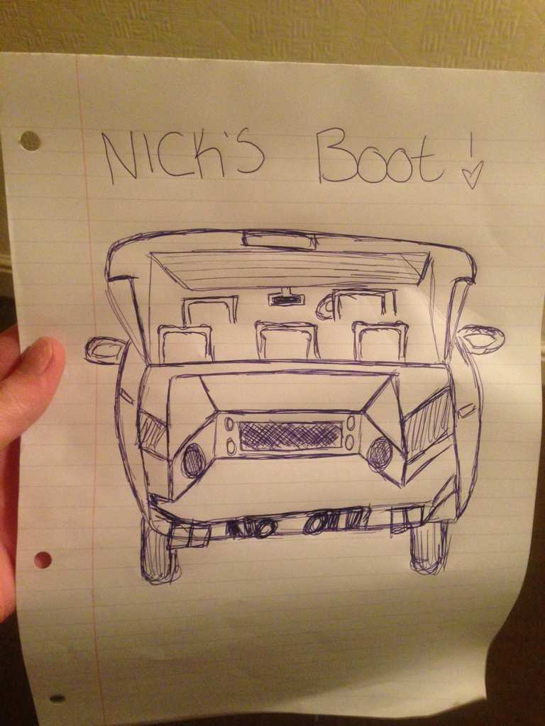

Ps just to help out a bit... My idea of the boot build very roughly drawn by the misses

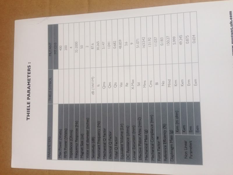

your best bet would be to use some speaker cab designer software (like winISD), input the parameters of the sub and play around with the sizes. You will know why you have got it right as the audio curve will be as flat as possible for as much of the low end frequency range as possible.

The spec sheet of each sub.

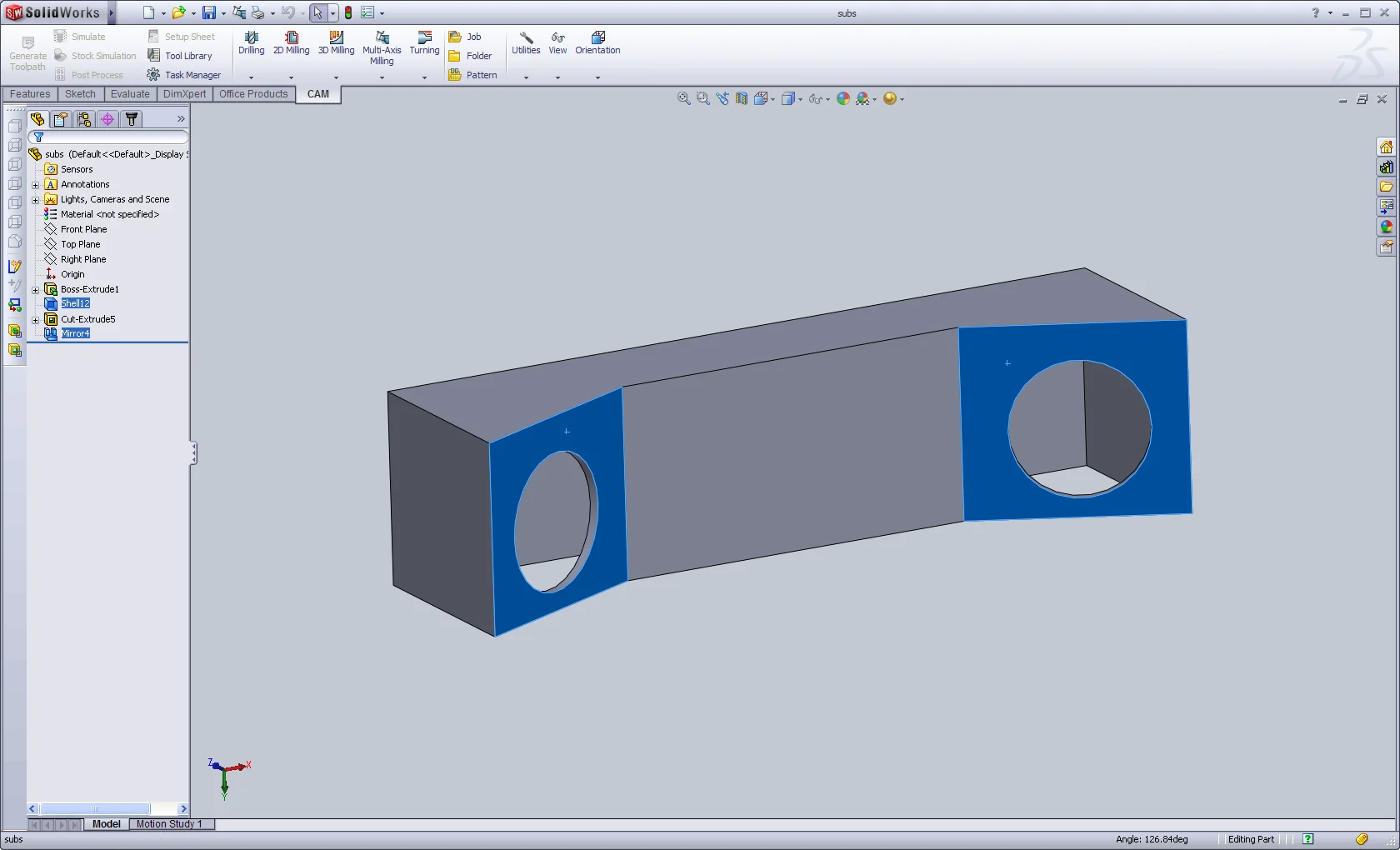

design looks good. You going to put a seperator in to keep the subs seperate?

Would you recommend a separator in between? Or just an open cavity? I'm going on a whim here haha budget I would go between £100-£120 (although the misses will kill me, ill deal with that at a later date).

I would probably keep the subs in seperate compartments. You dont want the box too big, else you will get a spike at a certain frequency (which dosnt sound good as that frequency overpowers everything else).
Sounds good just shown the misses, she said at first what the f*ck is that.... Then said i'll get it you for Christmas :) that's that sorted haha! I think i'll build in some separators then as you and Rob advise. Should make for a better sound.
I'd have two separators, that'd allow you to have the internal dimensions of each box exactly as you want.

I will have to measure my boot and get a good idea for how big I should build the box surround. then I can properly make a 3D model on the computer and get a good idea for sizes. That model above is actually in MM :p the wall thickness is 0.5mm haha I was doing it very quick ;). If I get some measurements of the boot and tell you guys how much I am willing to sacrifice think you could advise on the size of the box? Or just make it up the the size of the space I can sacrifice? (although probably not advised as I probably wouldn't leave enough room for the subs to do their things).
I am also thinking if I put 2 separators in the center bit one at each size maybe insetting the sub into it's own compartment with perspex over the front and a blue LED. How would be best going about cooling? A computer fan maybe?

you realise this is goingt o be heavy as f**k? What ar eyou ogin to make it out of? I've got in the habbit of making my boxes as small and as light as possible these days.

Birch Plywood is my no1 choice as its the best for weight and is also very strong. Only thing is its pretty expensive and splinters when cutting. 10mm is not thick enougth for the baffle, you want 18mm+ really. depending on how you build the box, you may also want to use 18mm on the rest as well (unless your build an internal frame, in which case 10mm would be ok for the rest).
I was thinking of keeping costs down and building it straight from sheets with no frame. So you would use 18+mm Ply for the whole box? By baffles do you mean those separators I am going to put in the center?

no I mean the bit the speaker is mounted to, this is known as the baffle. I woul be using 15 to 18mm for the rest fo th ebox in that case.

yeah. you will have to build a frame section for the inner side of each of the baffles. the baffle has to be the strongest part of the box.
