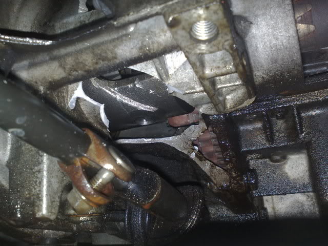

Ah then my box might be of no use to him as bits of my diff exited through the diff casing lol
