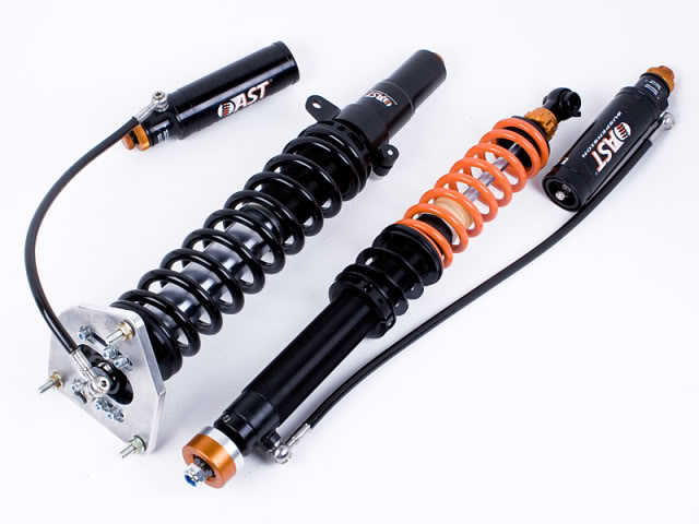

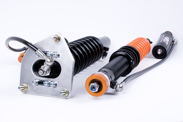

these are the ast coilovers. these are the 3 way, but the fitment and features (except remote res) are the same on the one way kit.
compared to the H&R which seems to keep normal spring? not sure how the rear is adjustable with this setup?

On the rear of the "normal" kits a threaded fitting bolts onto the rear lower spring pan on the torsion beam and allows you to adjust the ride height.
The AST setup is far superior on that department, much more resolution on the ride height adjustment(leverage ratio is virtually 1:1 on AST, looks more like 5:1 as std) for corner weighing, as well as more accurate spring control i'd have thought.
  200 cup & 106 GTi
yep! the spring control should be better on the ASTs also because as standard the rubber bush on the bottom of the damper is isolating the damper from the beam, whereas on the AST the spring is over the damper with what looks like a much more solid bush/joint at the bottom and a solid top mount. Plus they are inverted also!
