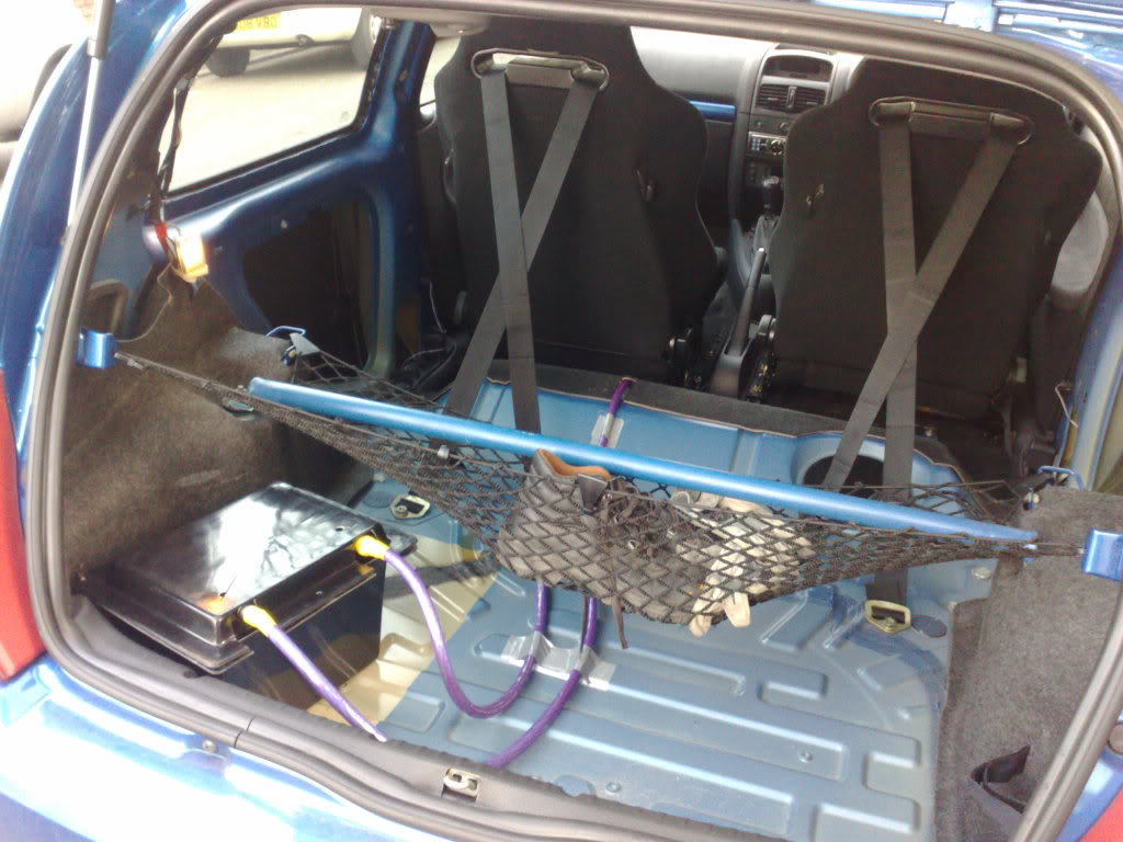

Anyone had a go at doing a DIY strutbrace?
Car  172 SPORT PH2
Seen it on the guides... does anyone know how to do one ? (REAR STRUTBRACE)
Width x Height x Wall thickness X Length ?
If anyone has done one, please show me the way.. i found some steel on ebay ... but theres lots of Different W X H X W X L ....
Not sure which i need ? any one pm me the details or post them here, if you have done it..
Bdw on a clio 172 ph2

Lol like you need years of experience to get a rod, cut it to size and weld some round things on the end. I bought mine and couldn't believe how simple it was. I could teach my dog how to make one. I shall get some measurement tomorrow for you pal.
I have some pics in my project thread if you do a search.
I built one out of Steel Uni-strut..... did f**k all... save the money/time for some thing else
made my own fo free, just measure from the centre of the bolts and make to fit, easy

Stava that would be great mate if you can get me some measurments cheers

iam a steel fabricator and could knock these up in my sleep,was thinking about making some but would need sizes or the braces to replicate
I used 2 x bits of angle iron for the ends to bring the tube up, otherwise it wont get past the bodywork

the overall distance is 108 cm between strut top bolt holes.
made mine with some tubing and some 40mm box.
i reckkon im gonna make a bolt in one that goes onto the towers themselves next and see which is better the top mount or side mount version,
