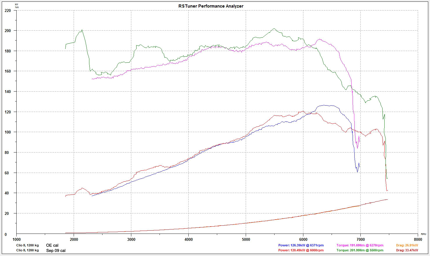

Anyway here's some PA graphs, I don't personally put a great deal of faith in them.
so going by the graphs you've lost a cpl of bhp over OE and gained a bit of torque and a smoother power curve ?
And if you read what I said I can't have an expectation as there is no change log, an issue I've flagged with you before; so I've no idea what improvements have been made. But in my own experience I can tell no difference from a performance point of view between this cal and the Feb 08. But you'll also notice that I have said, just this morning, that cold start and idle appears to be improved.There is a big improvement with my cals, not only power wise but also warmup, idle, throttle response. Not all can be seen on a Dyno plot.
Off course it isn't a Turbo engine so be happy with a little extra.
FYI, it works better than most Dyno benches when used under the right circumstances. This has been verified by myself and several other users.
I also compared an OE cal on the OE .rst (for want of a better description) to the Sept 09 cal and group N .rst...like I said lol.He compared a performance cal to another performance cal. Also 1 of the graphs is not accurate as it is way to 'bumpy'.
Sometimes you need a few iterations to get it right.
Errrm thought the group n was the .rst file and the RON98 the .cal? So the group n .rst rewrote the basic information on the ECU (including upping the rev limit) and the .cal reworked the fueling?
