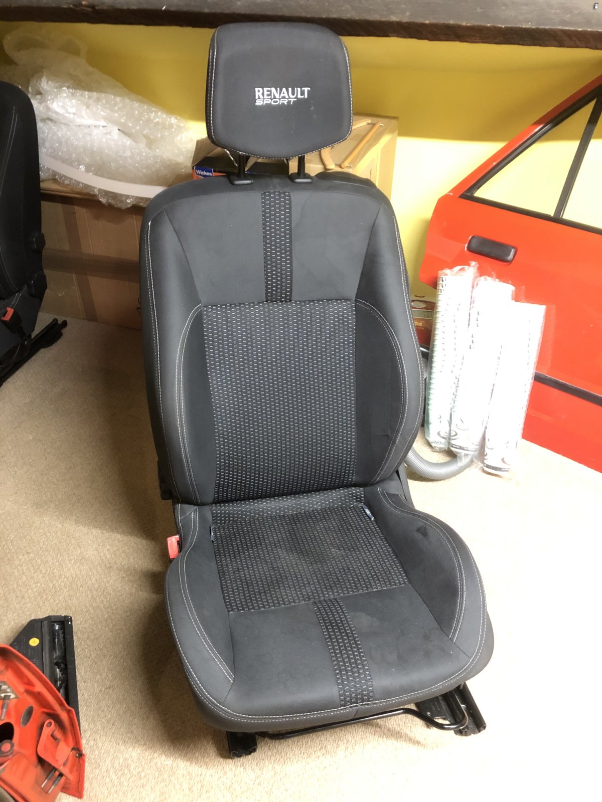

So, what are the plans for Kermit? Well, I bought a pair of Clio 197 seats for it today for £55. As my darling Wife is an industrial Seamstress by trade, she's going to re-stuff and re-upolster the seats for me over the next few weeks. I've no idea yet if seats from a Clio Mk3 will fit what is essentially a Clio Mk2 floorpan, but we'll cross that bridge when we come to it. After she's done the front seats I'll buy a few Kangoo door cards for her to work her creative magic on, and she's already started sketching up ideas of how to tidy up the dash, (she's a whizz with a soldering iron and pretty handy with a MIG welder)

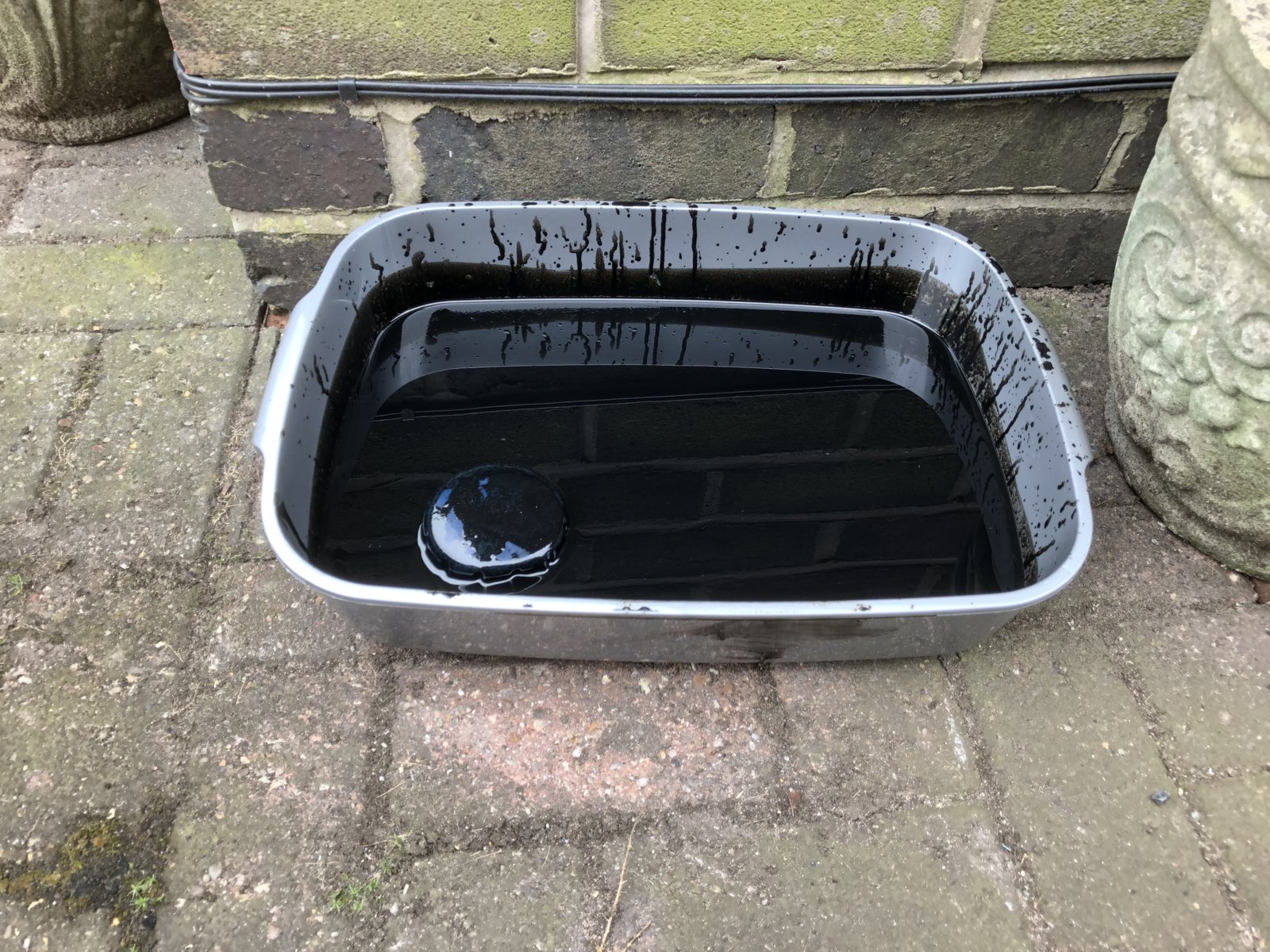

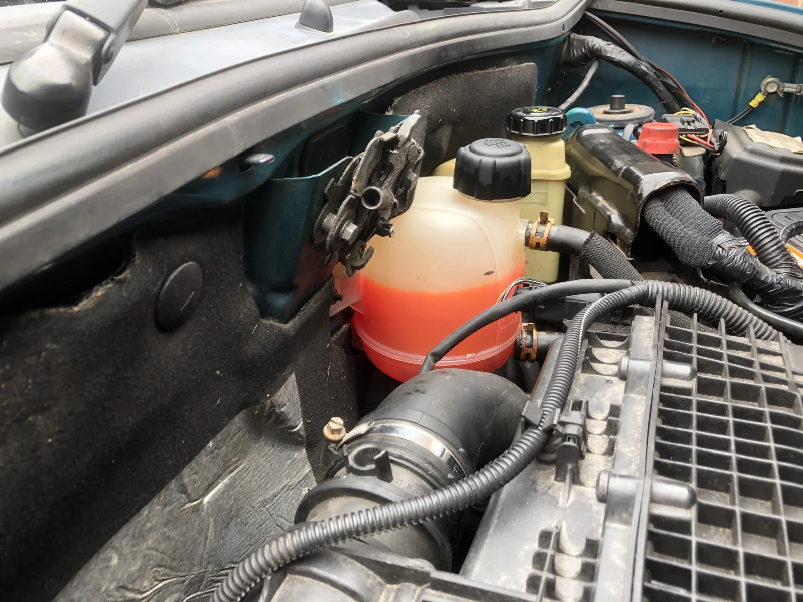

The coolant was like bog water. Brown and stinky is not how coolant should be. I expected it to only take a couple of hours to drain and flush the system. What I hadn't counted on was those bloody awful Clic-R hose clamps, the lack of room to get to them, or the fact that the bottom hose hose clamp had been fitted in such a way that the hump on the clamp that needs cutting through would be facing the front of the vehicle, making it pretty much inaccessible. There was much cursing directed at the Frenchman who fitted that at the factory. After two hours, two long, frustrating and fiddly hours, I finally managed to get the bloody bottom hose off so I could drain the system and flush the radiator.

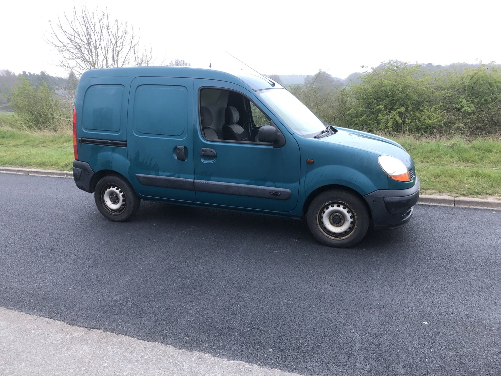

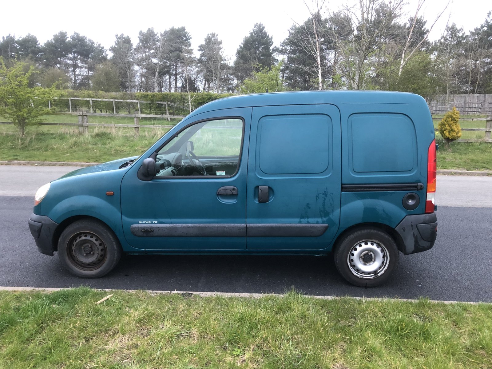

As promised, photos of Kermit.

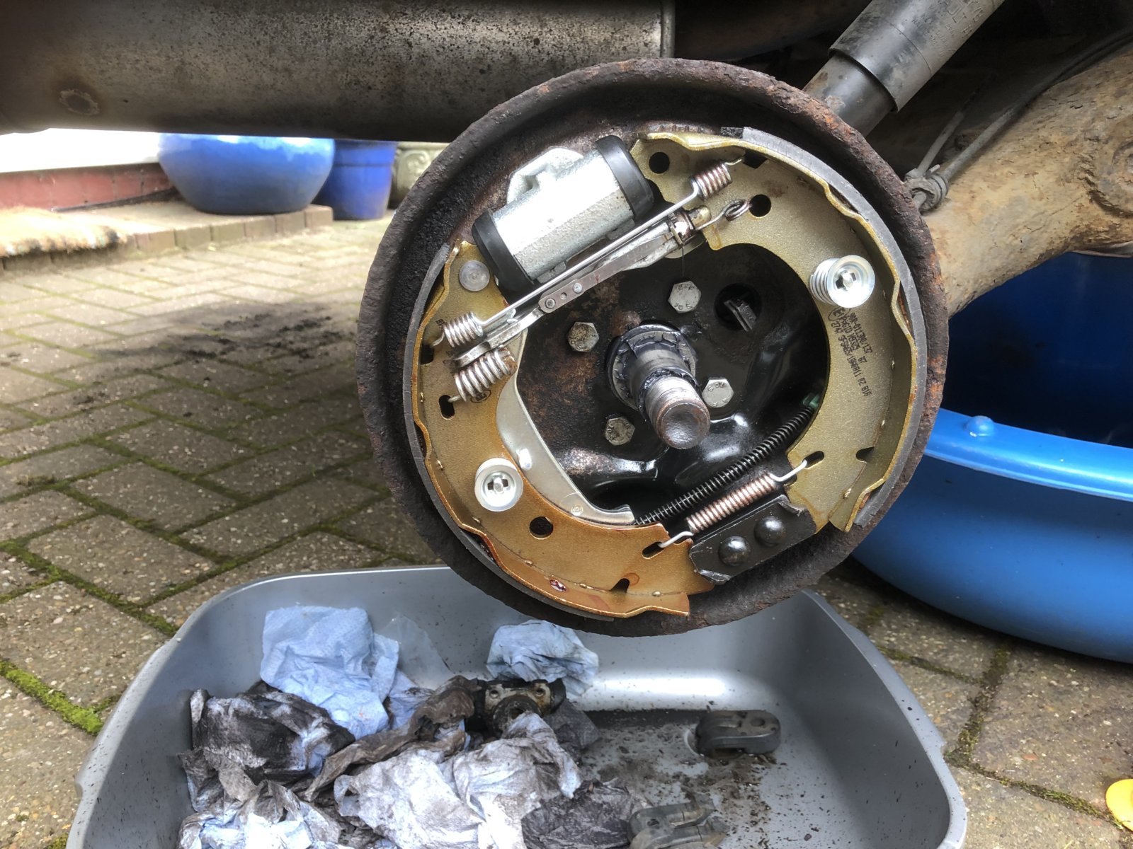

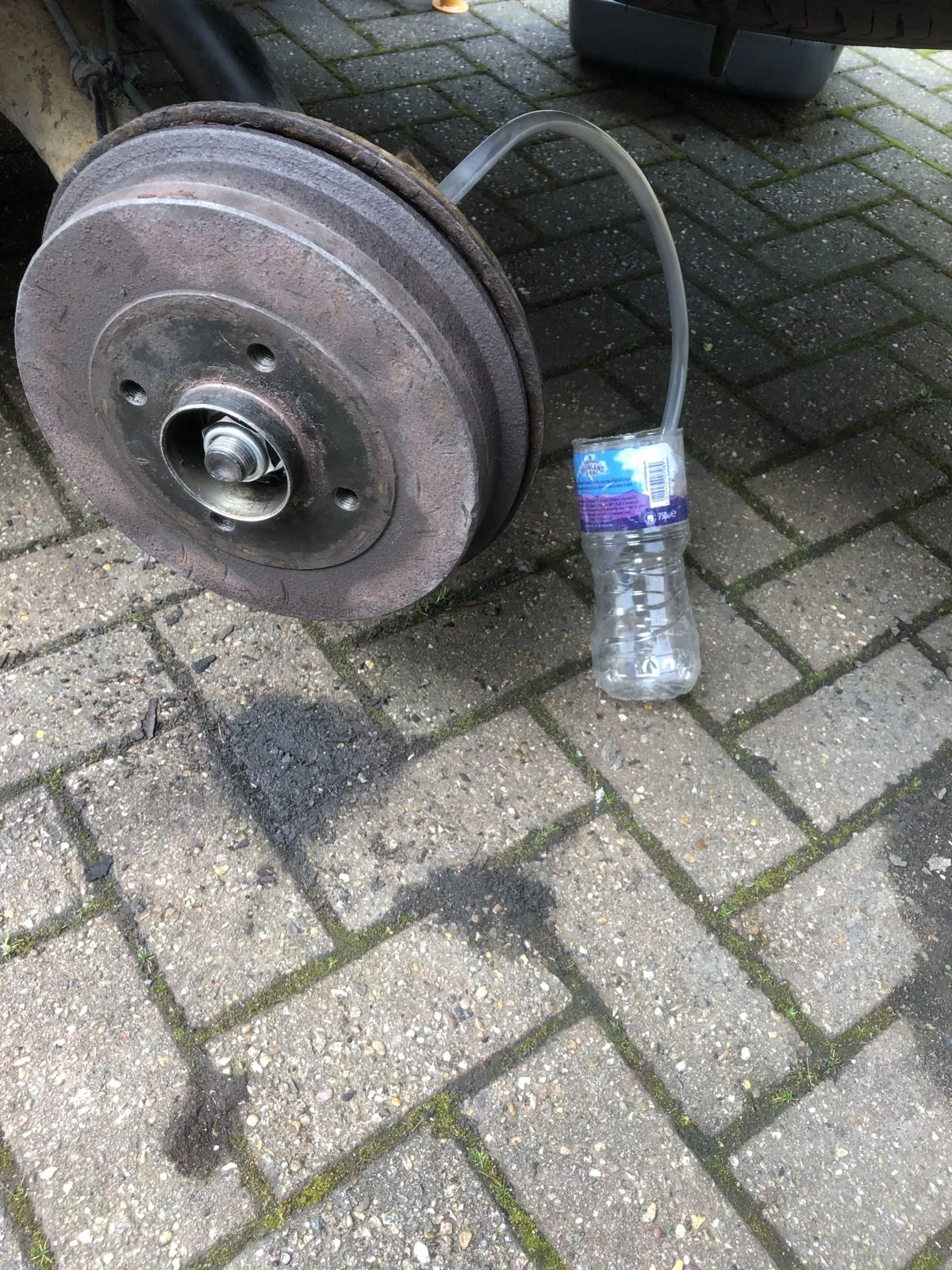

New brake shoes, wheel cylinders and wheel bearings. I hate changing brake shoes. I hate it even more when a well known motor factors supply me with the incorrect wheel cylinders and incorrect wheel bearings.

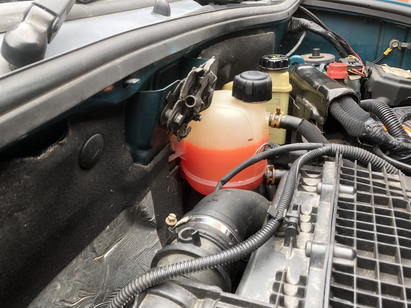

Coolant drained, rad flushed and reverse flushed, block flushed through the expansion tank and thermostat. New thermostat fitted.
According to the Haynes Book of Lies, there is supposed to be a drain plug on the block to unscrew in order to drain the block of coolant, (or in my case, brown stinky bog water). Can you guess who spent two hours looking frantically for this mythical engine block drain plug ?
I hate Haynes Manuals.
Brake fluid changed and brakes bled. I’ve no idea how much brake fluid these things hold, so I just flushed through a full litre. A neighbor called round to see why I kept shouting “Up” and “Down” to my Wife.

So, how long do you think it takes to remove a seized on hub nut and brake drum from a Renault Kangoo that’s been sat in the mud with no wheels on for the past four years ? The answer is about 3 1/2 hours and quite a lot of swearing.

Anyway, pics of the (partially) finished article......

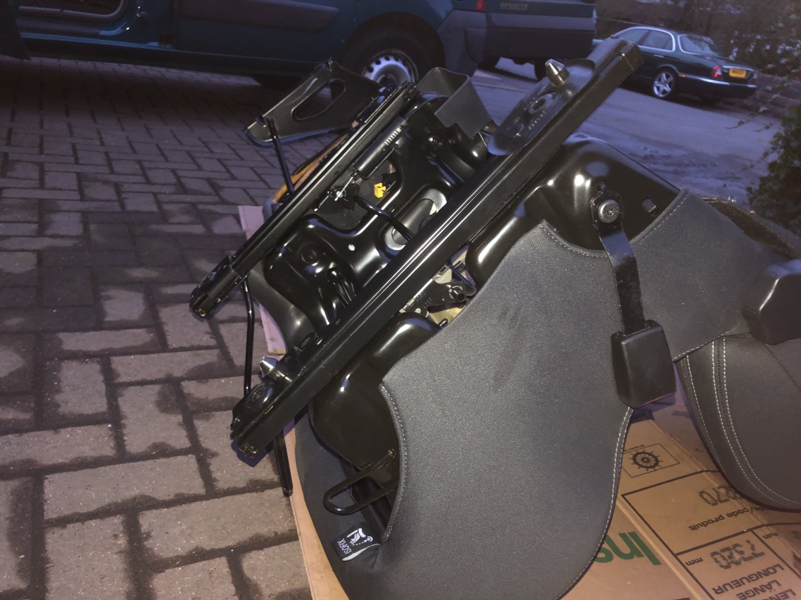

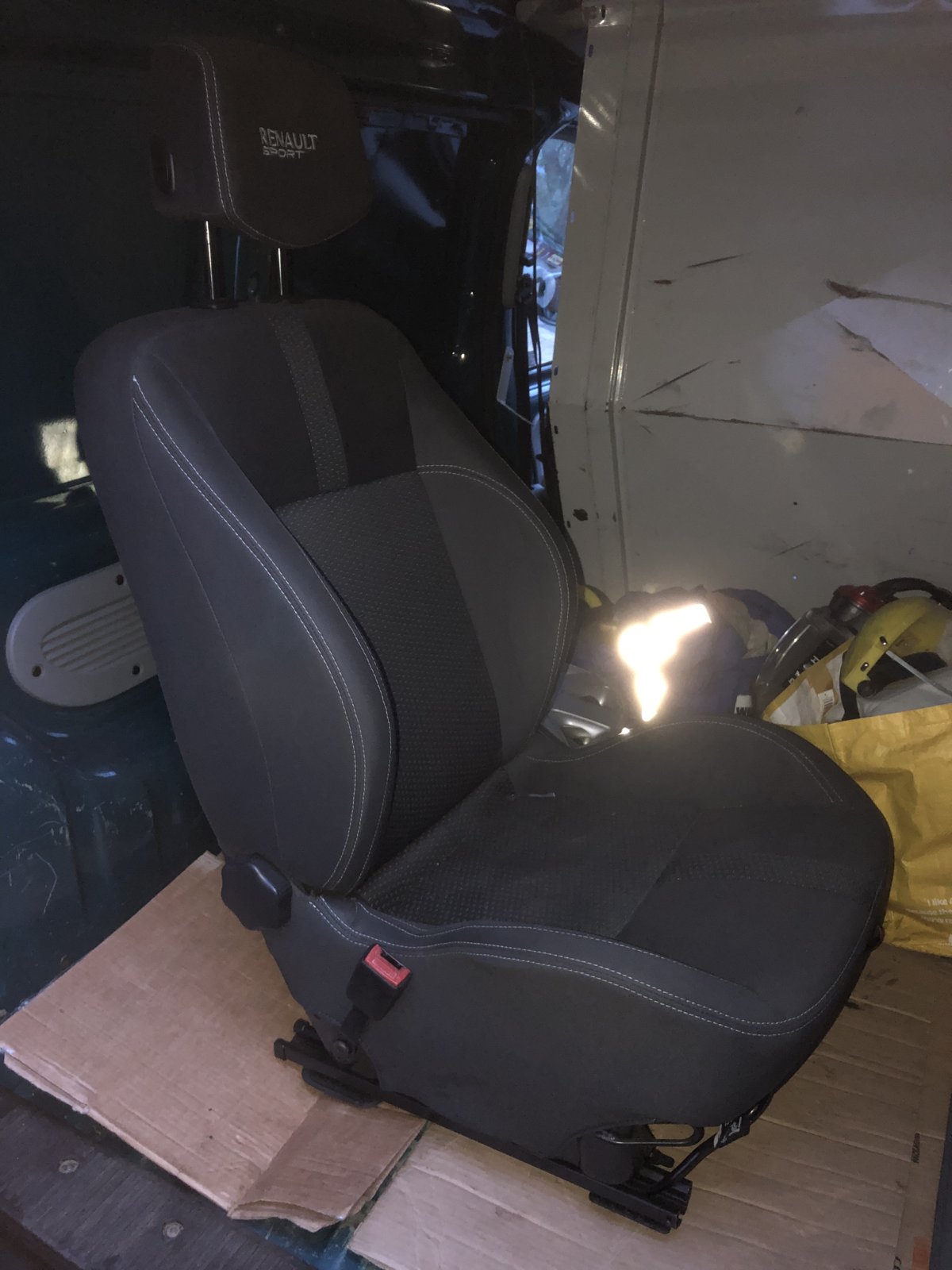

Sorry for the poor quality photo, but I had to go down to the Unit to get the seat out of my Office and it was dark by the time I got back home.
Tomorrow I’ll see if I can get the Kangoo seat subframe to fit the Clio 197 seat. If not, the Wife has said she’ll have a go at knocking a subframe up at her work. Fingers crossed for tomorrow I guess ?

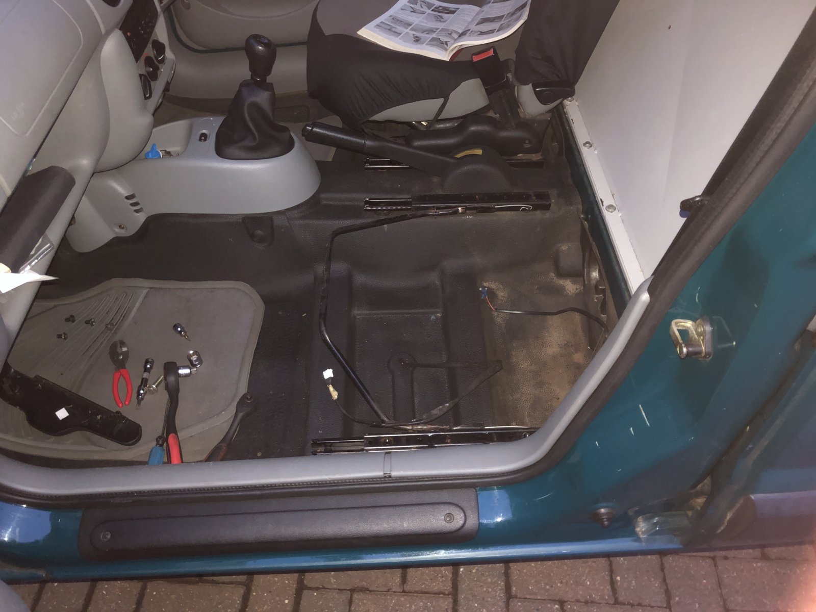

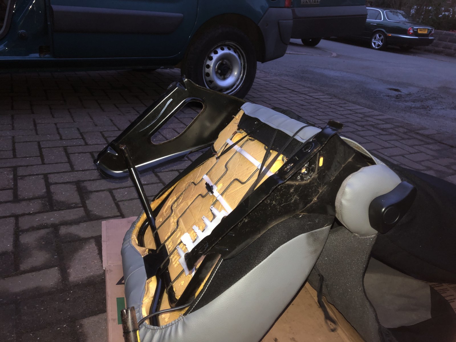

I had a quick trail fit of the 197 seats in the Kangoo today.
The simple answer is they don’t fit. But......

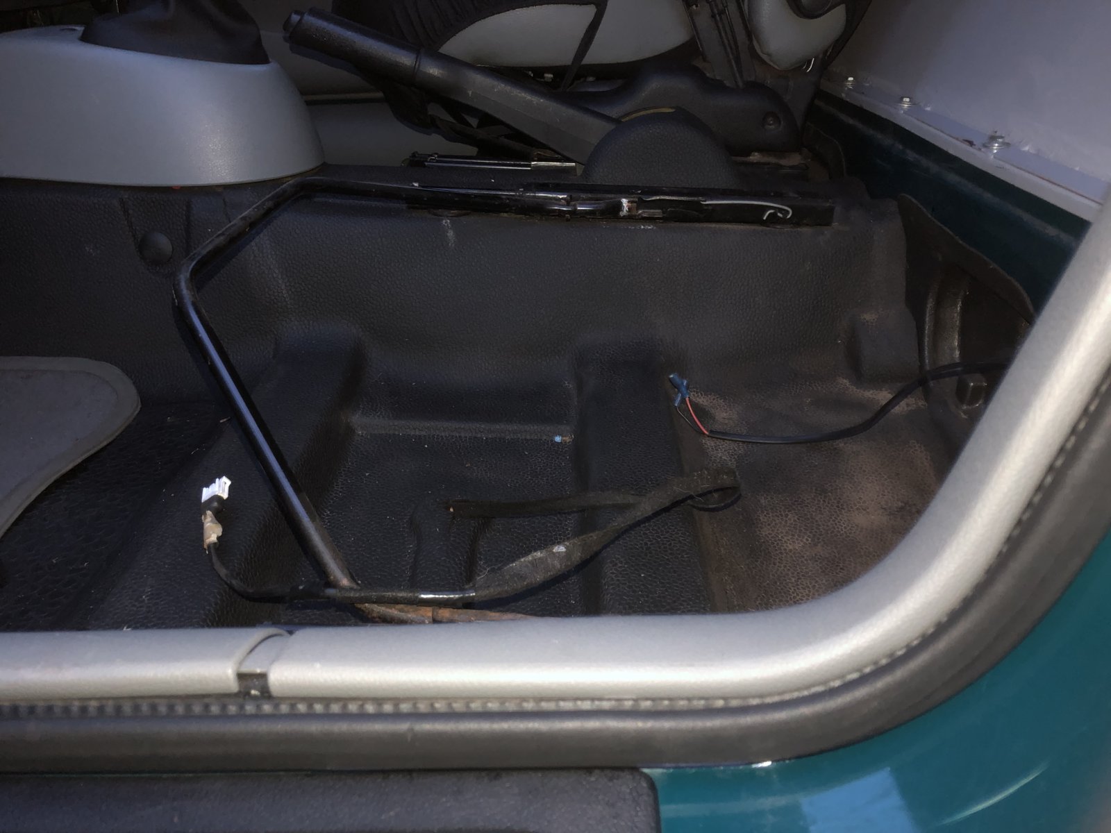

If you look at the floorpan of the Kangoo there is a great big propshaft tunnel in the way.
This means that the seat subframe of the Kangoo is significantly staggered, whilst the Clio seat subframe is staggered only very slightly. This makes swapping subframes from one seat to another somewhere between very difficult and impossible.
However, whilst I went to make a cup of tea, the Wife went into full-on work mode, and in a flurry of tape measure whirling, figured out that the Clio seat will fit, (just), between the sill and the propshaft tunnel. Some extra holes will have to be drilled into the floorpan, then support / bracing welded over the holes before using some very big bolts to hold the seat in place. The only real difference is that the Clio seats will sit about 20mm lower, and I’m not yet sure how compatible the seatbelt pre-tensioners will be.
We’ll have a crack at fitting them this weekend if it’s not raining. Now, I haven’t seen the weather forecast, but I reckon I know what the weather will be like.

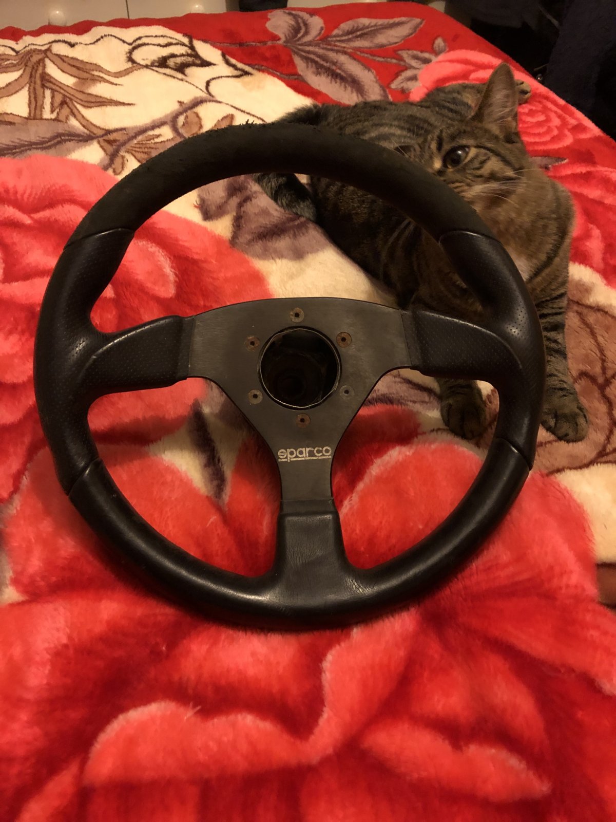

The steering wheel got delivered on Saturday, £14 inc delivery, (neither cat or awfull blanket were included).
I’ve no idea what boss is attached to it. Neither did the guy selling it.
I know it needs a bit of tidying up. I’ve found replacement centre bolts for it on eBay for a couple of pounds, and the Wife has offered to re-trim it for me, (she’s trying to build up her portfolio).

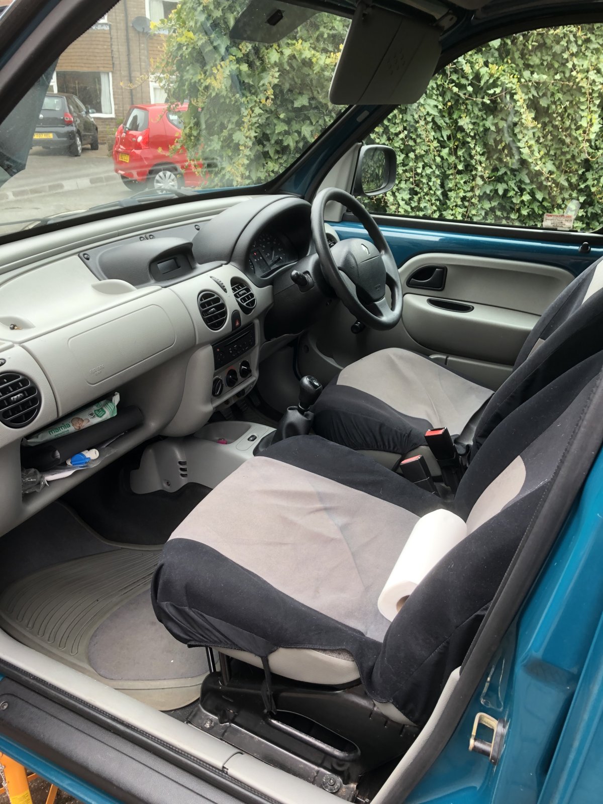

Kermit is about as basic as can be inside, (wind up windows and interior light delete). Got to be honest, I’m not 100% sure if the horn is on the wheel or the indicator stalk ?

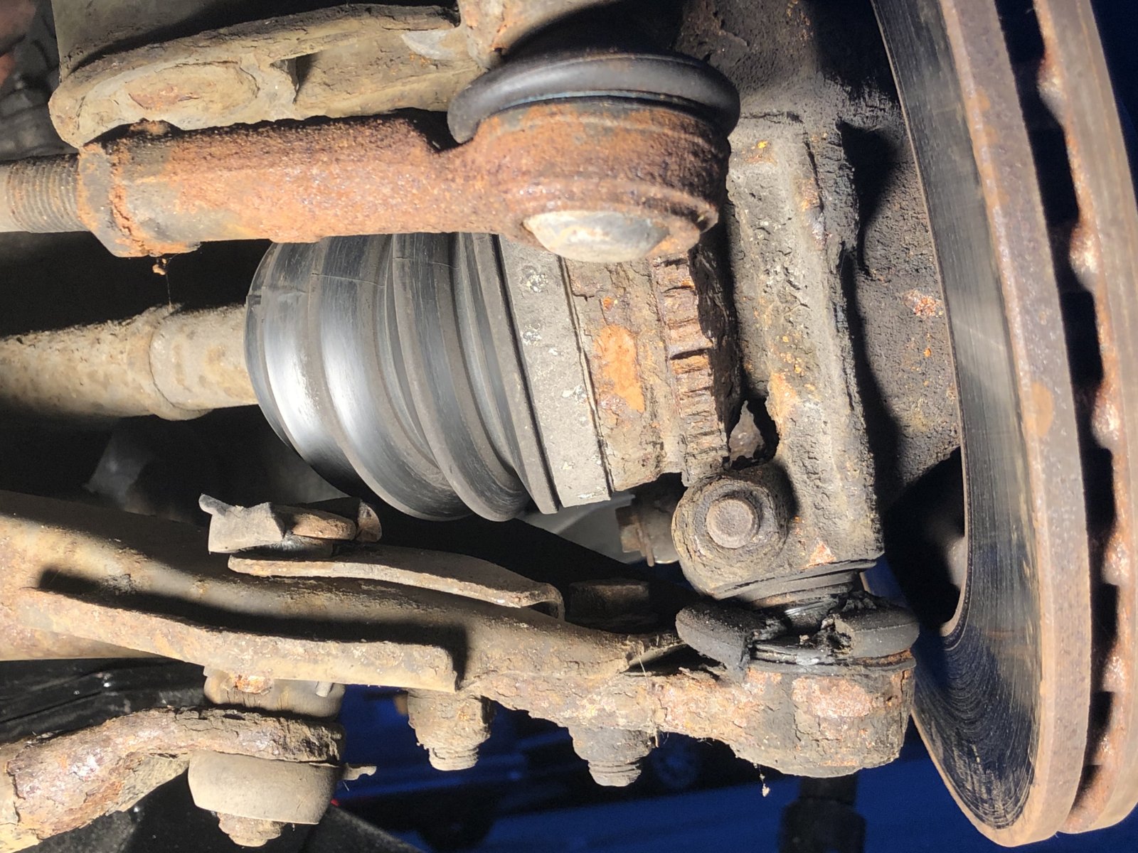

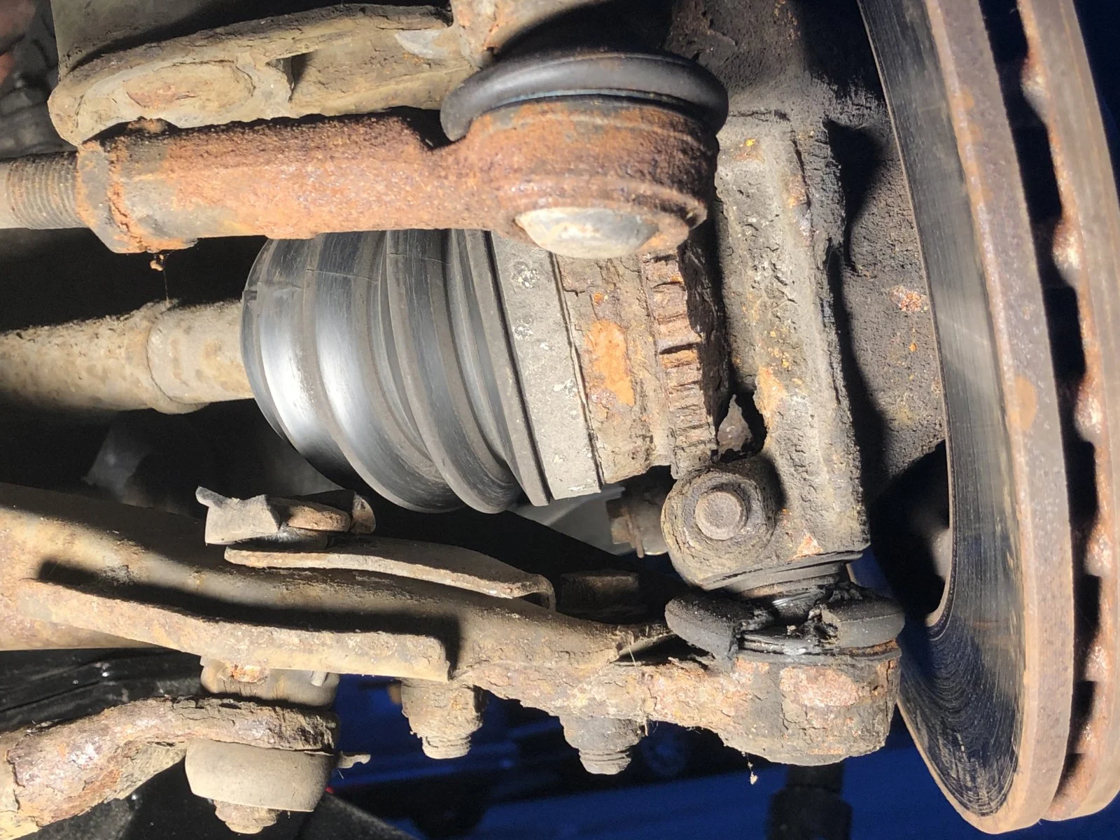

Upon removing the front wheels, it didn’t take long to find the source of the problem.

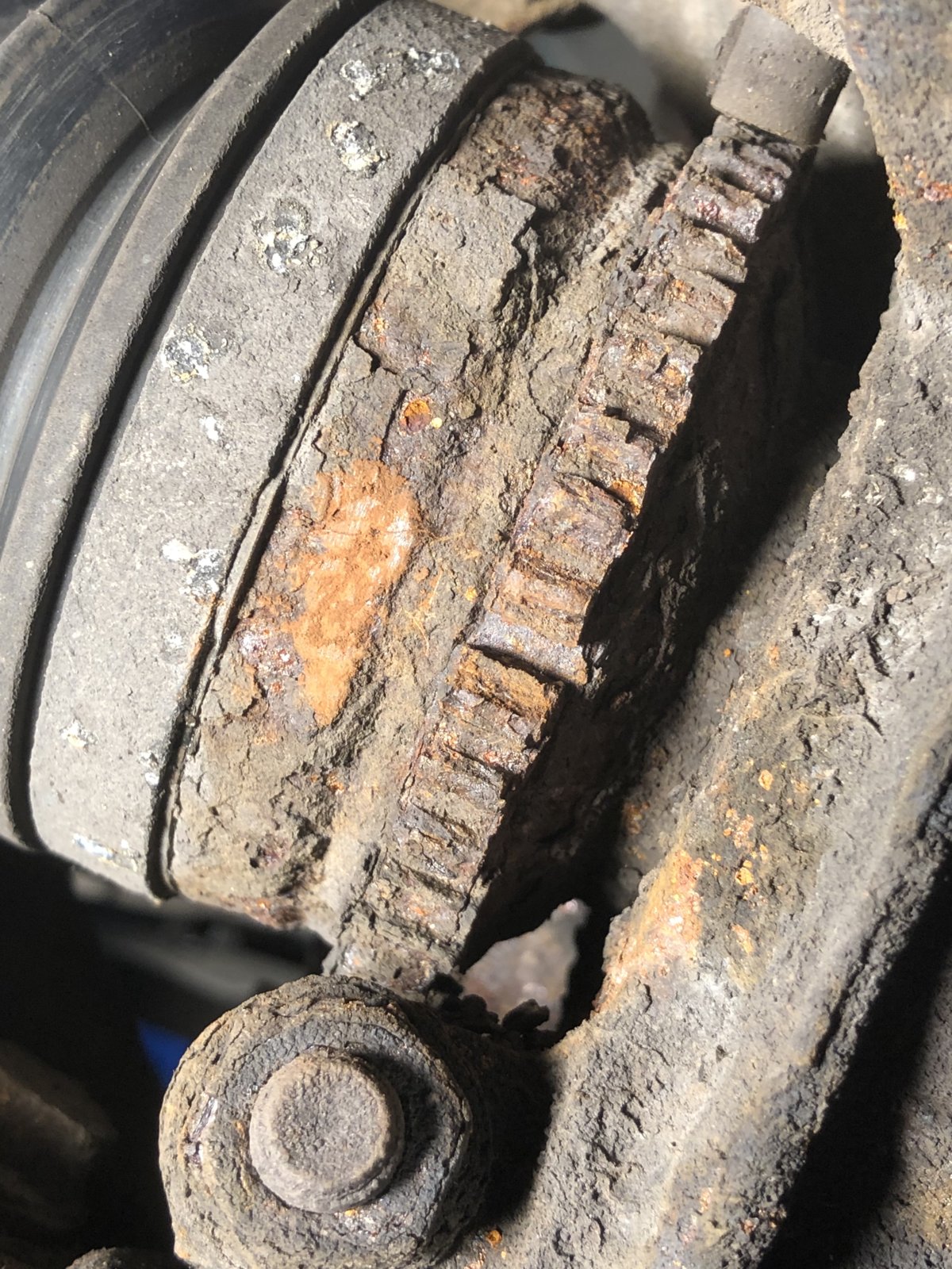

I know it isn’t a very clear photo, but the ABS reluctor is broken in two and missing a tooth. This is the drivers side, and although the passenger side is complete, the reluctor doesn’t look in great condition on that side either.
There are other issues I noticed today as well whilst having a poke about.
Although the front discs and pads look pretty much brand new, I think I’ll take the disc retaining screws out and Copperslip them before the inevitable happens.
On the passenger (N/S), the inner CV joint looks to be leaking, although I couldn’t see any obvious sign of the gator being split or damaged today. Are there rubber seals on the gearbox / driveshaft join on these ?
On the drivers (O/S), the good news is that it looks, based on the cleanliness of the inner and outer CV joint gators and their clips, that both CV joints have been replaced recently.
The bad news is that the bottom ball joint has gone there’s a bushing joining the lower wishbone to the ARB that’s gone, and the upper ball joint doesn’t look great either.
Fingers crossed this isn’t going to be one of those pain in the ass jobs where everything goes wrong and it drags on for several days.

Both front lower ball joints were replaced, along with both front ABS reluctor rings and both front ARB to lower wishbone drop links. The bolts for the drops links were just a couple of mm too small, so I used some threaded bar, M8, (or it might have been M6, I can’t remember), with washers, nylock nuts on the top and double-nutted with threadlock on the bottoms.
No pictures as I was in a rush to finish the job. And as the saying goes, ‘more haste, less speed’, in my hamfistedness, I accidentally pulled the near-side driveshaft out of the gearbox, rapidly emptying the contents of the gearbox all over my driveway. By the time I’d retrieved an old paddling pool of my daughters that I use as an extra catch tank when doing oil changes from behind the garage, most of the gearbox oil had already come out.

The underside bolt on parts (lower arms etc) all look pretty corroded also, so I’d just bin the whole lot off abs start again from the 172 parts.
