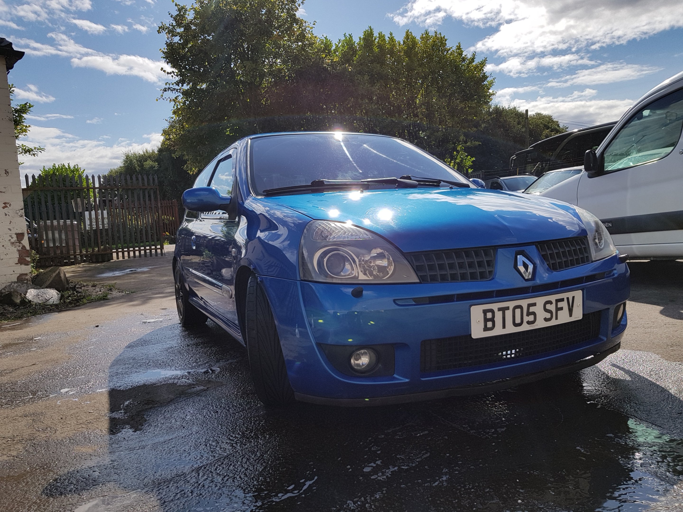

Got it through to the unit yesterday and first thing first, was to polish up the headlights and give it a good wash!
Headlights before:
And after:
Passenger headlight still has a mark inside it so I'll probably be on the lookout for a replacement at some point.
Following this, a quick wash, decon, de-tar, wash again and a coating of some spray on stuff my mate had, which seems fairly similar to CarPro Hydro2.

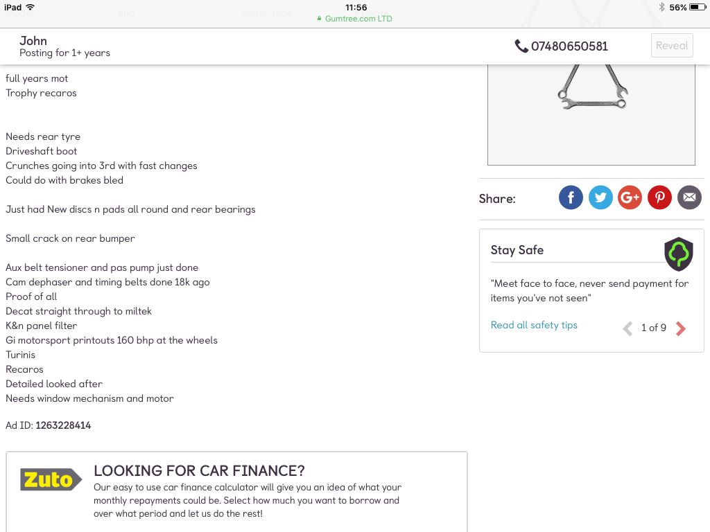

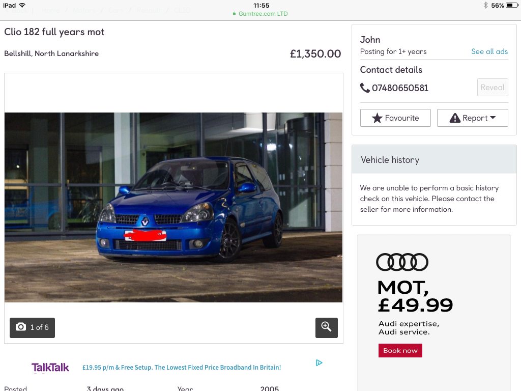

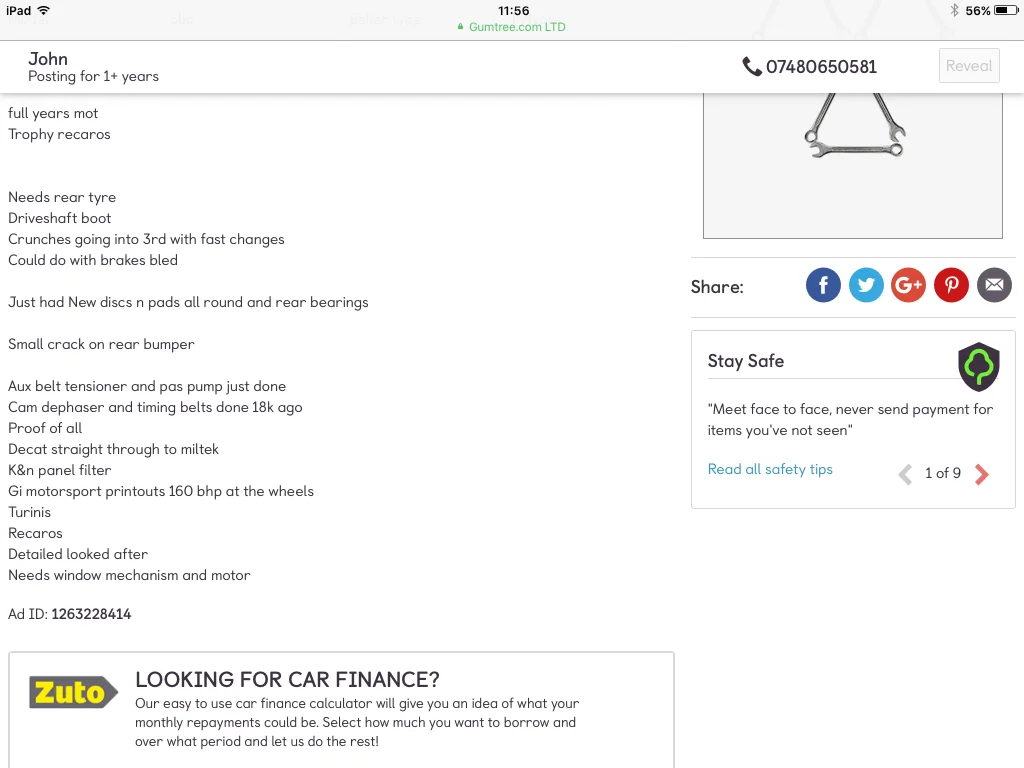

Absolute bargain matey. Here's the original advert for you. I really fancied it to be honest but the travelling distance put me off.

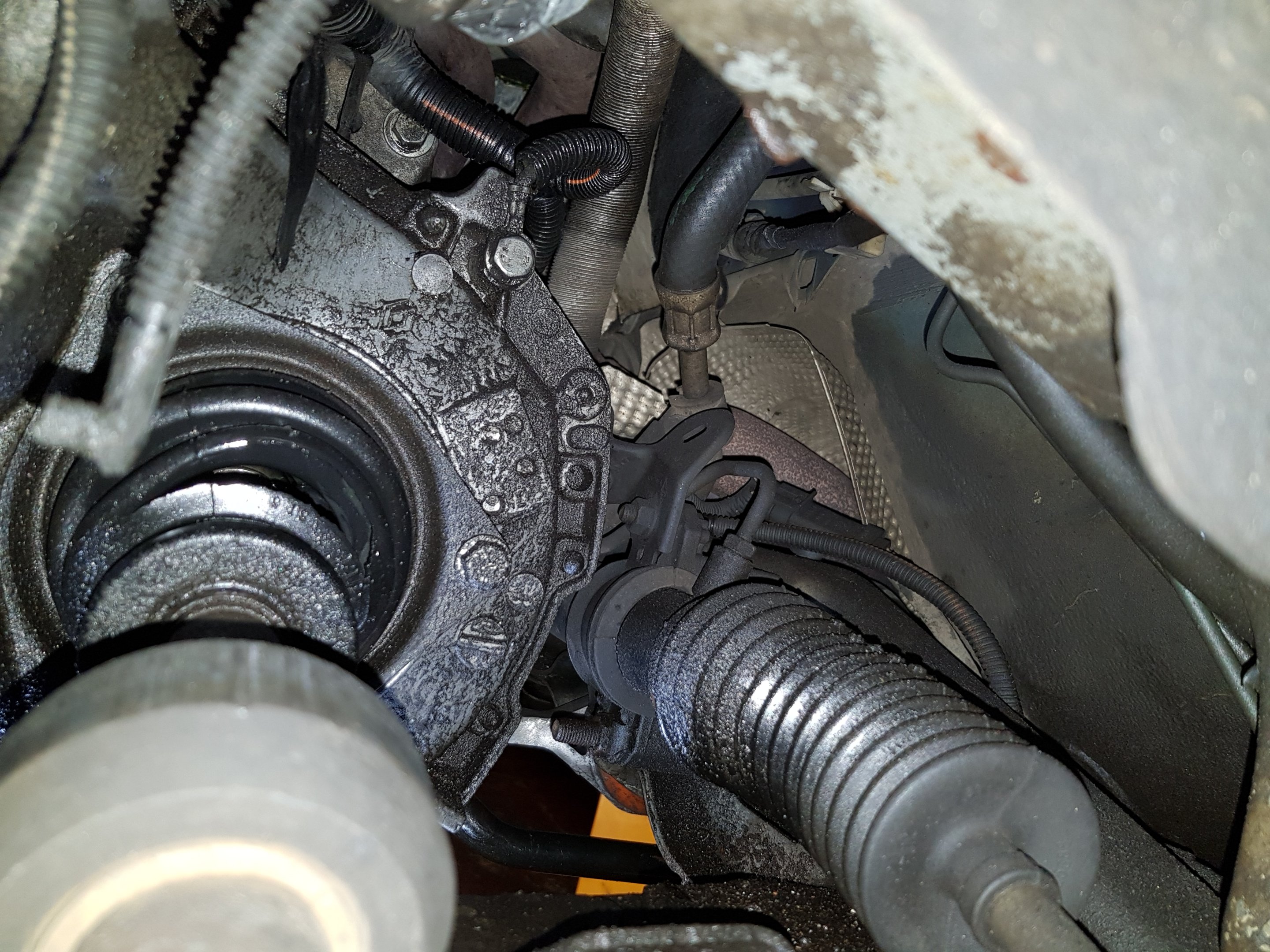

Also fitted a new inner CV boot on the nearside as the current one had sprayed most of the gearbox oil all over the underside of the car since it looked like this:
Annoyingly there's still a slight leak from it on the end that clamps round the driveshaft, so that needs investigated. Hopefully just needs clamped tighter.

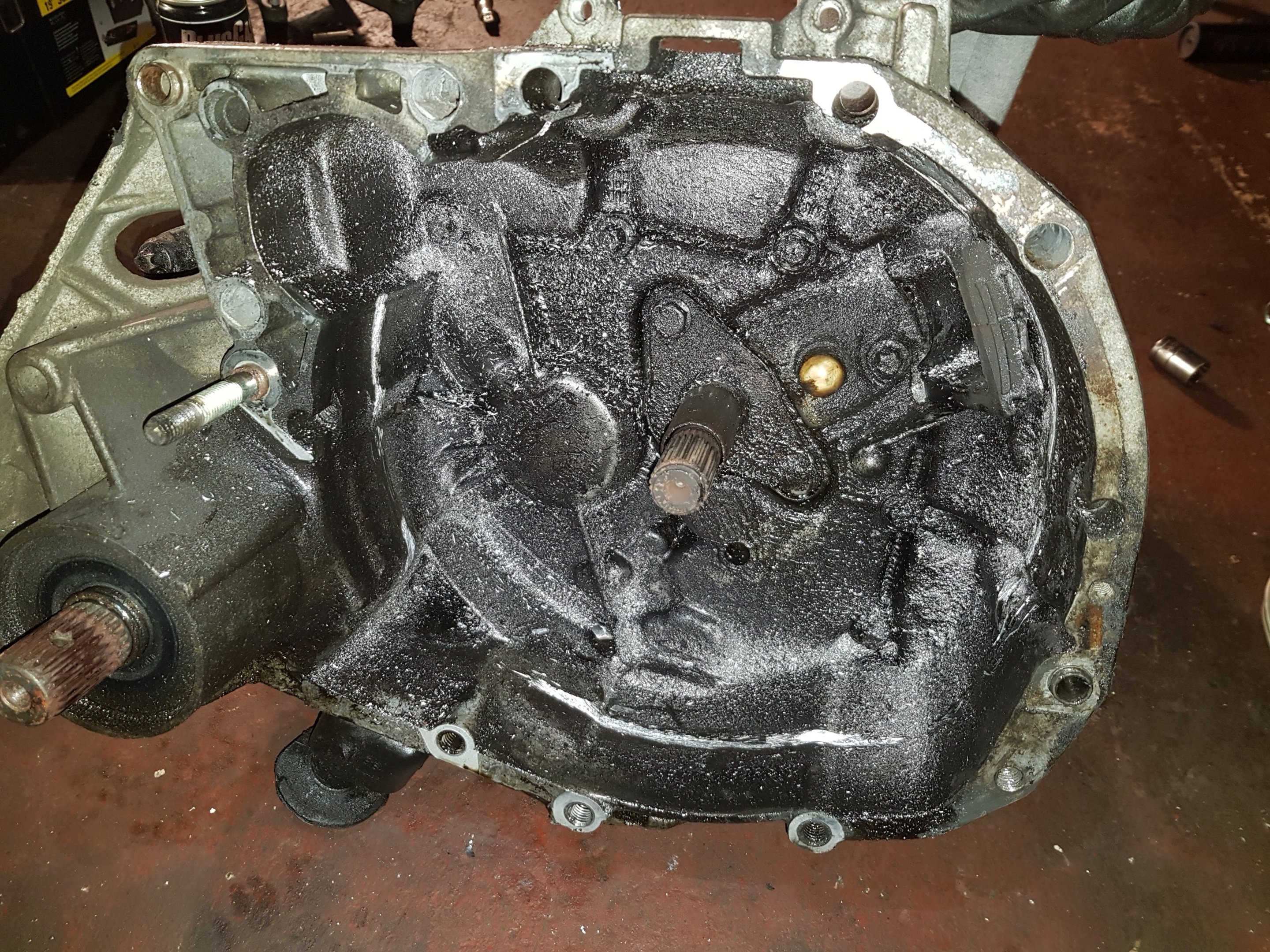

Well the box is out and it doesn't look good 😂
(Yes, that is all metal shavings in the bell housing lol)

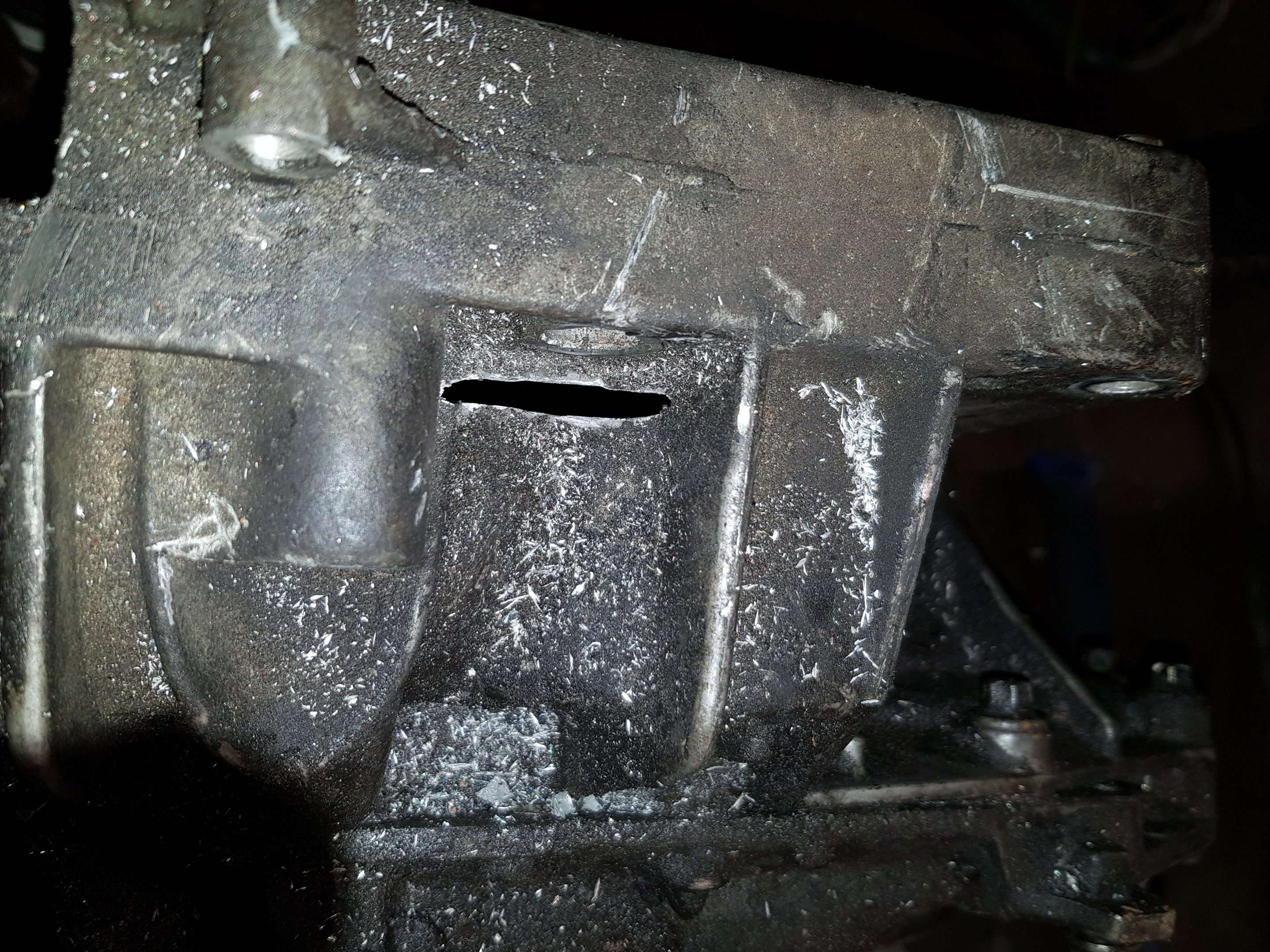

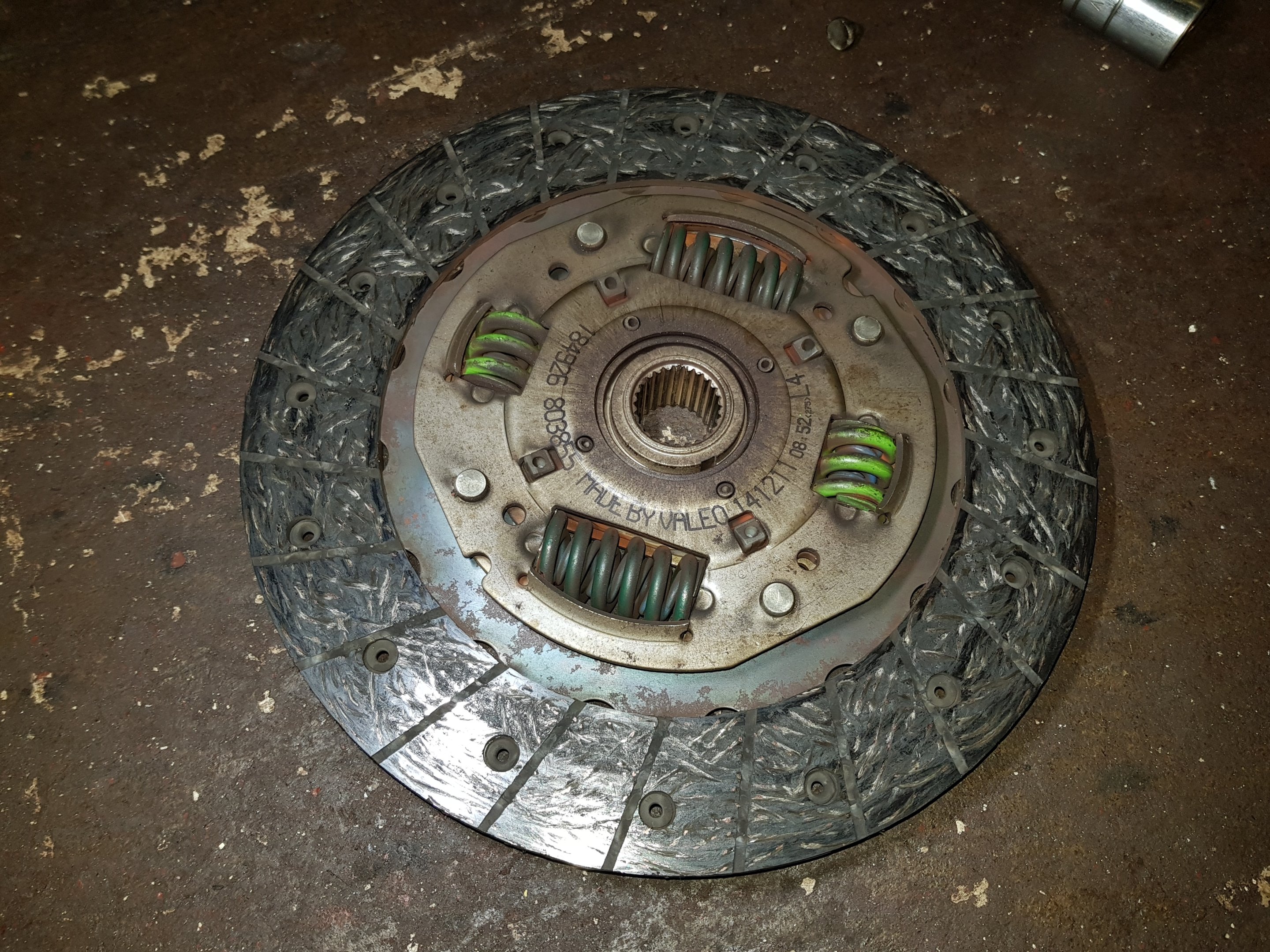

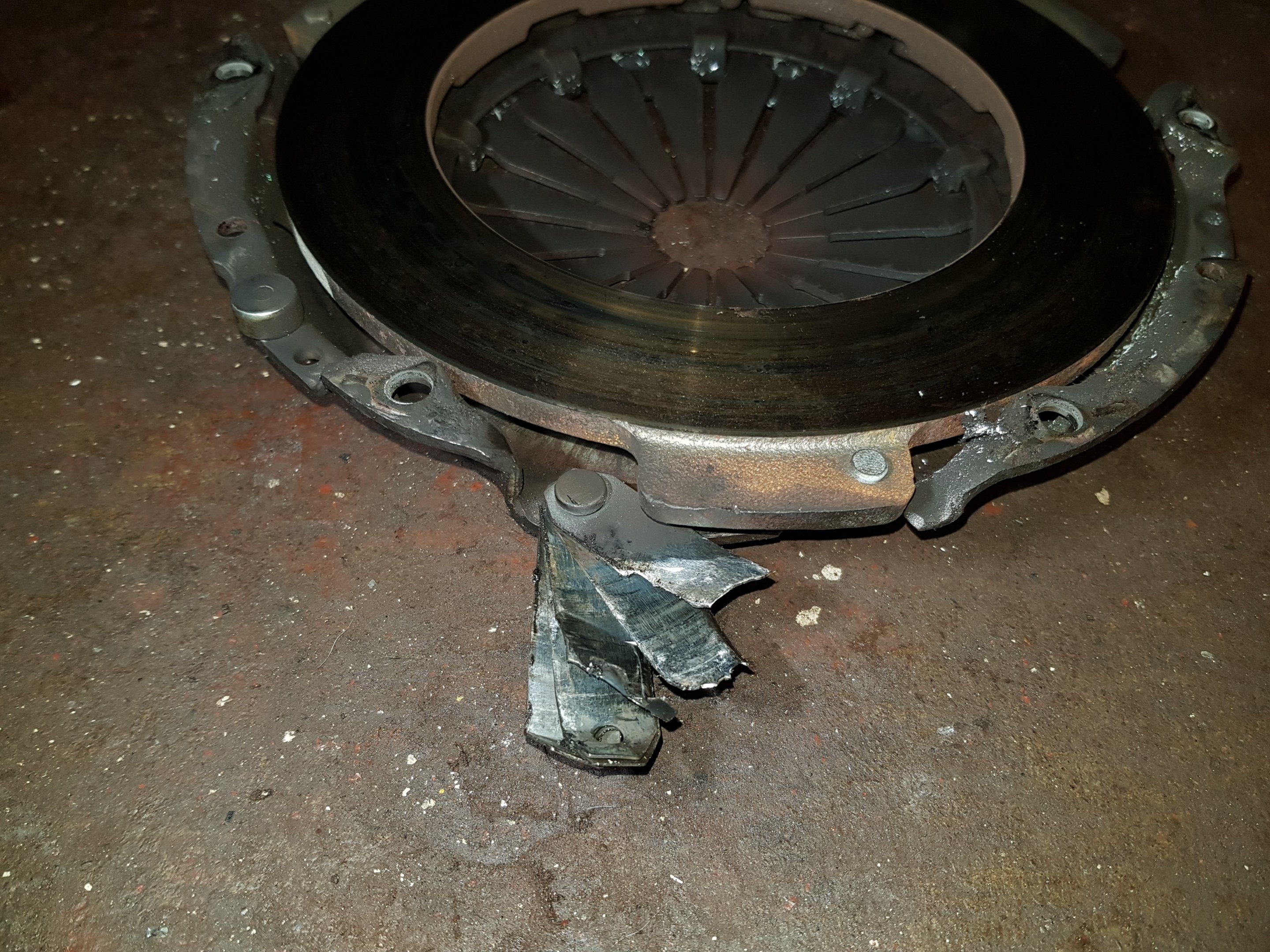

Ok so, after quite a struggle last night, we finally got the gearbox out and found the issue. Before we took it out we could see metal shavings throughout the engine bay around about the flywheel area, however we didn't quite expect to be greeted by the full bellhousing being coated in them! It was well and truly fucked!

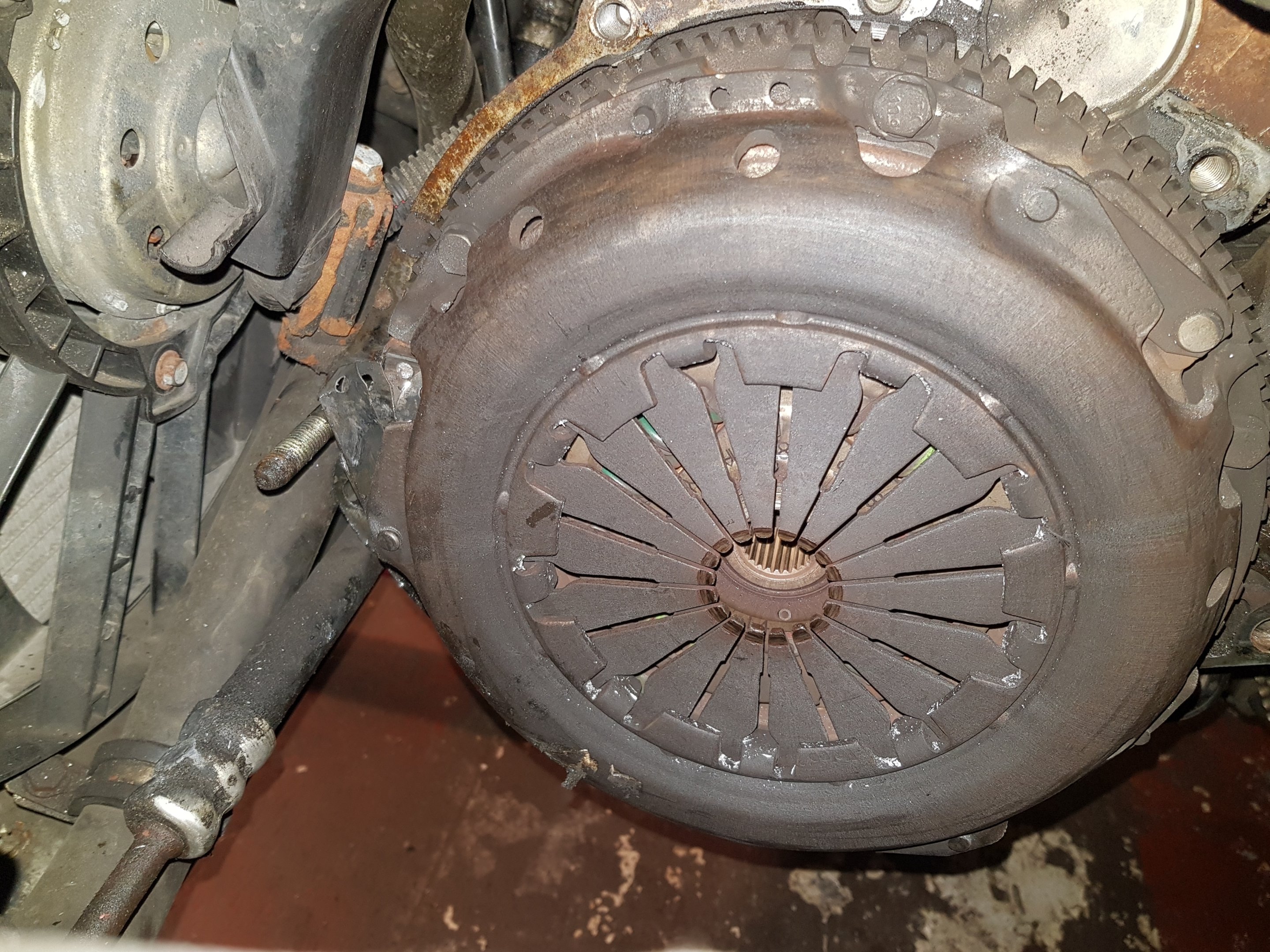

Once the gearbox was out we were greeted with this:
Note the metal bits hanging out the pressure plate on the left. Once this was off the problem was clear...
Surprise surprise too...it's a valeo clutch! And a fairly new looking one at that. Another failure of theirs to add to the list.
Looks like the rivet holding the springy bit (or whatever you call those bits of metal) around the pressure plate had failed, and the metal has spun round scoring the inside of the bellhousing leaving a nice scoring all round it. It's cut a lovely big hole out the top too!
All in all, not ideal, and certainly not planned for when buying the car, but on the plus side, it hasn't put a major hole through the gearbox and a new clutch should be all that's needed to sort it.
I now need to find a decent clutch for it though, because I'm sure as f**k not putting a valeo one back in!

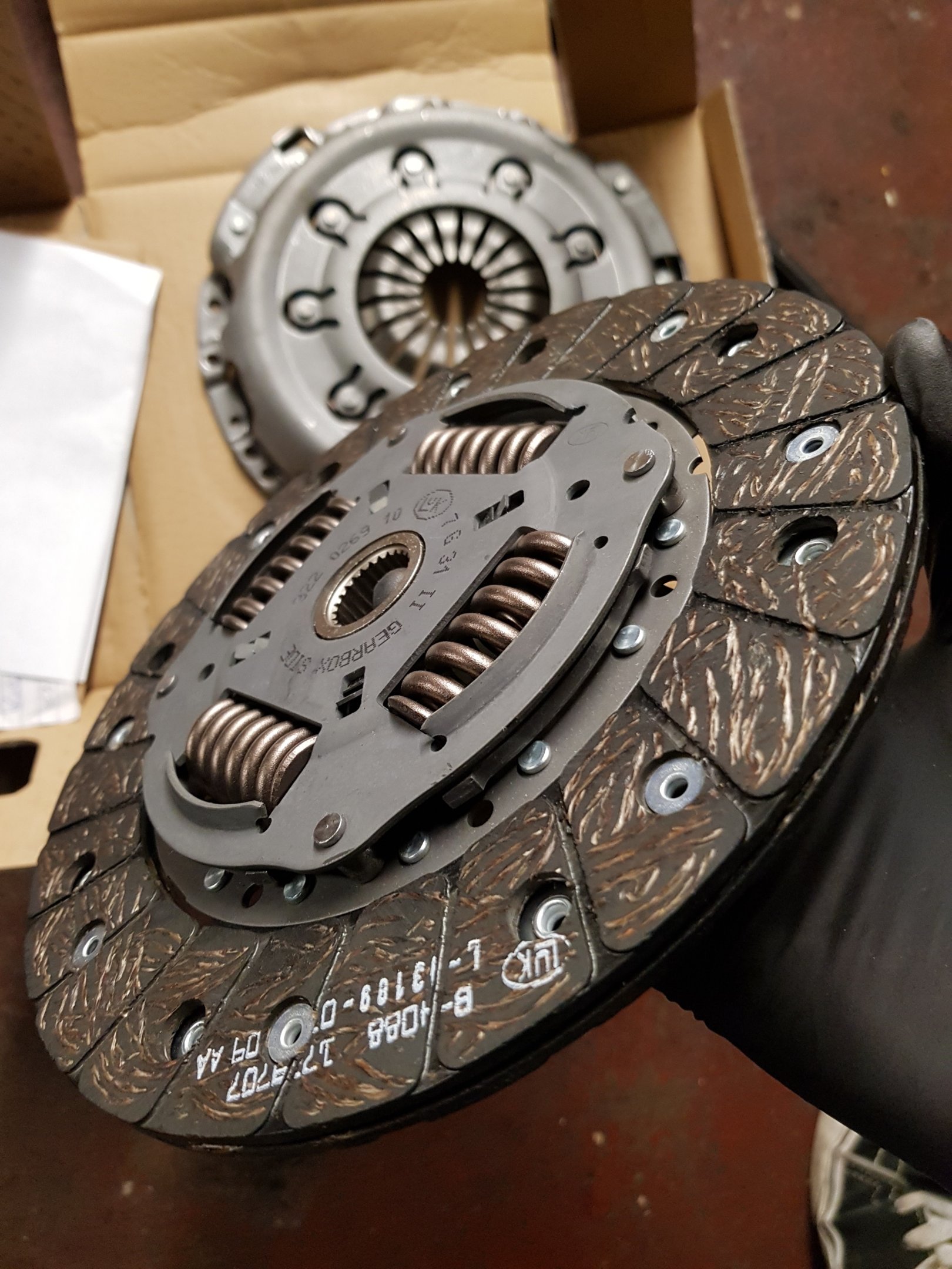

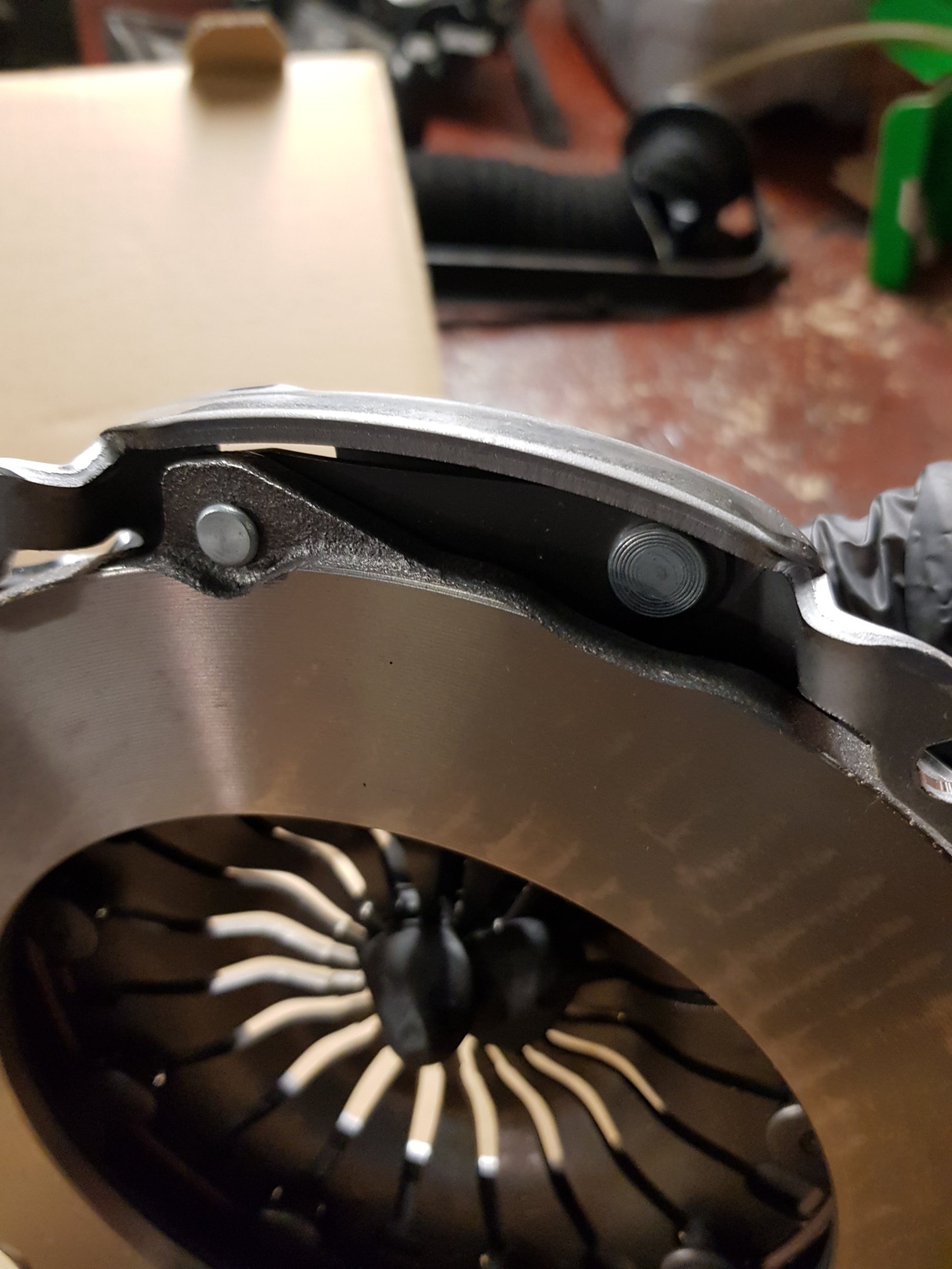

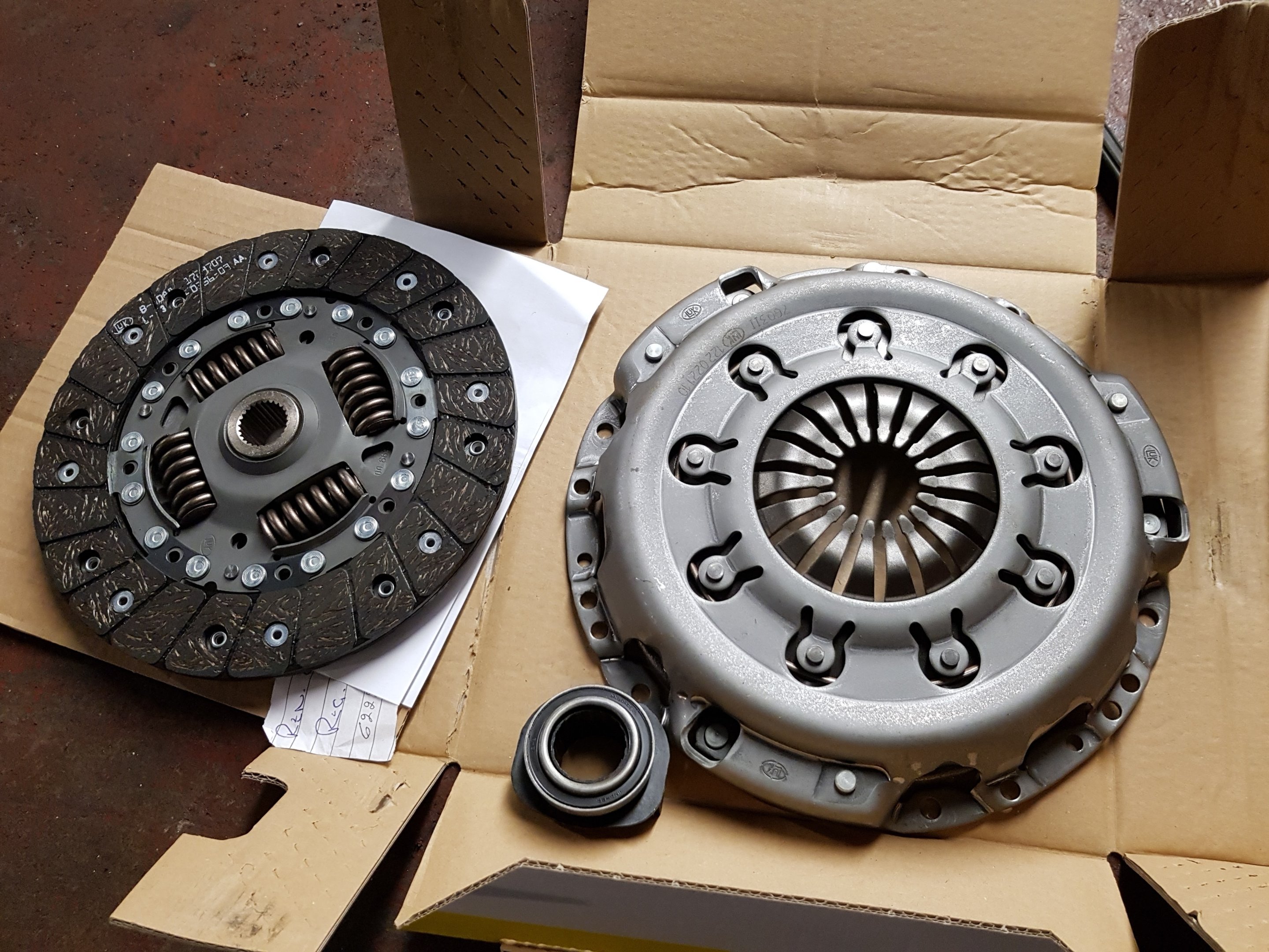

We went for a LUK clutch which, to be honest, looks far better quality than the Valeo item! Actually got it changed and back together the day after the gearbox came out but I've been on holiday since then so forgot to update the thread lol.
As you can see below the LUK pressure plate has a cover over the part that failed on the Valeo one, which would've prevented the bell housing from being cut into the way it has been.
As for the valeo clutches, I've now personally seen around 3 or 4 failures of the exact same component. From searching on here, probably 10+ failures documented from both track and normal road use. All with the same rivets on the pressure plate failing. I have a valeo clutch in my track ph1 172 and TBH I think I'll be changing it before I get it back out on track.

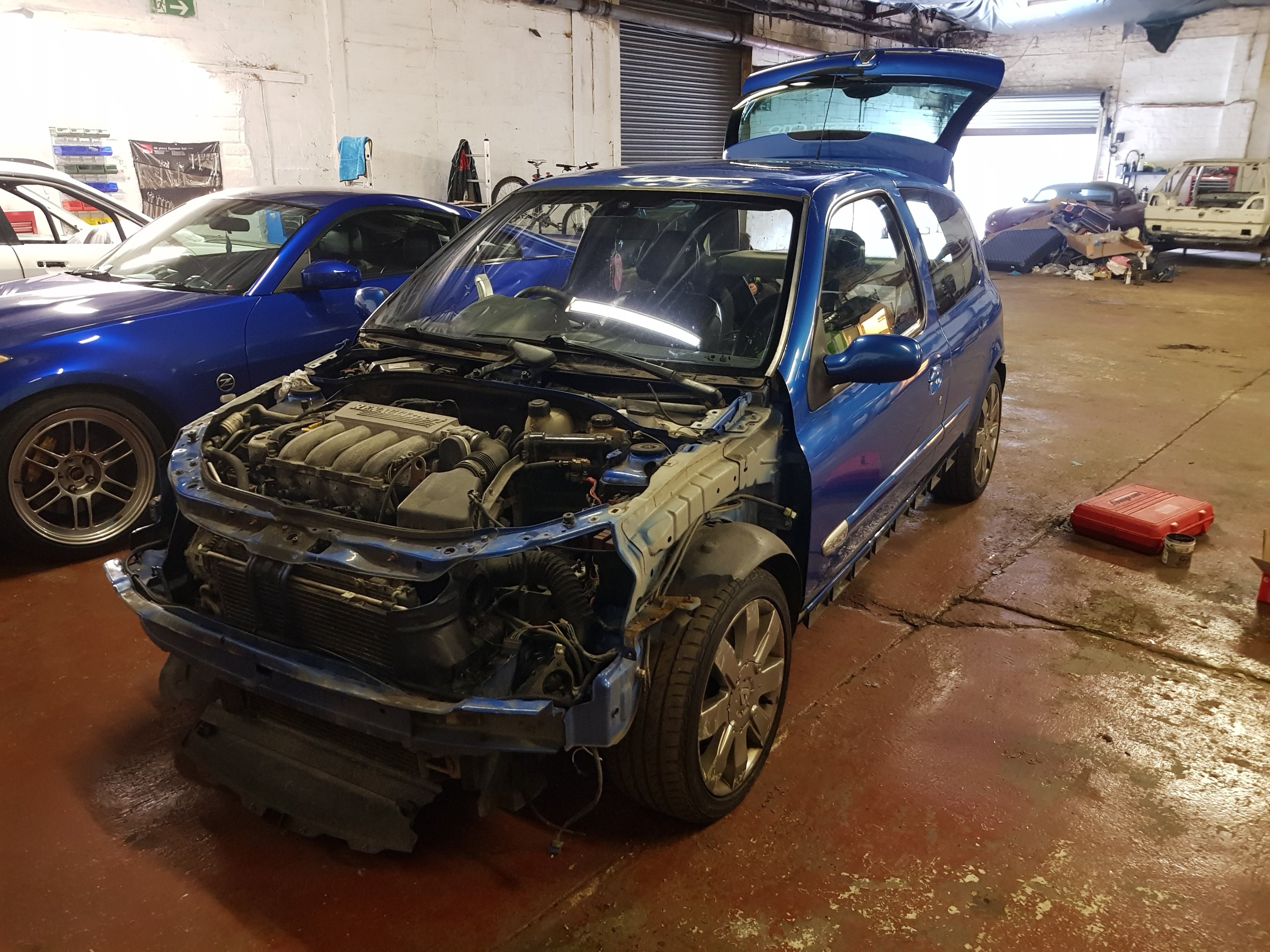

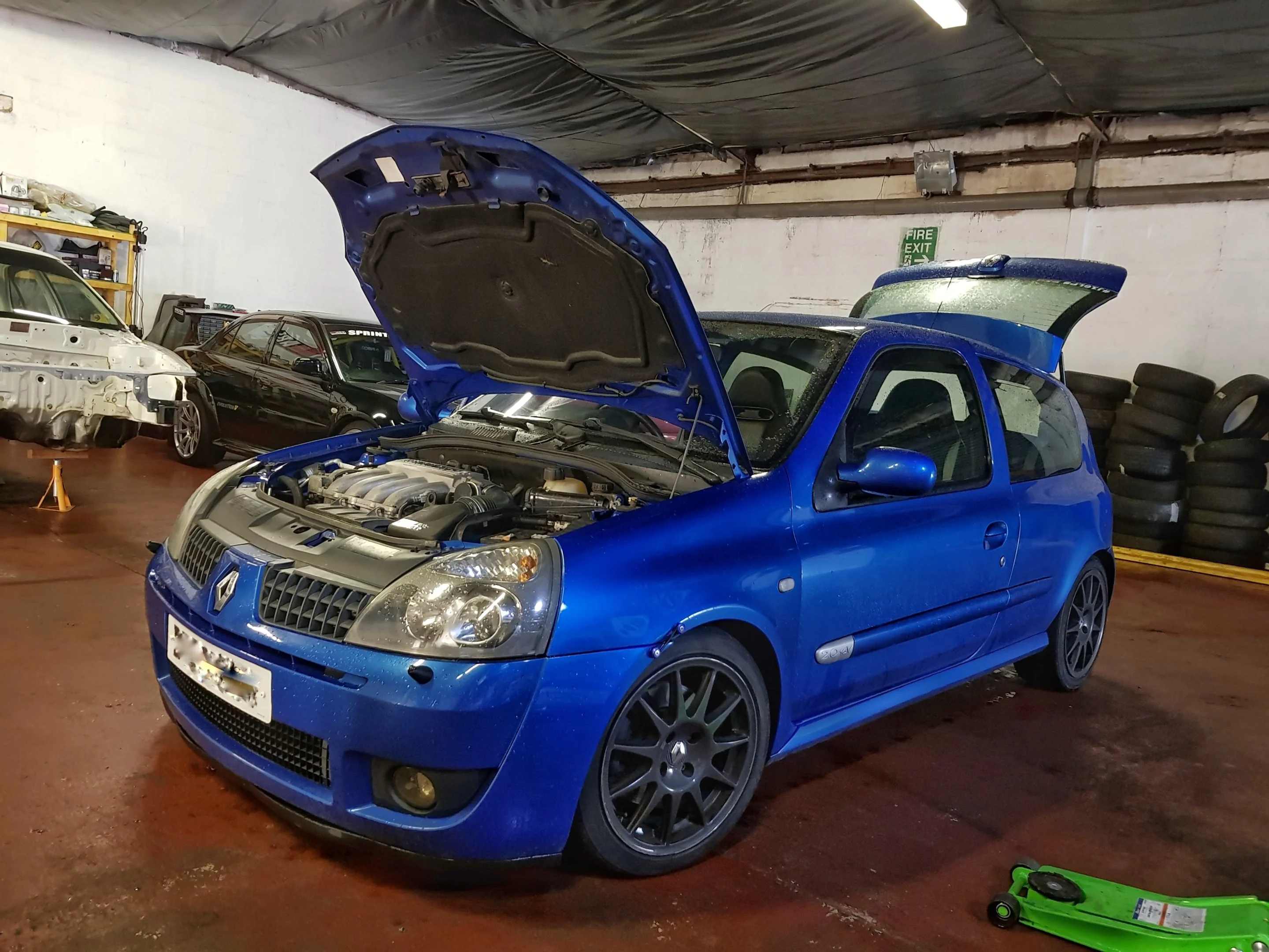

Can't believe it's been almost a year since I updated this! Decided it needed a change of wheels again...
Not much has happened tbh, it's not been used much but things have slowly been getting fixed. Got an extremely cheap donor car and it's been used loads so far to fix little things here and there.
Voila, £300 worth of fully running Clio!

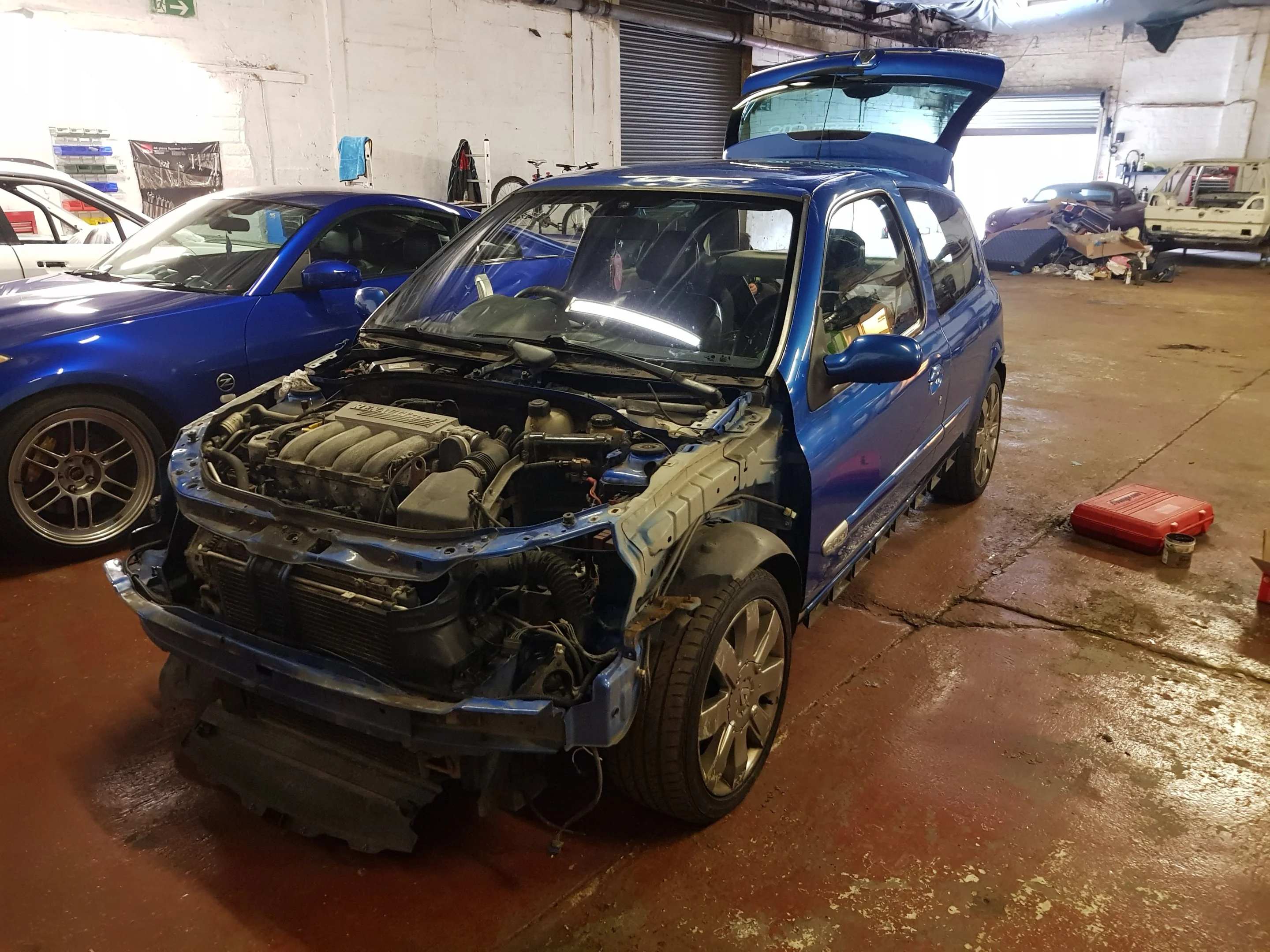

So far it's been used to replace both xenon's, rear calipers and lines, the horn, sticky interior trim with stuff that looks almost like new, swap out the cup rear bench and fabric door cards with proper 182 seats and alcantara door cards, and replace the interior temp sensor too so the climate control doesn't just constantly blow hot air. Also sleeved the cat so it no longer leaks. Probably a few other things I've forgotten too.
Bodywork is next on the list, but for now, the 'definitely-not-going-to-be-a-track-car' 182 is booked on at knockhill on Saturday... Meanwhile my actual track car still lies on pieces.
