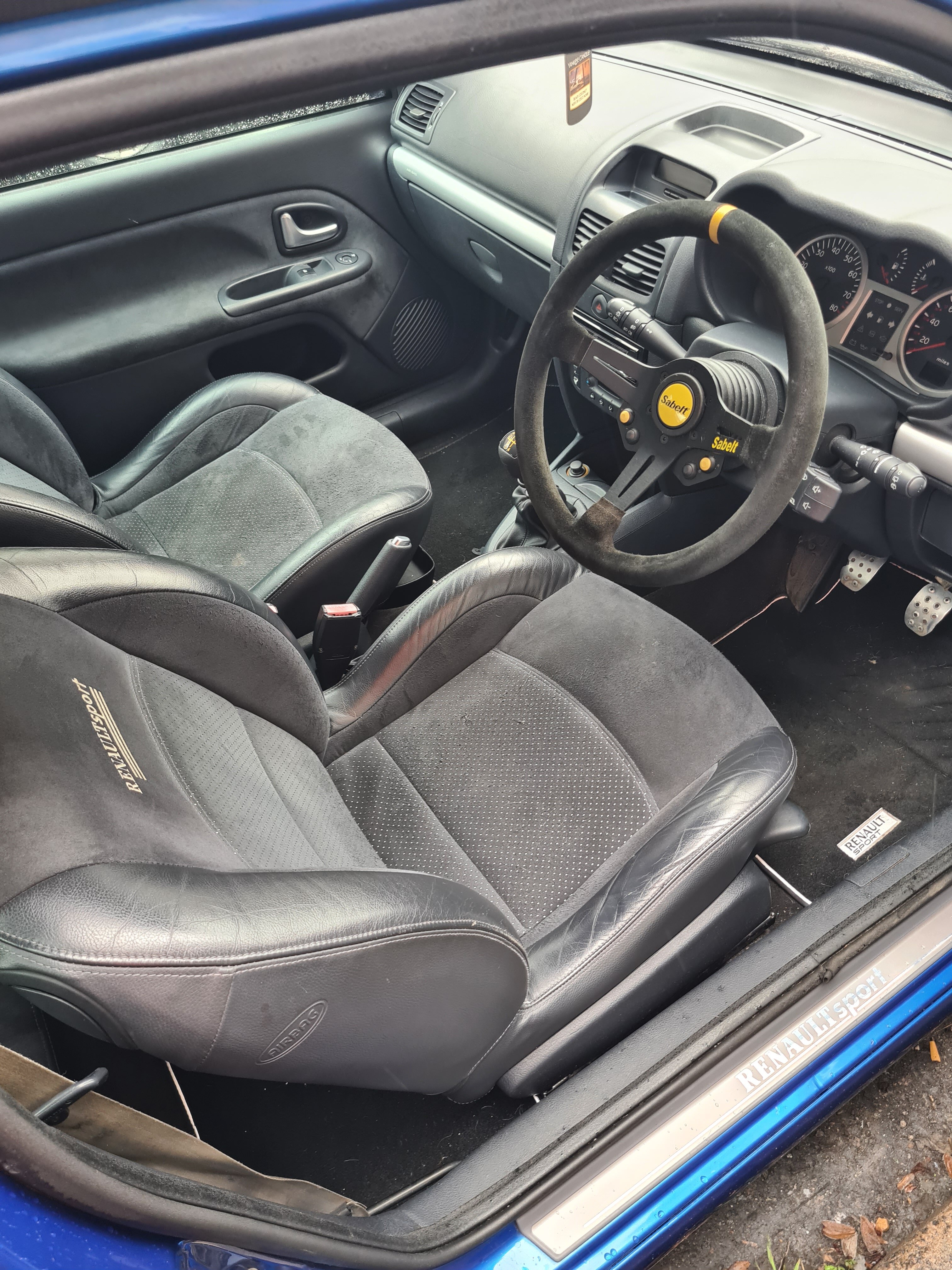

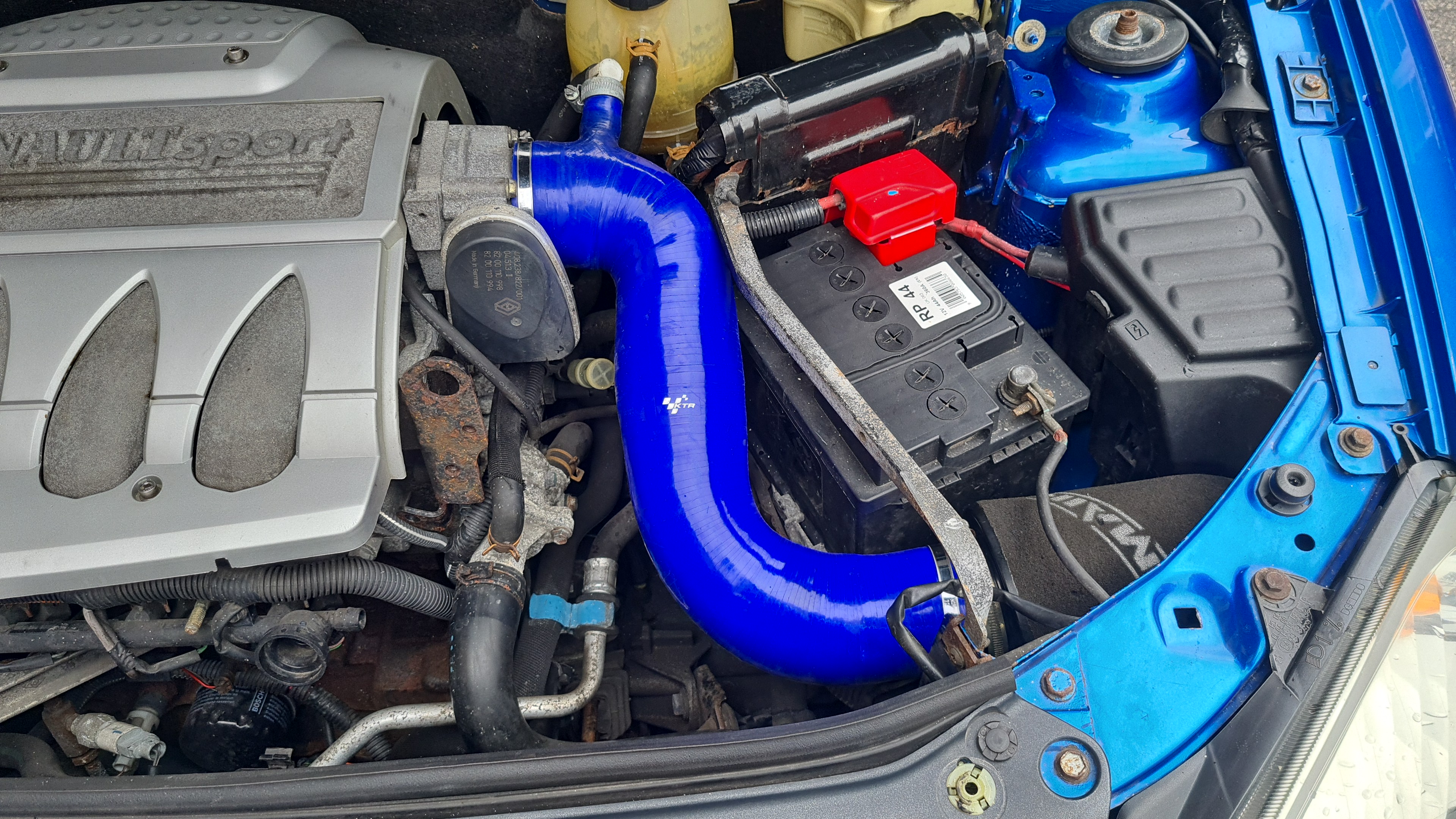

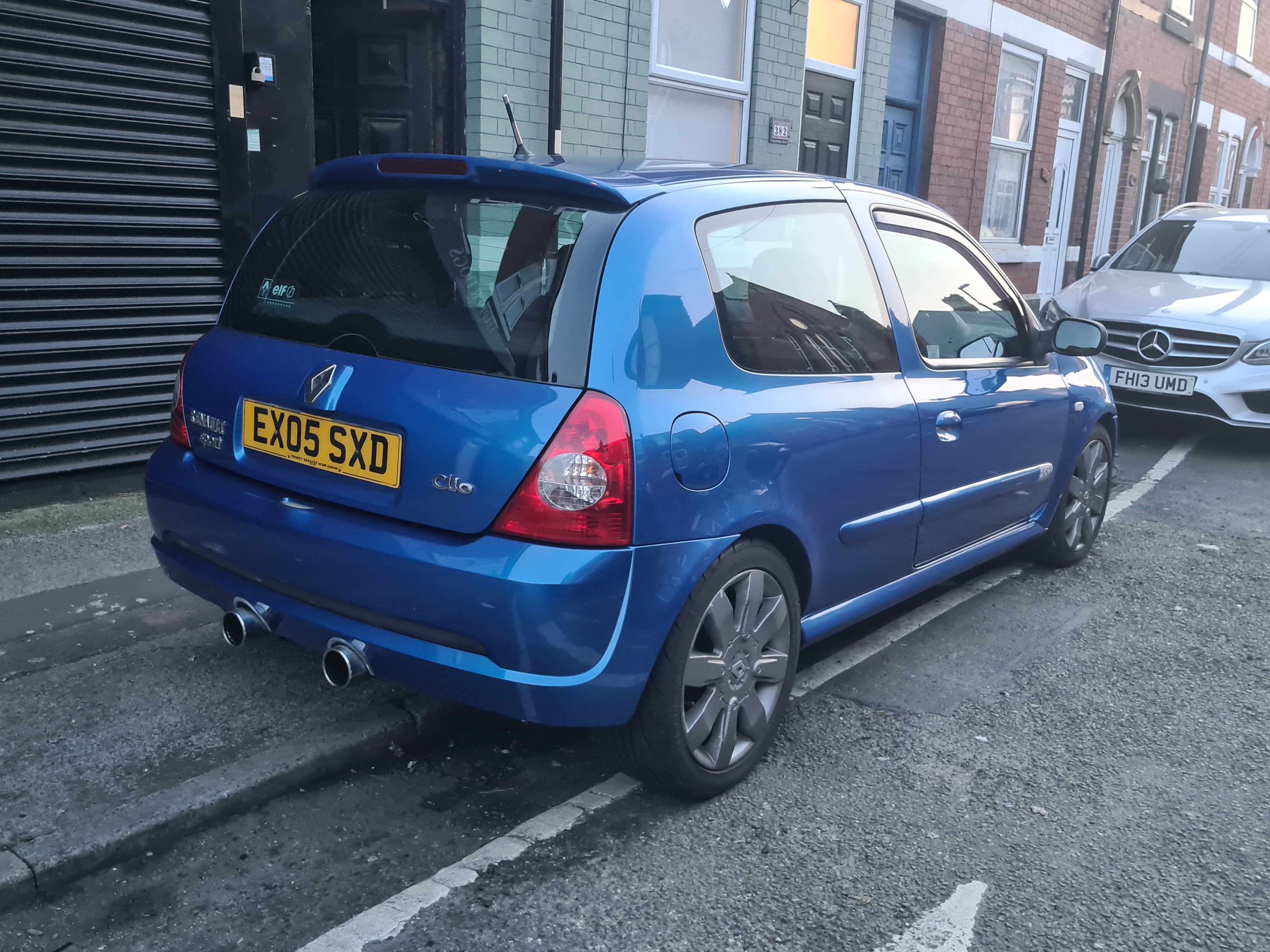

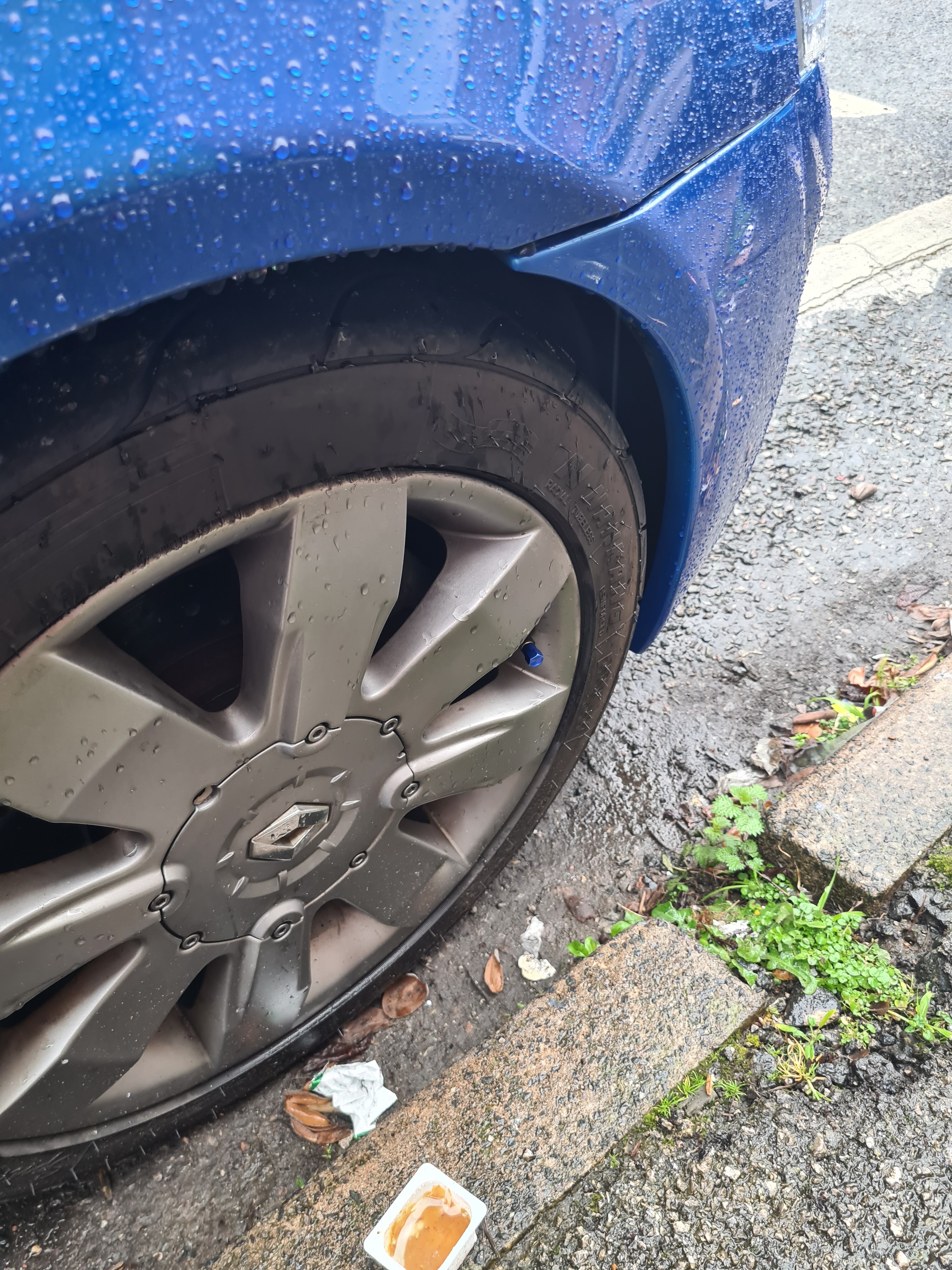

So I got myself a arctic blue clio 2005 182 a few days back so thought id make a little progression thread more for myself than anything ,, 170k but full service history including the original build sheet where I found it was specced with cup suspension and cup spoiler pack and only 3 owners from new
The bodywork is pretty mint for the age of the car ,, no damage no rust ,, filler cap is clean arches are mint , underneath looks nice too , interior again is all clean and all there ,, the only mods the car has is scorpion decat and full scorpion exhaust , sabelt steering wheel , eibach lowering springs and shocks
I brought with a rattling clutch but sadly the day after the clutch pretty much went ,, squeeling with clutch down rattling heavily and not wanting to go into gear so it's booked in for a clutch in 3 days (wednesday) so
hopefully all will be well then ,, only thing I dont have receipts for is the aux belt and tensioner so just ordered one while there in stock at cp performance to be on the safe side ,, anyways here a few pics of the new toy

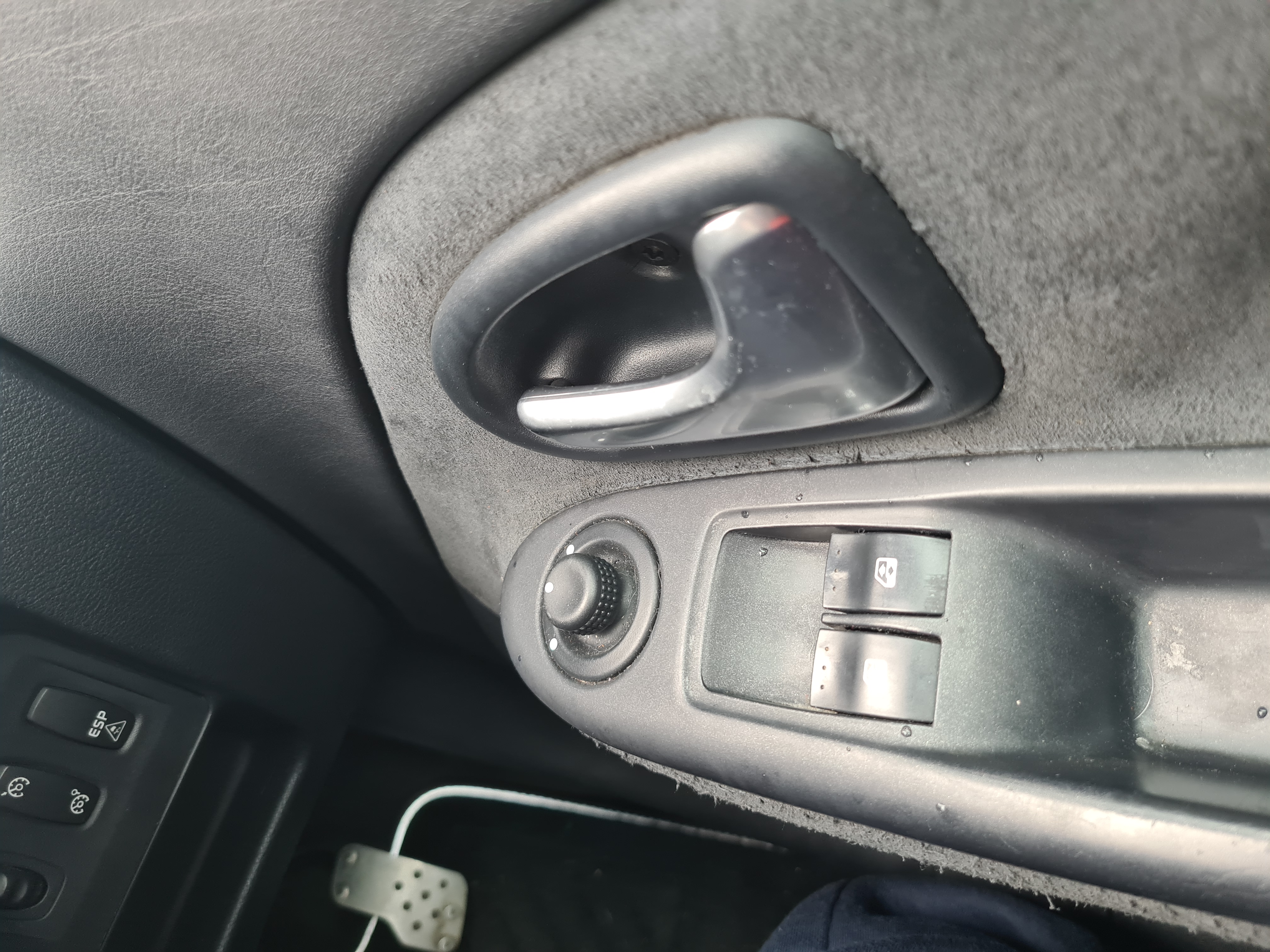

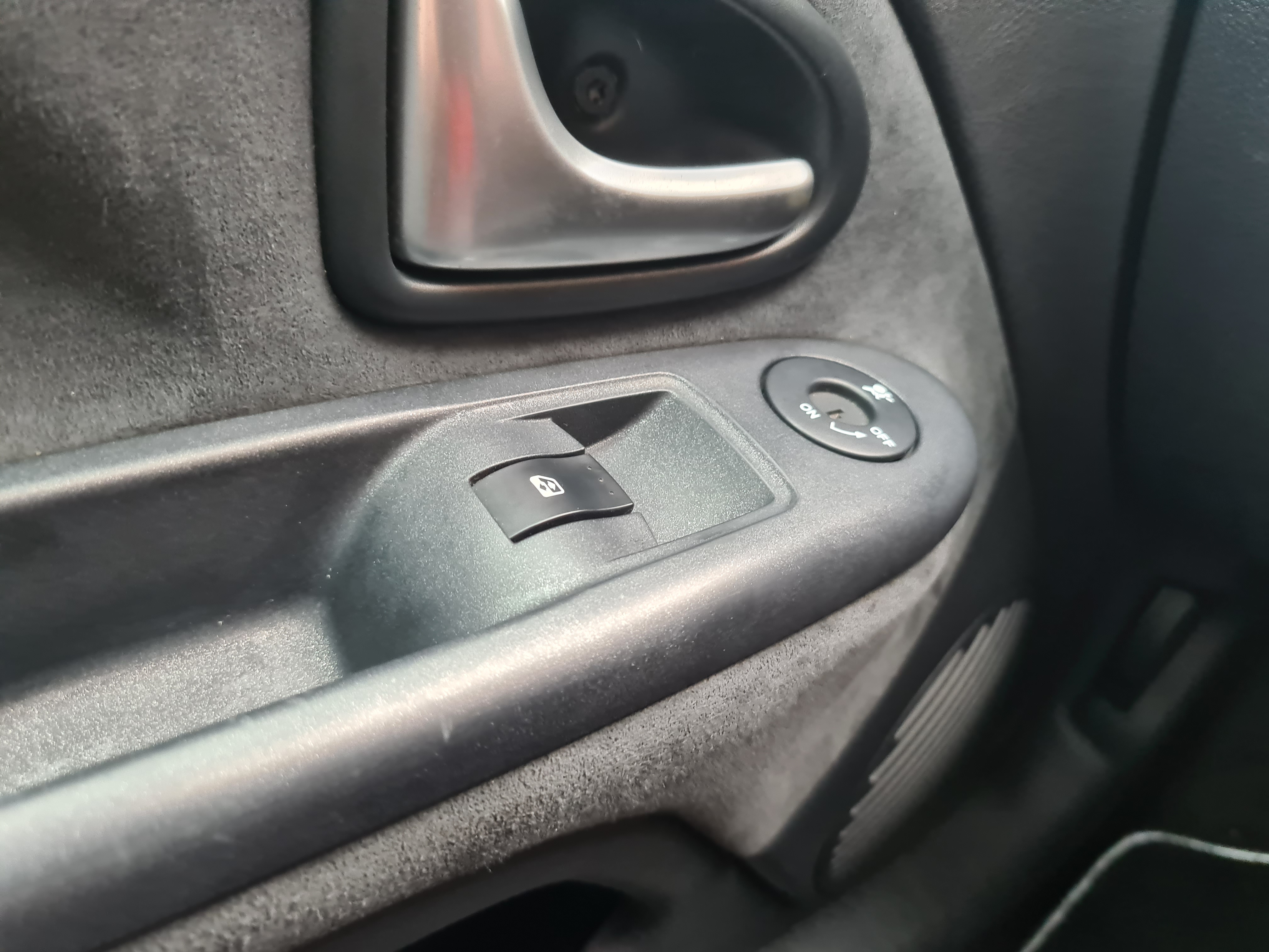

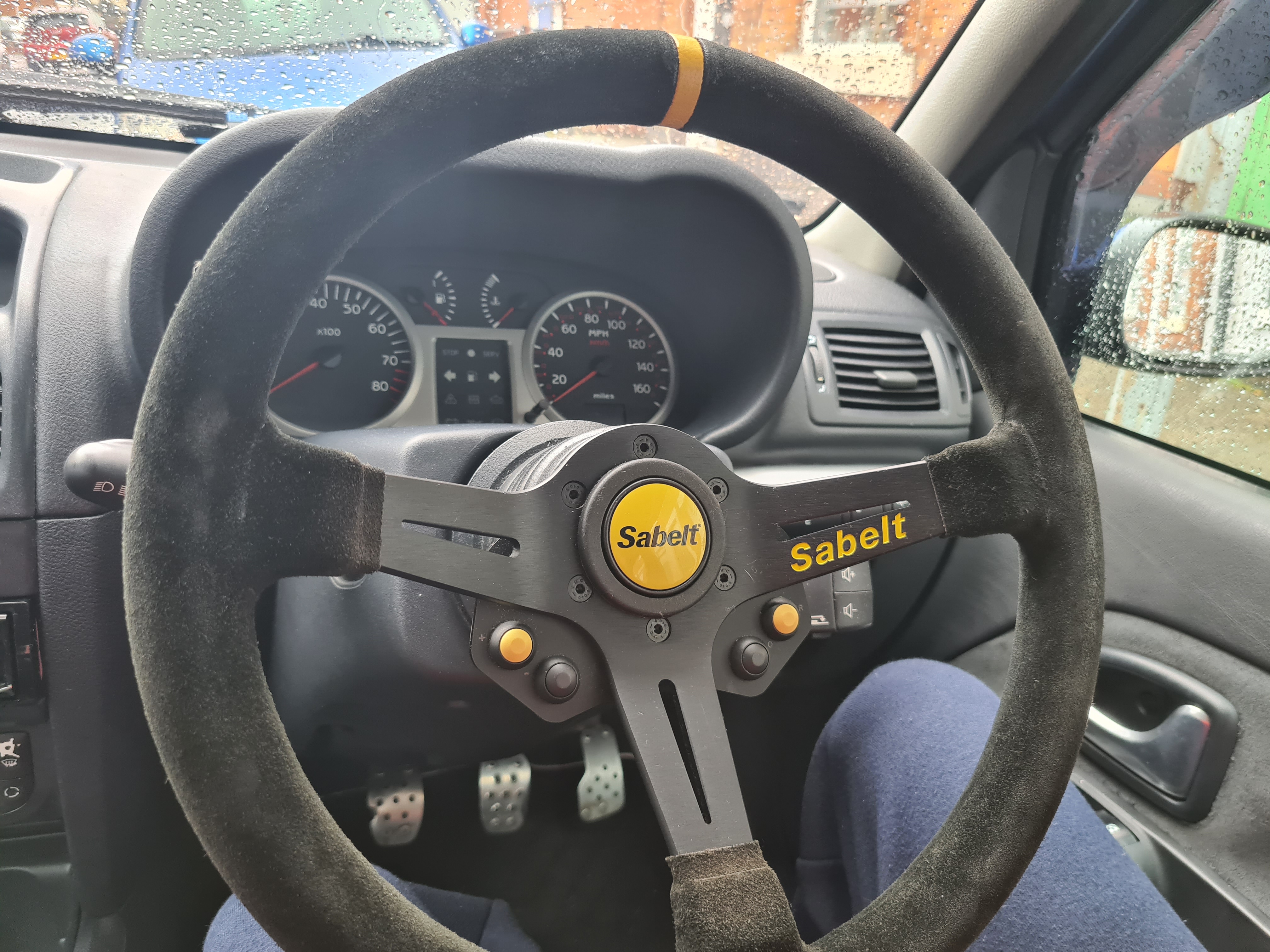

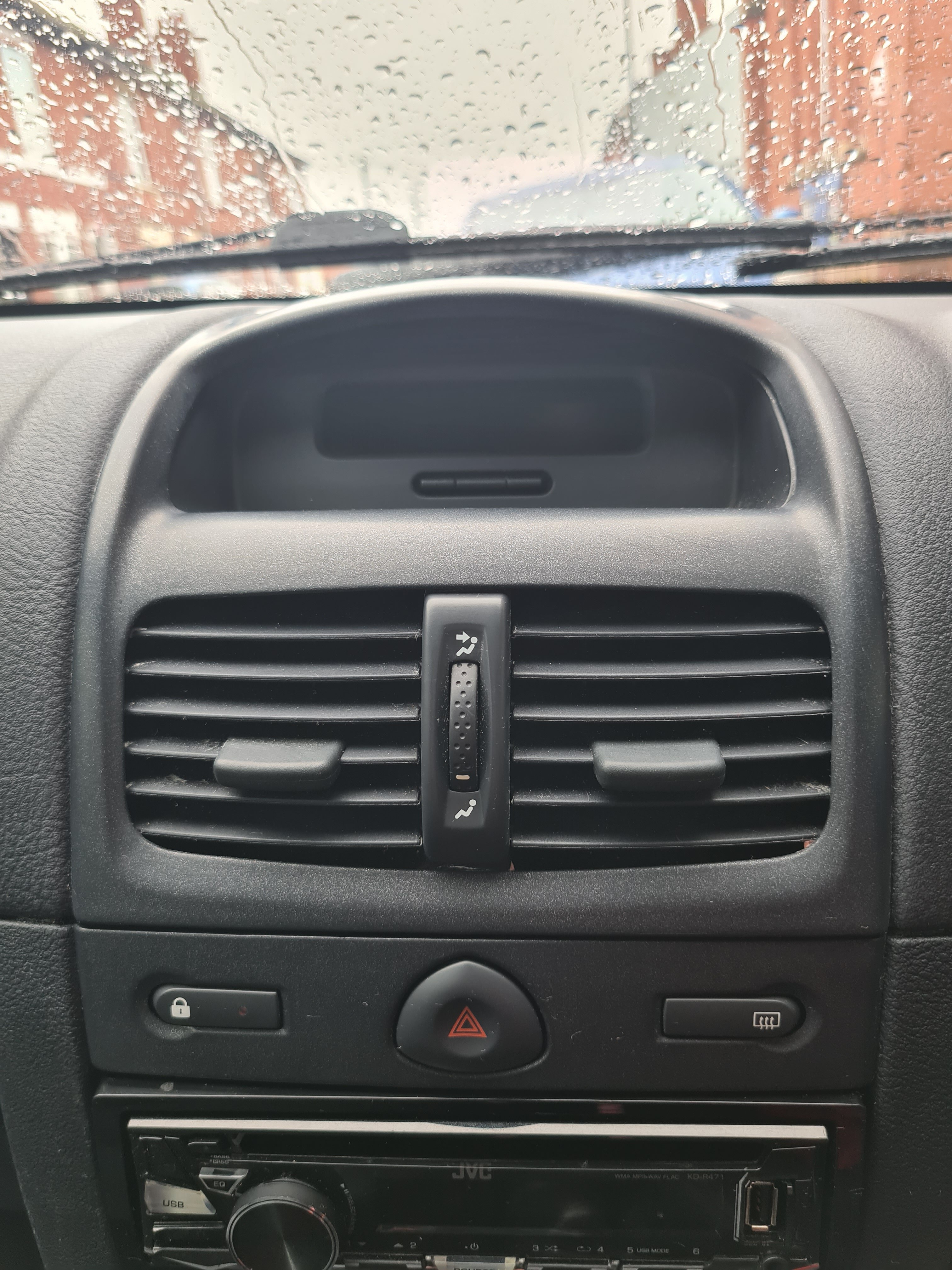

So yesterday while the car is sat waiting for ots clutch I thought I'd sort the sticky plastics out in the car and what can I say bar , it was a hour well spent ,, no more stickyness ,, after seeing a couple of guides on here I decided I didn't want to remove the dash , so I removed all the other trims , door handles ,, stereo , climate control panel etc but left centre bent plastics in the car ,, I had some pink stuff paste under the sink so thought id give it ago and it made light work of the sticky rubber coating,, did the centre vent panel in the car took about ten mins ,, also fitted some blue valve caps as had them lying about , did put a little grease in to stop them seizing on,,, also forgot to mention the car 4 new nankang ns2r on it too ,, what are these like for daily use ??
Next job is pop the grommets out behind rear lights and seal them up as noticed it's a bit dam on boot carpet

Looks decent.
Ns2r are pretty awful in wet conditions. Id change them for daily.
  Clio 182
Wouldnt class them as a track tyre just a summer tyre. I dont rate them personally
No worrys bud cheers for the heads up ,, I wanna swap the wheels anyway once I know it's mechanically right so hopefully they won't be on too long

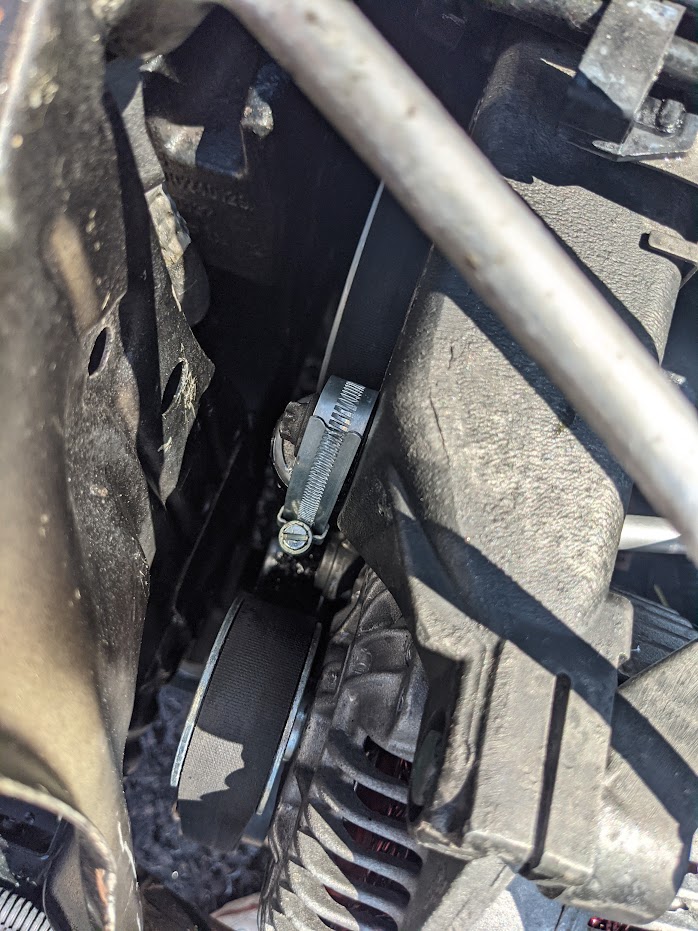

Make sure you have a strong jubilee, and a pair for if one slips.

I recently did my Auxiliary belt as I was changing the power steering pump and couldn’t get away with the Jubilee method.
I’ve done loads on my track cars but my 182 has all the original brackets.
In the end I bought the proper tool which made it a doddle.
But have a go and see how you get on. If you struggle and feel like smashing it with a hammer, have a read of my thread first. Links to the tool are in there.

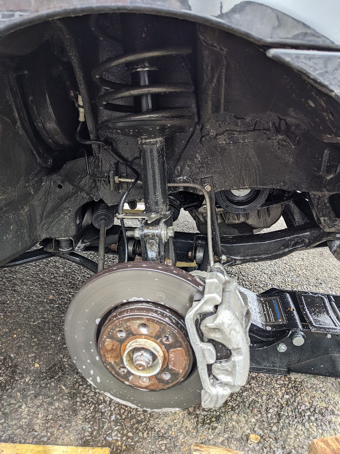

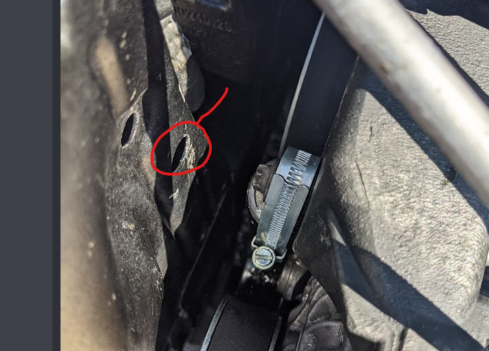

Bottom pulley through drivers side wheel arch, wheel off, arch liner out, or there might be a little cover you can pull back I can't remember tbh.
I removed the slam panel because it take 2 mins.
I had drivers headlight out too as I was changing the power steering pump which had recently exploded and covered the entire engine bay in fluid so needed cleaning.
Did you undo the engine mount drivers side aswell bud , or just remove scuttle and drivers arch to make access easier ,, thanks again

If its just the aux belt then I believe you can just fold the belt by 90deg and slip it between the inner wing and the pulley if you're worried about getting the belt in there? I cut the old one off and pulled it out, no going back 😂
However if you need to get better access to the crank pulley its only 10mins with a trolley jack under the sump and buzz off the drivers side engine mount to lower an inch or so. I don't recall having to do that though, just used a jubilee to keep the tensioner spring compressed, cut old belt, pulled it out, removed headlight which let me get a socket on extension bar through this hole:
removed the bottom tensioner bolt (allen key), fed new belt in with the tensioner and pulley completely removed, changed the bottom idler and then reinstalled the tensioner.

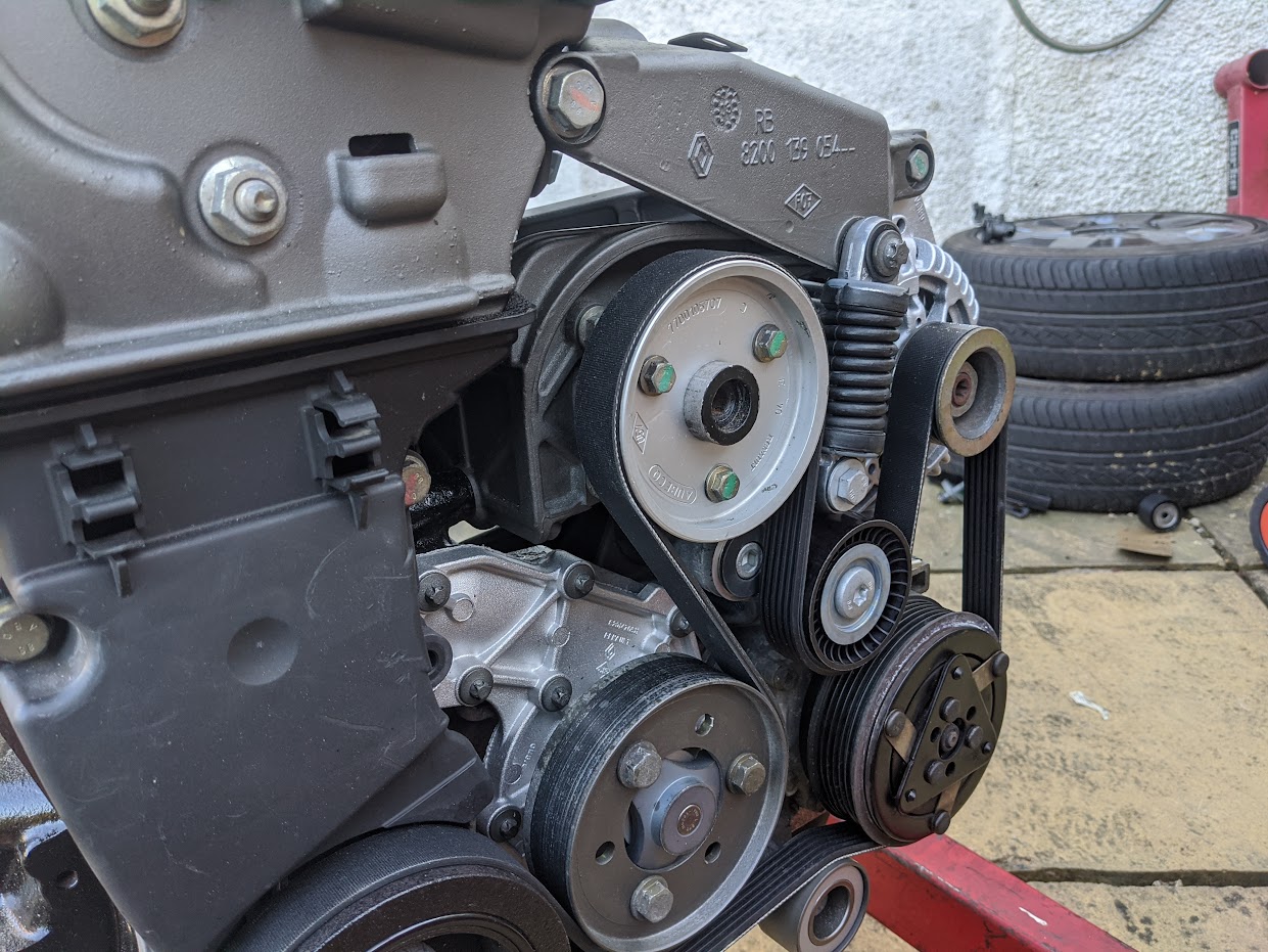

Picture of belt routing in case it helps:
Its a fairly simple job, made even easier if you buy the proper tool like Mr Underhill.

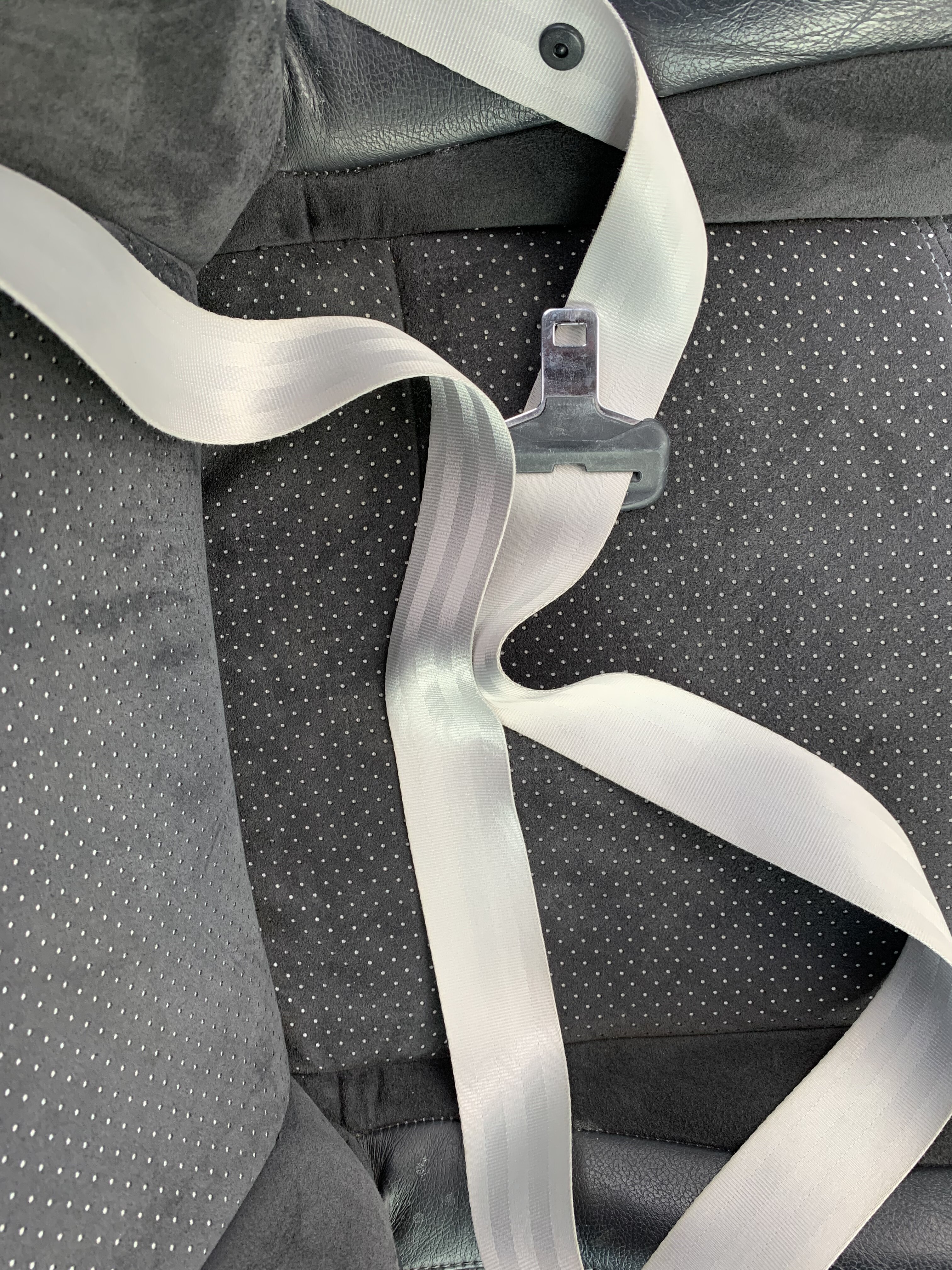

If you want an easy job to lift the interior, clean up those seatbelts, will go from grubby to a nice bright silver, makes a huge difference. A few methods on here if you have a search.

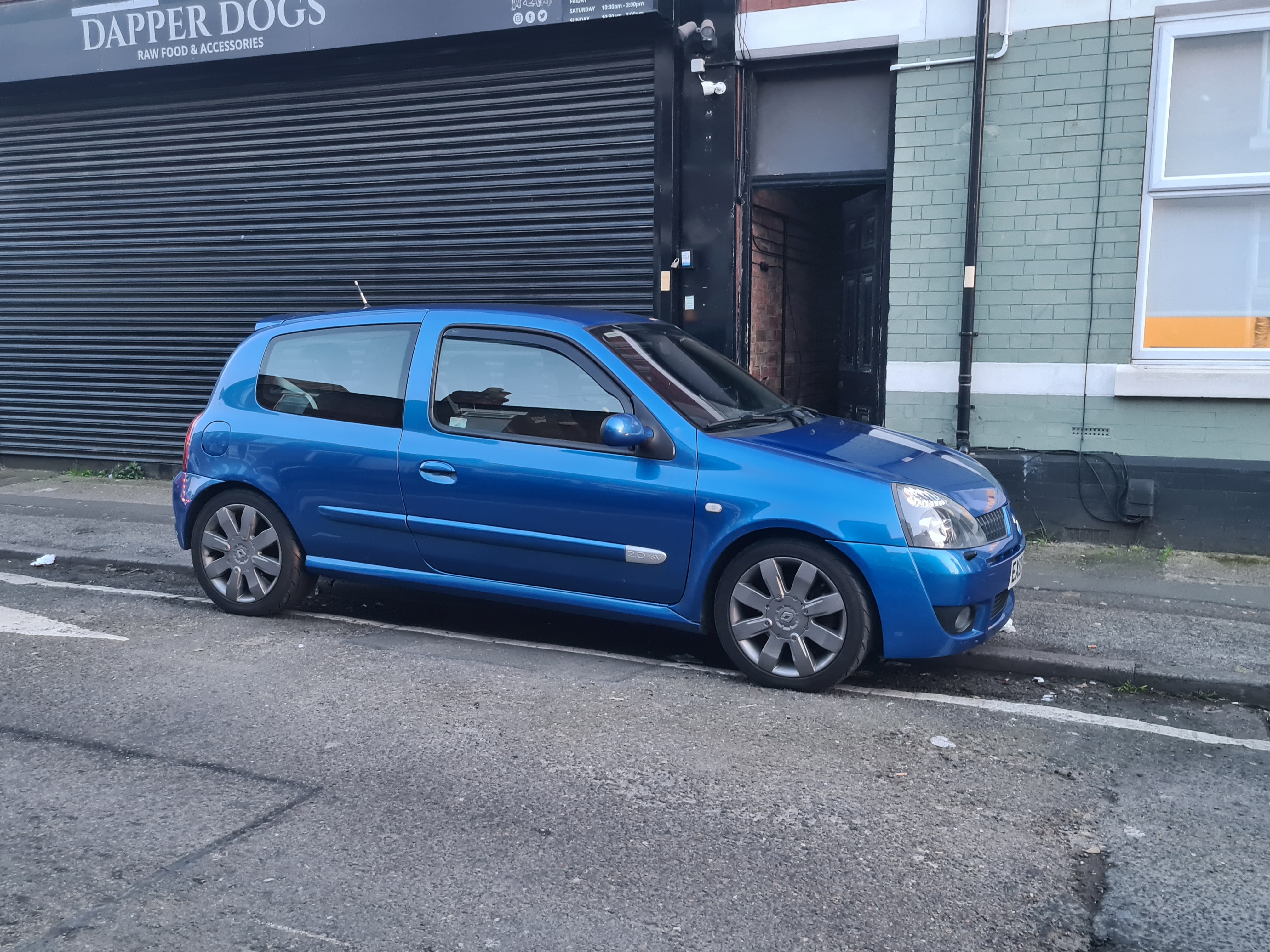

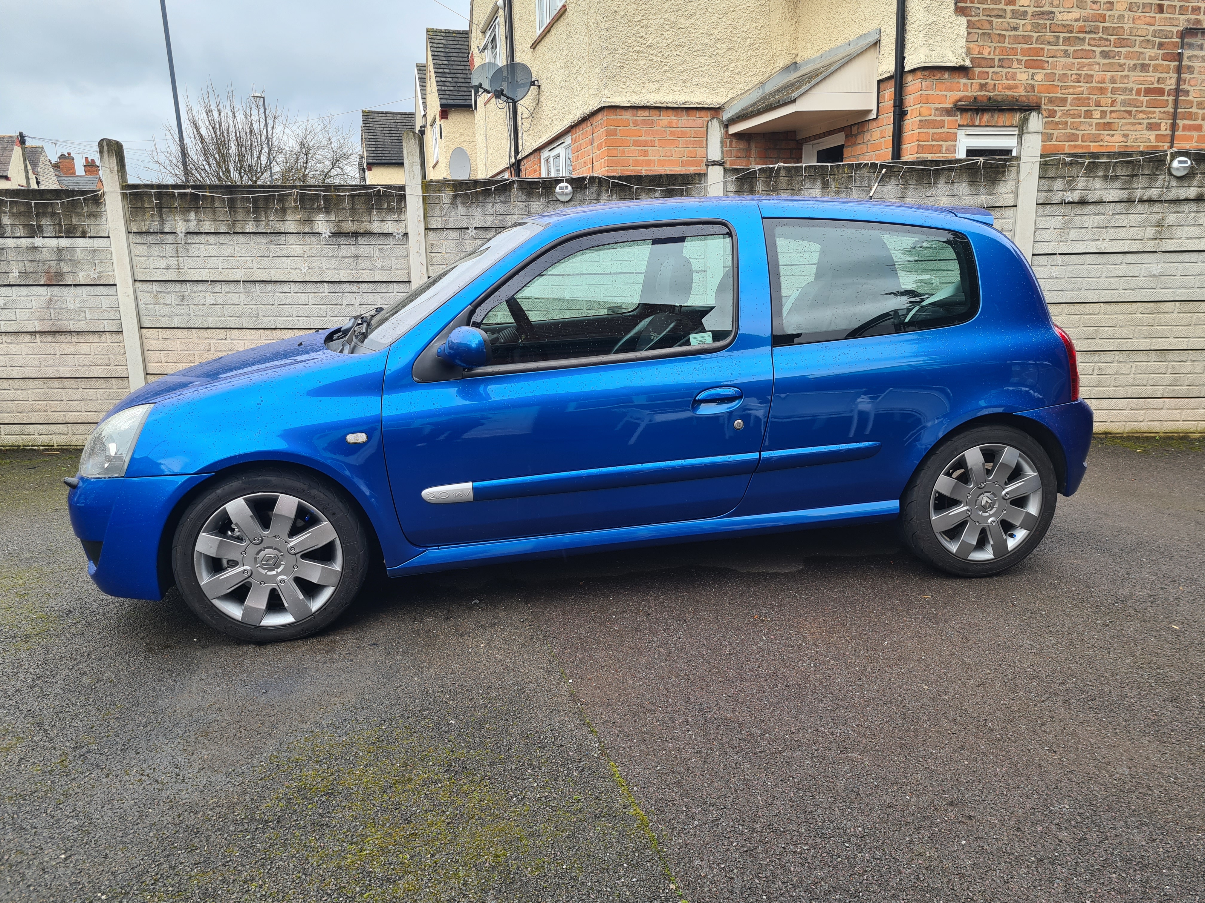

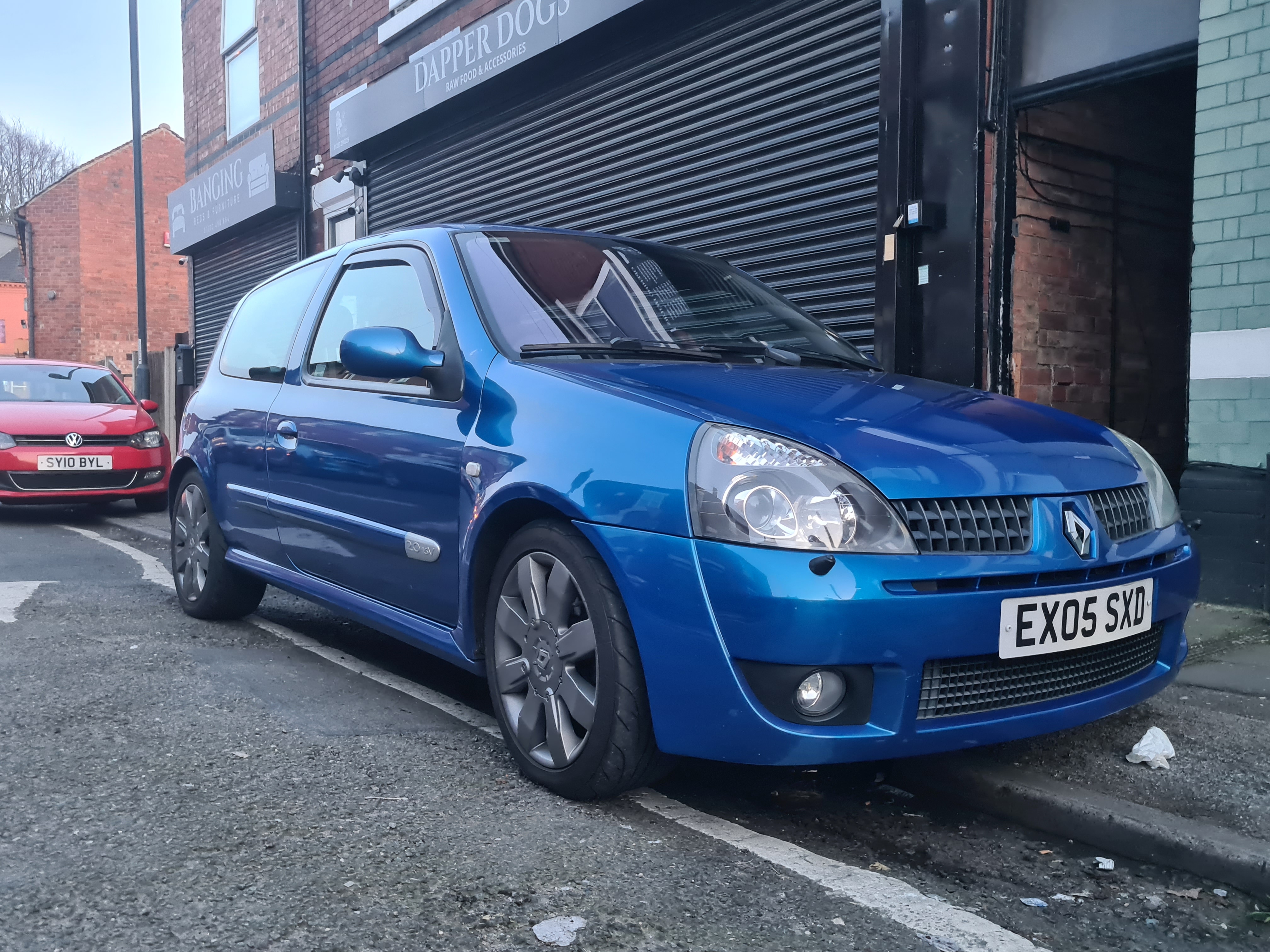

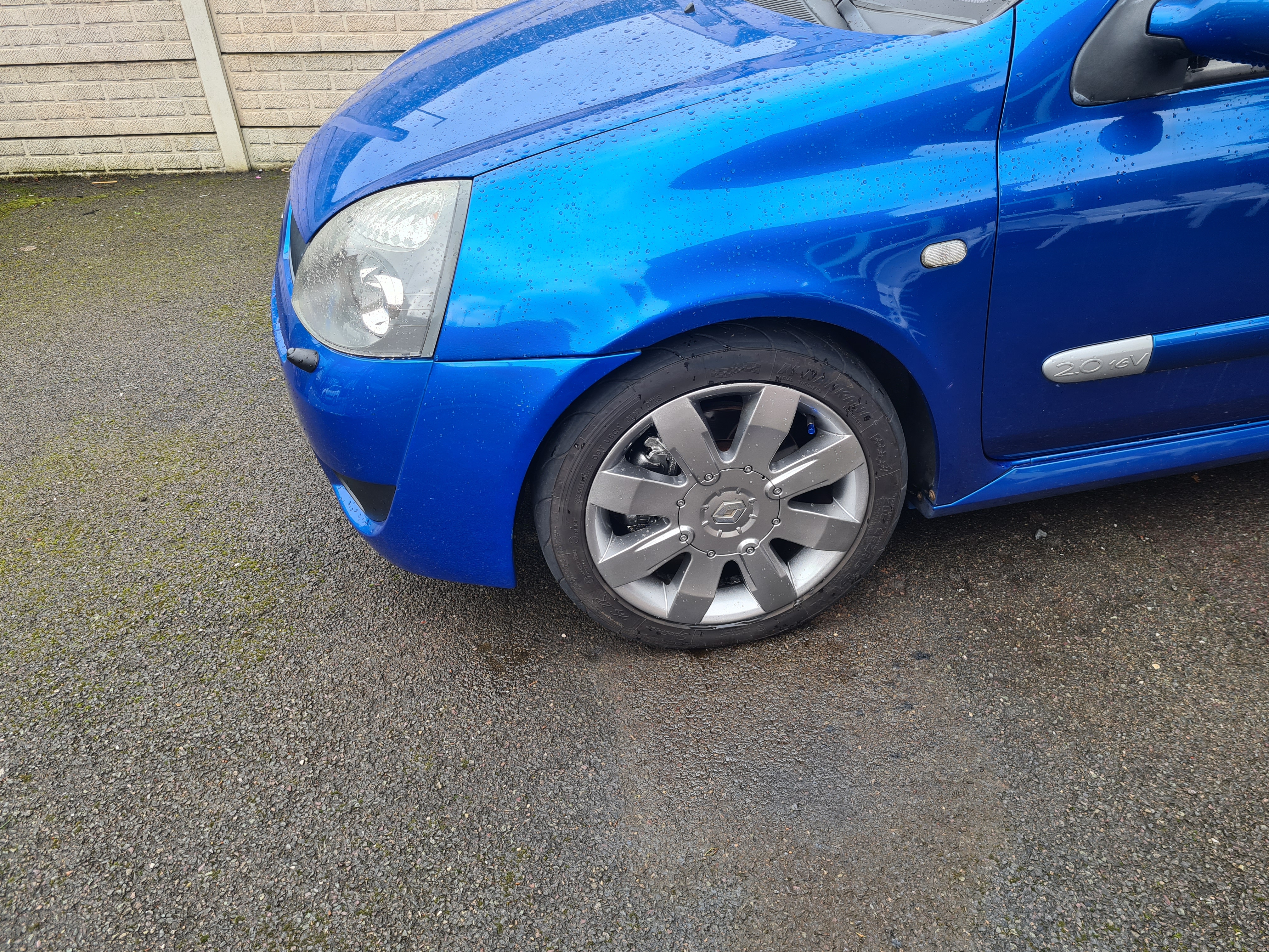

So just a little update got the car back , clutch is now lovely with no rattles , nice and light and the plus side gearbox is nice and smooth no crunches etc ,, had the aux belt done too and managed to give the wheels and calipers a lick of paint ,, done the calipers the same steel grey as the wheels ,, mainly did the wheels as previous owner had painted them but no lacquer,, either way looks much fresher now.. also found a ktr induction kit local and cheap enough at £60 so grabbed it and chucked it on 😁 did find out upon removing the airbox it already had a ktr panel filter in though
Still got a couple of issues ,, tc and service light popping up sometimes could be after half a mile sometimes after 3 or 4 miles , did have abs light but adjusted the brake switch and abs light seems to be sorted ,, also seem to have play in the steering likes to pull all over on any imperfection ,, and also still got a whining noise ,, not sure if it could be pas pump causing the whine and the play ? But saying that it don't whine lock to lock although steering feels heavy , the whine seems to match with revs rising , any ideas ?? Also wheres most common for play in the steering on these track rods or steering rack bushes etc
Anyway here's a pic on how she looks now

Great result!
They do tend to tramline more if you’re running semi-slicks or budget track tyres. I find the best results are PS3 195/45/16s. You still get the odd occasion where the steering follows imperfections in the road surface, but the ride is vastly improved. Avon ZVRs are also okay. Any quality premium tyres are ideal.
Poor steering geometry setup won’t help either. I’m still on original steering rack.
The setup from the factory is really fine-tuned, so it’s easy to alter the ride and handling characteristics if the dampers are old or aftermarket, if you fit the wrong springs, or if you have worn bushes, wrong wishbones, etc. You really don’t know what the previous owner has done.
A PAS pump is harder to detect if you’re not familiar with the cars. The steering will feel heavy, vague, and it’ll be noisy just turning the steering left to right at a standstill.
It’s a gradual decline. I got a local garage to switch mine as the noise was there all the time. Sadly, the one I switched it for wasn’t much better, and it failed on a track day, pretty much instantly after some hard corners. The fluid got hot, and it just couldn’t cope.
I bought a reconditioned exchange unit from a place on eBay and switched it myself. Night and day now.
Sadly, the more old parts you change on these cars, especially around the steering/suspension, the better they drive.
I had 2 road-going 182s. One was feral due to stiffer bushes, the other as smooth as silk to drive, but it came at a price.
It depends on what you’re trying to achieve.

I'm currently looking for non sport plastics but that looks pretty good actually so might give it a try :)
