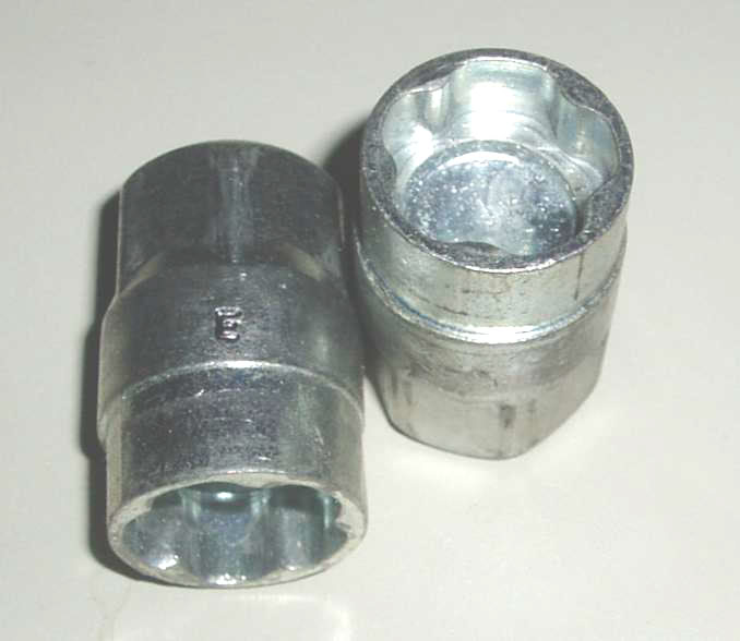

My V6 key doesn't fit so is there lots of different configurations?
lol not being funny.. bt if they were all the same... people wouldnt have any wheels left...
On a more serious note... did you get the car home ok?
my mate borrowed mine the other day... but he said it wouldnt fit and was different... maybe they are the same for the same model? but not the same for eg 1.2 to a v6
The Renault ones have a letter on , so i would imagine you need the corresponding letter for the locking bolts or as pettsi says your wheels would be easy to nick .
The set i have look slightly different and have the letter m on

agree with that as i gave 1 to a fellow cup owner , it works
Hammer a socket onto it as its the only way your going to get it off without the help of a garage....
The reno ones aren't that great anyways, get some macguard ones from halfords.

You can order new bolts though or go to a friendsly dealership and ask if you can use the keys in the cars they have on the forcourt and when you find the one that fits order it from the parts deparetment takes about a week. Some specialt dealerships have a set of all the sizes of bolts in stock and can get them off.

The V6 has them like the 172 and 182 the none RS models are all the same type.
I think that the locking nuts may not be Renault on the Dynamique as all the std clio locking nuts that I've seen have 6 points, my partners have 7 points:S
