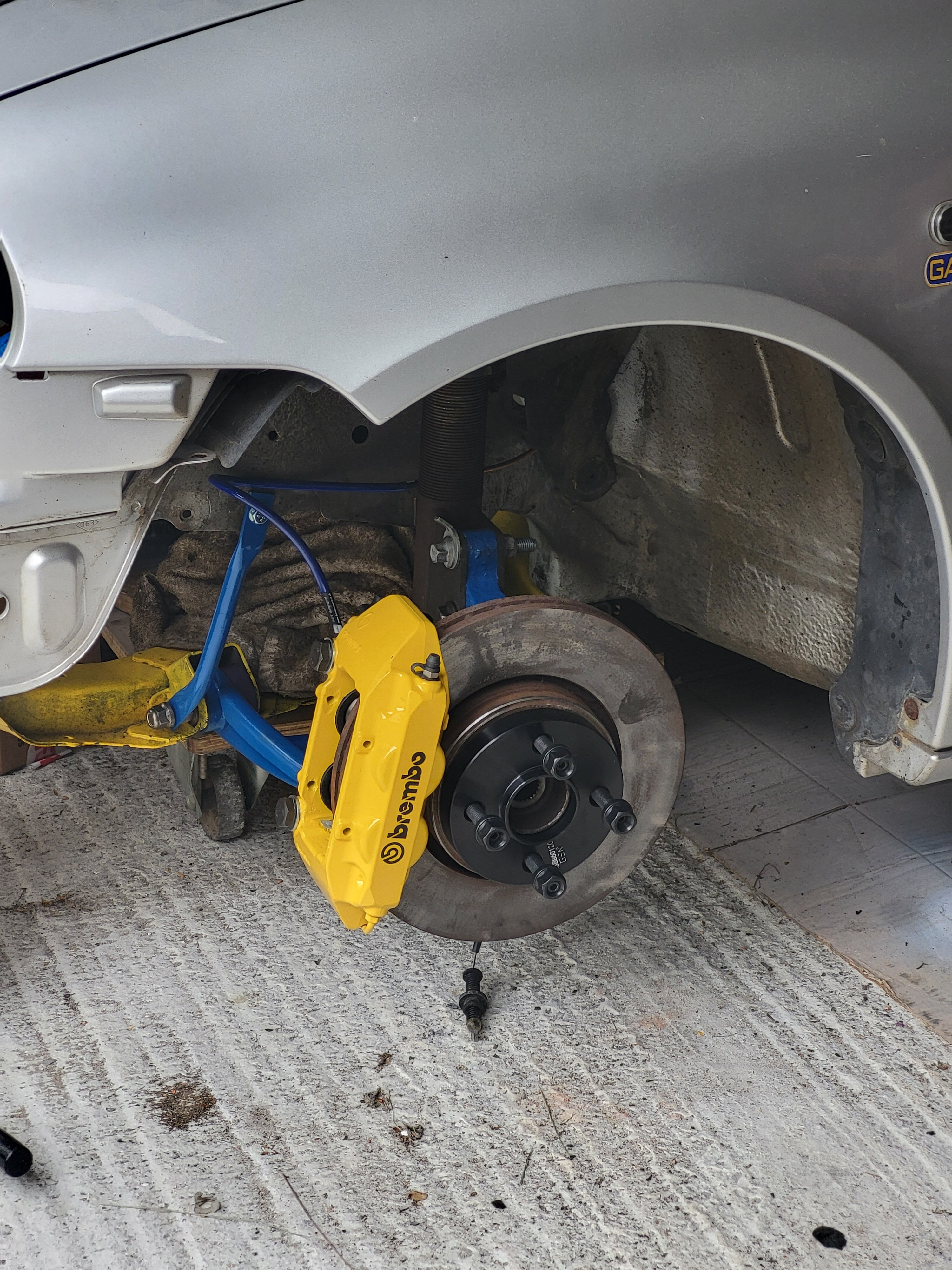

Any ideas what this could be? It's started happening during my rebuild and no idea where to start with it. It seems to happen once after being left a while then not again. Pressing the pedal (while stationary with no servo connected) there is a loud bang and the pedal jolts.
Note that the following has been done:
  • ABS removal
  • Custom brake make
  • Hydraulic handbrake added
  • Brake bias valve added
  • Rear calliper rebuild
  • Refurbished 192 brembos fitted
On this occasion it wouldn't do it again, it might be only once the wheels have moved a little it does it again. Could it be just the pads moving in the calliper? I haven't added any grease to the pads yet.

Pad sticking in the caliper then freeing off when enough pressure is applied?
Id strip the front calipers, clean up and grease the sliders and make sure the pads aren't too tight in the caliper

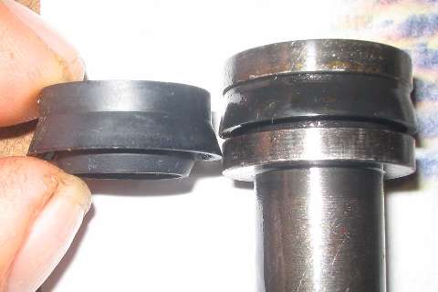

I wonder if its a seal in the master cylinder flipping over.
No sliders as they are brembos, but i might try and take the pads out and add some lubricant anywhere there is movement. They were newly refurbed recently.
2nd bank looks like pedal hitting bulkhead? Is eveything bled up fully? Doesn't look like it is?
How would the seal in the master cylinder flip over?

Master cylinder piston and seal, the seal can jump out of its groove or in some cases peel back if the bore is corroded or damaged for whatever reason.
