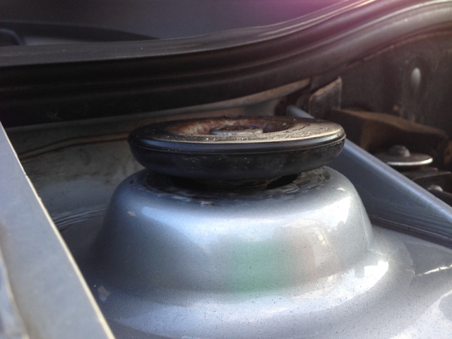

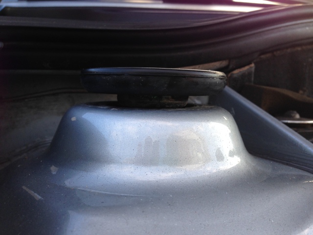

Are my topmounts broke?
Car  Range Rover Sport
Will let the pictures explain.
I'm guessing that's not normal as the passenger side one seems flush against the turret.
Yes I did read that thread, no this is when the wheels are straight, just concerned as surely that means there is 10mm shortfall somewhere in the suspension?
They just look like they arent done up TBH
There is a gap but it shouldnt be that much IME.
Do they make any noises when you turn the steering?
Those mounts are only there so when you go over a humpback bridge the shocks dont drop out, in theory you could remove them and your car would still drive exactly the same under normal circumstances (but DONT!)
They've always made a 'knocking' noise from day one of me owning it. I just thought it was down to a) being pretty low b) having cheap coilovers fitted. Only noticed it today, wasn't like that last week.
Well they are either loose (looks probable by the lack of thread showing out the top of them but TBH its been ages since Ive had standard mounts on any of our clios!) or the mount under the turret is FUBAR'ed and allowing the shock rod to come up too high.
In fact, if you look in that thread George182 linked to from here, you can see how much thread is poking through the top of the nut in the mount, so I am 99% sure yours are just very loose!
Thank you Chip, is there a way of narrowing it down without taking the suspension/coilover off?
Both the Alan key part and 'nut' extremely tight?
You need a swan neck spanner (24mm IIRC) and an allen key so you can spin the top mount without it spinning the shock rod.
Either that or just get a nut gun on it but dont let it spin and spin as it can damage the seals in the shocks.
21mm, struggling to get the spanner as don't have any 'sean' neck version however when the spanner is sitting on the nut they are extremely tight.
Looks that way, although I still dont see how they are right with so little thread sticking out the top, what shocks are they?
Cheap coilovers, I believe K-tec supplied a fair few years ago. (Raceland springs to mind *pun intended)
Well if the mount now sits higher, and the thread has always been the same above it, then something on the mount under the strut top must be knackered
