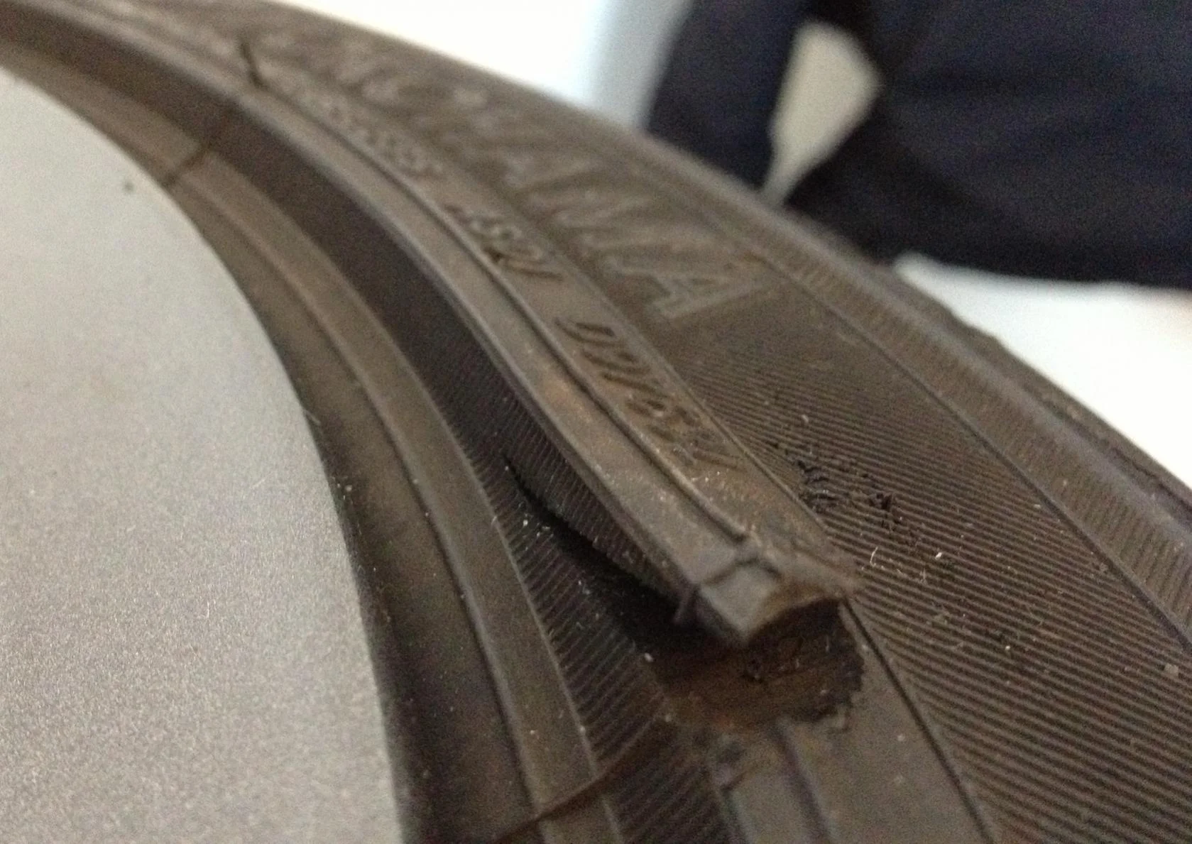

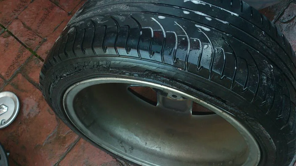

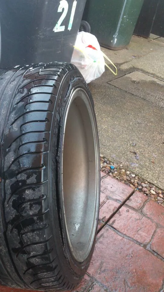

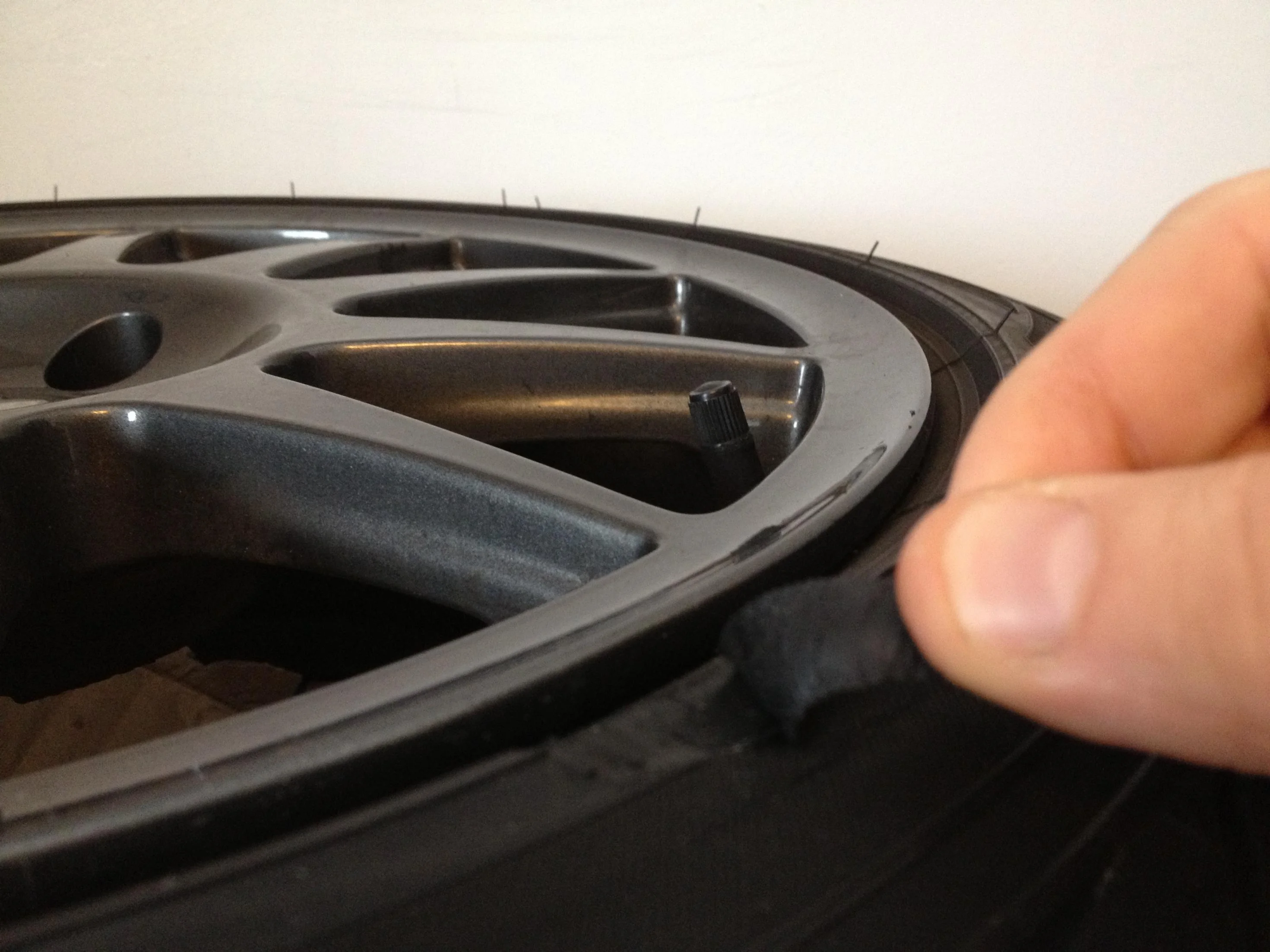

Can anyone tell me if these tyres are legal?
2 are quite bald on the inside edge (see photo), but are fine everywhere else.
One if the others has a bit of a chunk out if it. (See other photo)
shoild I get new tyres?

I'm not 100% sure about the thread wear, however the tyre with a split in the wall definately wouldn't pass an MOT.
Personally I wouldn't use them.
The one with the chunk missing is illegal.
The one with worn on insides, you might get away with it. It would really depends on the police officer on the day who stopped you. VOSA would no doubts say that is illegal though.
I would get new ones anyway, judging by that tread pattern they are ling longs or something else awful.
If that split is less than an inch it's legal. And just measure the thread dept, over 1.3mm is legal.

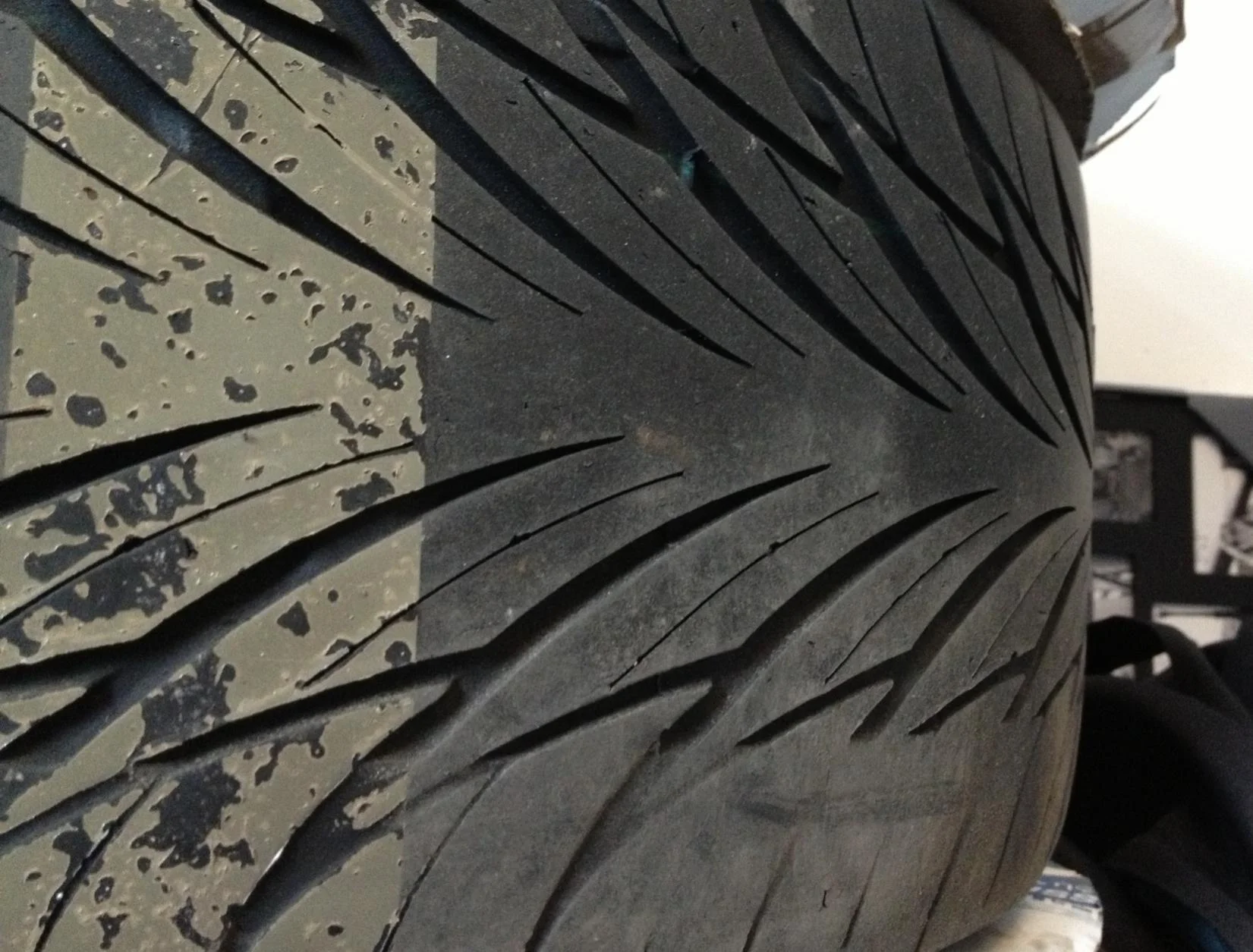

Change them don't leave them, I did that and mine ended up looking like this lol

all of those tyres are perfectly legal and fine , the first 2 have rim protector damage , 3rd is fine just the edge is feathered .
rim protector edges are just stuck down again by dealers all the time and happily pass and mot .....
the pic in the post above has been rubbing on something , yours will NOT fail in that way .

Tyres MUST be correctly inflated to the vehicle manufacturer’s specification for the load being carried. Always refer to the vehicle’s handbook or data. Tyres should also be free from certain cuts and other defects. Cars, light vans and light trailers MUST have a tread depth of at least 1.6 mm across the central three-quarters of the breadth of the tread and around the entire circumference. Motorcycles, large vehicles and passenger-carrying vehicles MUST have a tread depth of at least 1 mm across three-quarters of the breadth of the tread and in a continuous band around the entire circumference. Mopeds should have visible tread. Be aware that some vehicle defects can attract penalty points.
Law CUR reg 27
thats the law in the pic above feathered edges with no pattern on is fine

Measurements are across the centre three quarters. As long as that cut isn't down to the cords and you can't feel the cords through the remaining rubber with say a screwdriver, its good to go.
It's what keeps you in contact with the road, do you really need to ask? Any doubt get it changed.
the sidewalls don't , and have you any idea what a rim protector is on a tyre and what is for ?
they have nothing to do with structure , they stop you curbing rims and its fine to stick bits down again .
the outer edges on our s4 are worn .... they are fine across the rest of the tyre and passed the mot fine , as the tester said they are legal , i had 2 new rears fitted and the fitters said fronts needed changing ..... again , no they didn't !!
Rim protector? Mmmm no sorry I know nothing about cars, at the end of the day there is no canvas on show on the cut on the sidewall so based on that it would pass a mot so in theory is safe, but i doubt it it is above 1.6mm over the centre 2/3 of the tyre so would fail on that.
change the tyre.
I can say 100% the tyre was no rubbing this happens due to the tyres been old, they were Michelin pilot sports, and still fully inflated amazingly. It was on half the tyre not all the way arround.

Good old Michelins, they all crack really bad. Failed loads of them for split walls, cord exposed etc.

the thick strip of rubber shown in the picture is a rim protector , its thick rubber and designed to stop your rim hitting a curb before the tyre when parking
they often get cut and are safe to stick down and do not need a new tyre
if the very edge is smooth but the rest of the tyre fine then again legal and in my opinion fine
