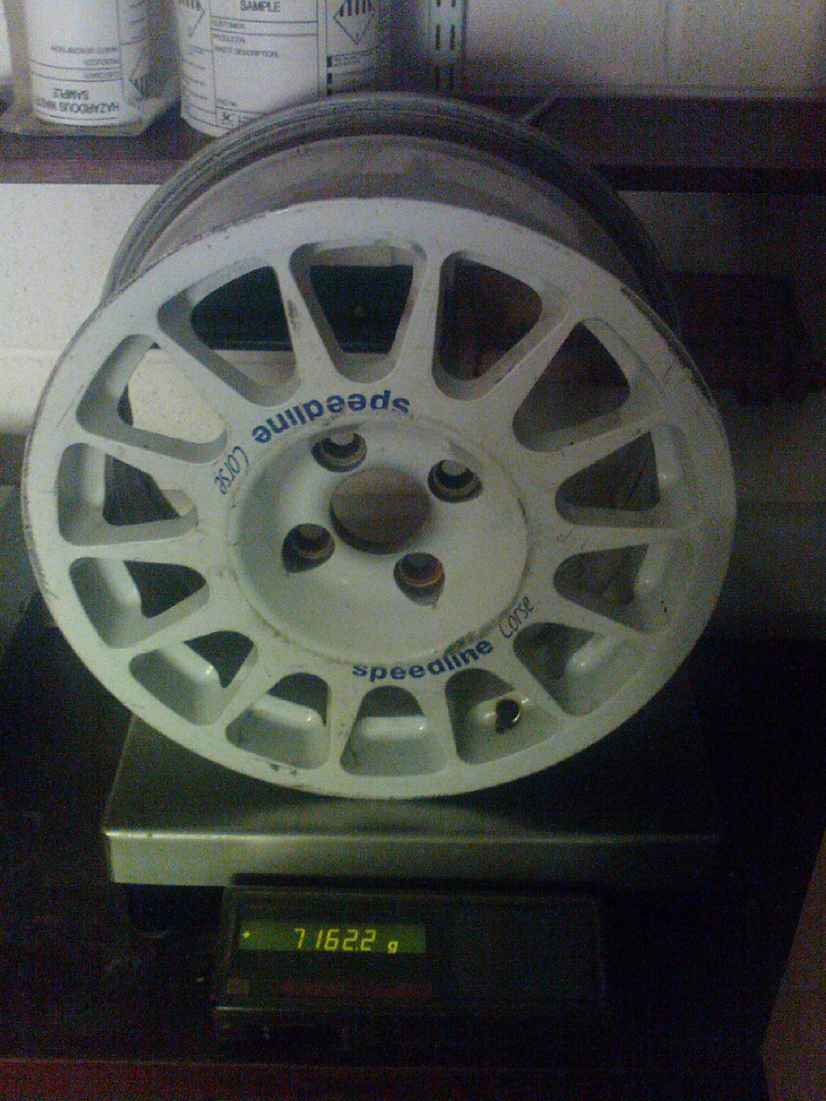

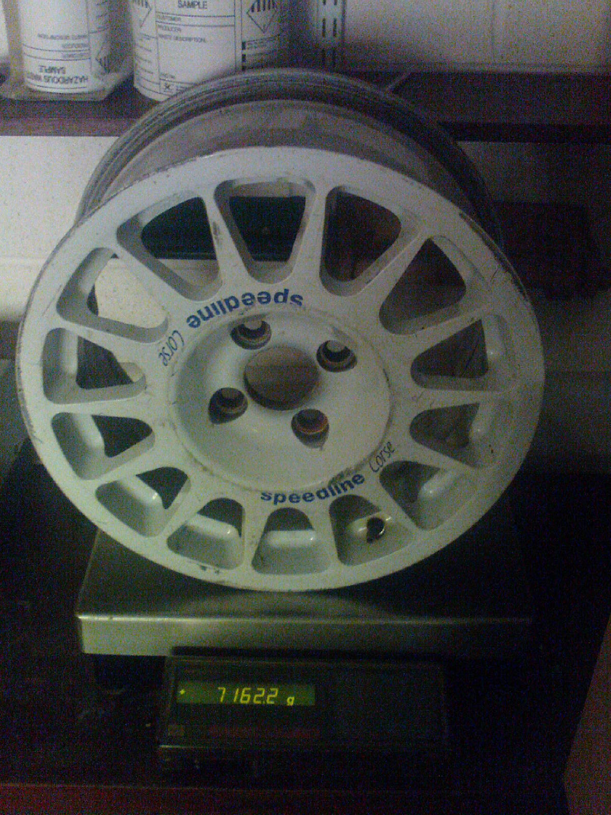

All of my cup series speedlines weigh pretty much 7.2kg. From memory, my of 'off the shelf' ET43 set weighed pretty much 9.4kg.

Yes, both sets of phase one (blue decals) & my set of phase two (embossed) cup series rims all weigh pretty much dead on 7.2kg. As you say they're ET48.5, have a different spoke depth and no ET stampings.
My palmersport/whatever that speedline currently sell with the ET stamping on them weighed around9.4kg yes.

If you look at the image I attached, it shows the weight. I'd imagine yours should be the same if you've recently bought them from Holland. :)

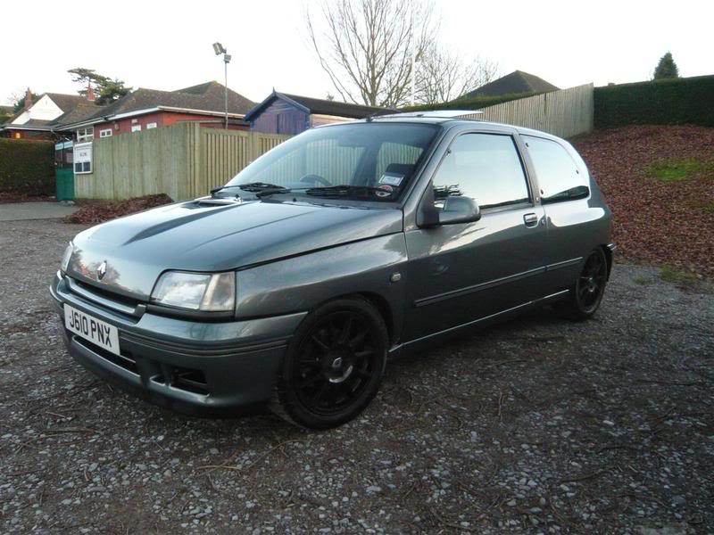

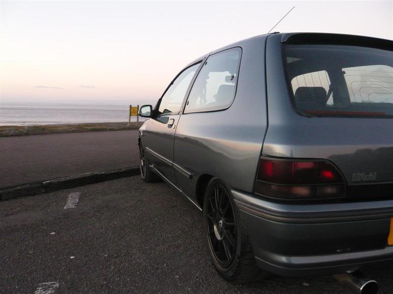

Coops Mk1
  Lots of Scrap...
they bulge a bit but look good still, laine wont mind the picture pilfering I'm sure ;)
