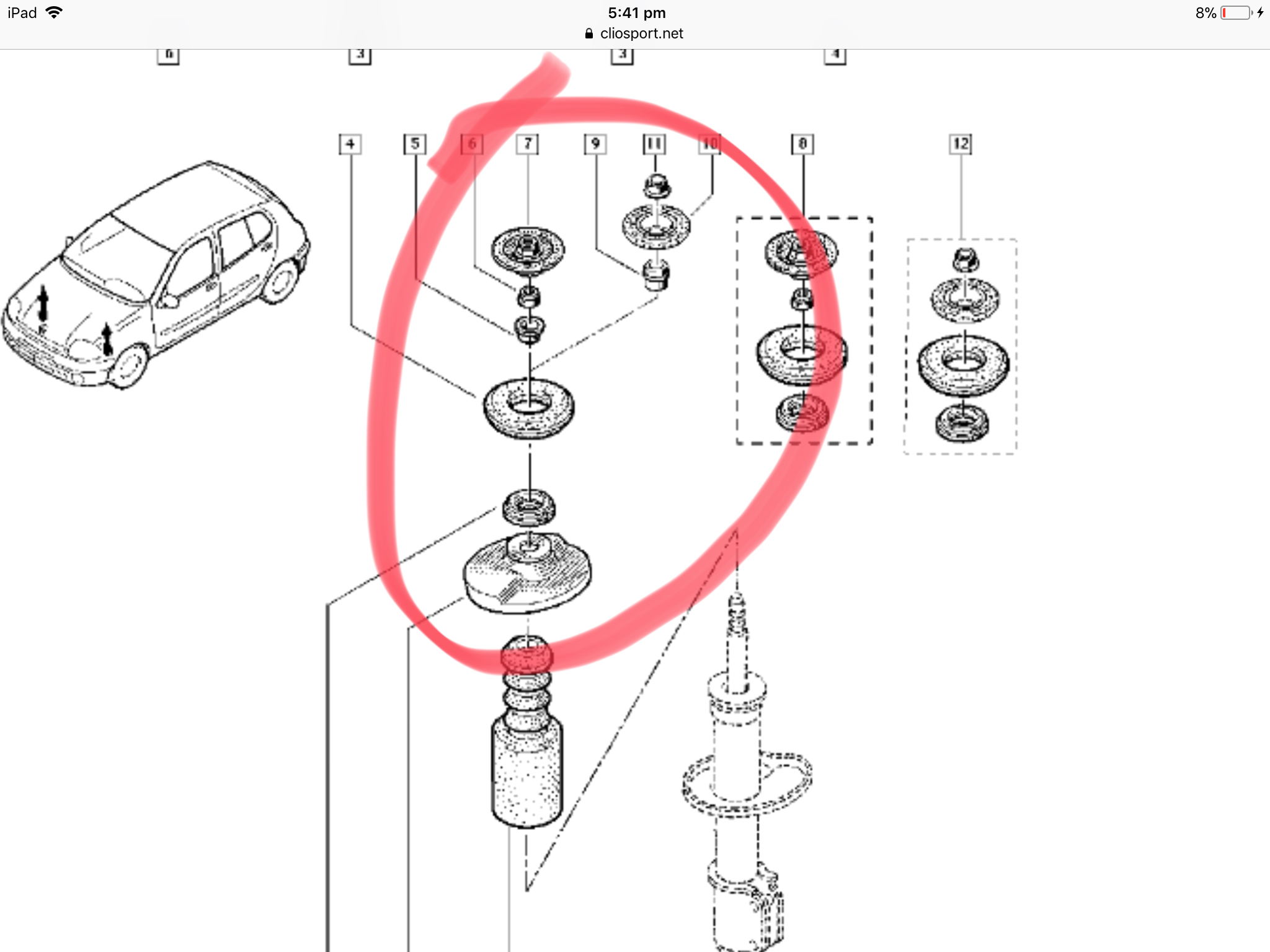

The Beardo Car Kangoo 182 Mar 30, 2018 #1 im about to refresh all my suspension and I’m need ing the bits circled in the picture, just wondered if they are the same on both 182 and 182 cups?

STEVE.M Car PH2 172 Mar 30, 2018 #5 No, you do not need 9/10/11 which are the modified parts that have caused so many people problems. 5&6, the spacer & 17mm half nut are no longer available, so reuse the old ones and get 2 of these kits. https://www.ebay.co.uk/p/Febi-Bilst...37597/1428599220?_trksid=p2047675.m4096.l9055
STEVE.M Car PH2 172 Mar 30, 2018 #6 I just noticed that the listing I posted is for a BMW, but don`t worry, as the listing has been edited since I saved it. 37597 is correct for a 172/182 all models https://www.ebay.co.uk/itm/2x-Top-S...493652&hash=item3611d7e5d1:g:5jUAAOSw03lY6nwW @The Beardo
