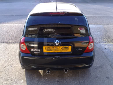

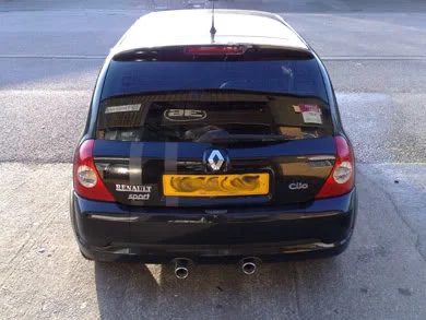

pics below are of a clio sport with 70% on the front which is legal and 28 percent on the back.
in pic one you can see how light the film is but in pic 2 from a different angle looks darker its because the back is dark so no light is coming into the car making the front look darker
pic 1
pic 2
Ok mate I work about 6 miles from your company! Why only 28% on the back? Will 70% allround look good? I have a black mk2 172?

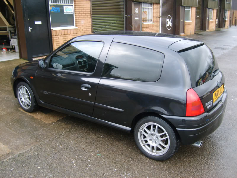

this one is 70 all round but the car had slight tints on the back to start
you will notice its been done but its not in your face dark
