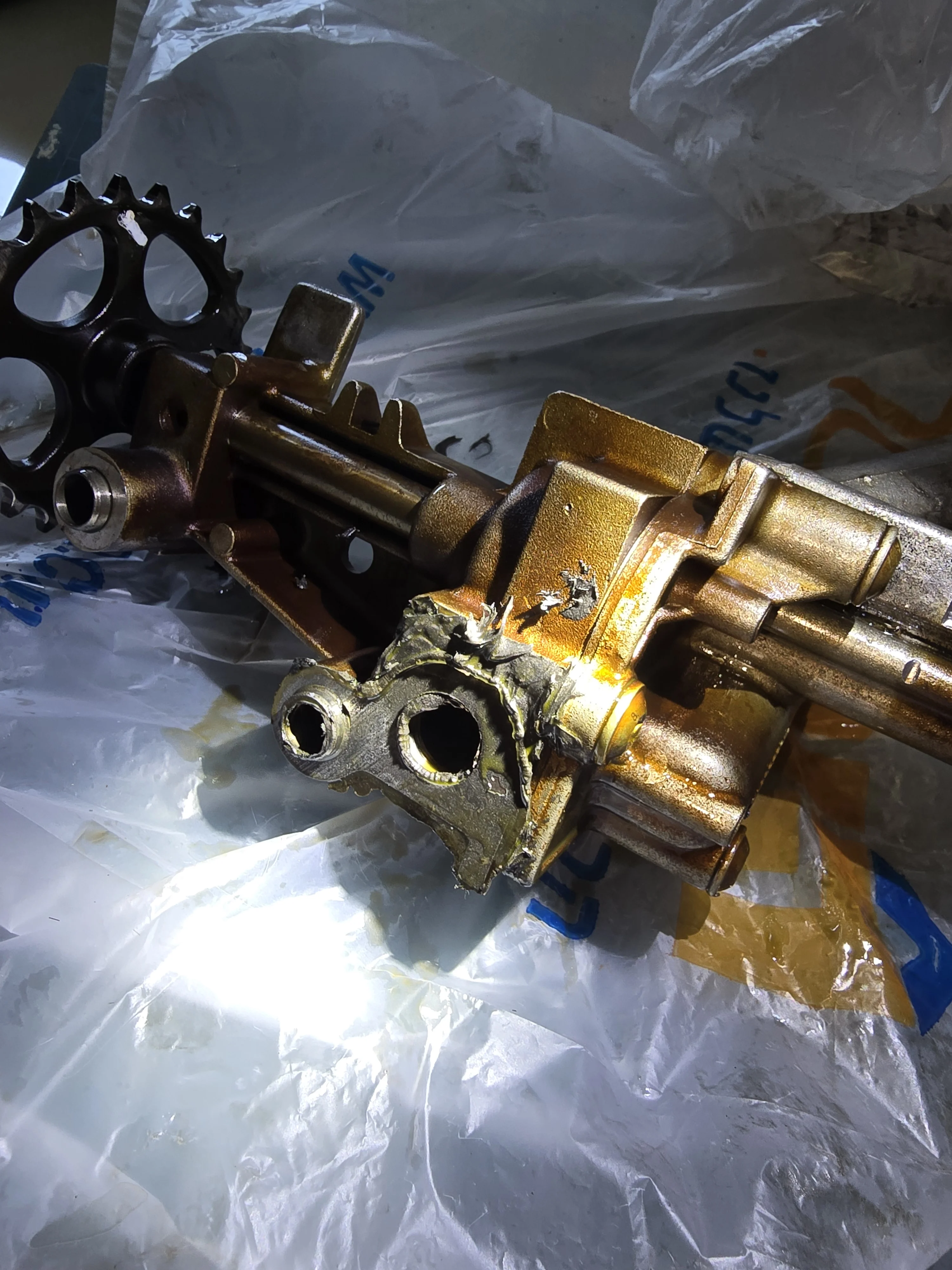

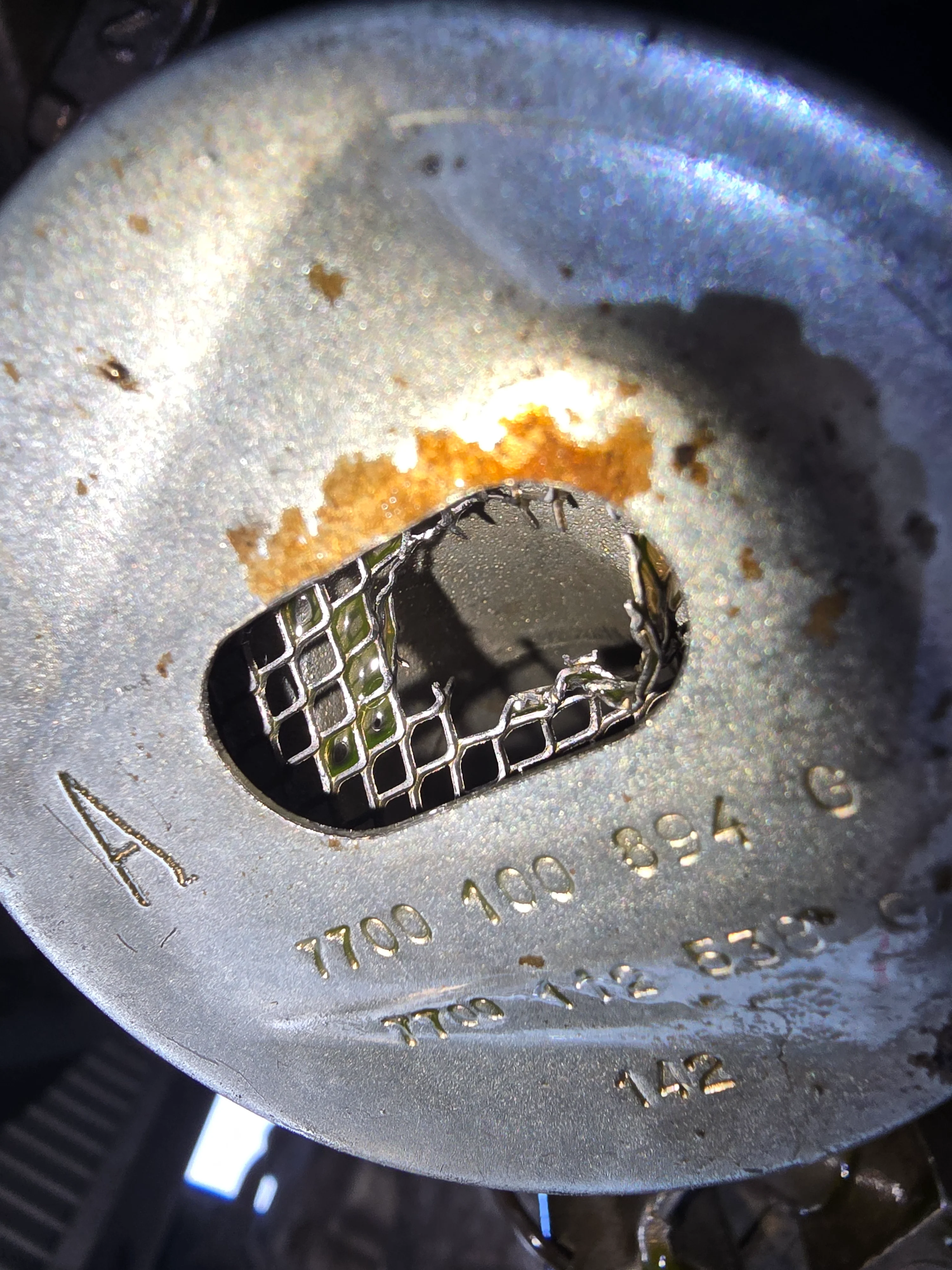

Thead revival, looking to replace and upgrade the oil pump on my 172 ph2 (my pump attached). No idea how the mesh filter got punctured.:unsure:

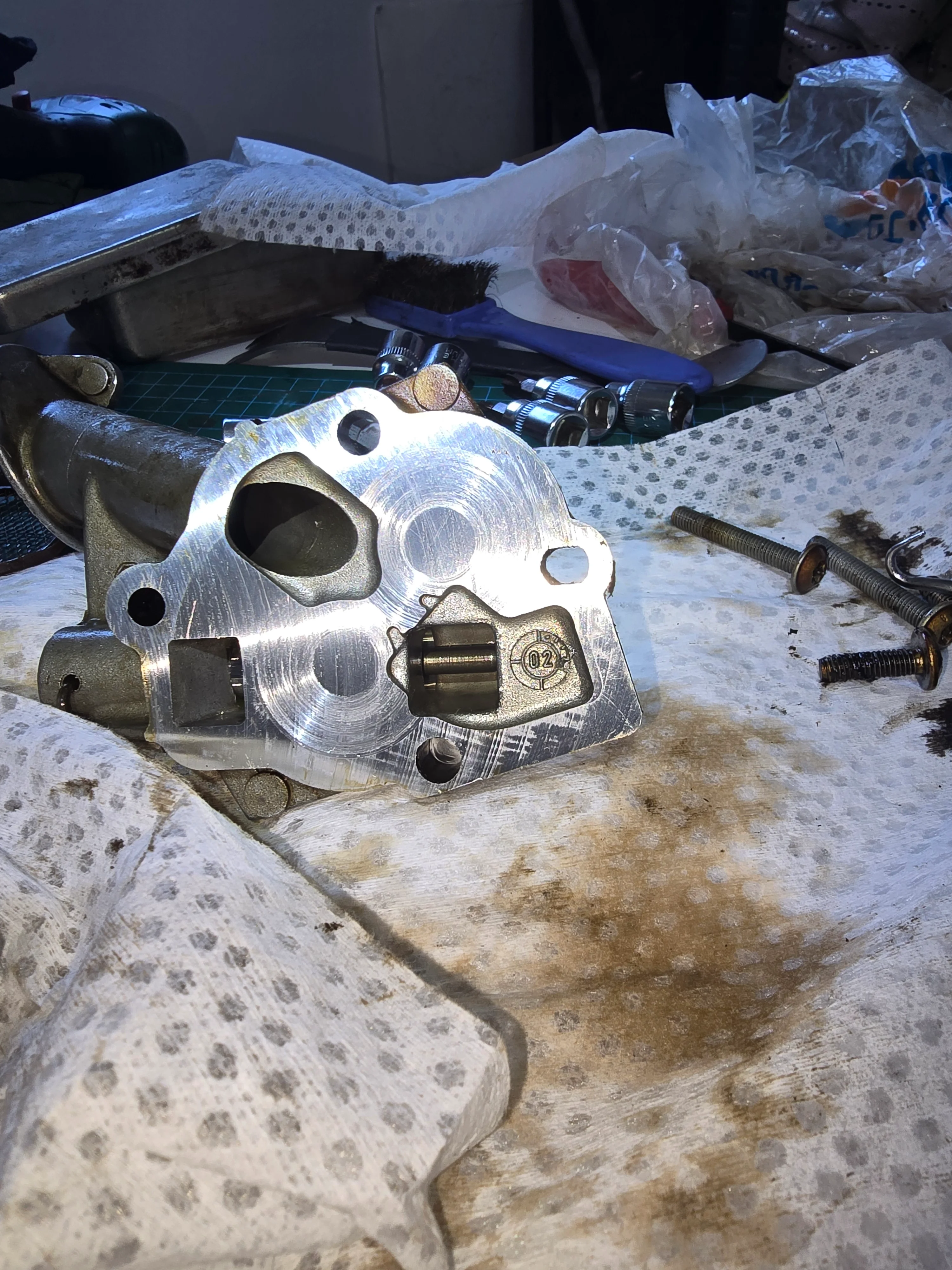

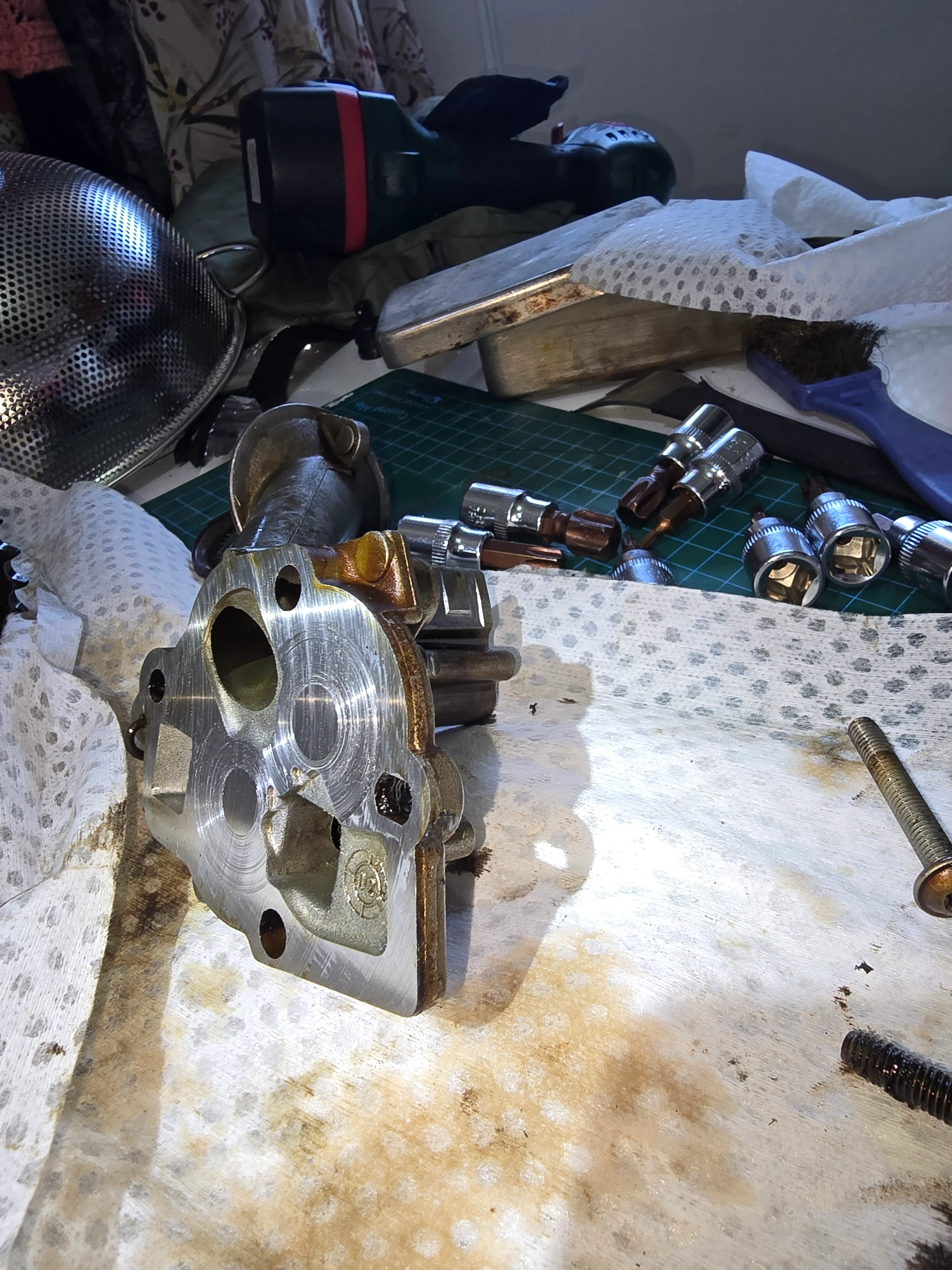

The upgraded pump oem:
150108716R
The windage tray that works with it:
8200394655​

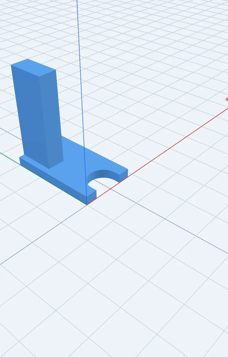

The fitment mods required:
1. Manufacture the bracket as shown by @PerthRS - cheers, mighty helpful!
