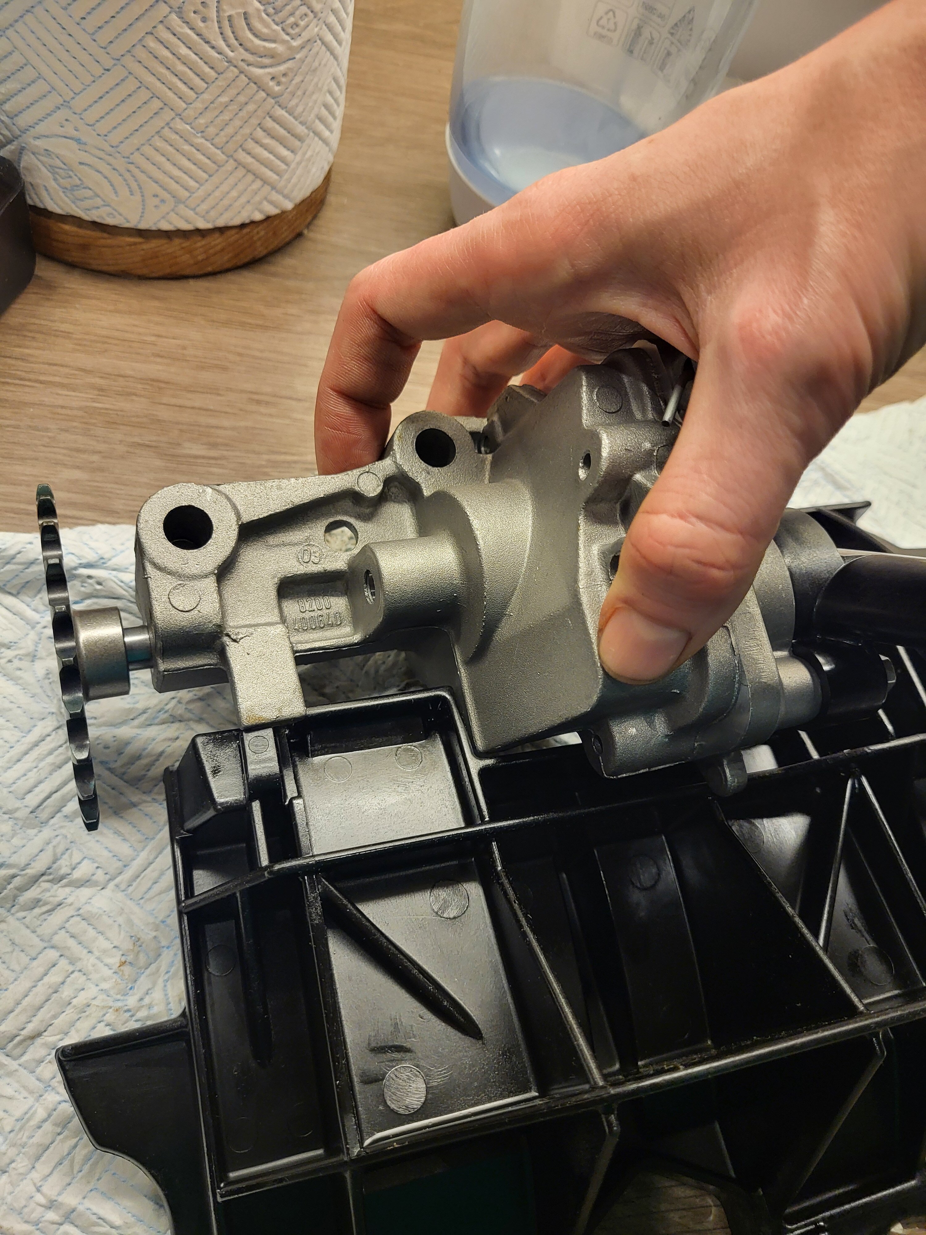

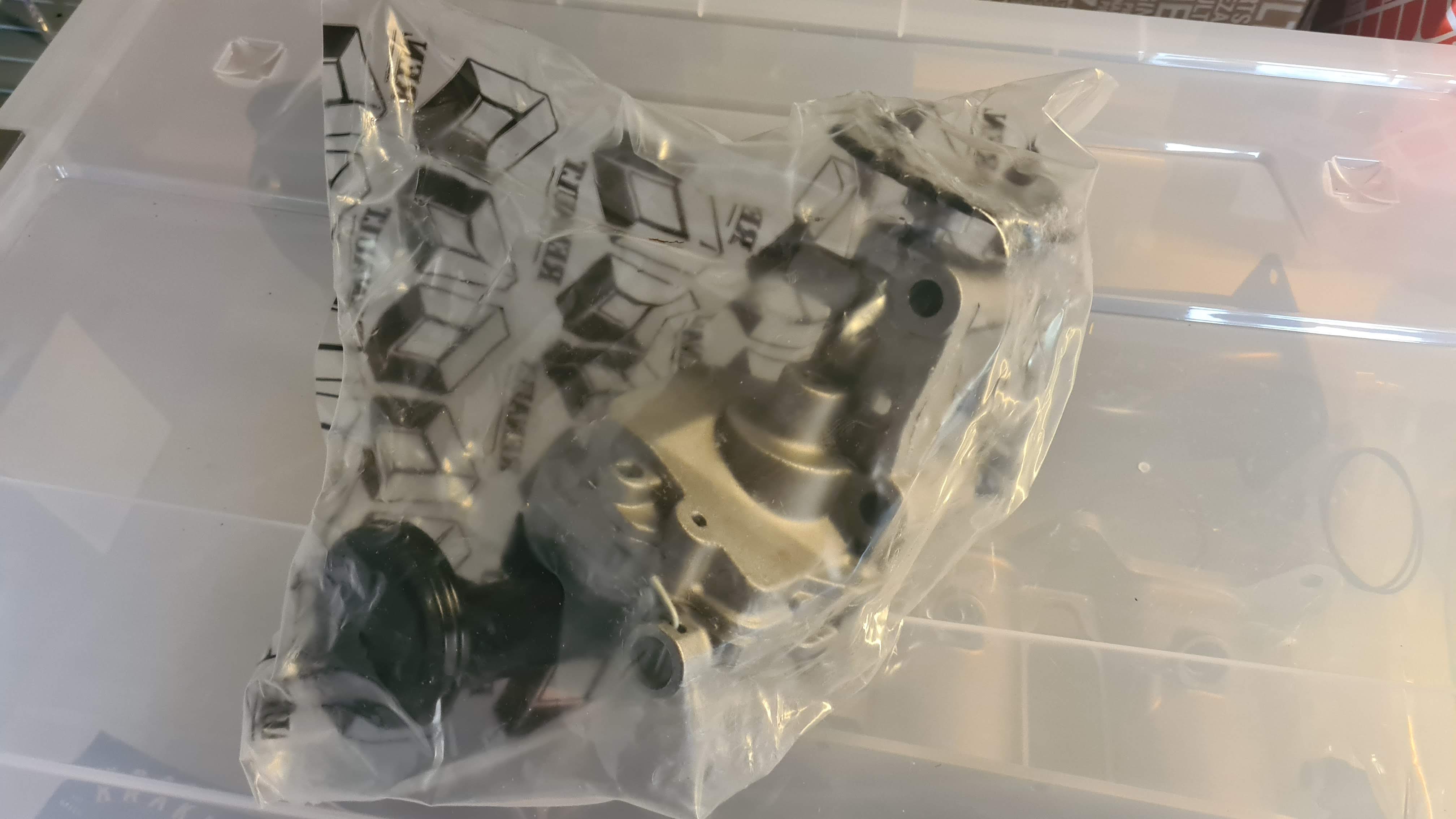

Part number is 150108716R

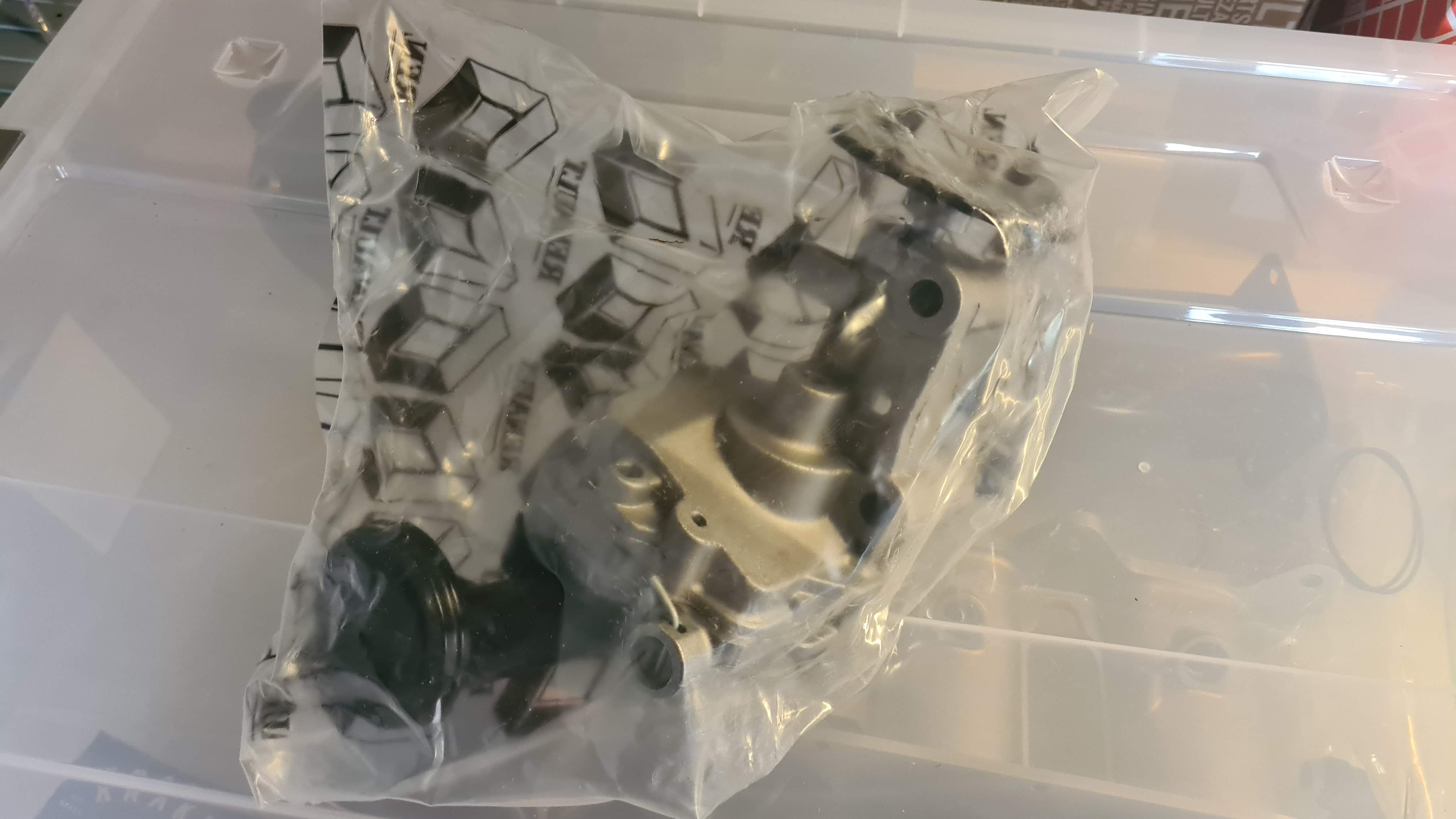

Picture below (haven't pulled it out of the bag yet).
It is a physically larger unit. With the oil pickup tube being plastic. Rather than being part of the Alu casting (like the standard pump).
The pickup does reach a little further down. So the sumps internal strength webbing will need to be shaved down to accommodate.

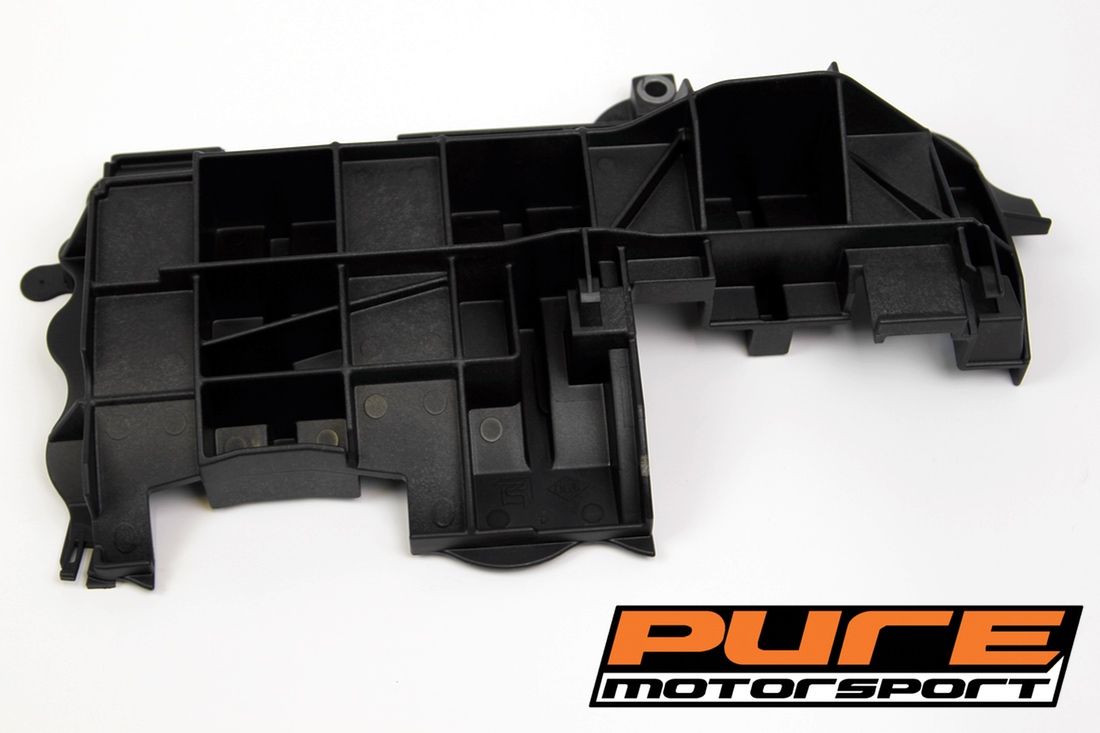

Can see more pictures on PMS's listing: https://www.pure-motorsport.co.uk/larger-oil-pump-kit-clio-2-3-megane-2-3-rs.html

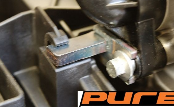

Looks like the PMS kit has an extra little part to it. Does this mean you can't just order the pump from Renault? The cost difference between that and the PMS part is significant.
Looks like its the tab for supporting / locating the plastic tray. Frogjam's website mentions it
Fitting this pump does require modification to the sump pan - some areas need grinding away in order to achieve sufficient clearance for the oil pickup. Similarly you will need to fabricate and fit a small bracket in order to secure the plastic windage tray as this pump does not have the same locating tab near the oil pickup as the F4R oil pump. For this reason this alternative pump should only be fitted by an individual with sufficient skill and experience to perform such modification.

Plus no faffing about needed to fabricate that windage tray bracket. As PMS includes it with the pump.

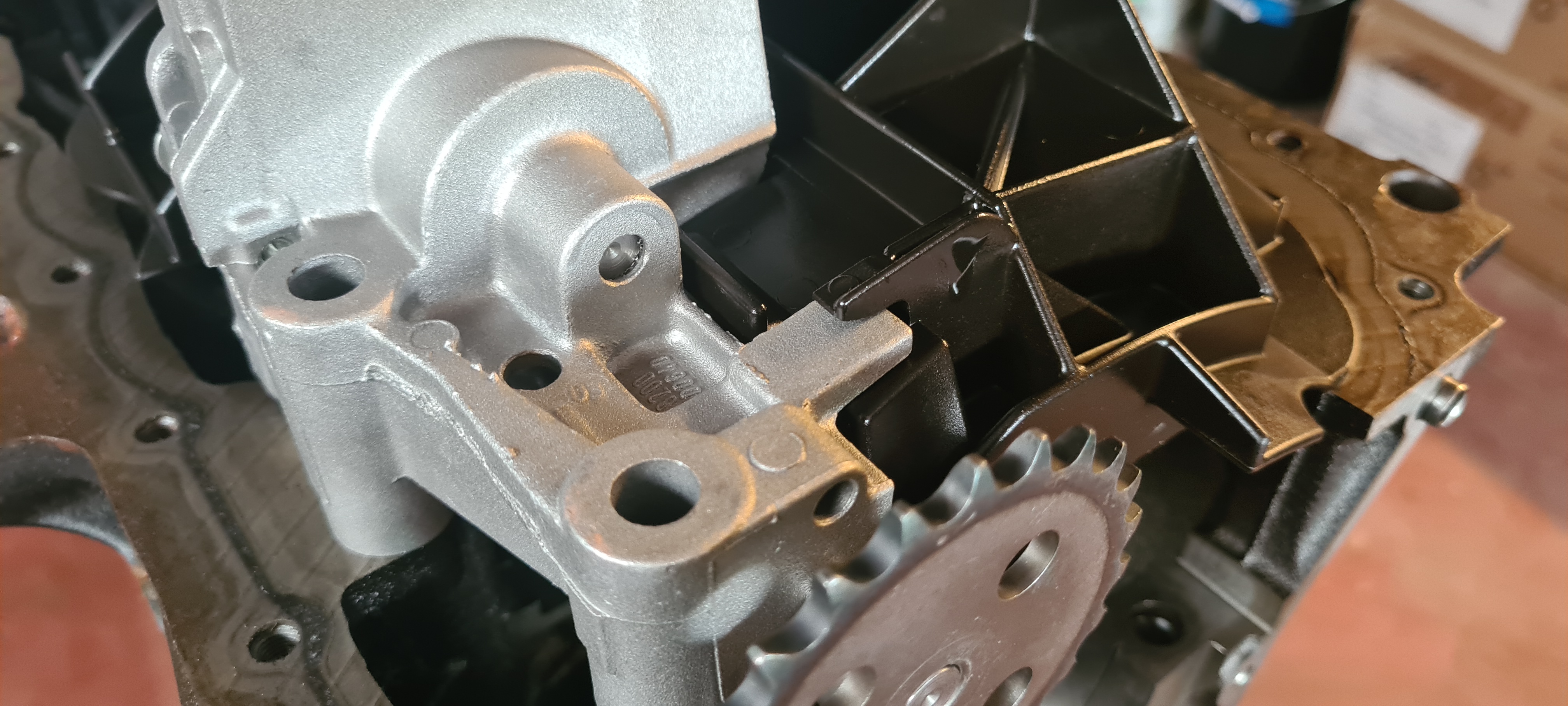

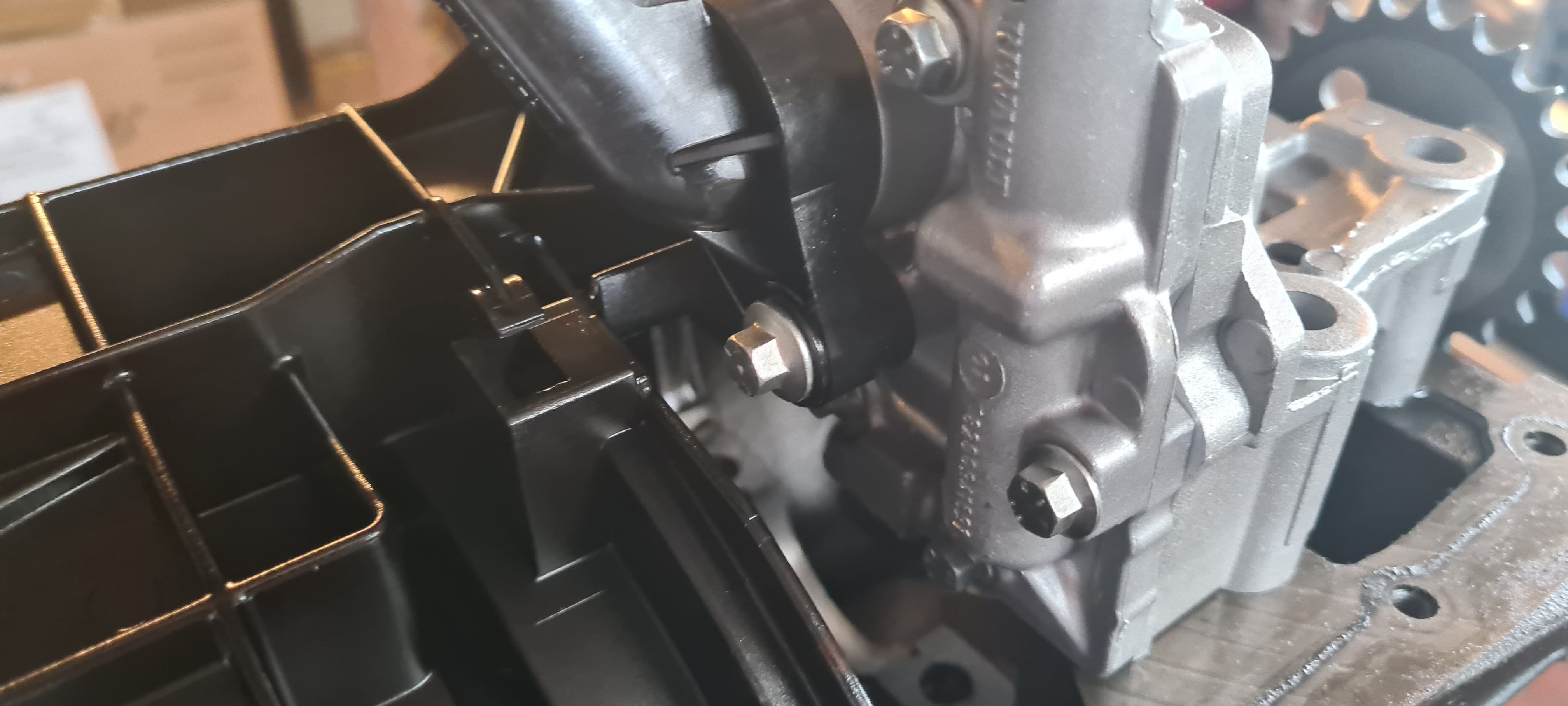

Im just attempting to fit the plastic windage tray following fitting the larger oil pump. The tray fouls on the oil pump before it even gets near the mounting lugs or hole.
Anyone else came across this issue? Iv contacted PMS to see if theres been a change in pump design or what the crack is. Frustrating after waiting all week for it

Think I saw your Facebook group post. After referring back to the PMS sample imagery. It seems your windage tray is slightly different :unsure:
I've got a bare meg 3rs block with tray in the garage. Just did a mock up fit with the bigger pump. No issues lining it up and with no fouling. Retaining clip/provisions are the same as shown on PMS's website.
Dont know if the 182 tray is the same, as still yet to remove my sump.
Is it possible ph1 trays are different?

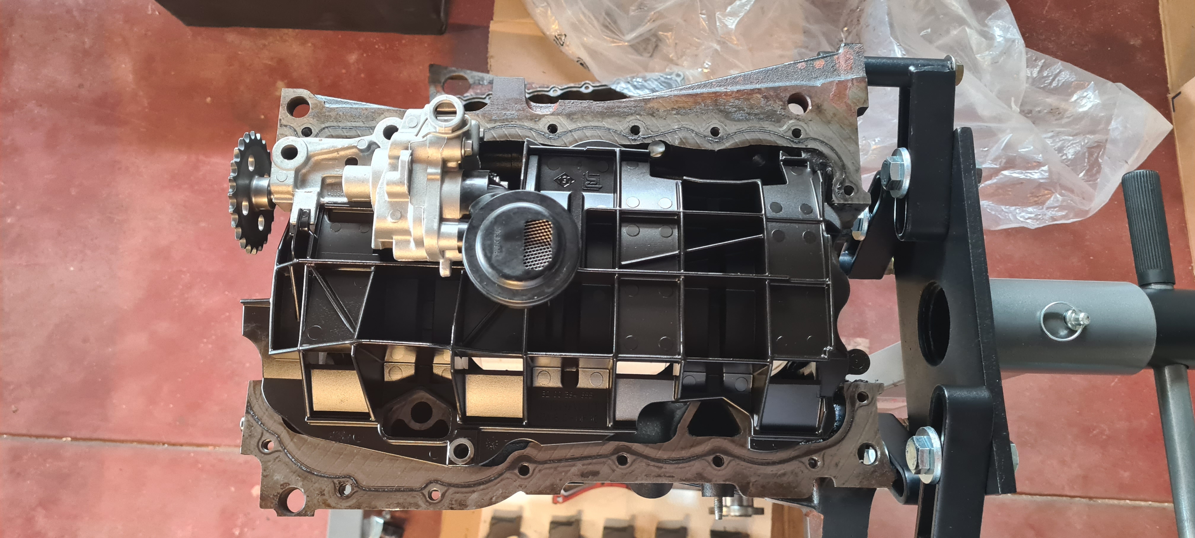

Here are images from the mock up test fit (supplied bracket not installed):
Seems like PMS sell the windage tray that matches the one in my photos and the one shown in the oil pump listing:

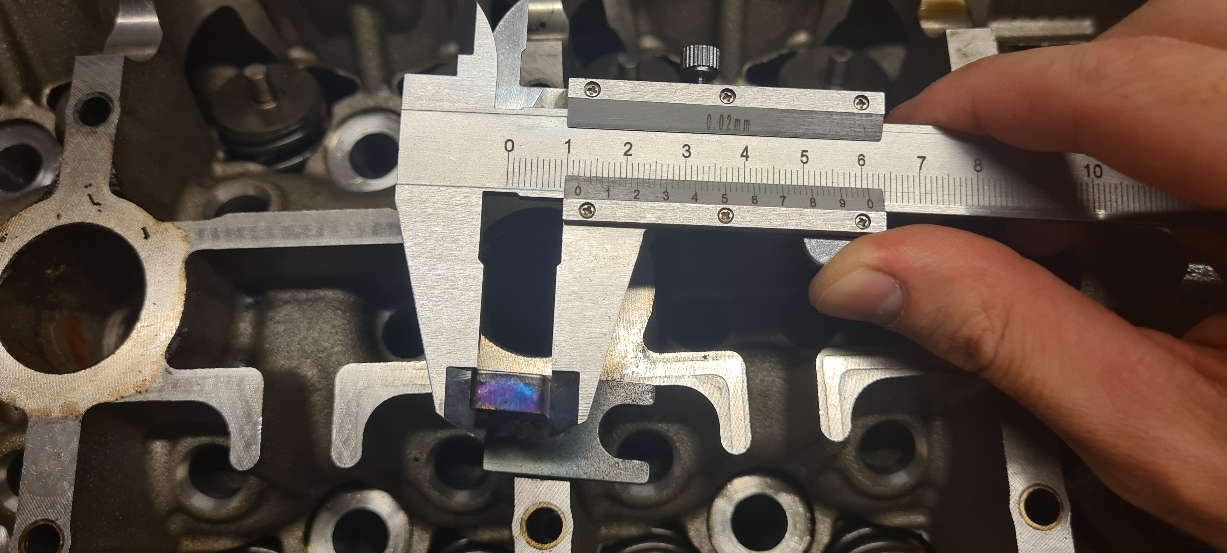

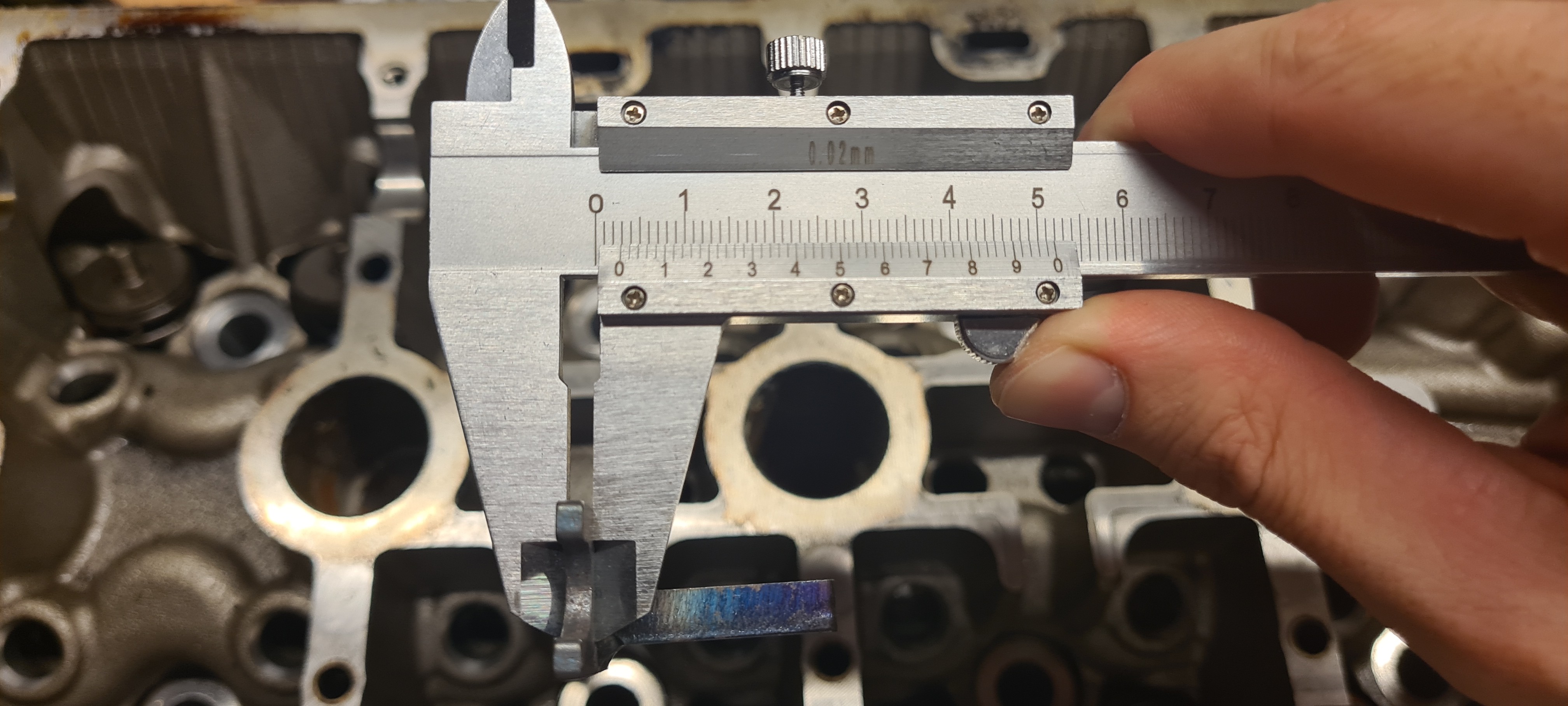

Cheers for the reply, I modified it last night following a few others saying they had the same problem. I started to think Id ordered the wrong pump or something.
Nick also replied today and says it seems to be a lottery with the trays, some fit straight on and some need some fettling. Bottom end all built up now & sump back on finally. Now to take the top end to bits

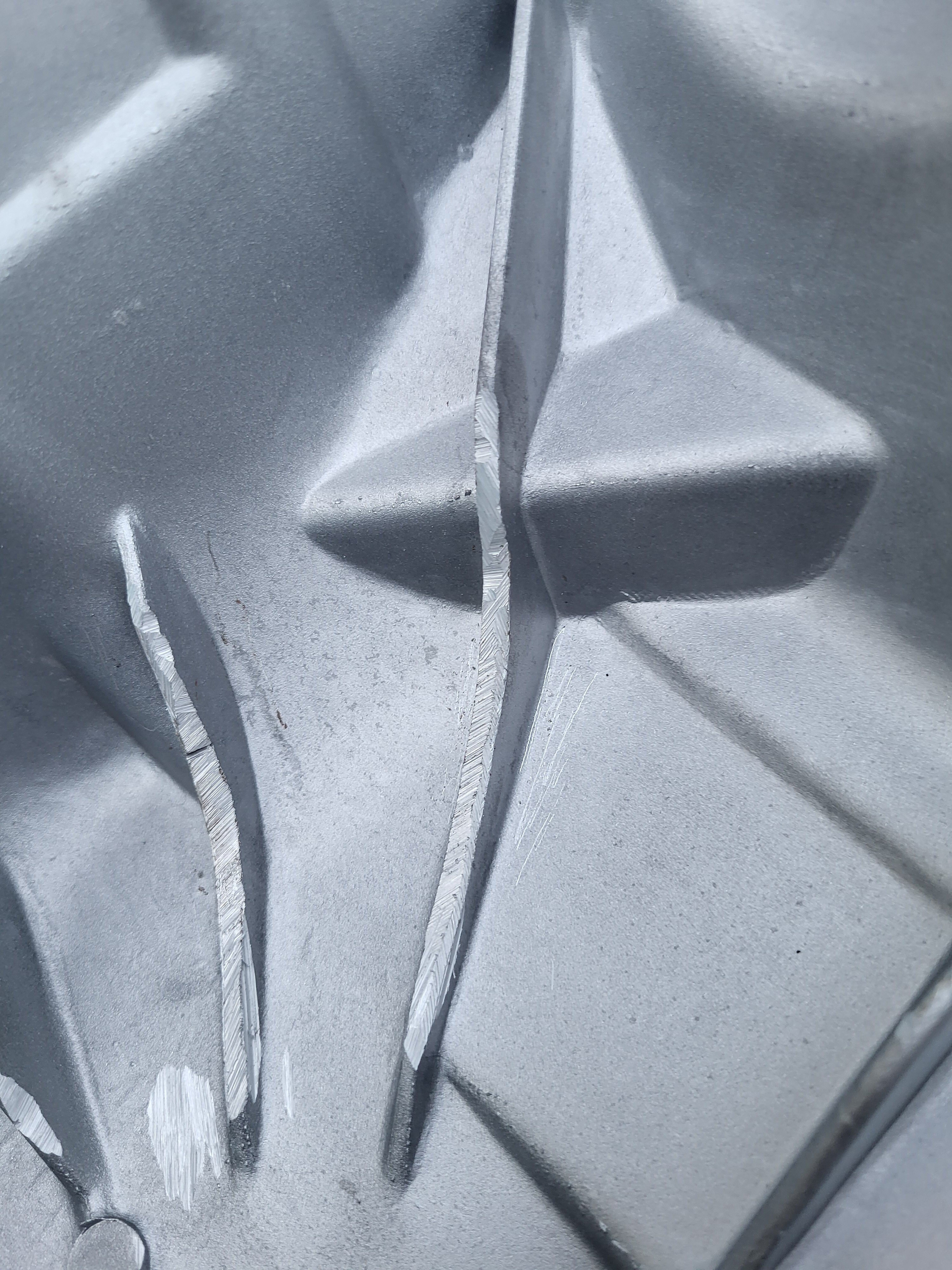

Also I started to hack up a new sump (assuming my old one will get ruined when I get the bolt off)
To those that have done this before, does this look ok for the trim inside?
Probably a good idea, I've got them for the grinder but wouldn't be able to fit it in the gap. Will invest.
Got this as a pattern part from frogjam, there's quite a few sharp burrs on the inside I'll probably take off while I'm at it.

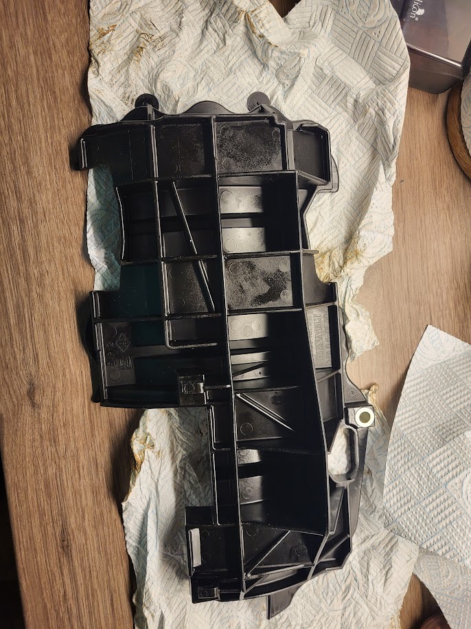

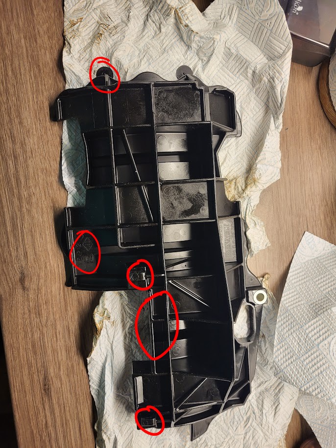

I think I may also have the wrong windage tray, which would track as it's a pretty early ph1. Are you able to confirm from the picture?
Looking at the little plastic finger from the tray that's meant to slot over the pump a bit. It definitely seems to be different to the Meg one I referred to in the garage (same as PMS offering).
Hard to tell from your photo. As could be subject to parallax error.
Unable to find Mertin's social media post photo. So can't confirm without reference.
i meant to post more pictures than that. Was on my phone. Does that make it easier to confirm? I've bought another one anyway now so will be able to compare when it arrives.
Certainly looks different than the Meg tray I can reference and the one listed on PMS's website.
Main differences I can spot via the photo:
- The two tray retaining figures have no rib reinforcement on top.
- It doesn't seem to have the recess/cutout/step down in the middle of the pump provision (I'd assume this is the main reason why it doesn't fit).
- Seems to have two circular tabs on the rear main end. While the Meg/PMS only has one.
- one set of logos seem to be flipped/swapped position.

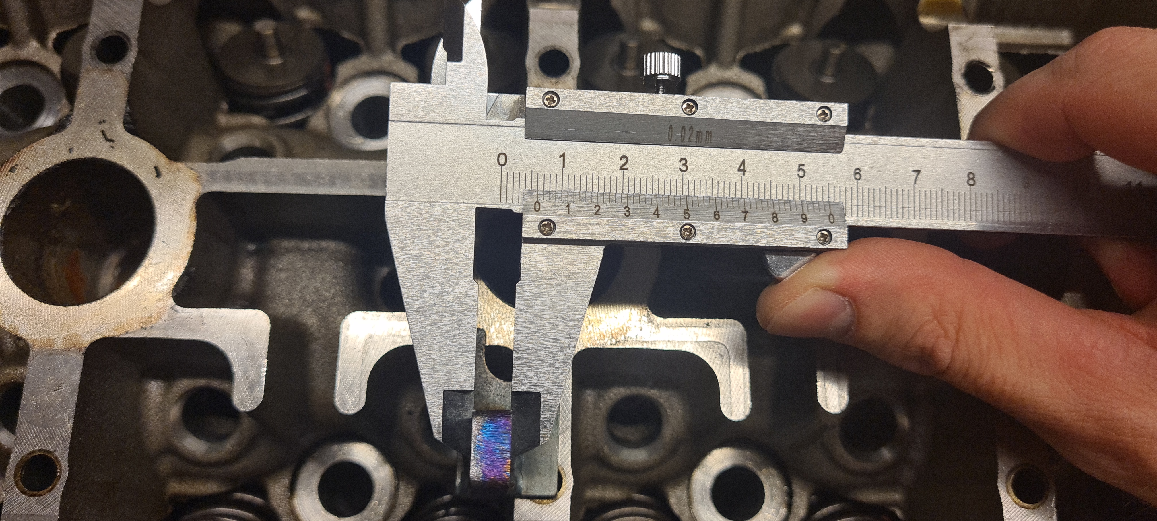

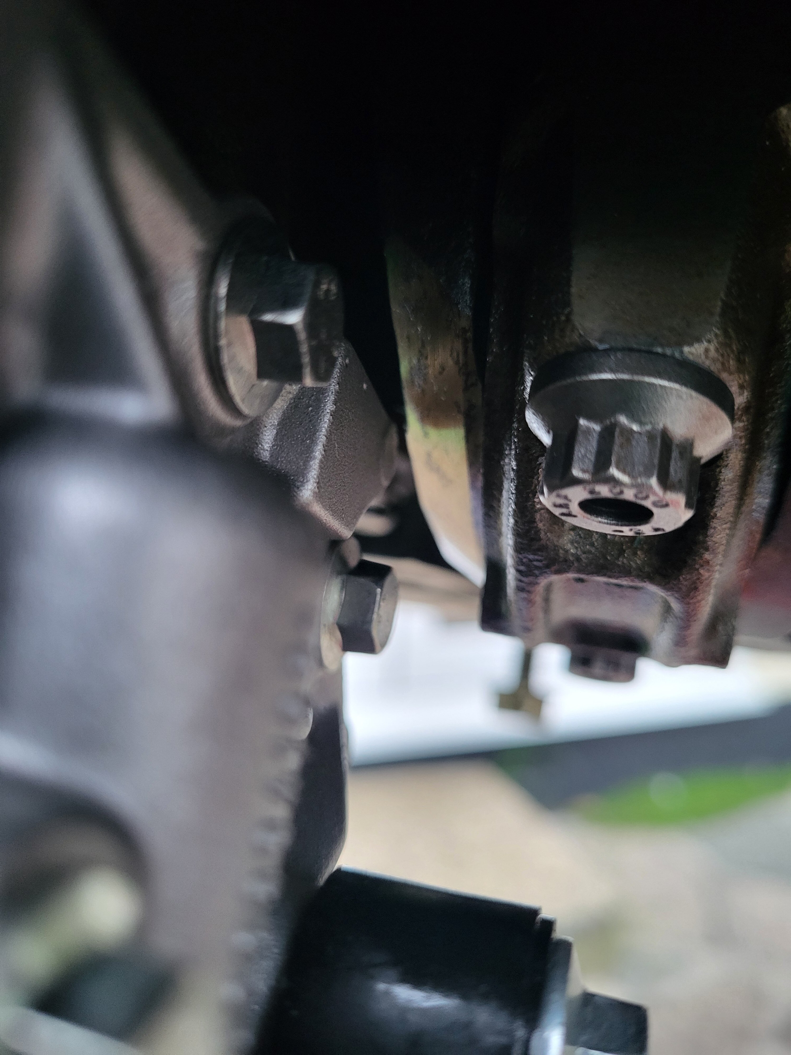

So I fitted all my ARP bolts tonight and the oil pump. Went to fit the sump on (no windage tray but I don't want to leave it open) and it just wouldn't go. It wasn't bottoming out at all, could peak a light in to confirm. It felt more like the pump was fouling on the side of the sump meaning it could go flat to the block but couldn't get any bolts in.
Have you managed to get your sump on?
Also, yikes! Is it meant to be that close?
Gna drop PMS an email in the morning and see what they have to say for themselves.
