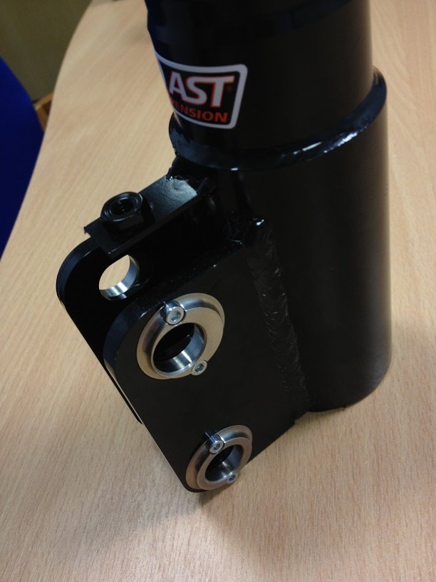

After speaking to Josh about getting more camber. I'm After some pics as think mine are different to others. Ash? Tony? I need more camber and unsure if I can use camber bolts the way mine are. Pic of the hub mounting would great

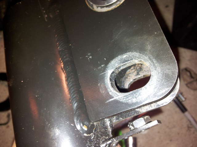

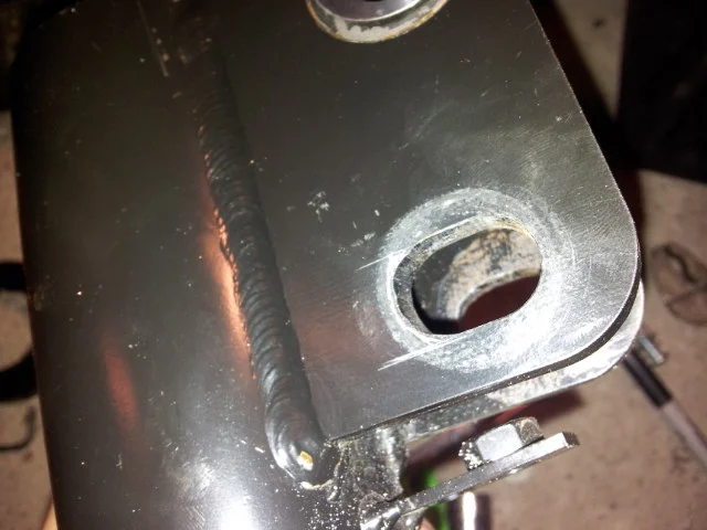

Just mill/file out the strut casing as several people have done already.
I filed mine out, mainly so that I can adjust it, and still use the proper Renault bolts, they are nice and beefy and it's never moved, not once.

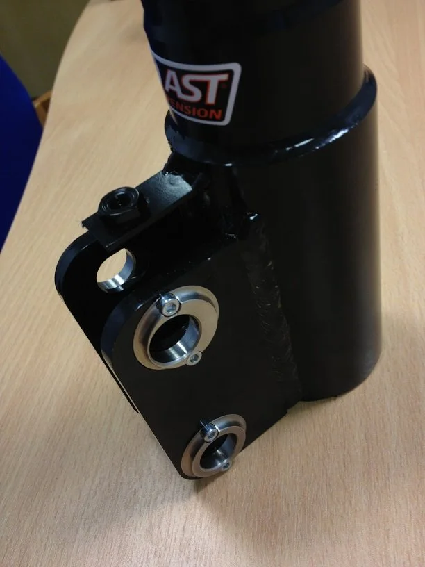

If the top hole on yours are recessed for the screw in shim, they'd presumably need to be milled to extend the recess that the shim locates into for it to move inward/downward to match the arc of the bolt spacing as you pivot the hub position relative to the lower bolt hole in the strut casing. Without the shim you'd presumably be shy of material due to the recess it sits in?
That's why I asked for pics as I have a inset cam type washer to change hub spacing. I'd rather slot then with a round file and use the hefty original bolts with gripping washers
Guessing your upper bolt hole is this type?
Kind of. Mine dont bolt in just have cam type washers.. They look much better quality than mine. Mine are sportline 2
Without looking I've just had a funny feeling mine are canned type washers at the bottom to change hub spacing. Normal at the top so means I could alot them or use camber bolts or both... Ill look tonight as doing geo

Like this?
The push in cam for the 54 versus 60 mil bolt spacing in the bottom mount hole.
Hell of a lot easier to just file out if they are.
Just be sure to file in the arc of the bolt travel as you pivot the hub. If you offer them up on the hub you should get a feel for where you need to take material off :)
Yes that's it... Washer at bottom for hub spacing.. Then top one I can file out using a scribe and compass to curve it slightly. Then mill it out
