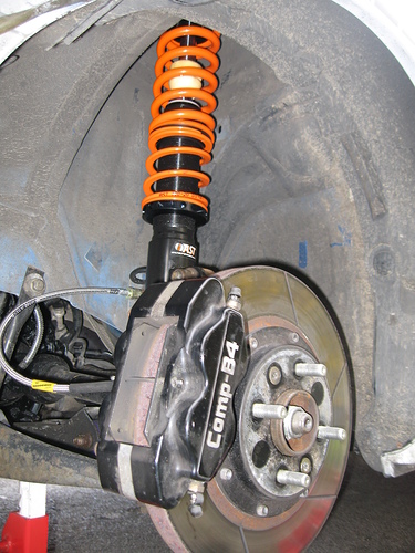

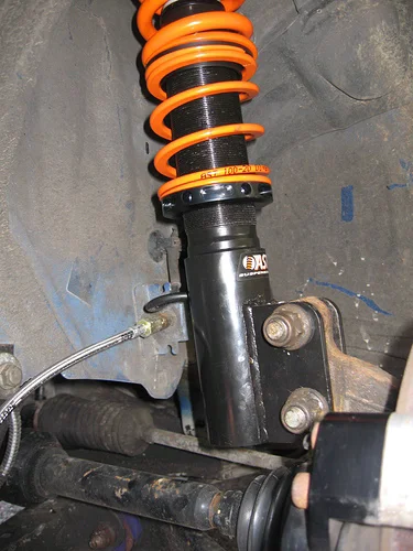

very easy to adjust on front. just a knob on top of the strut.

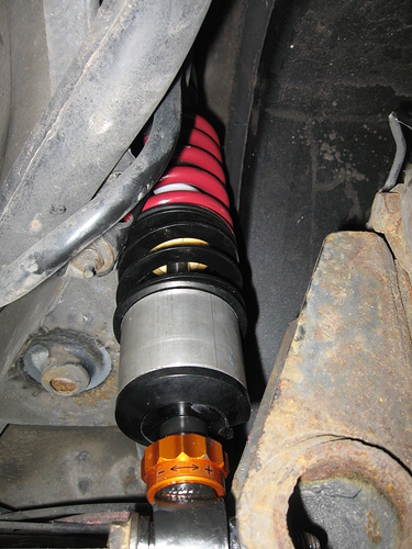

rears you have to lay down and reach under the car the adjust, as adjuster is on bottom of the shock. but its still a simple process!!

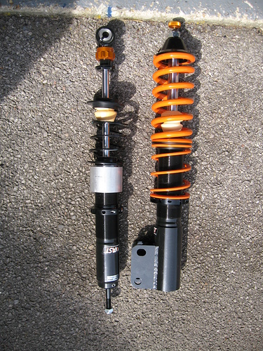

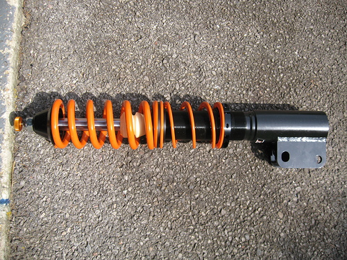

mine kit:
a few pics i have.
not many of the rears (springs are red as they are super hard eibach numbers).
in a shameless plug.... these will be for sale soon, so if anyone wants a set, cheaper than RRP then let me know.
They have been valved and sprung to Cup Race Car specs, so super hard! (450lbs front springs, 750lbs rear)
