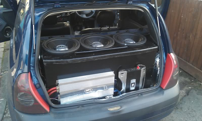

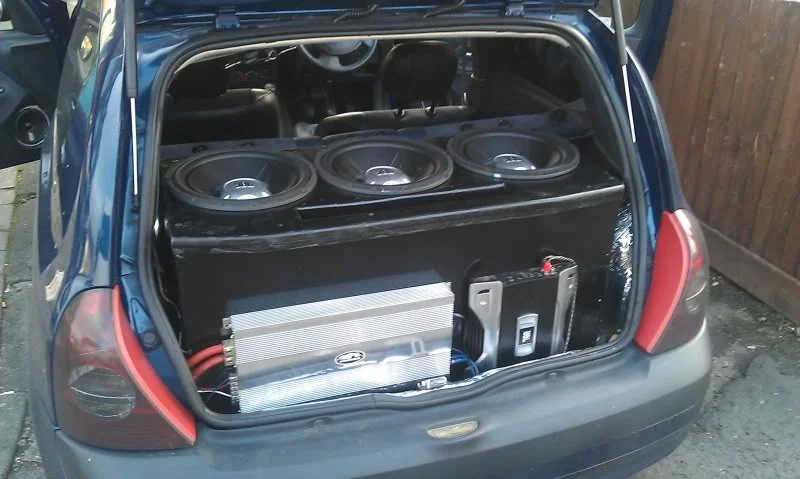

3 jbl gt5 12's , spl dynamics s2000-d, 2x jbl gto 6508c speakers per door running of 2x jbl 75.2 with 4 batteries alot of deadening and alot of 0 gauge :)
also the box is custom made to 6cubes with the port tuned to 27hz with a double baffle and braces throughout :)

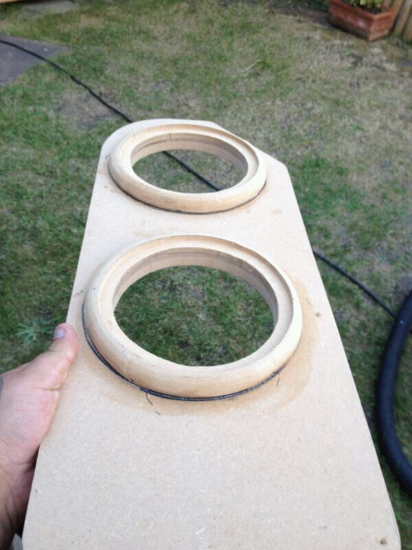

only one for now its been painted black for now until i decide what to do and when it gets warmer for me to finish the build
