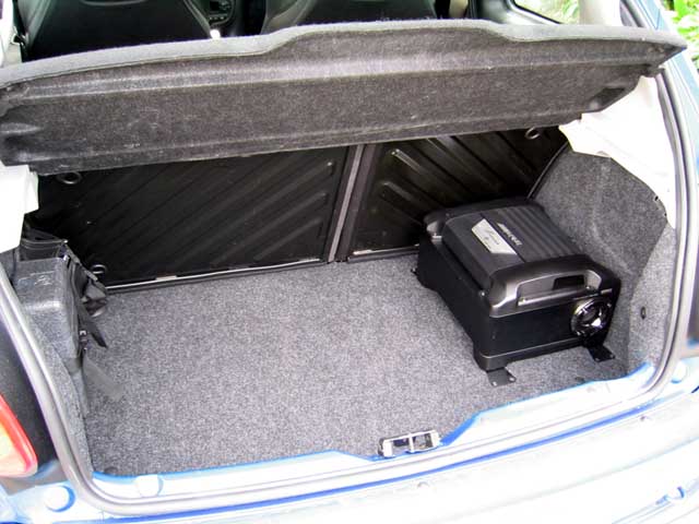

I'm running a monoblock alpine v amp and a 10" sub. Does the job if you just want a bit more punch and doesnt take up much space in the boot. I'm still running the OE speakers and tbh when they're not having to deal with the bass they dont sound that bad although I'd go the route of components too.

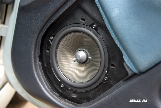

No you don't need to use crossovers.
You might need to solder a bit here and there, and you'll need to dismantle the plugs that come on the Clio speaker wires. Just try to leave as much wire as possible. I fucked mine up a few times and it started to get a bit tight (there wasn't much visible wire left in the fronts and could only just get the speaker out before you started pulling on the wire).

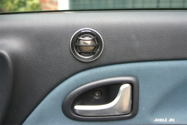

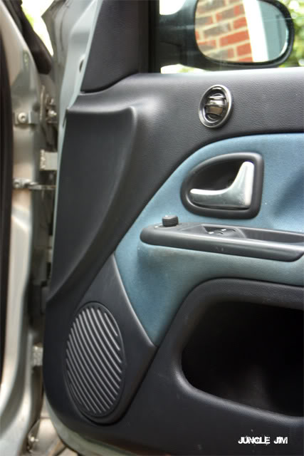

i wired mine differently, i removed the OE speaker from the door, cut the plug n play connector off it and added some more length of cable to run the crossover which i hid behind the door card, i then fitted the tweeter in the door card and ran cable from the crossover to the tweeter and the new door speaker.
i left the standard tweeters in place / still working. its good to use the crossover as its splits the input into bass and treble and also amplifies the signal
