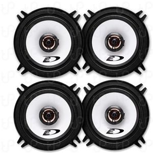

I dont have a sub mate & there Alpine 13cm Speakers,these ones.

I wouldn't get too engaged in trying to massage noise out of that setup if honest.
Taking the lowest bass out of the equation (high pass filter) would help the speakers from distorting when trying to play frequencies they can't reproduce, but other than that, you dont have a lot of options.
Honestly, you'll have as much success playing with treble & bass controls :(

Tweaking the headunit will only get you so far, the real limitation is your speaker selection. Provided you dont want deep bass, you're alright.
Just don't try and force bass out of those speakers, they wont react particularly well. Bigger cones and more watts would be the key.

Yeah I'm not expecting loads from the speakers mate,they sound good but just like you said not much bass,as if I went bass route I would need to get a sub but I don't want to go down that route.
Is there an option for better 13cm speakers or not really?
  Listerine & Poledo
Not really. Sure, you can get 13cms that take more power, but it'd take some serious door-builds to get a significant improvement in bass.
The only real upgrade would be the component front speakers, that use a separate tweeter, but that's a mission to fit and still only marginal gains.
