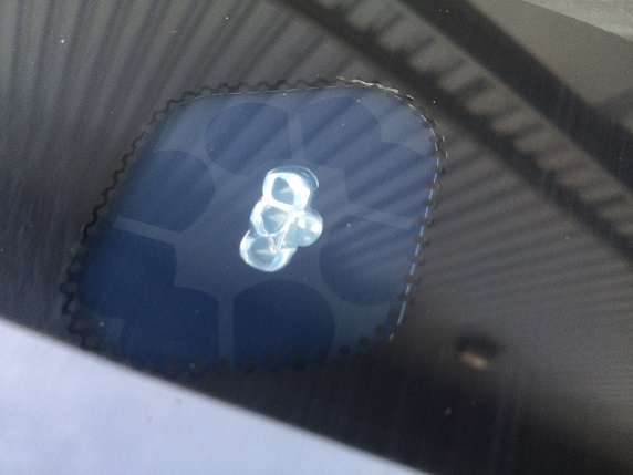

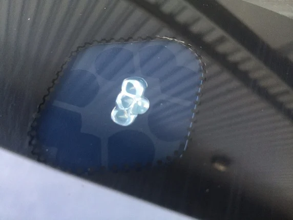

I did a google search and through different forums I think I have found the solution. Seems that the reason is the clear gel which is between the windscreen and the sensor.
If that gel is a bit milky or misty or you have bubbles inside then the wipers they will not work or will work randomly.
Mine for example looks a bit misty.
I have found a video on you tube how to replace the gel. The hard bit is now to find that gel. Any ideas?
