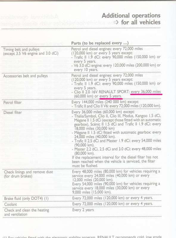

Aux belt, is it 3 or 5 years?
DrR
  VW Golf GTD
Seams to be mixed opinions on this.
My service book says it's 5 years or 36k.
But quite a few people reckons it's 3 years.
DrR
  VW Golf GTD
I want proof, who says it's 3 years, where did this come from?

3yr 36k Aux, 5yr 72k Cam.

Well i'm on 18k and 3.5 years so i'm gonna follow Renaults guidlines as per my cars manual.
So far to me 3yrs just seams to be CS recomendation.

Why does my manual say 5 years?
Surely i can't be the only persons who's say 5 years?

My service book for my 182 says the same 5 years or 36k . I'd like to see proof also if the schedule has changed . Unless it's just a case of chinese whispers and people assuming that 36k equates to 3 years with an average of 12k a year .

The more I think about it, I think Paul (lemonnobby) may have actually just said it was due at 36k, not 3 years/36k...
I may be forced to eat humble pie.
I'm 80% sure he said to me it was 5 years.

In Australia the Aux belt is listed in the warranty / service manual as 3yrs / 50000km and the timing belt as 4yrs / 100000km. The dealers also say you are not supposed to reuse the aux belt- so it needs to be replaced again when removed to do the timing belt at 4yrs :S .
They also recommend replacing the tensioner when doing the aux belt..... I had mine done "early" at 30months/ 14000km and they replaced the tensioner under warranty because it was noisy. (I figured I might as well get it done early if it needs doing again with the timing belt at 4yrs.)
I can scan the above and post it if nobody believes it. :)
