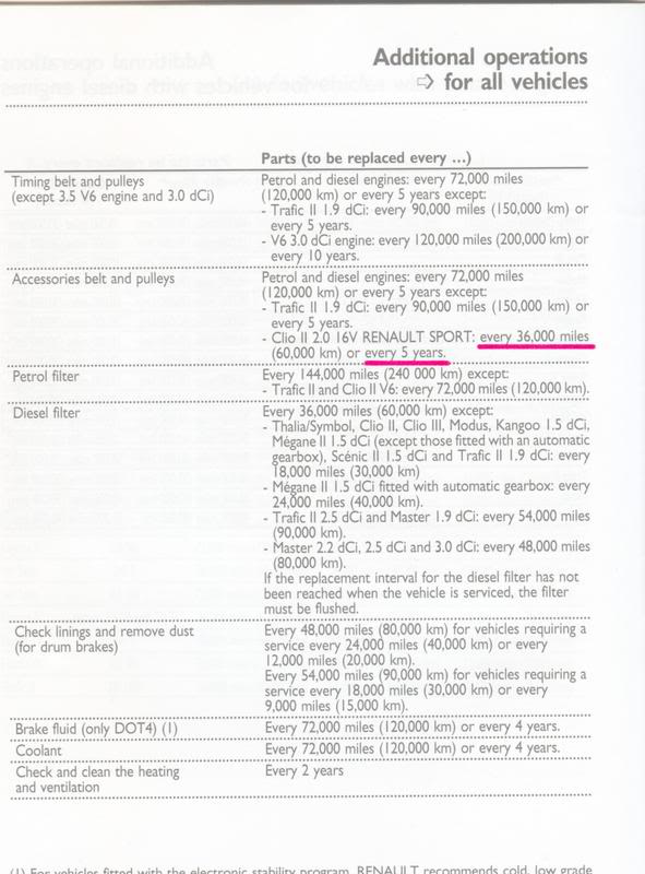

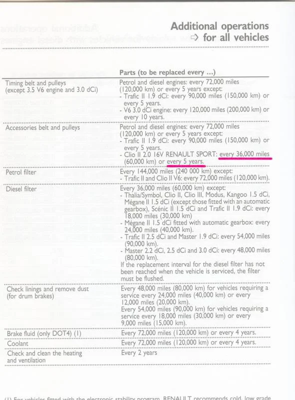

Scan from the Manual.

The Renault programme states: accessory belt: every 36k or 5 yrs / Timing belt: 72k or 5yrs and with the accessory belt it includes the belt tensioner pulleys. So if its 5 years old both belts should be replaced.

I'm yet to see any evidance that it's anything other than 5 years or 36k.
I think the 3 years thing come from the fact they're usually done at about 3 years because most people have done 36k in that time.
Both my 172 and 182 handbooks say
For the F4R 2.0L . Cambelt 5 years or 72.000 miles.
Accessories belt+pulleys 36.000 miles or 5 years.
