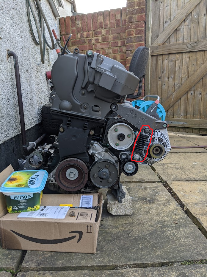

Aux belt tensioner is knackered. Mine did that when it went, I suspect the tensioner spring is just starting to rub on the belt.
The tensioner in the bottom left of the video? Did you do the work yourself? Did you follow a guide? Sorry for all the questions :)

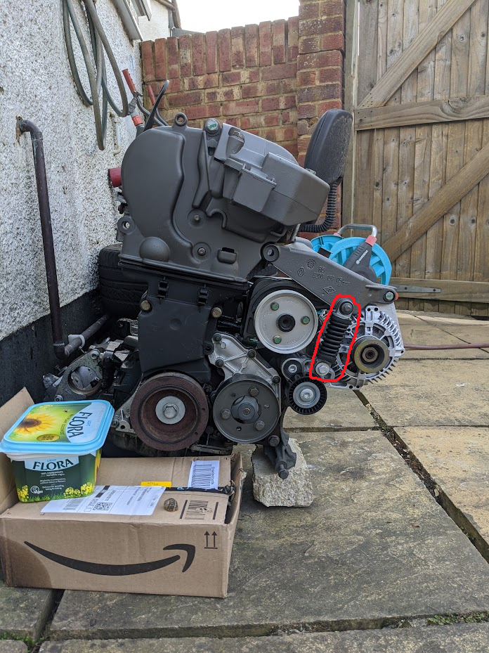

The tensioner pully is attached to the spring you can see in your video. I did do it myself yes, I didn’t follow a guide though because ‘MAN’ it’s not a hard job, but a pain in the arse that’s for sure. Access is pretty tight, well it is on a 182 with ac

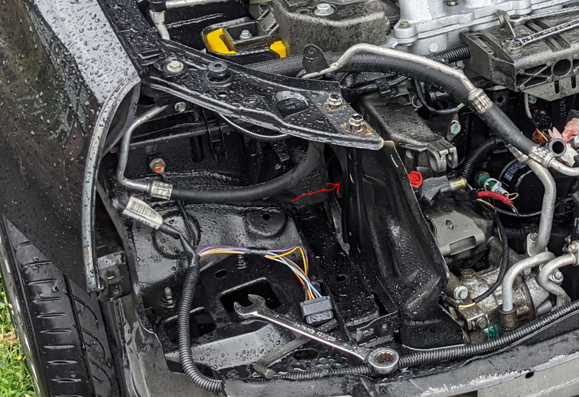

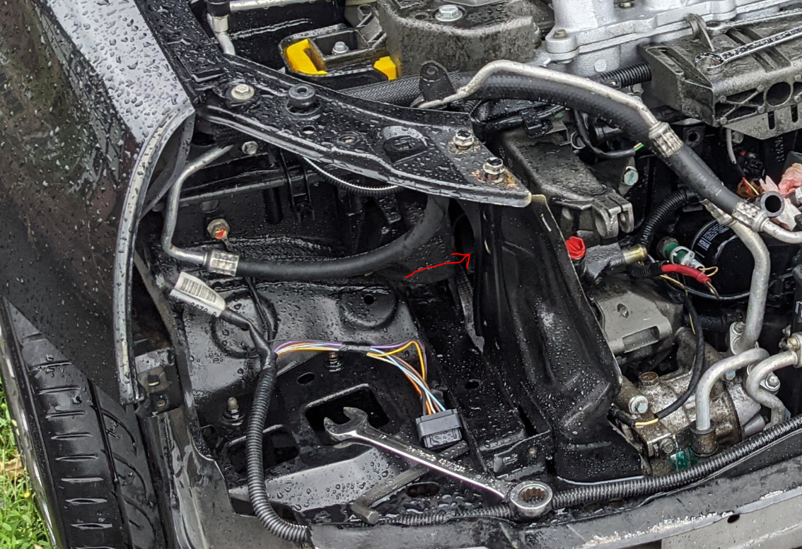

From memory if you take the drivers side headlight out there is a hole you can get a tool through.

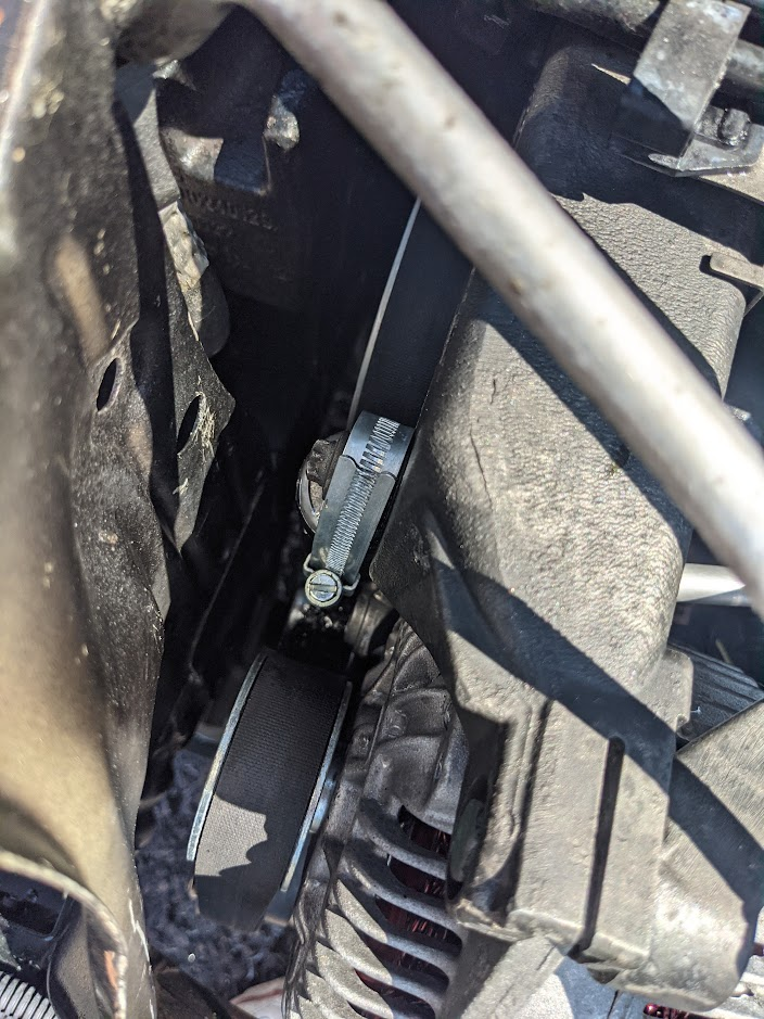

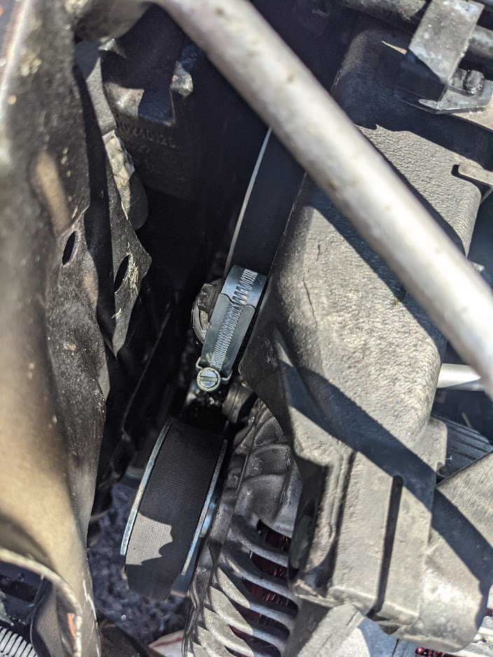

You will want to buy a 100mm (again from memory sorry) Jubilee clip and place it around the spring. You tighten the Jubilee to compress the spring:
1672948686157.png​
I think this is the hole behind the headlight that lets you (with some swearing) undo the top bolt.
Top bolt is a female torx, E12 rings a bell but might be inventing that.
The bottom bolt is a largish allen key here:
With the Jubilee clip tightened you are able to remove the Aux belt, with the two bolts undone you can remove the tensioner. Its a fiddly faff but its not really difficult.

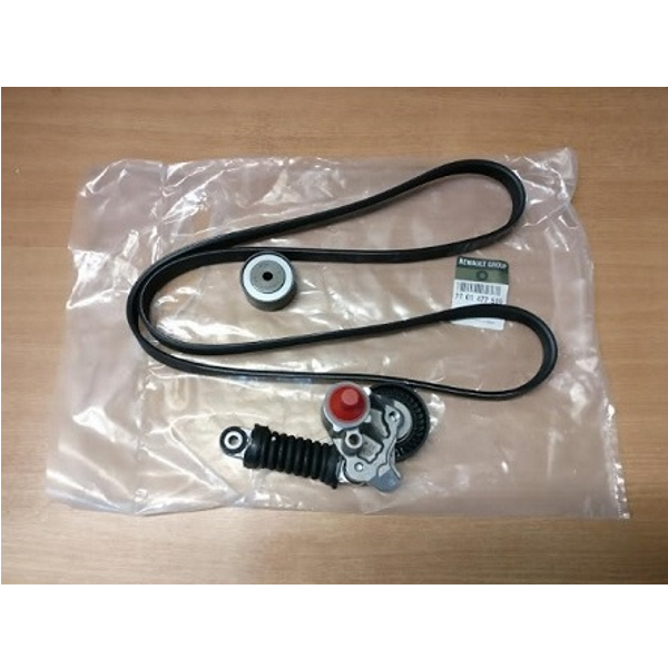

Assuming you have AC I would personally buy this kit:
Aux belt is a 3 year service item while cam belt is 5 years I think.
