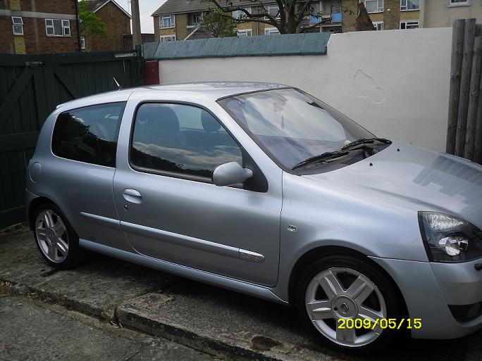

  clio 172 sport
Piccy of my baby in better times! :)

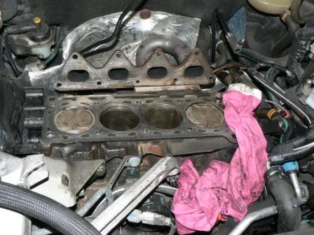

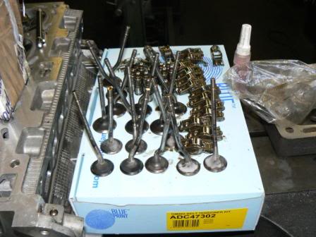

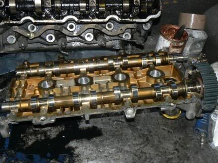

I had a similar problem with my 182, aux belt started to shred (but didn't completely let go). The shreds then took out the cam belt. This happened when i was driving at about 40mph on a dual carriageway. It bent all 16 valves and wrecked all the valve guides on the exhaust side. Engine needed a head rebuild and new cam and aux belt kits. Total cost £1070! It was the aux belt tensioner that caused the fail for me. Got photos of some of the damage and the valves didnt look pretty afterwards!!
Would be interested to see the piccys,I have know idea what any of this stuff looks like! :D
  Petrol Blue Clio182FF
Piccys
Bent valves
Head with cam shafts
Cylinder block
Edit: pics are small, if anyone wants a bigger pic i'll email, just send a pm.
  clio 172 sport
^^ Wow! so thats whats inside! i can see now why its such a big job!

  Lionel Richie
wow those are some majorly bent valves!
i notice they haven't removed the inlet cam pulley, who did the work again?
only reason i ask is if they didn't have the special renault tools your timing will be off, does the car still go mental and pull hard when it hits 5K rpm?
just a few words of warning
