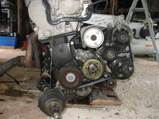

picture request!!!
has anyone got a side picture of a clio sport 172 engine, so i can see the how the AUX belt and pullys lie, coz as the engine sits in the car its hard to view!!
thanks

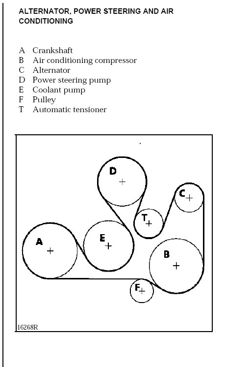

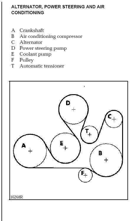

tadaa
Edit: Good luck :)
