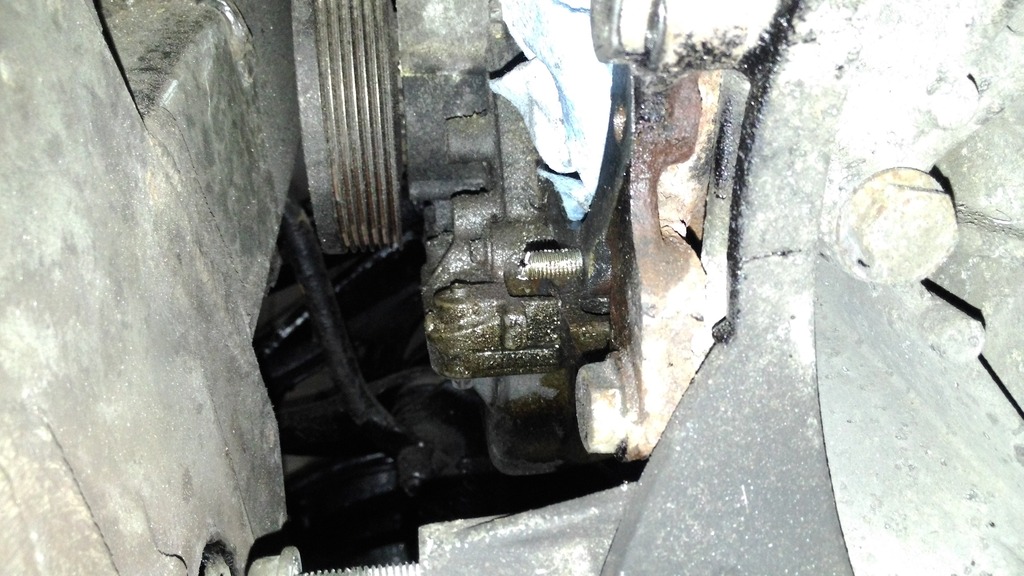

I'm not sure whether I did it or it was like this before, but the top bolt for the aux tensioner has sheared, leaving a bit in the bracket. It looks like the bracket for the power steering pump, once I took off the top bracket.
I'll probably just drill the remains and helicoil it, which I think should be sufficient, given the alternative is a replacement bracket, which looks like removing the pump would be necessary. I'm not sure if the pump can be left without upsetting the hoses, so don't want to go down that route.
I'm guessing the bolt is an M8, hoping so. Is there any particular reason to use the E12 bolt, or could I just use any old M8 bolt? If not, does anyone have the part number to hand?

Yep, i always swap for a hex bolt when i put them back.
Re: bracket. If it's a std Ph1 bracket, then it comes off without the PAS pump needing to be touched. Few bolts into the lower inlet. One awkward 16mm by the upper engine mount, aux tensioner(which is done already) and a nut and bolt onto the top of the Alternator..

I would only use a high grade bolt, not something from a DIY shed, because failure can/will result in cambelt disturbance with catastrophic results

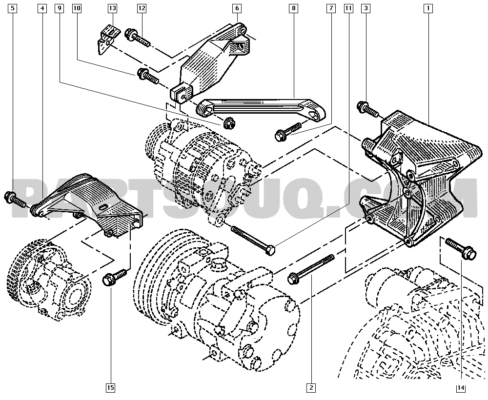

Ok, whipped out the Dialogys. It looks like the part number is 77 03 002 949. This is a flanged hex head bolt rather than an E12, and some images online suggest that too. Even looking at my replacement aux tensioner, there is now a hex head bolt instread of a E12, so must have changed for convenience.
The bolt I have appears to say 10.9 on it, but the bolt on the aux tensioner says 8.8, so not sure whether 10.9 is unnecessary.
Model
name engineNo engine options model manufactured complectation
7700864098 SUP AIR CND COMPR 1
7703002190 SCRWEW M10X150-65 2
7703002697 SCRW M10X 3
7700114754 STRNG PUMP BRKT 4
7703002949 FLGD HEX HEAD SCRE 5
8200139054 ROD-TIE ALTRNTR 6
7703002854 SCRW M10X 7
8200139051 ALTERNAT SUPT 8
7703035041 FLANGED HEX NUT M8 9
7703002949 FLGD HEX HEAD SCRE 10
7703602241 SCRW RDL 11
7703101545 HEX HD SCR W/WAS M 12
7700114742 BELT TENSIONER 13
7703002710 FLGD HEX HD SCREW 14 (X) dimension = 60
7703002697 SCRW M10X 15

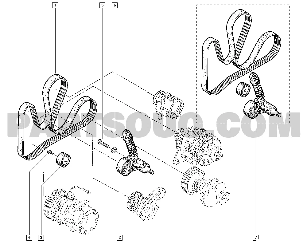

Its not on the diagram I tried to get one from Renault you will have to measure the old one
Number Name Code note
8200226493 RIBBED BELT 1 Special feature?; No special feature
8660001511 COURROIE ALTERNAT 1 Special feature?; Motrio alternative offer for Renault vehicles over 5 years old and Dacia vehicles over 3 years old = Yes
8660001578 GALET TENDEUR 2 Special feature?; Motrio alternative offer for Renault vehicles over 5 years old and Dacia vehicles over 3 years old = Yes
8200429703 TENSIONER-DYNAMIC 2 Special feature?; No special feature
8671019888 GALET ACCESSOIRES 3 Special feature?; Motrio alternative offer for Renault vehicles over 5 years old and Dacia vehicles over 3 years old = Yes
8200065479 PULLEY 3 Special feature?; No special feature
7703002949 FLGD HEX HEAD SCRE 4
7703002419 SCRW 5
7703053934 PLAIN WASHER 8.2X2 6
7701477519 BELT ACCESS KIT 7

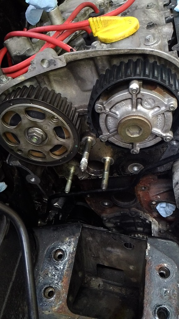

Just spent the last three and a half hours taking ogg the water pump. I officially hate this car. Once this is all done, I will go and wrap it around a tree. Never getting a Renault ever again.
How come none of the guides around mention that the water pump pulley doesn't really come out, not without some crazy bending and rotating of the water pump itself? No amount of raising or lowering the engine gives enough clearance, and thank god I have no gas in the air con, because that means I can remove the compressor and condenser and radiator out of the way and it's still tight.
Oh and of course, there had to be 9 bolts for the water pump, and they had to be stupid E8 bolts, of which the last one had to turn into cheese. So out comes the Dremel, to grind it away before the pump can be freed.
So I'm left with this:
These aren't M6 nor M8 bolts, which either suggests they're M7 or some completely different size. So ditching these for standard hex heads still isn't an easy option. I still haven't removed the bottom cover yet. I'll be spending the weekend on this one stud, and then probably the cam seals on the end so I can start thinking about doing the actual damn cam belt.

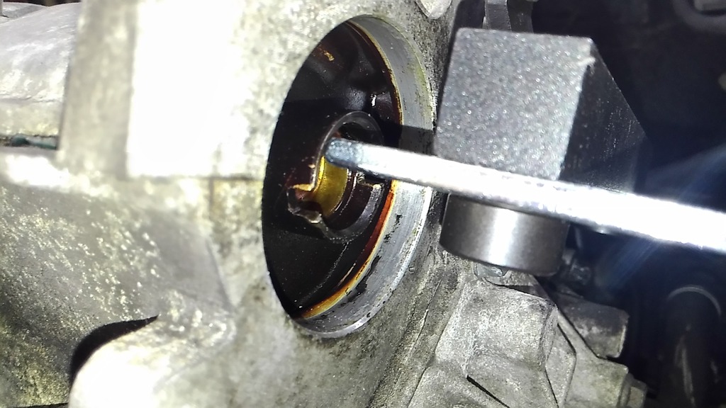

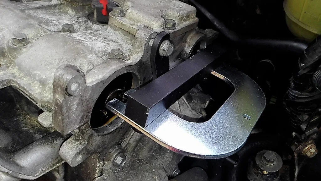

Got the belt off, but amusingly:

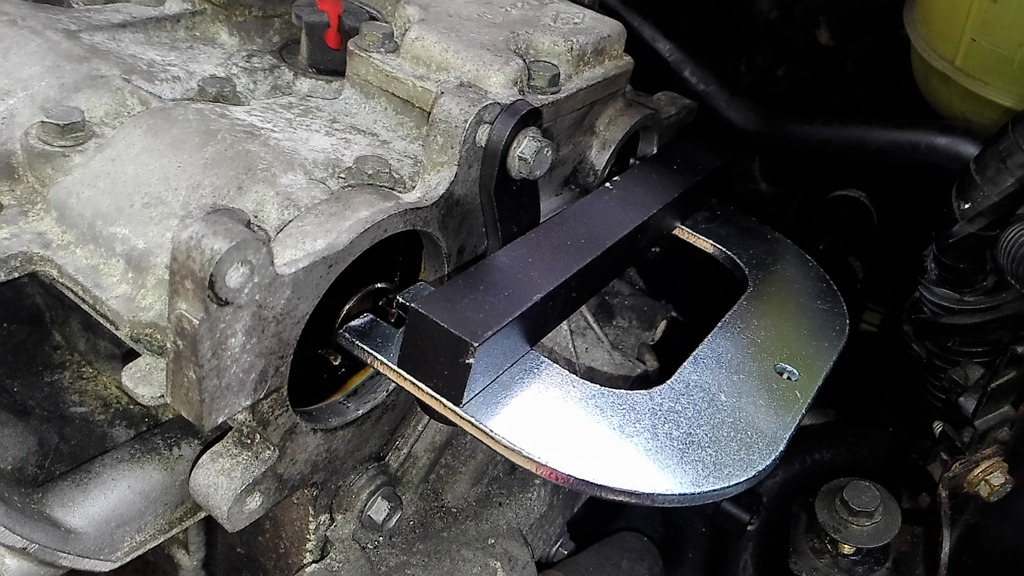

Now, I'm not using the genuine camshaft timing tool (a U.S. Pro one), but even so, looks like the timing is off. Don't worry, I have the genuine Renault pulley locking tool. I discover now that you can buy the complete genuine set, I should have waited rather than think that Renault weren't making them anymore (they were out of stock when I was preparing for all this).

I have the belt on and initial tension set. The manual says to rotate six revolutions, presumably to let the belt settle in?
Maybe it's obvious, but I should take the TDC pin out to do this? I would guess the pistons would move, but the camshafts are still set by the camshaft tool, so no valves will be hit? Is that correct?
  dan's cast offs.
leave the cams locked and just turn the belt, as all the pulleys are floating nothing will move.

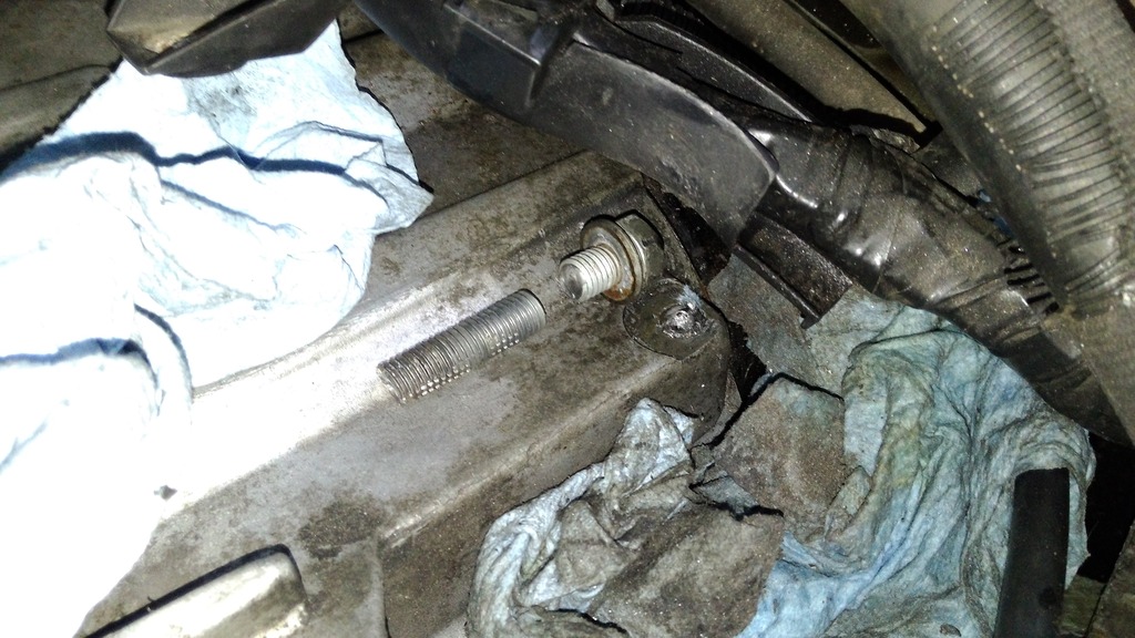

The bolts for one of the brackets that attaches to the gearbox. Two bolts came out with no drama, but this one was unbelievably solid, a breaker bar and pipe on that got it to move a few degrees before it snapped. Nothing has worked. Got a couple of nuts to try and lock them to undo the remaining (same as for the sheared water pump bolt), ended up stripping the threads on the nuts!
In a rage, just got the dremel out, cut a horizontal slot to try the chisel and hammer method in attempt to undo it. Not budging. Then cut the damn thing off, cut a slot in the middle, and attempted an impact driver. Not budging. Have now decided to cut if off flush and drill it. Which is where I am at, because I have this feeling this bolt is not going to go without a fight. I have no idea why this one is stuck so solid.
More drill bits, probably a helicoil kit just in case. I am really falling out of love with this car.
