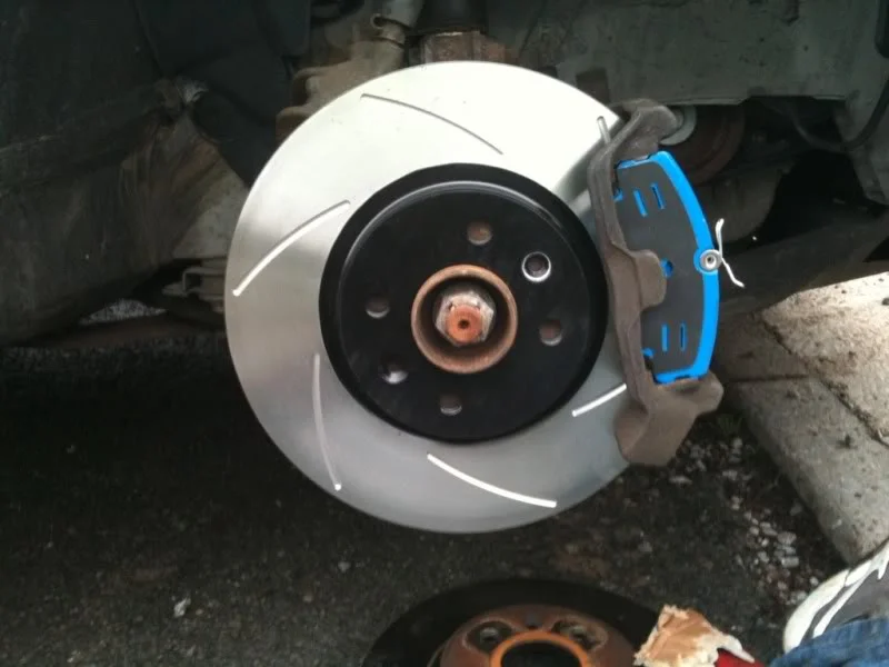

So far I've fixed the brakes, I was told by the previous owner that the disc was cracked.
So popped in to see Ben at GodSpeed who sorted me out with a set of GodSpeed groved discs and a set of Bluestuff NDX pads
Straight home to fit and it became apparent what the noise was as soon as I removed the first caliper bolt. The caliper fell into my hand, there was only one bolt holding the caliper to the carrier.
next problem whilst fitting was the sliders in the carriers were siezed, Ben sorted me out with another pair that came from the clio that he was breaking.
So brakes all done, but I still want to bleed them as I'm unsure how old the fluid is.

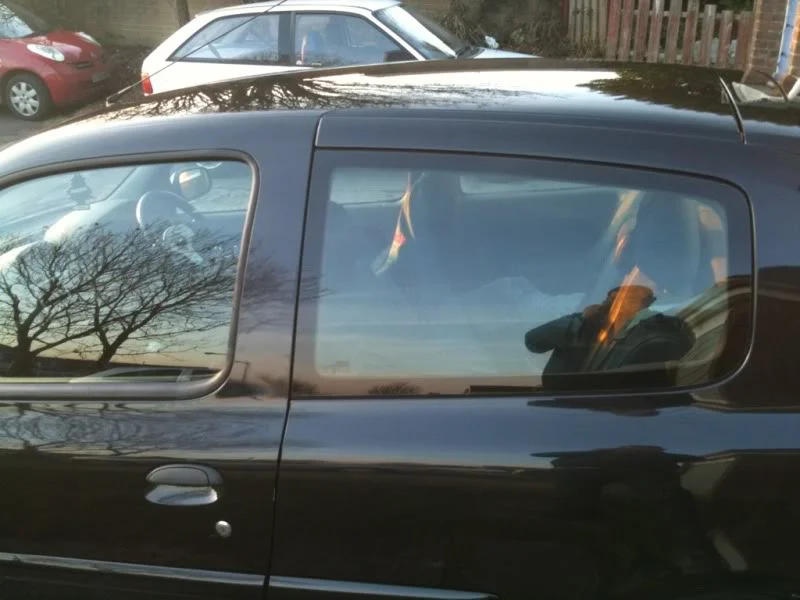

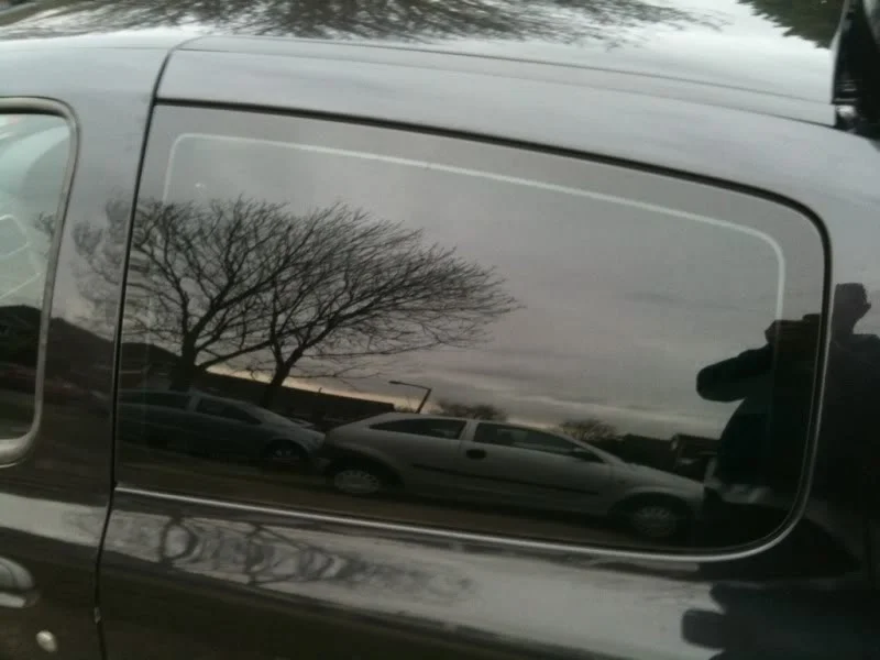

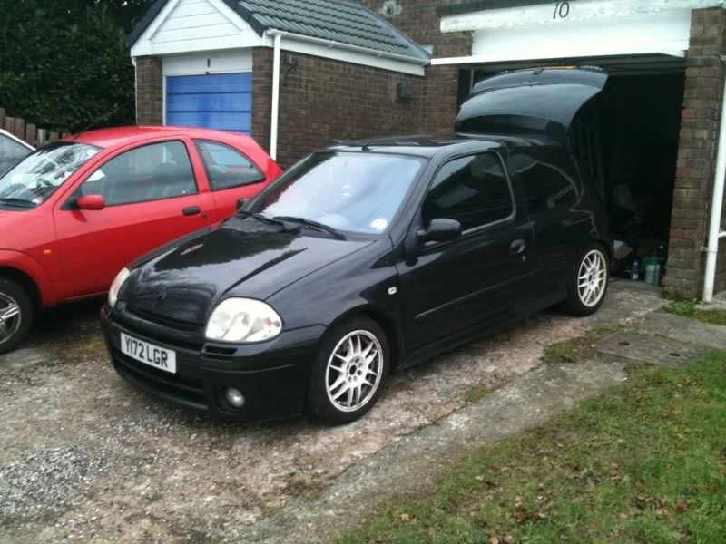

Next up was to remove the tints on the windows, not really my thing and I want to try and "Clean" up the car.
so..Before
After

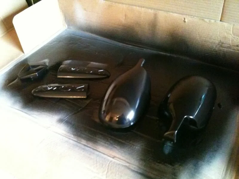

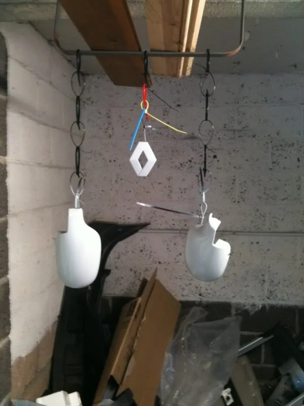

Next up then was to get rid of the white badges and mirrors
Primed
Base coat and laquered

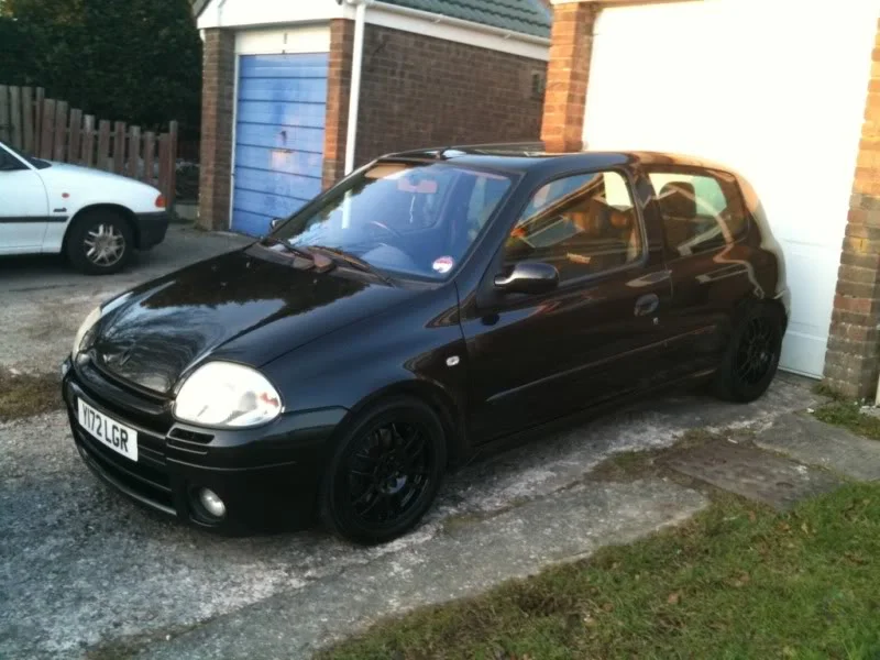

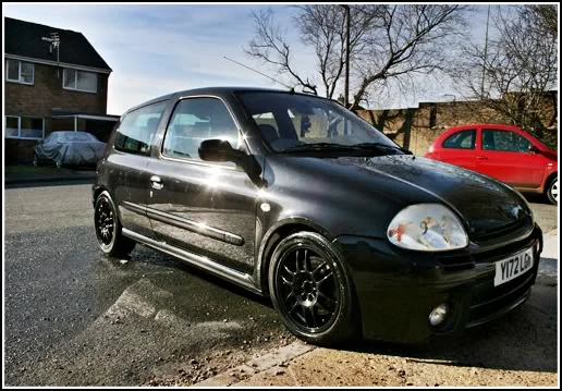

During the week I gave Matt a call and asked him to paint my wheels and mirror caps (I'm quite possibly the worst painter in the world!) so friday night I dropped the car off to him ready to get the wheels done yesterday and here are the results..
Never done the "Black on black" Before and really liked the look of it, love them very impressed by Matt's work! I'm going to have to stock up on tyre shine!
