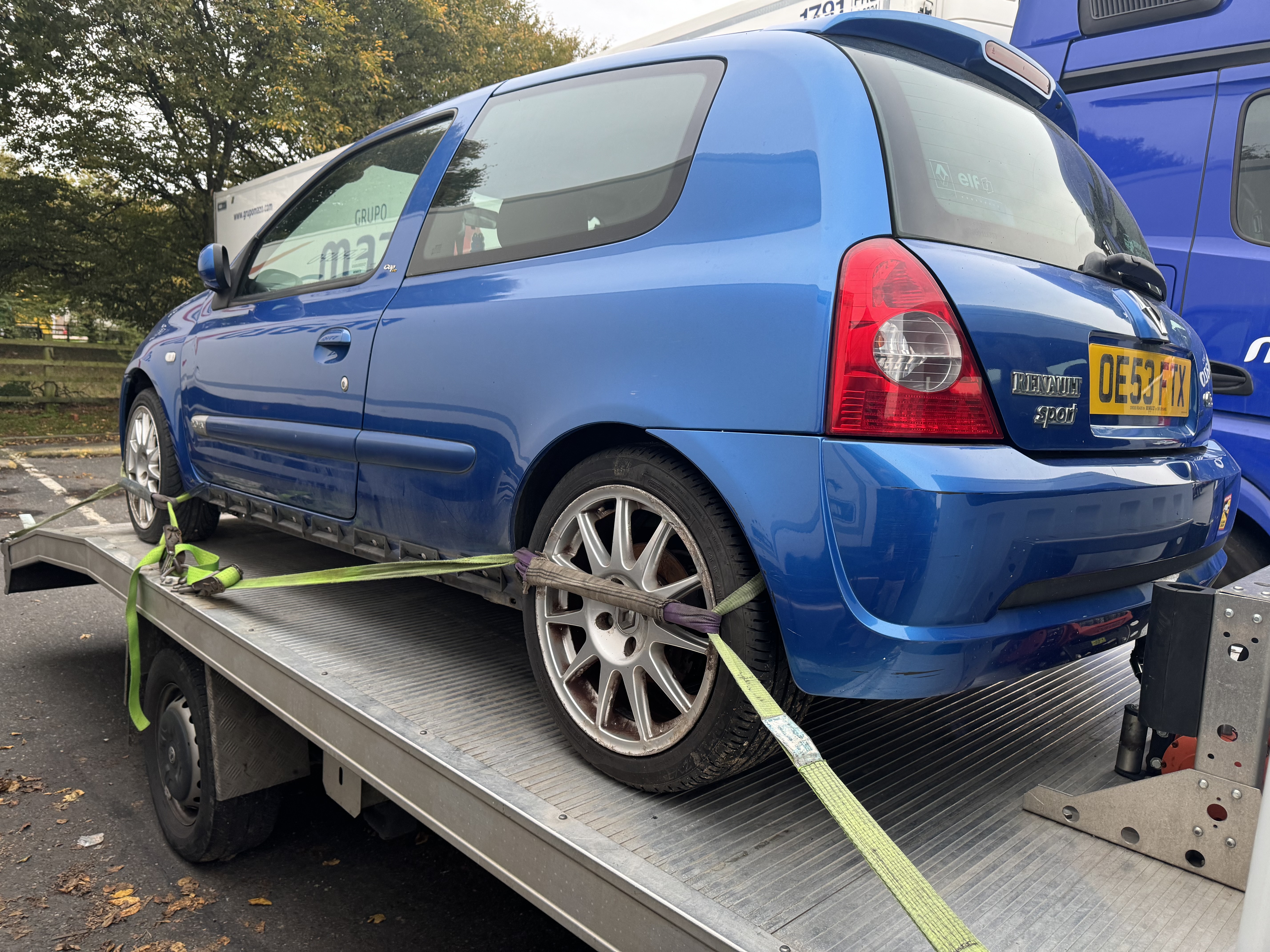

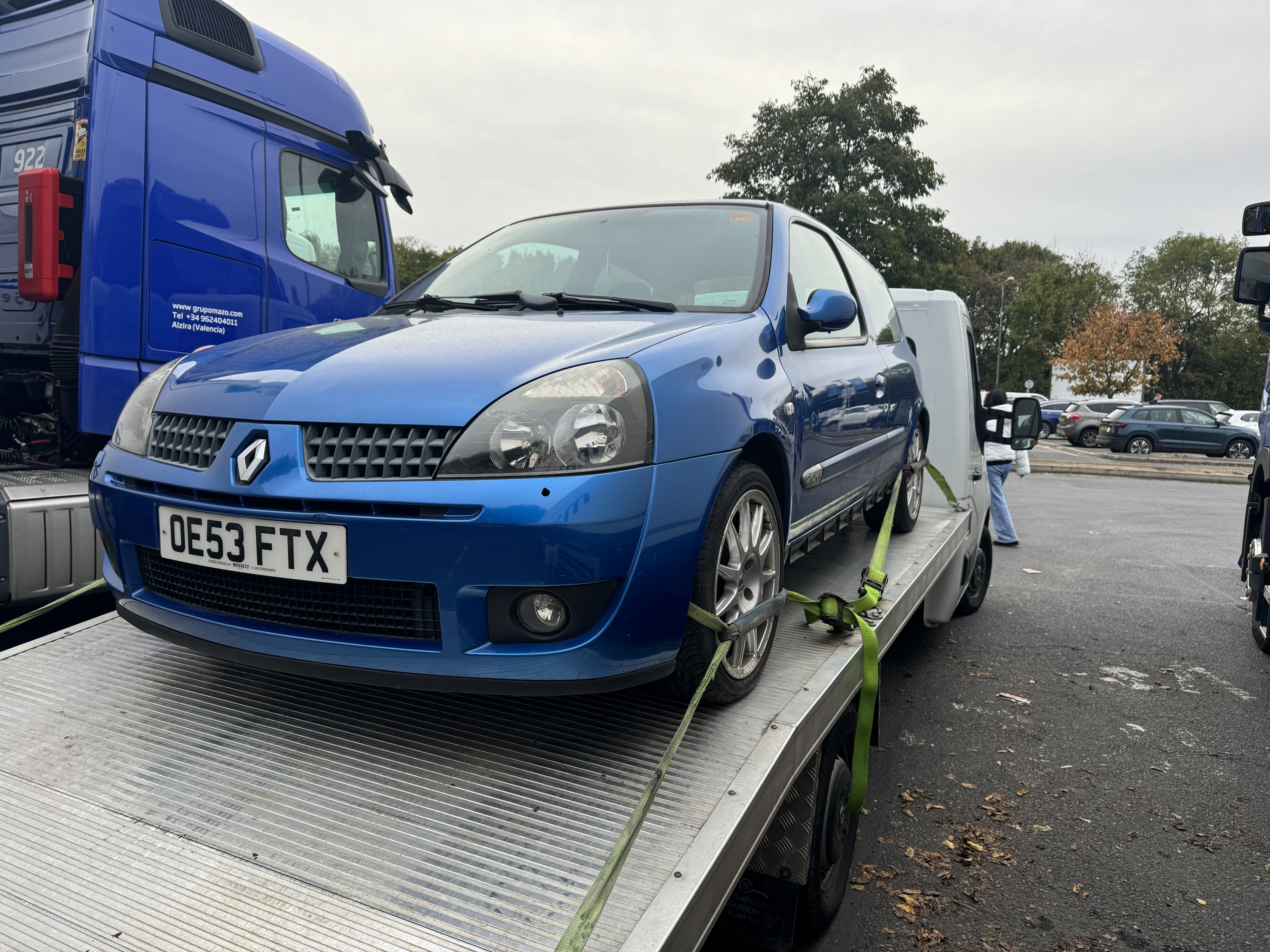

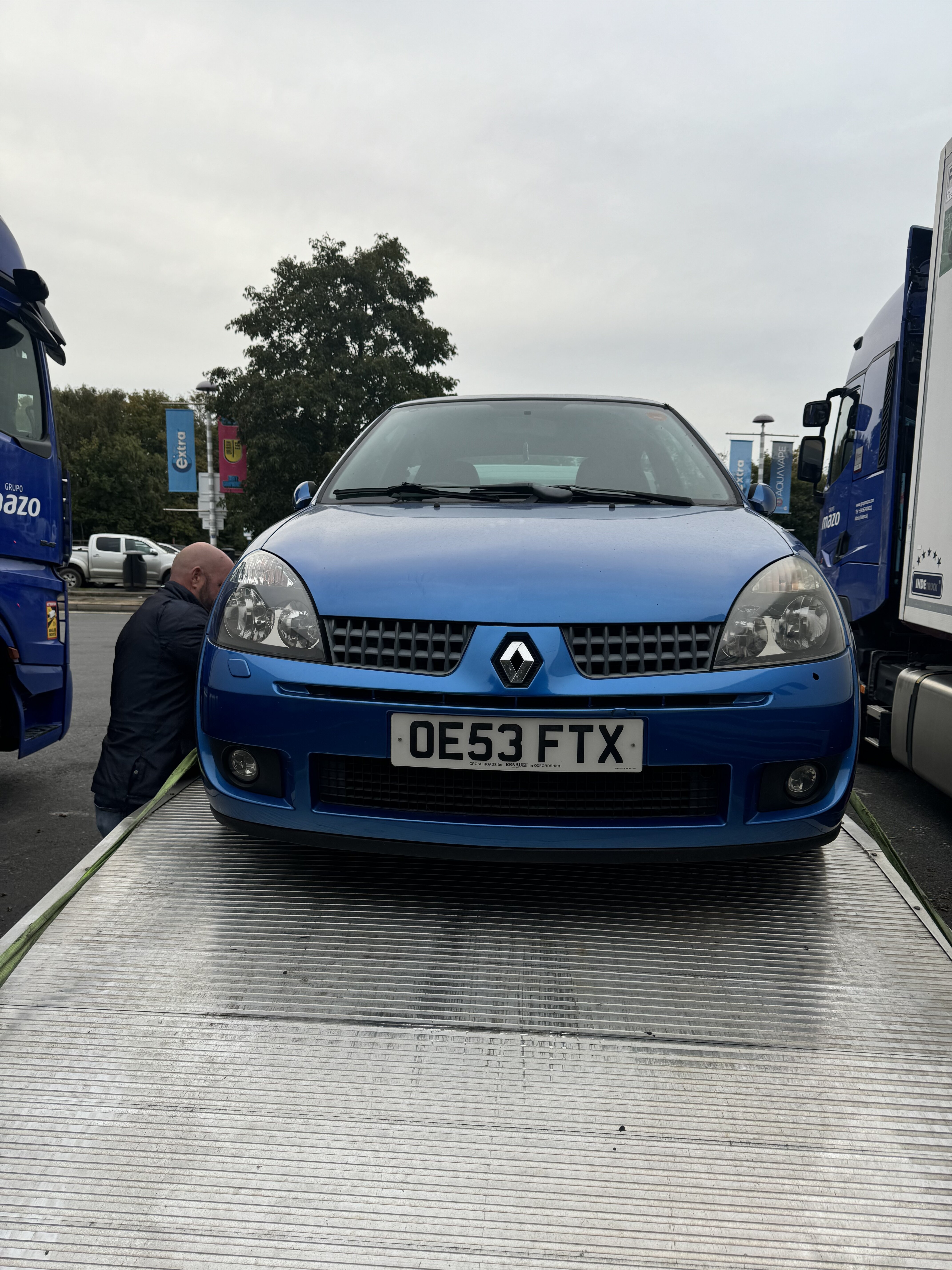

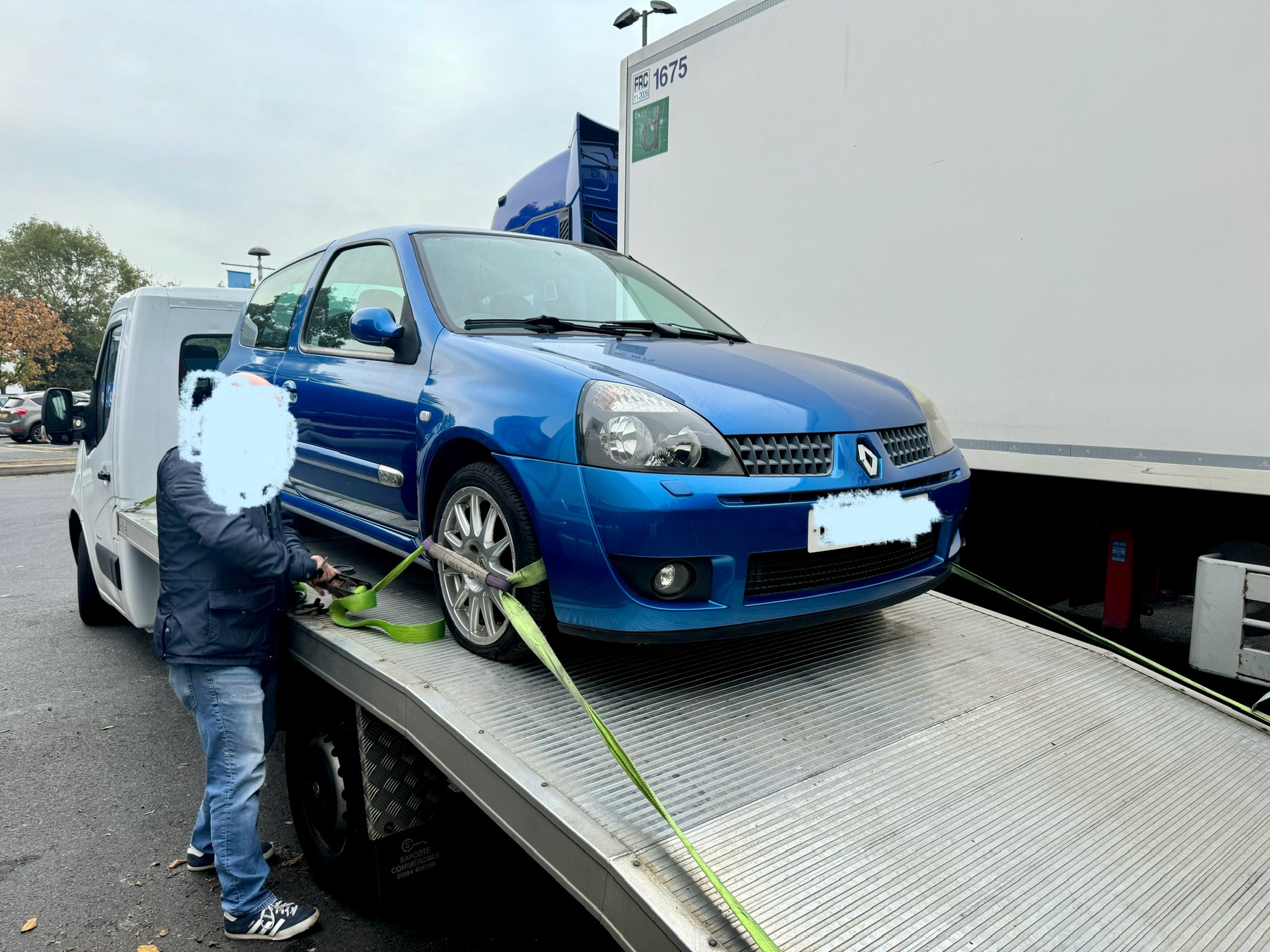

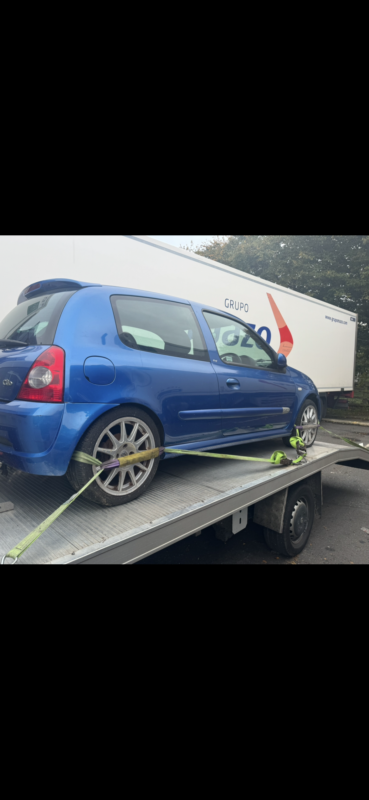

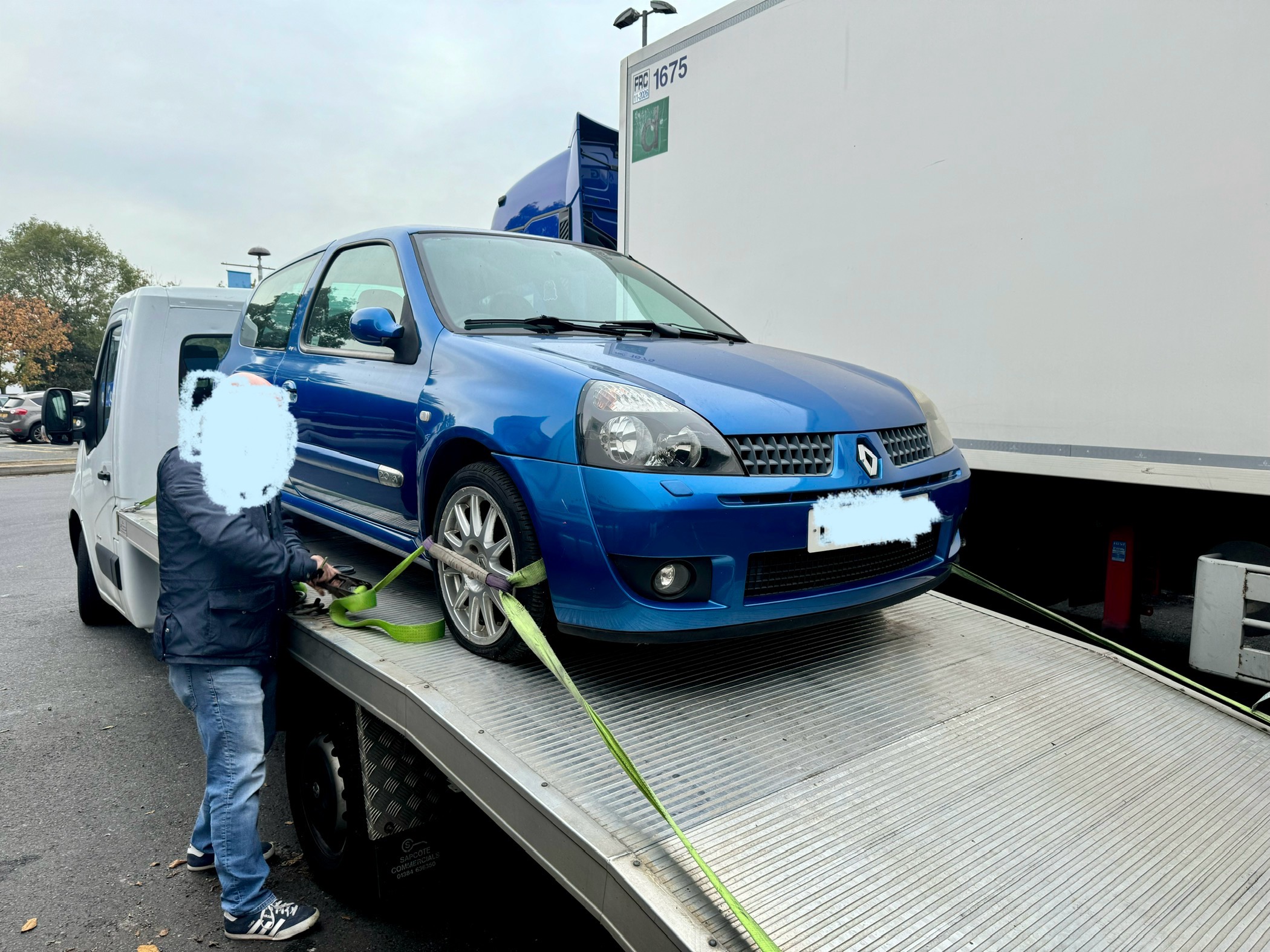

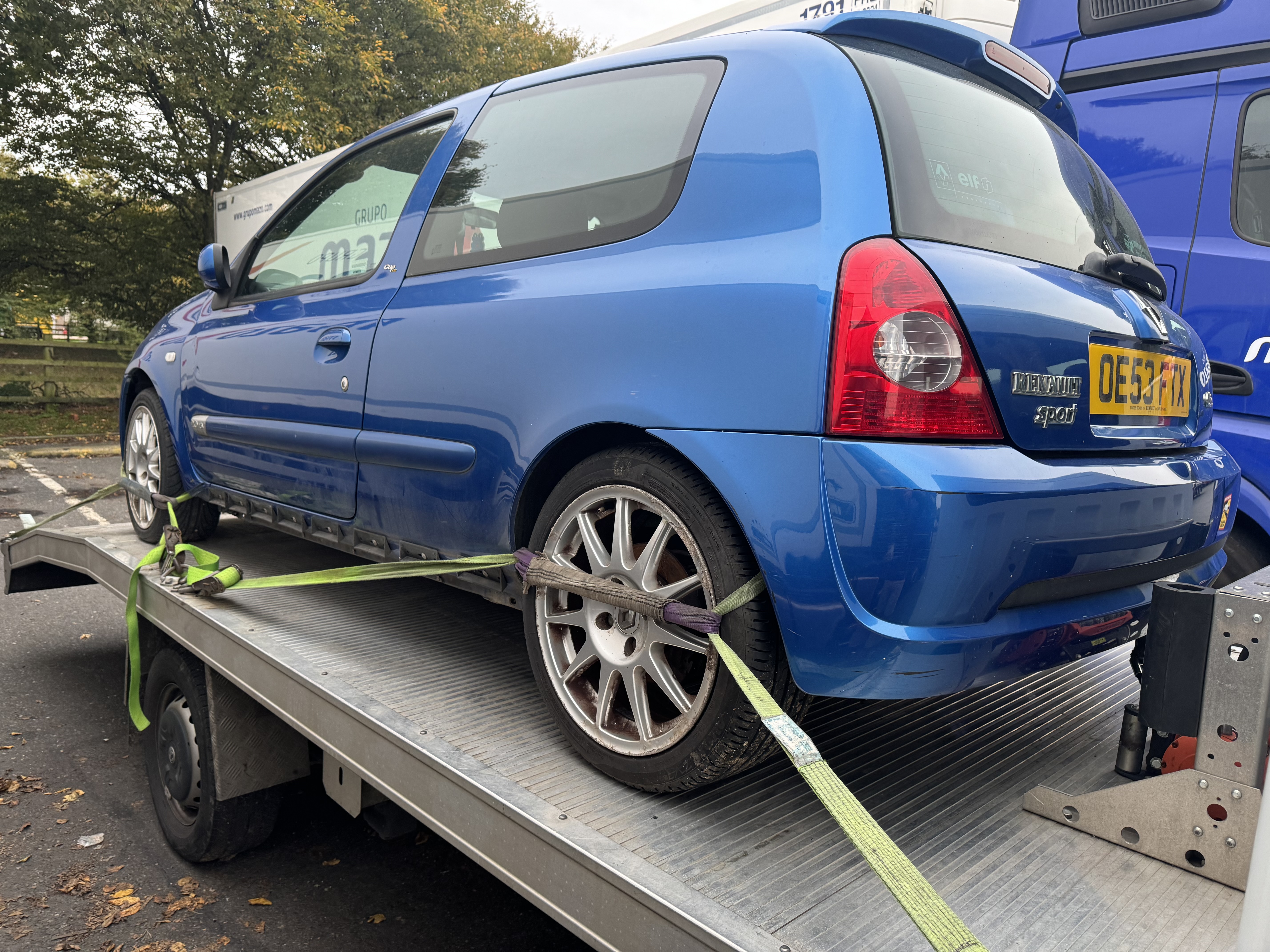

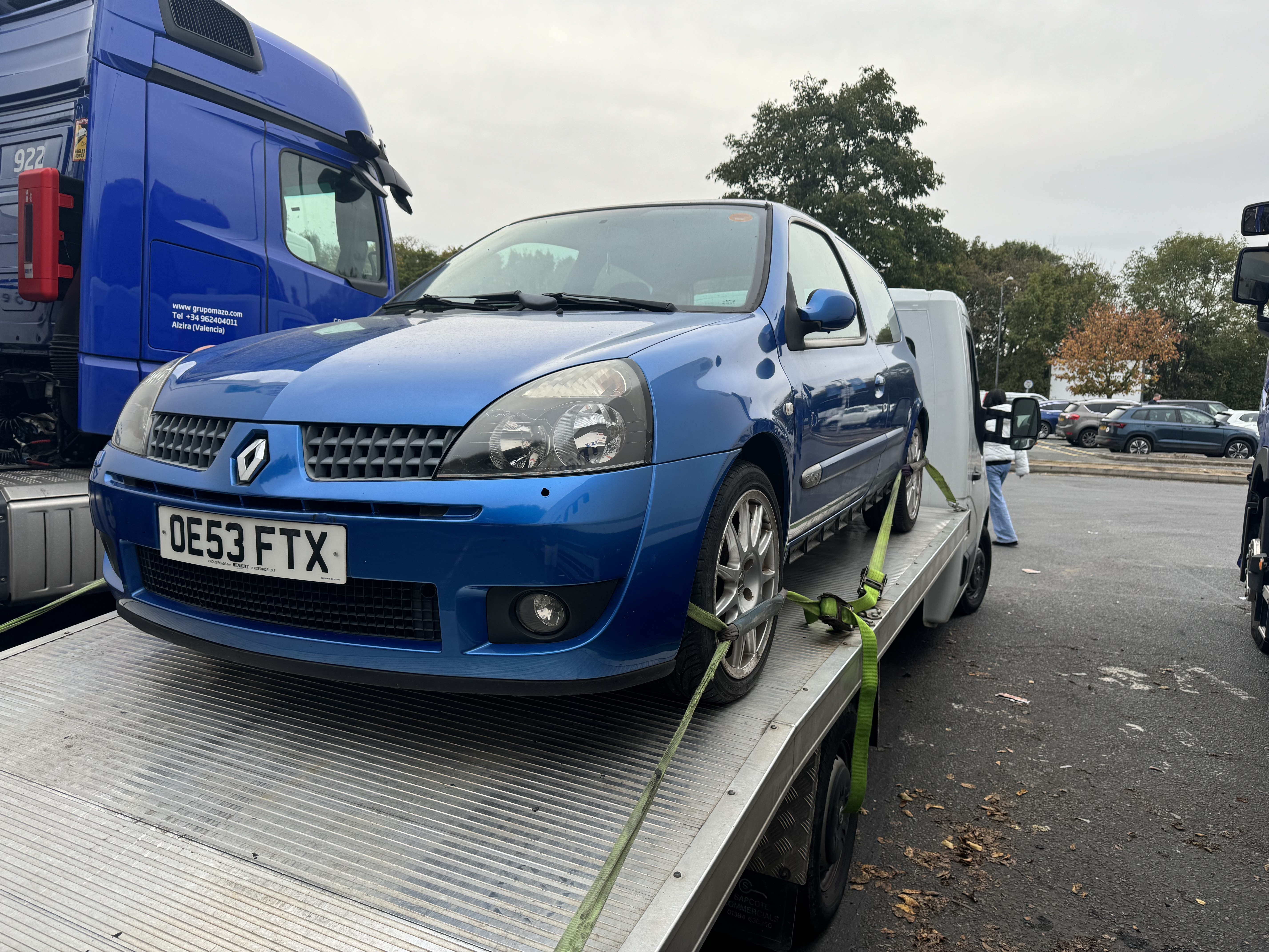

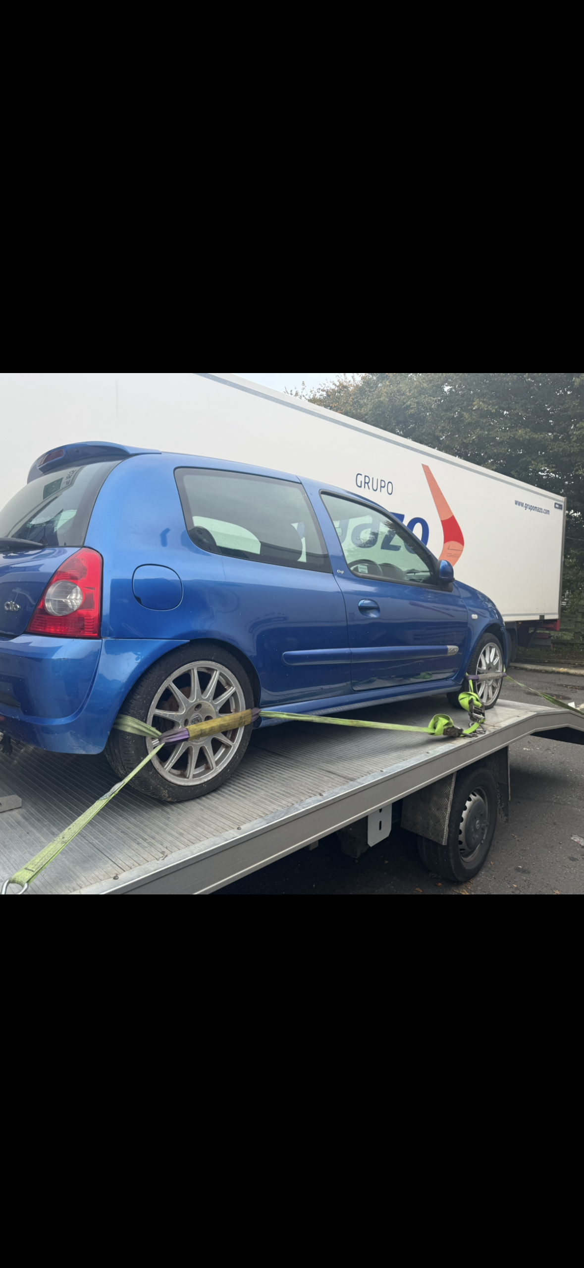

Here’s the story, a clio 172 cup was posted breaking for parts. Got in contact with the owner just asking if it was in one piece. He replied and said yes. 18 months ago someone got underneath it, stole the cat, in the process, damaged the door, side skirt, wing and jacking point and it was then left to sit ever since.
The guy had owned it for 9 years and the owner prior to him 10 years. It’s completely bone stock and untouched with just over 77k miles. Bought as a non runner spares or repairs

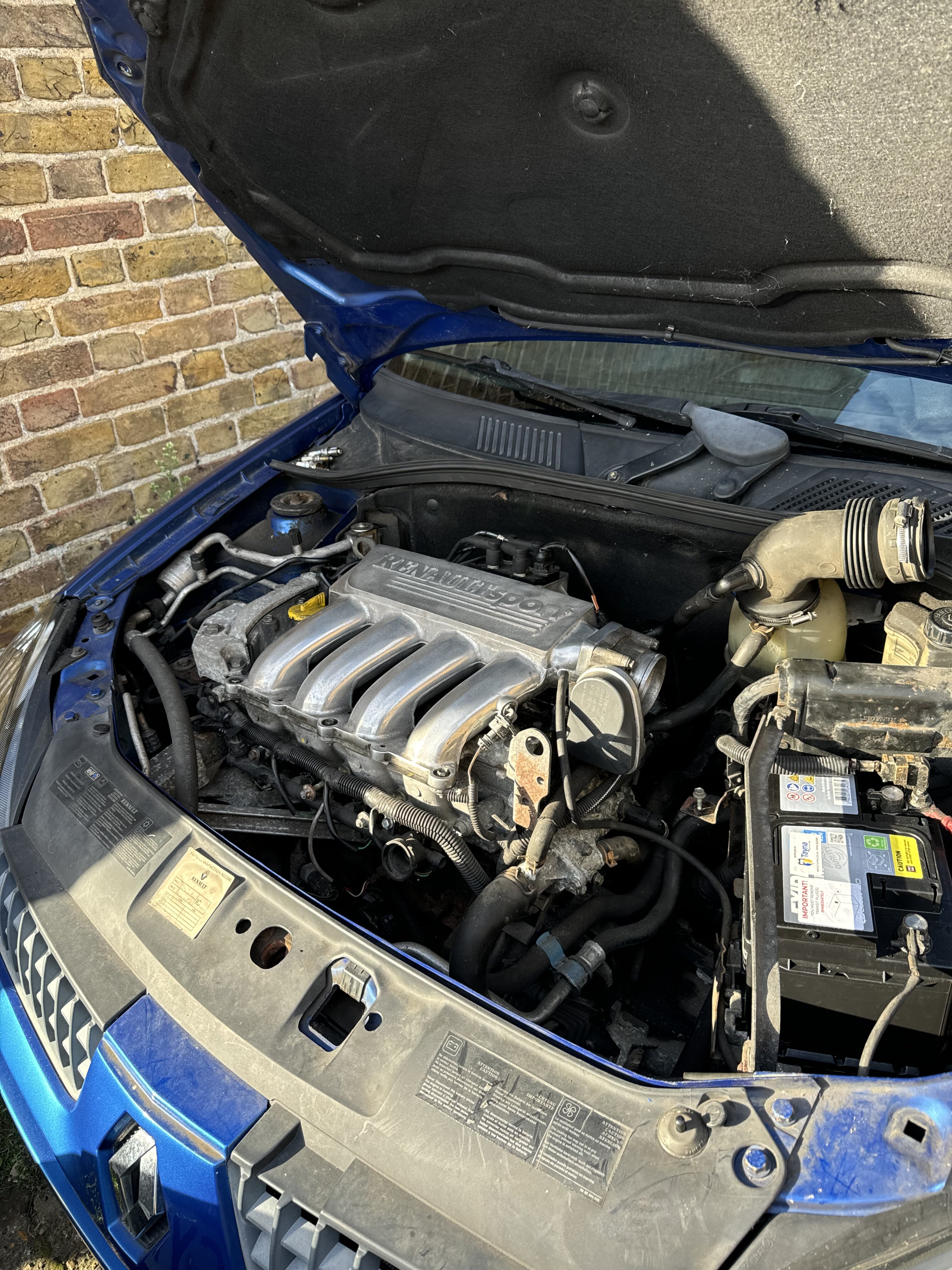

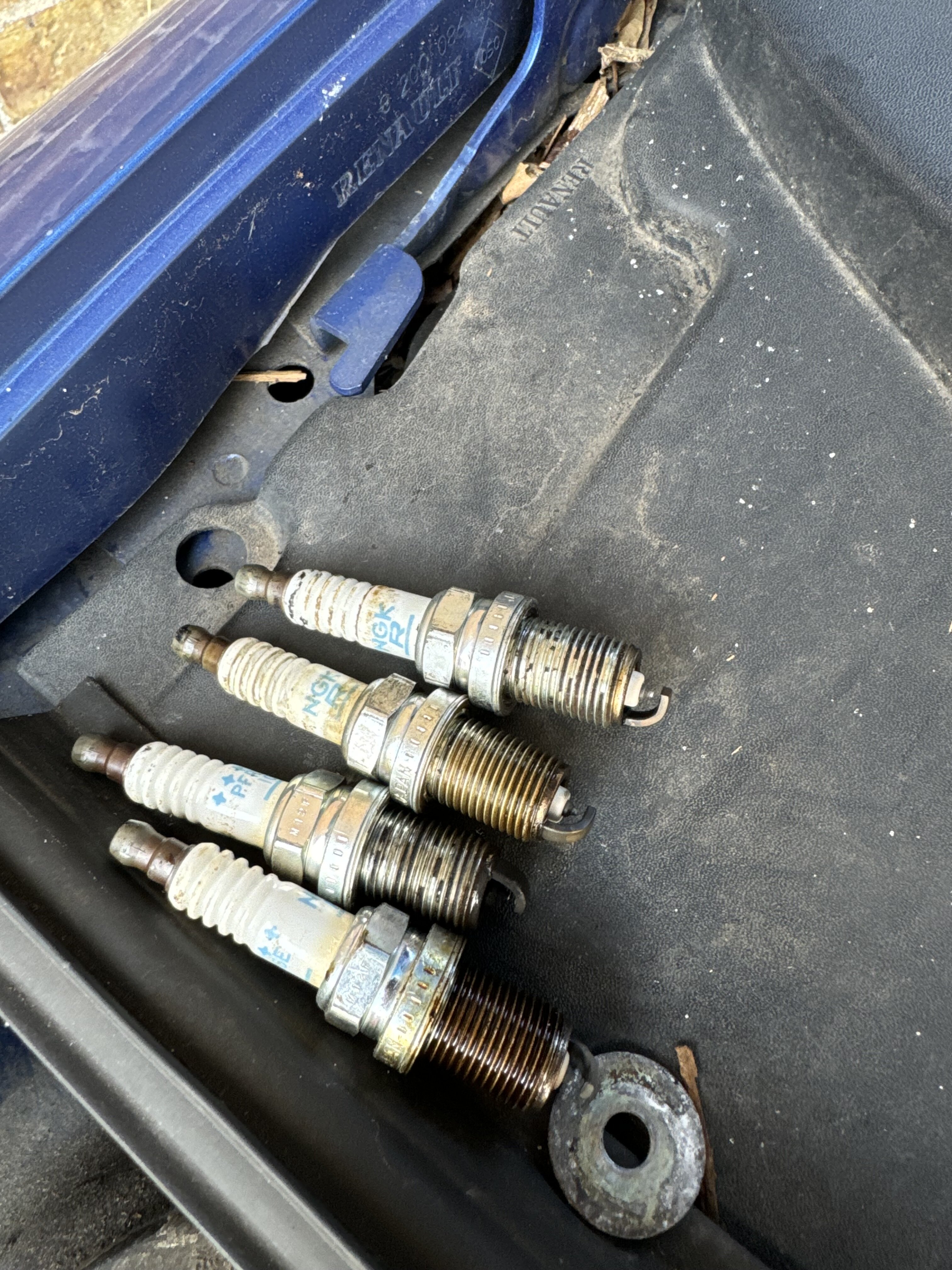

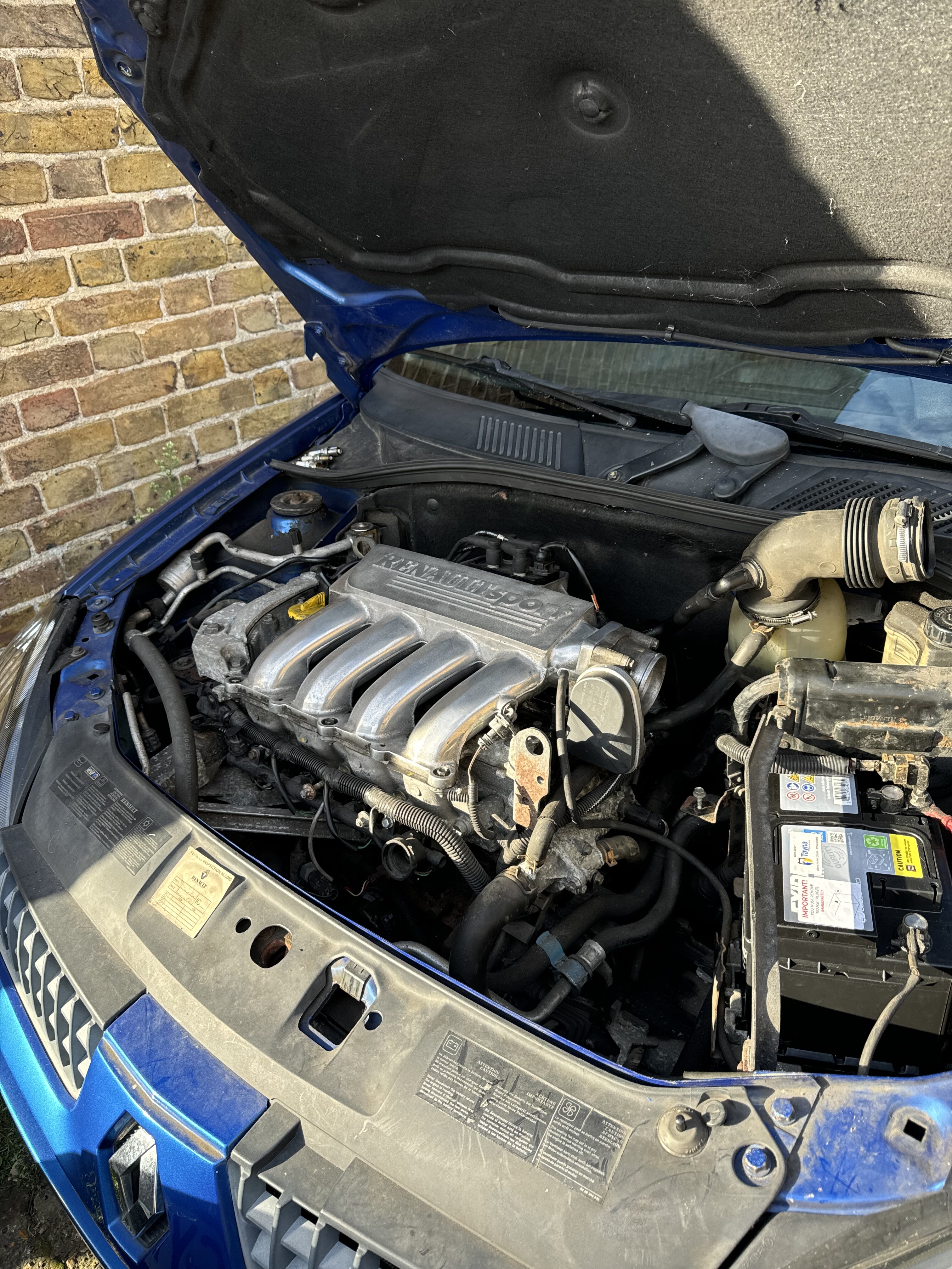

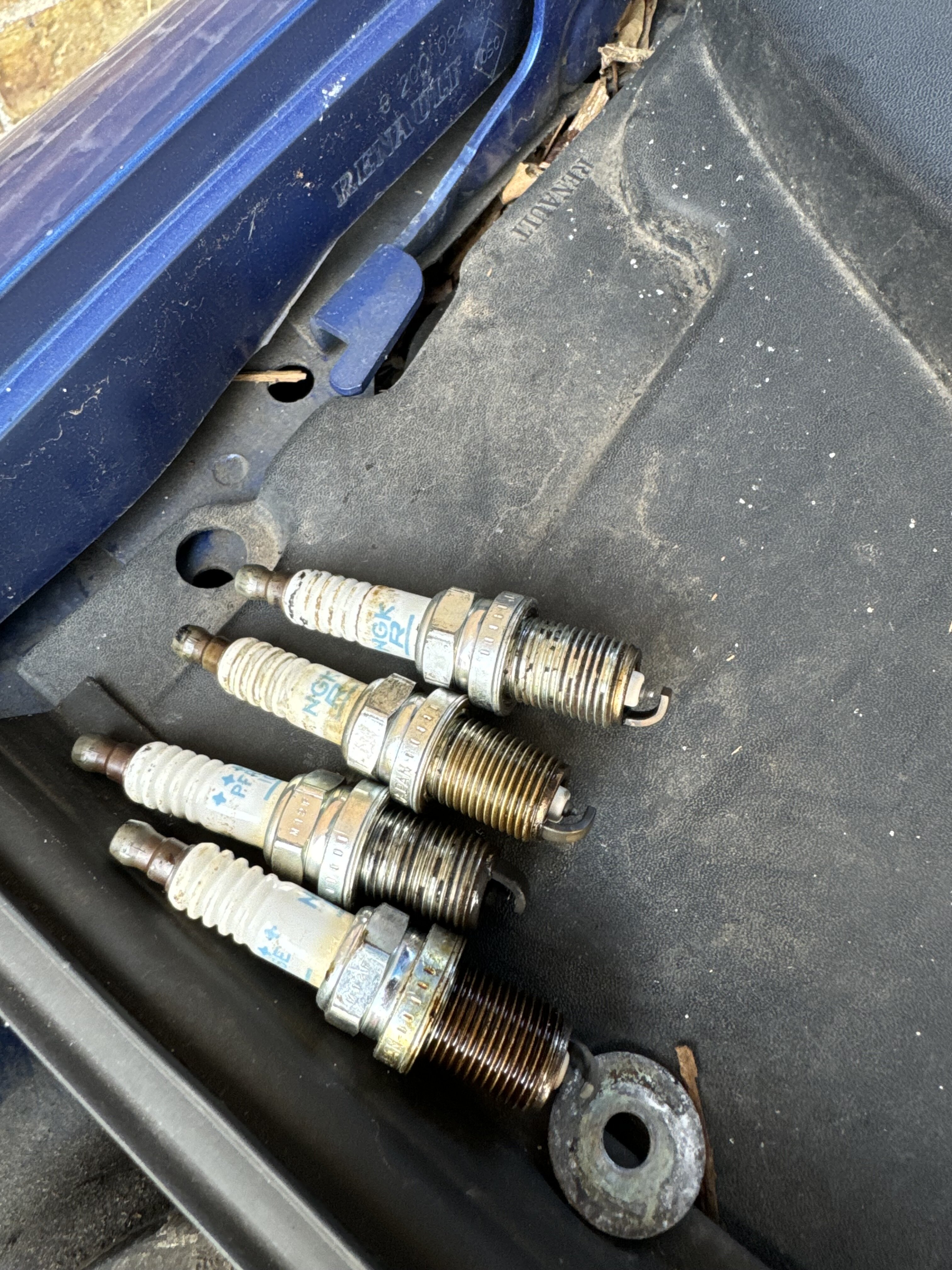

I got it recovered and so far I have fitted new a brand new battery, new ngk r spark plugs, new crank sensor with modified loom. The car cranks strong but will not fire up. I have spark and after spraying break cleaner in the inlet she fired up for 2 seconds! So I know the engine Isn’t knackered lol. I got my multi meter on the injector plugs where they told me I have 2v, fuel pump plug 5v this seemed very low? After seeking advice I’m told there is a chance there is broken wire some where.
This is how far I’ve got and now going to try and get a mobile auto electrician to help me out!

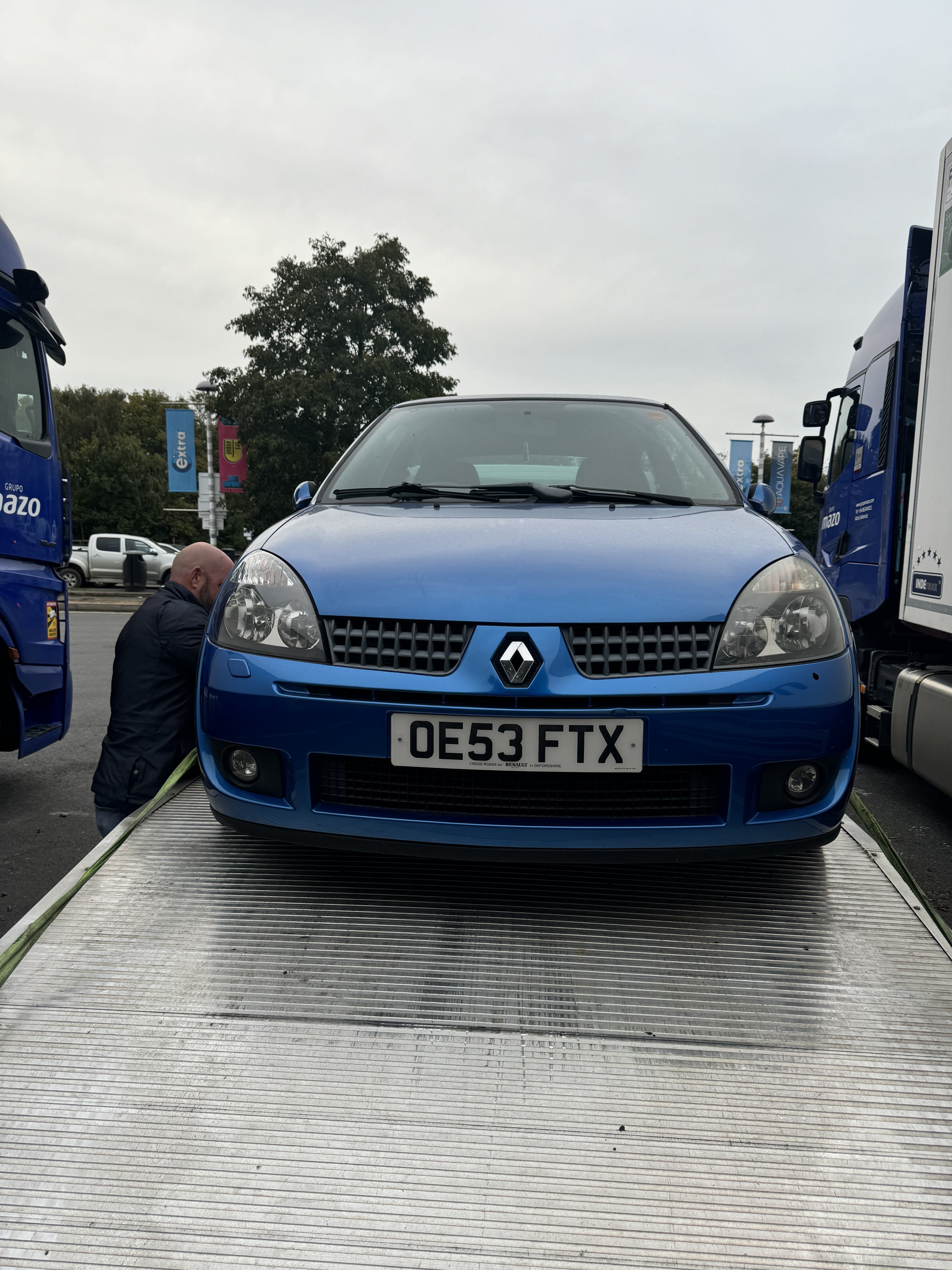

To be fair don’t know I’m not bothering sharing what I paid for it cause I plan on not selling this one for a long long time. I’d love to pass it to my son when he’s old enough. Hard negotiation after having a brand new cat on it. I gave £1300 for it and picked it up myself with my mates flat bed

After hours of work. We found the starting issue. It was a rotten cable in the loom underneath the battery tray which was connected to the fueling system so she runs!
Since then I have done new
ngk iridium spark plugs
Oem coiloack
8.5 blue ht leads
New dephaser
Cambelt
Waterpump
Aux pulley and belt
New crankshaft pulley and bolt
New carbon itg induction ( not fitted )
New oil catch tank and itg breath filter ( not fitted )
She’s well on the way, runs beautiful and pulls beautiful. Few suspension issues, new tyres and brakes and she’s ready for a mot!
