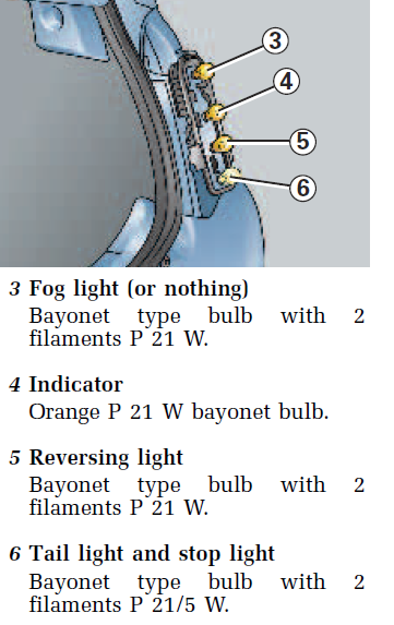

I have a 54 plate Clio 1.2 Dynamique. The back right bottom bulb does not work and I'm pretty sure it used to. All other lights work fine apart from this one, I've even tried the bottom back left bulb in it's place and it doesn't work there. Is this a wiring issue, or does this back right bottom bulb not work on all Clios?
It's No. 6 on this diagram:

Ahh, didn't see that part of the opening post, sorry! Yes its probably a dodgy connector, may just need a clean.
No worries mate :) Which connector specifically? Not too sure what to clean! It's all had a misting of WD40.
All working now, was just the connectors. Sorted them out with a bit of WD40. Never seen so much dirty, suprised they work at all. I now have my back right fog light working and my back right reverse light which I never knew existed, haha! I only thought it had a back right reverse light. Sorted, cheers guys.
