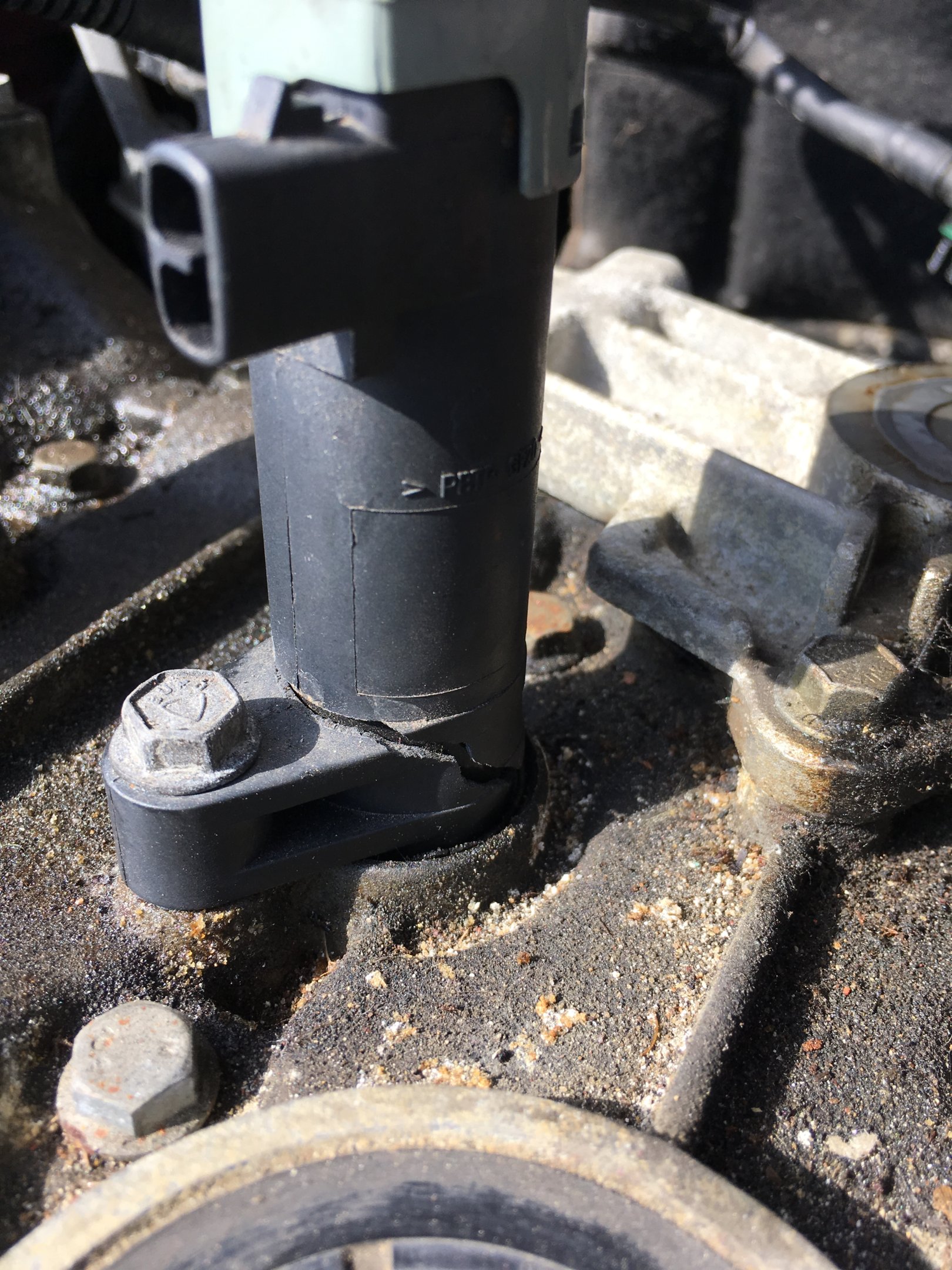

After driving around for a bit, haven't got a chance to go for a longer trip yet, but a it's getting better... just cleaned the throttle body and the RPM is 1k ish, and stays around there... Still struggles sometimes but getting better, so I believe a good drive will fix everything...
Just a quick question what cc fuel injectors does it have?
