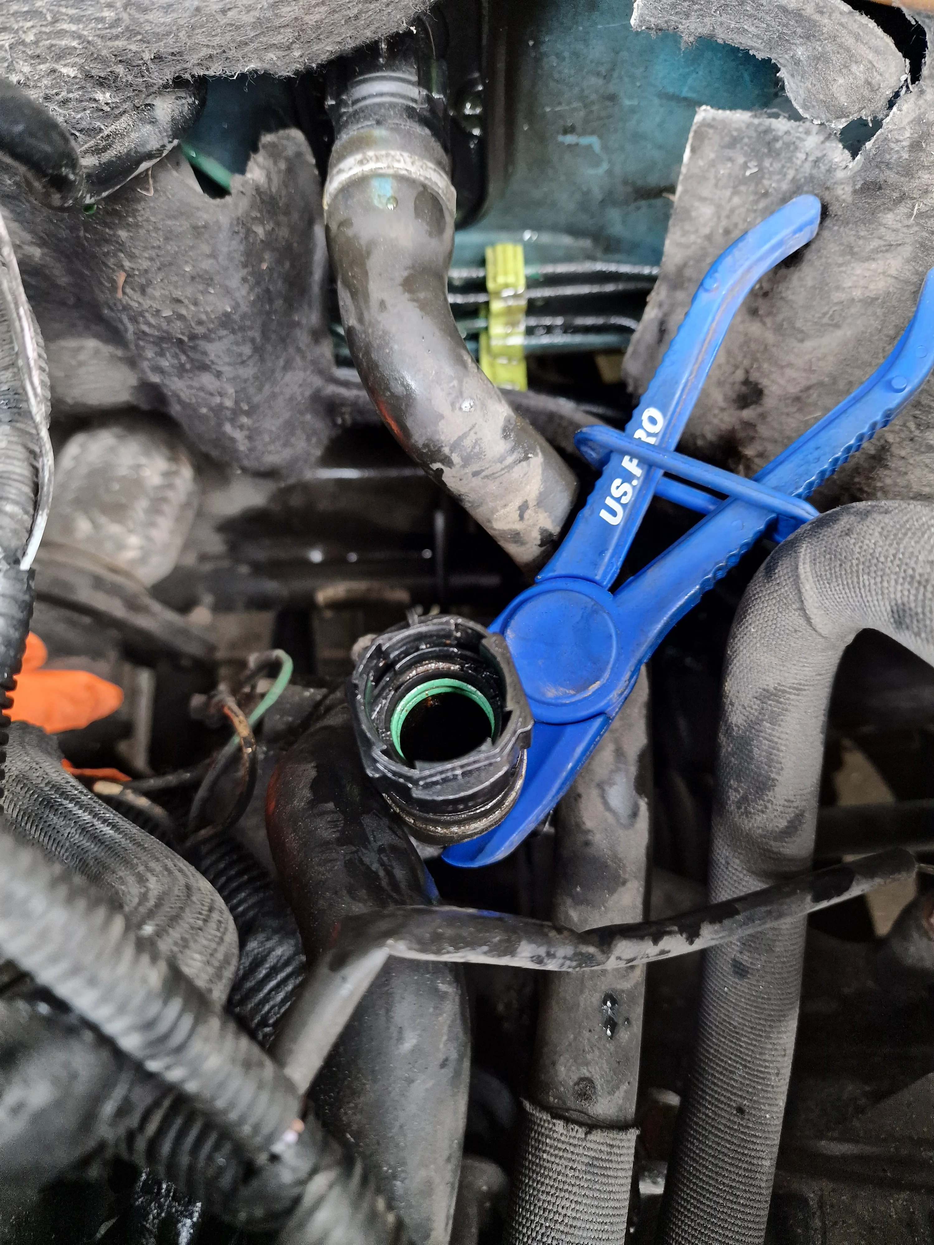

Having an issue with coolant level dropping over 4-5 days, topping up around 250ml. Temp staying where it should be however & car runs as normal.
Had the car pressure tested at renotec as well as a local specialist. Both have reported no visible leaks, only a bit of coolant residue around thermostat housing flange & a bit around pipe from back of water pump.
Had thermostat done & flange vapour blasted not too long ago so that area was spotless initially.
Now seeing a new bit of residue around it, not a lot though. Which is odd considering no leaks from pressure test.
Im scratching my head as this a bit outside my comfort zone & both garages can’t say 100% what it is so a bit lost.
Any advice/recommendations would be greatly appreciated

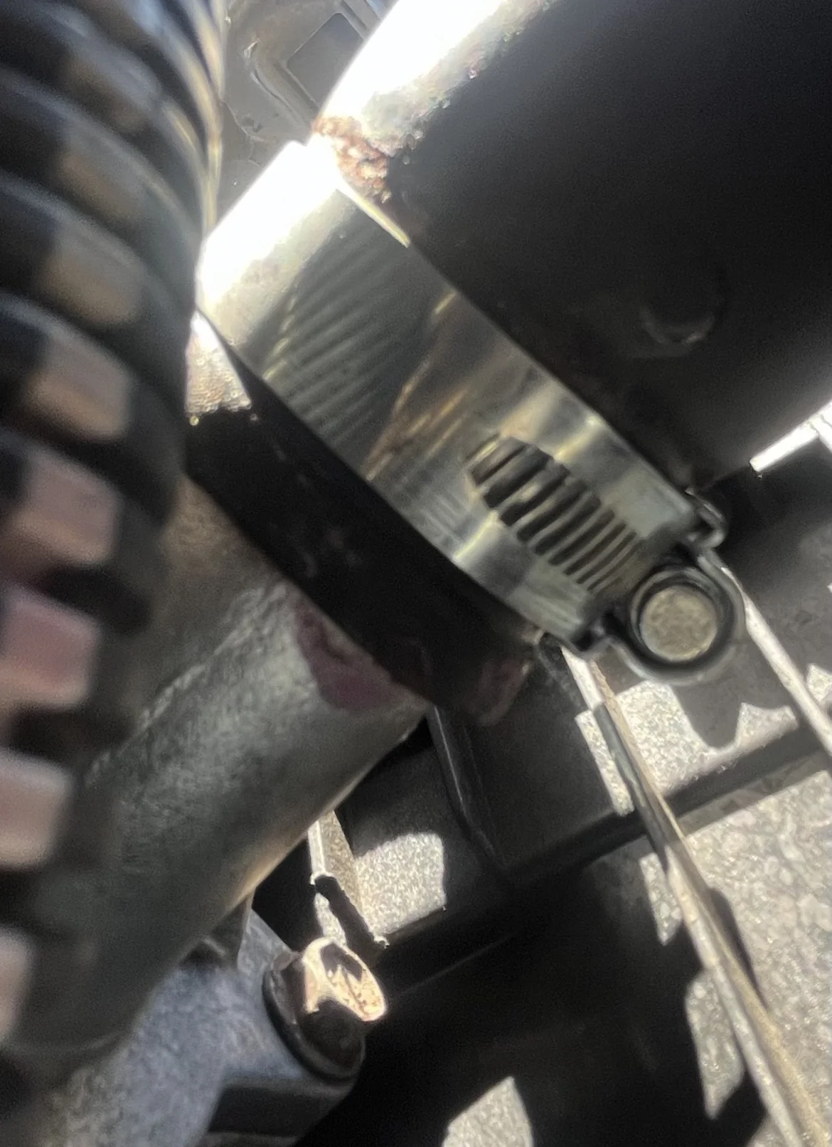

What jubilees are they? Only use JCS Higrips.
Check the heater matrix too and for any damp floors inside the car
Personally wouldn't be using a jubilee clip at all on something that gets hot and expands and contracts. You need a constant tension clip on there imo.
I can't see it being the root cause but it's clearly leaking from there.

250ml every 4-5 days is a fair bit.
When they did the pressure test and couldn't see any leaks, did it hold pressure?
If it's holding pressure then it can only really be burning it.
Yeah not seen it like that before. Forgot to ask if it's holding pressure. Local specialist cleaned the area said check back in 3 days, will ask when I go back in.
Think it is JCS if im not mistaken had it done at AWM.

Just a very small amount below the cap and down the side of the expansion tank.
Jubilee fine if its tight. The oem constant tension clamps arent perfect and let by when stood. Common to see a bit of fur in the stat area especially on occasional used cars as it does not evaporate with daily use.
As above 250ml is a fair bit. Id pressure test again and borescope the heater box to see if any traces of coolant leaking. I had all this carry on with the kangoo and left cooling system pressured up at 1bar for a couple of hours and it was the heater core.
If your worried about h/g, pull the spark plugs whilst the cooling system is pressured up and borescope. Highly unlikely any h/g issues unless running poorly or misfiring from cold etc, usually obvious when looking at plugs if any coolant has been in a cylinder.
Cheers Brigsy. Yeah it’s a fair amount tbh thankfully caught it early. Engines been pretty good sometimes can go a while without opening bonnet but decided randomly to open it while at Tesco to find it on min, horror.
Not too worried about h/g atm it’s been running as usual no misfire, smoke or oil cap sludge; more so heater matrix heard that’s not the easiest job. Is it not always obvious from coolant in cabin if that?
Yep should get a whiff of coolant inside cab if heater is leaking, can borescope the lower vents in heater box to see if any crystallised coolant deposits
You can get UV dye you can add to the coolant and can then use a UV light to see if you can spot where it’s coming from.
As above though, I had issues with mine with a s**t aftermarket cap for the coolant bottle. Issues went with the old original back in.

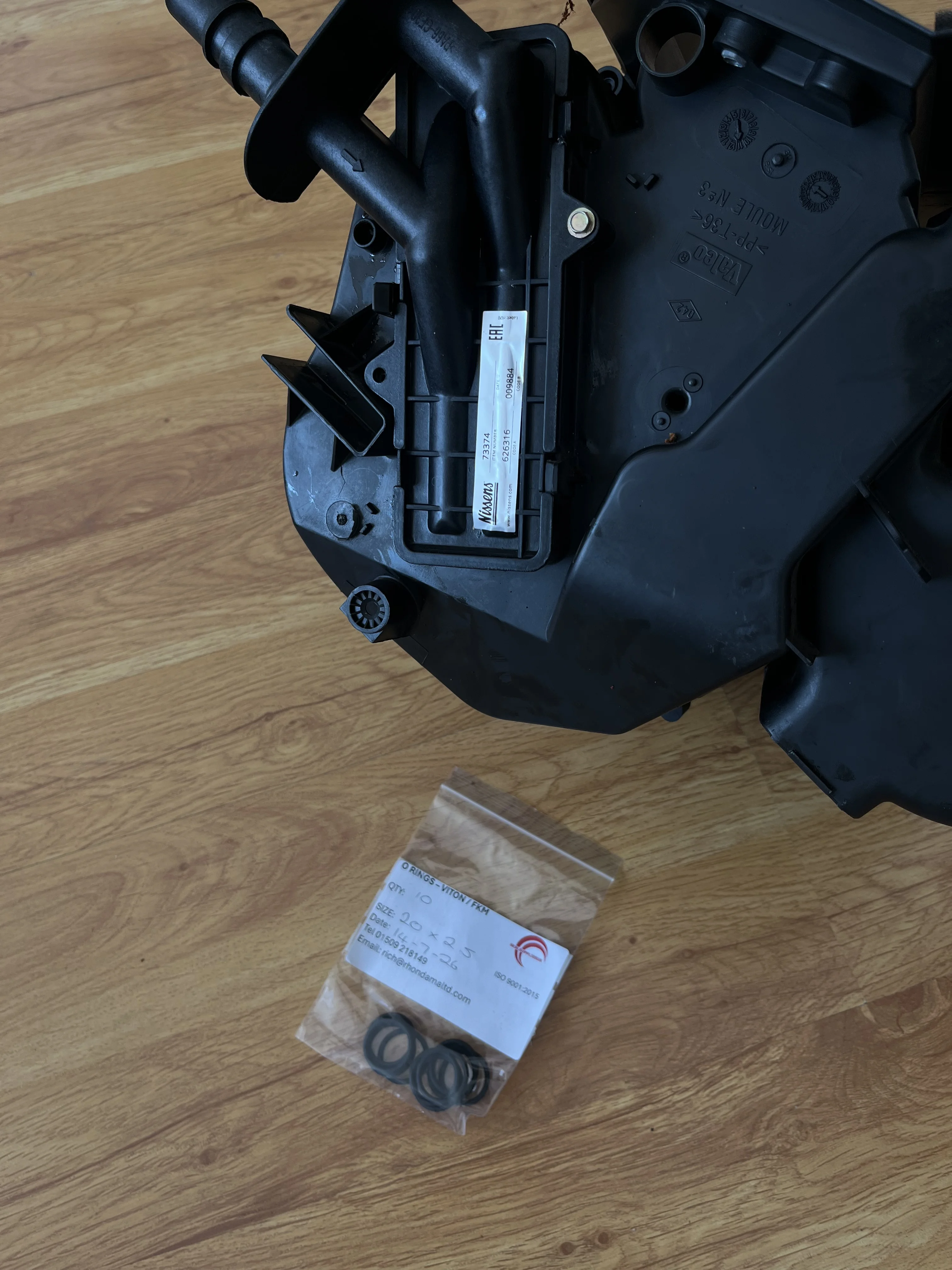

The connector o rings will most likely need changing as the orings go flat and will leak, buy 4x 20MM ID X 2.5MM C/S viton orings and replace if necessary.

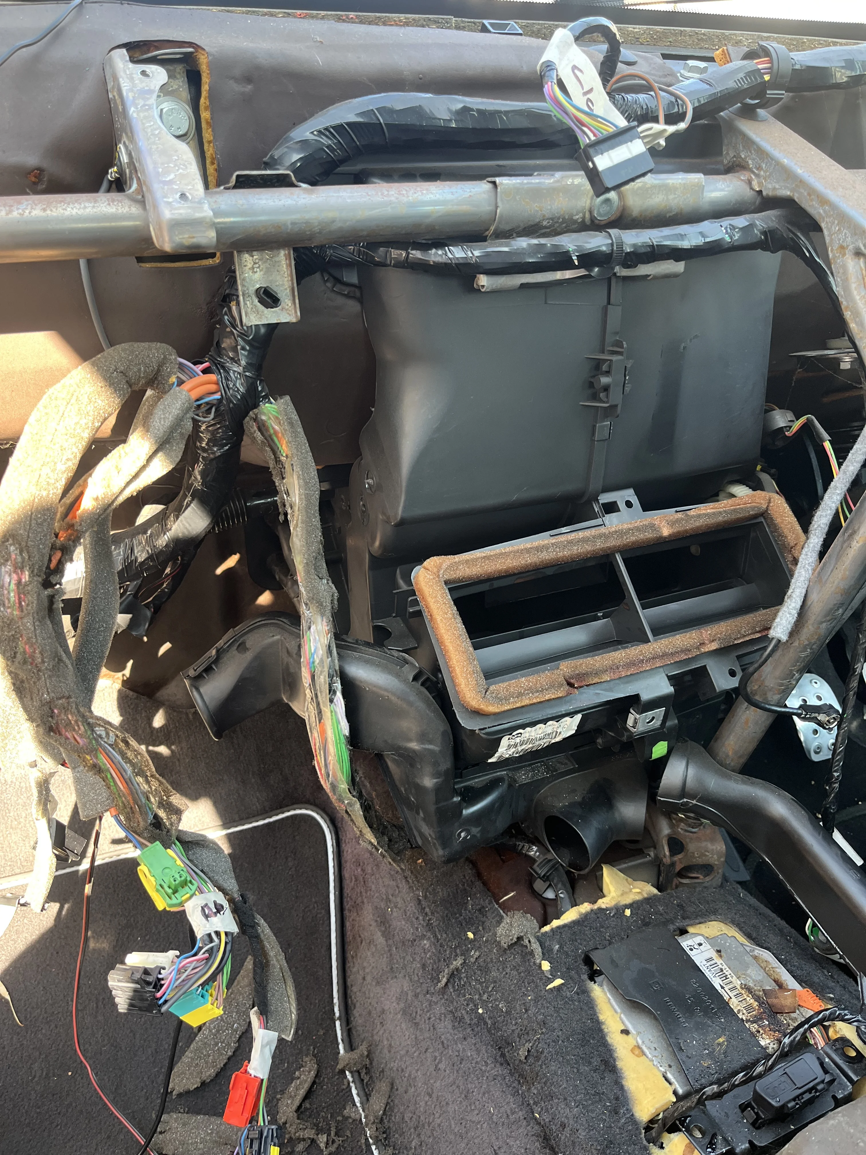

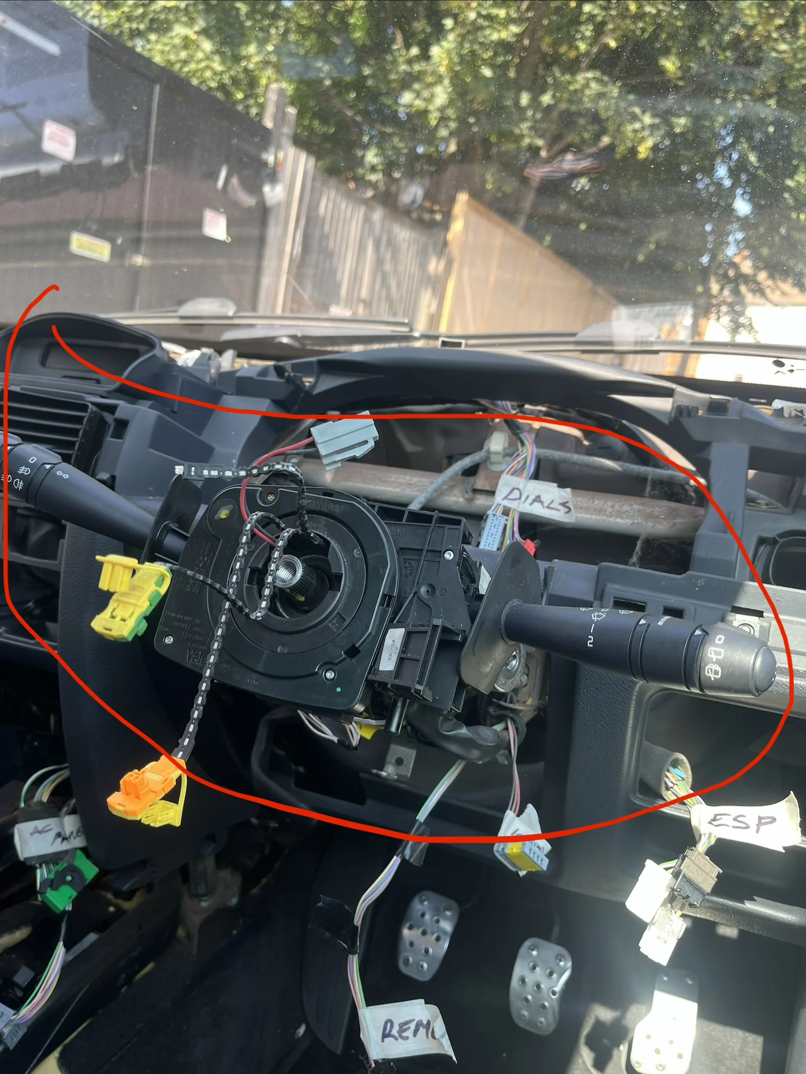

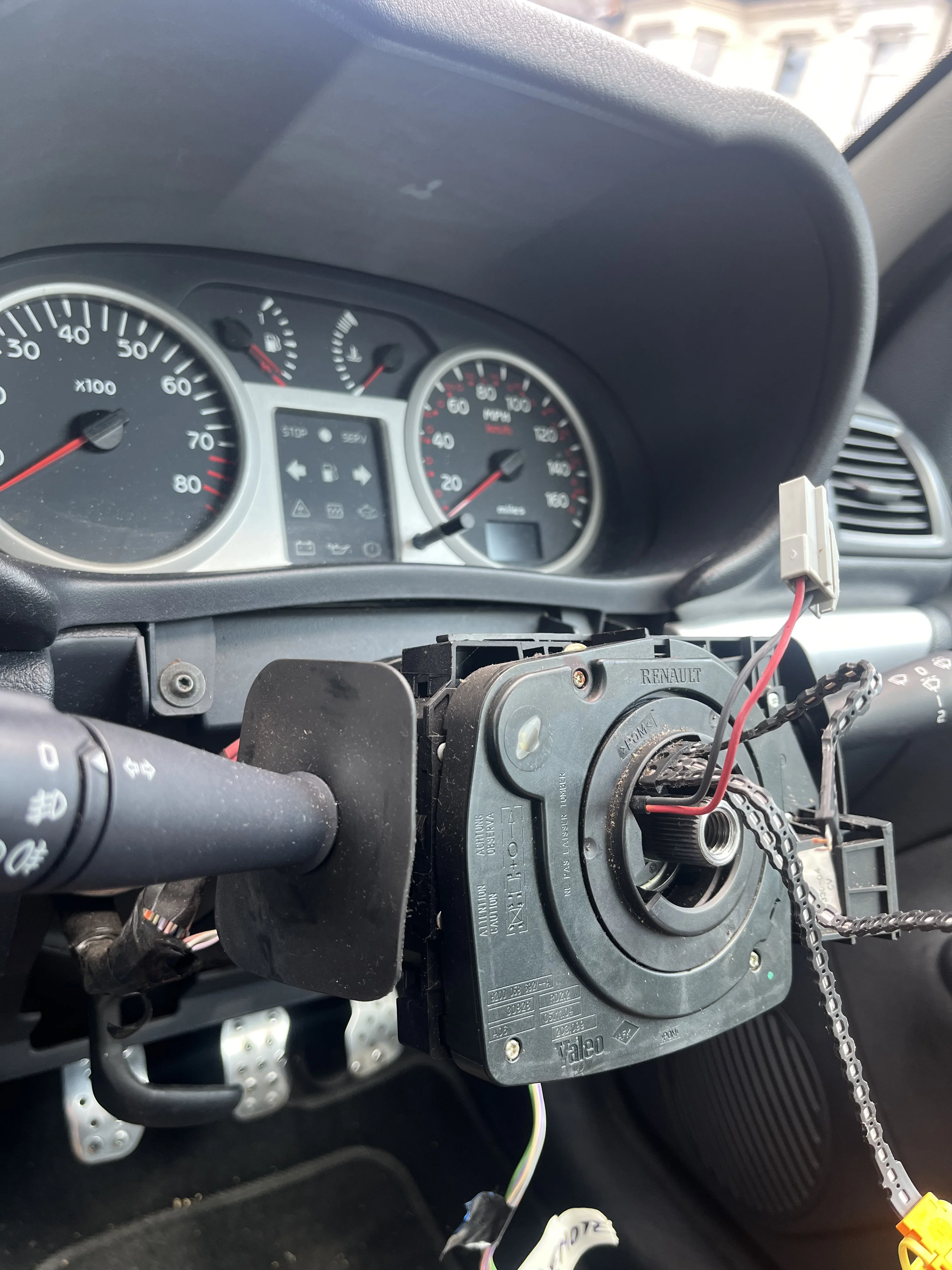

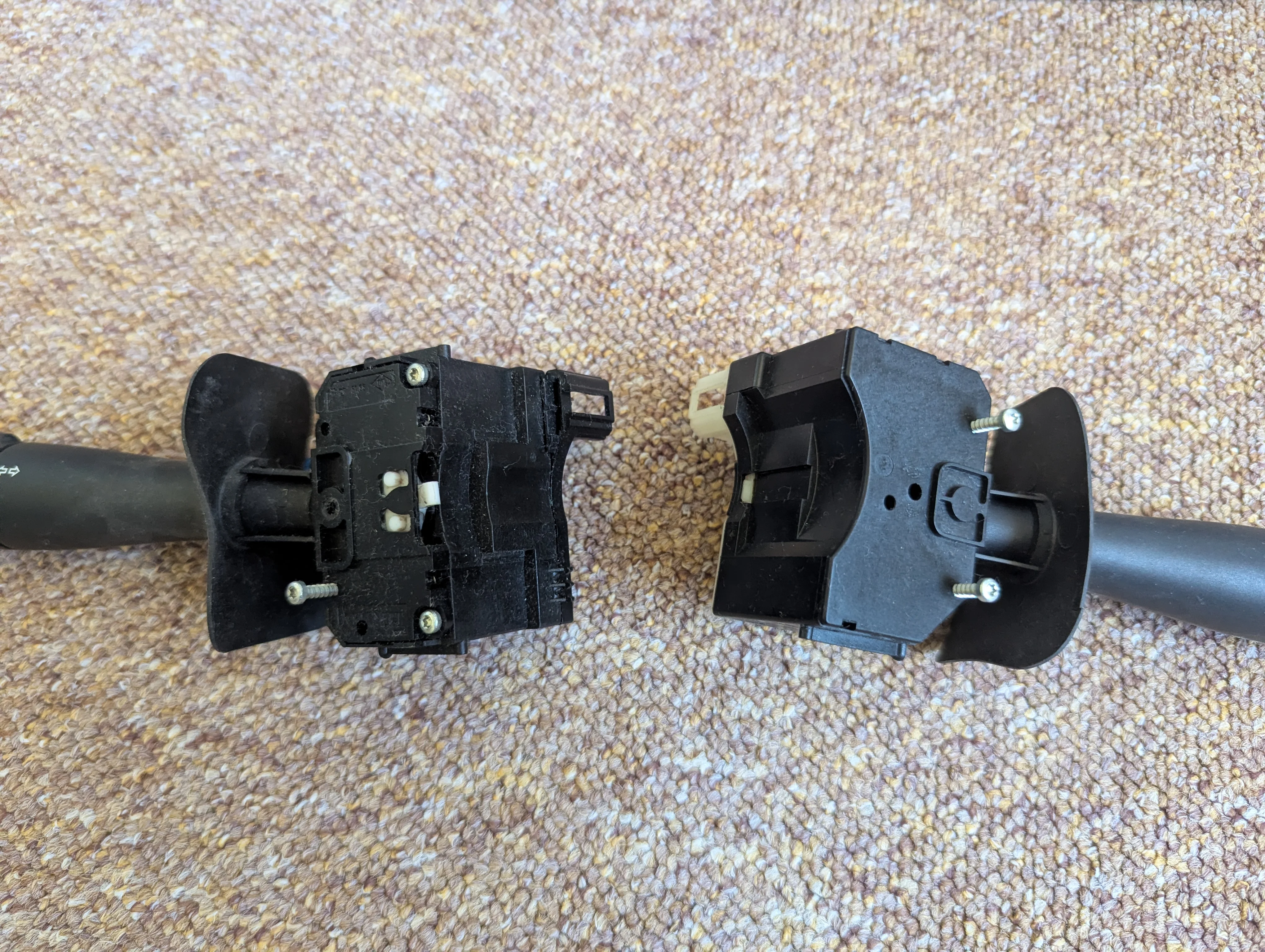

Afternoon gents having a little feel of getting the dash out, not ideal so far.

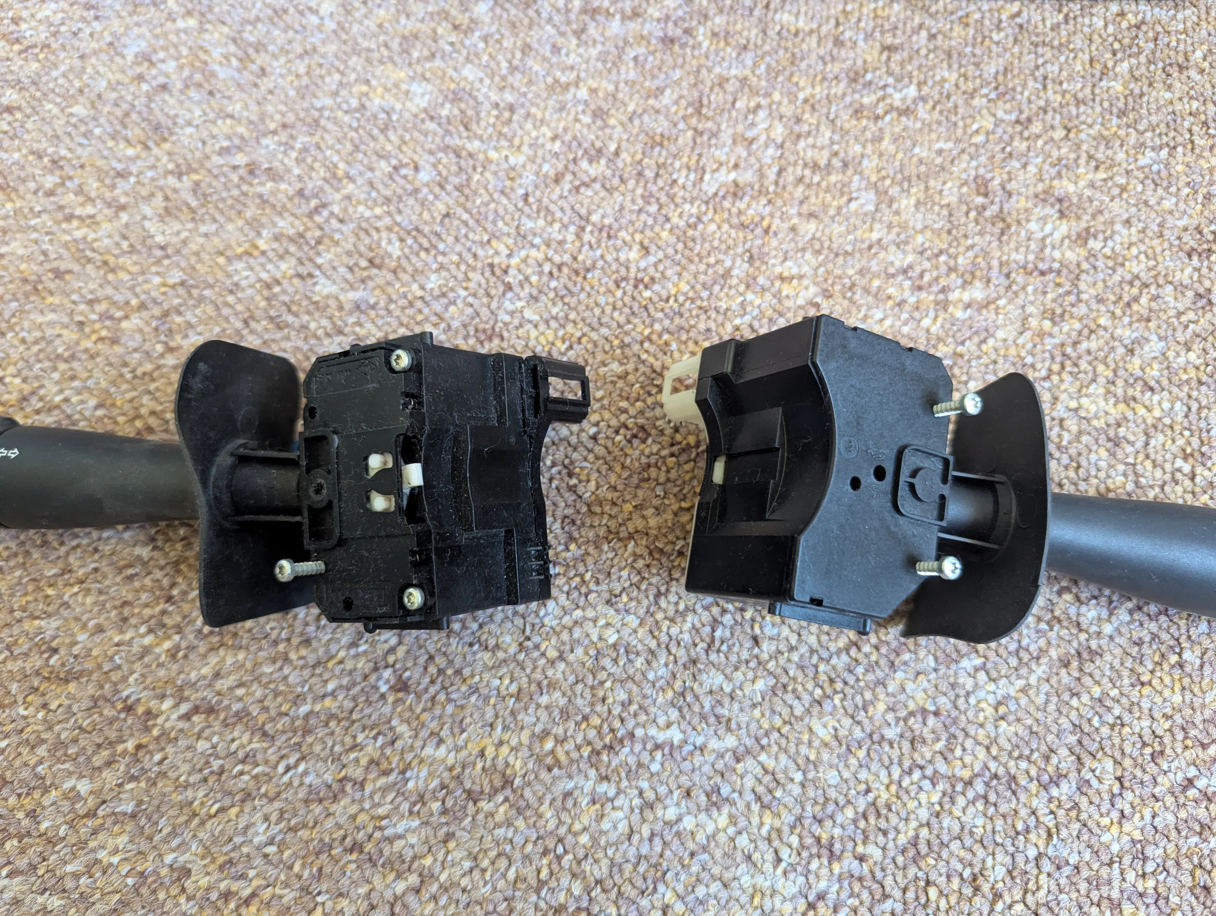

How does the stalk unit come out? Does squib have to come off first or can I take it all out in 1?
Undone the screw underneath stalk which has loosened everything but still stuck on there
Cheers
Sorry chaps not sure if was clear with my previous question don’t know what everything is called
Does this entire thing come off as one with the stalks attached or does it come off in bits
Dash is out after some sweating. 2 questions
Does the box want to come out entirely
Should the matrix pipes to bulkhead pull out by hand?
Any advice from here massively appreciated brains slowing down a bit.
Many thanks
Box needs to come out fully. 2x bolts under scuttle in centre. Metal dash bar needs removing first.

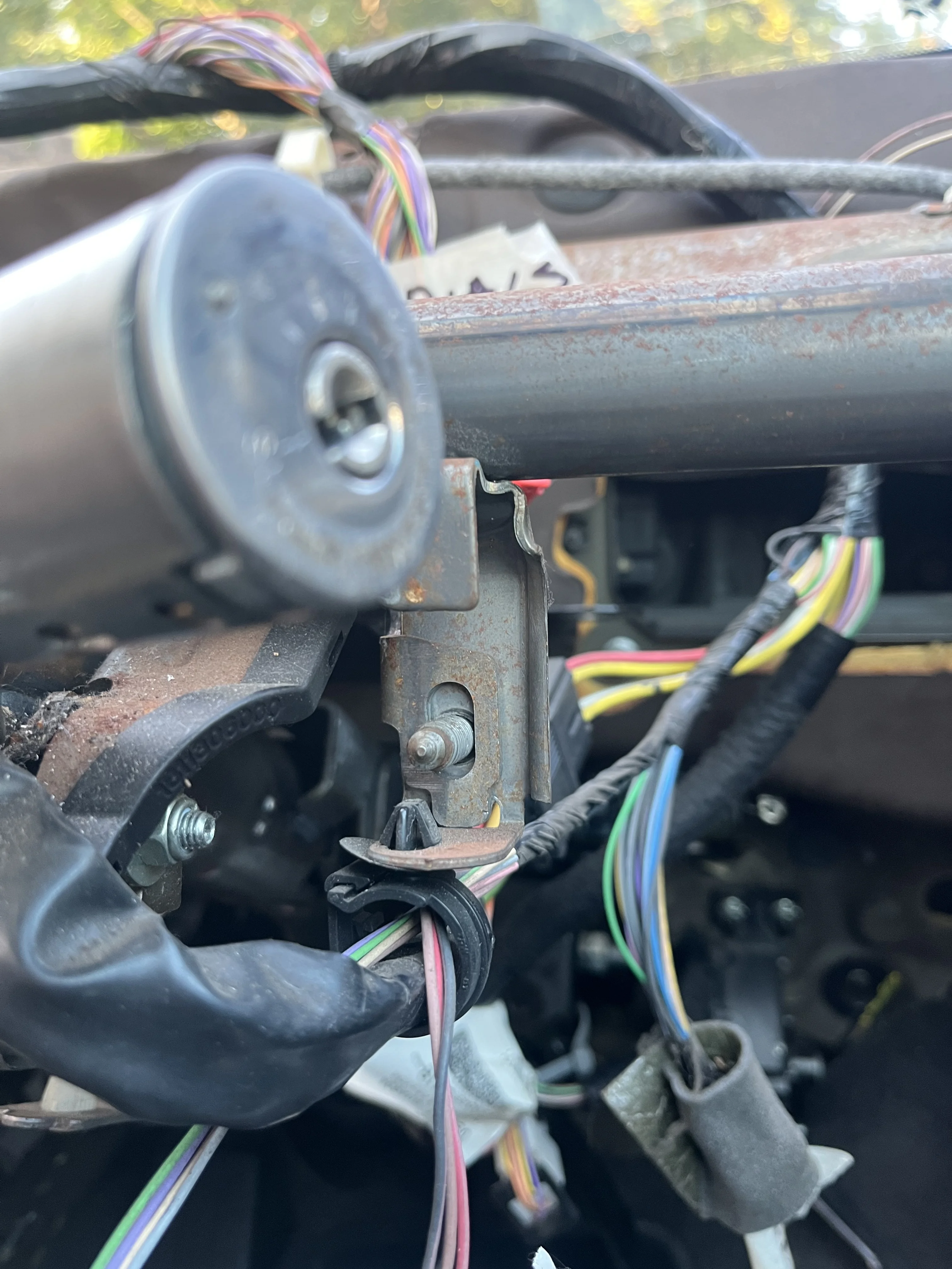

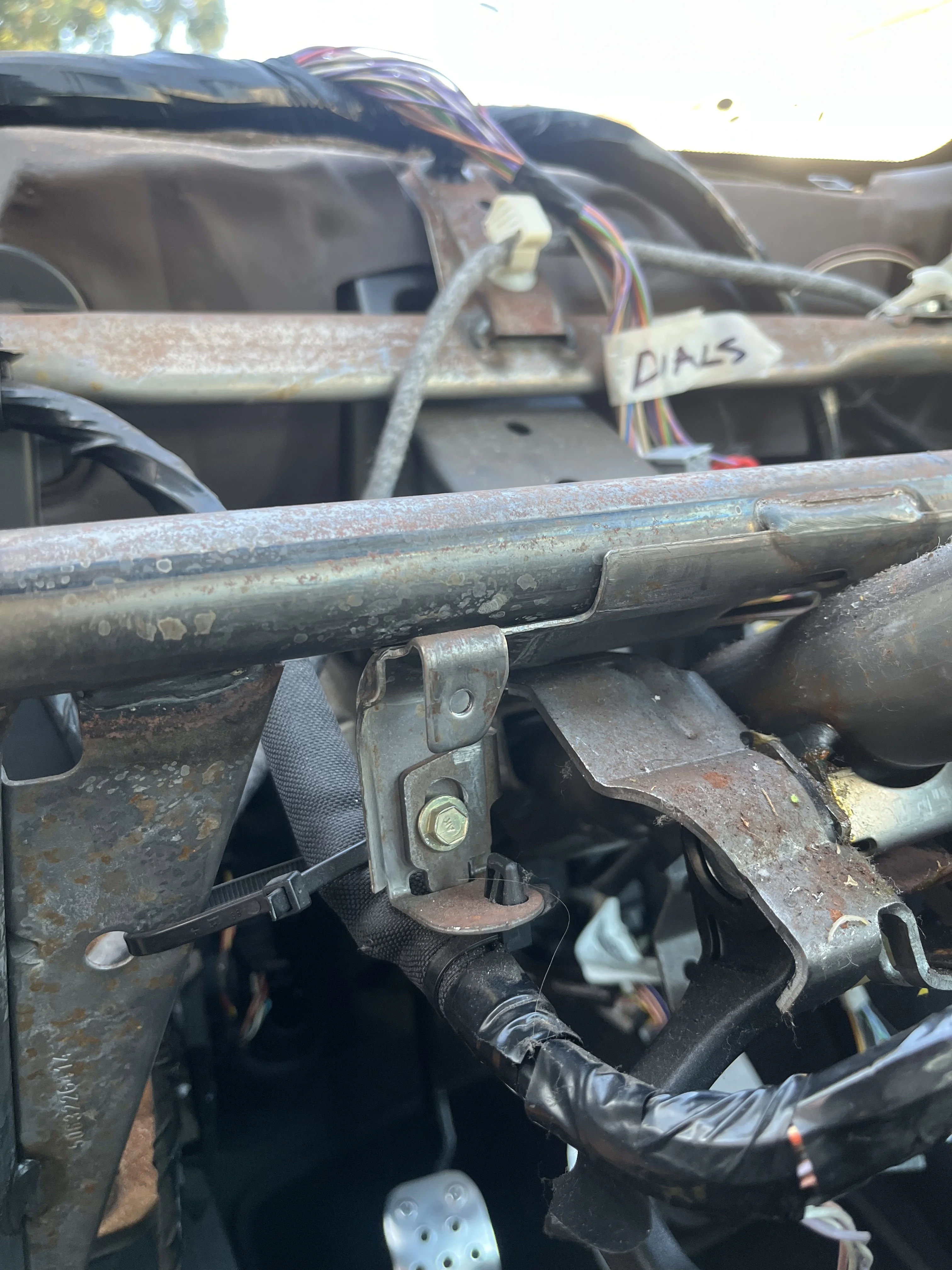

Does metal dash bar absolutely have to come off ?
How does the bar come away from the column? 🫩 all other bolts off but can’t get it to come away from here
Finally got it @Brigsy pliers recommended came in clutch mate thanks.
Didn’t come across any O- rings when disconnecting however do you know where these will be located?
Cheers
Orings are in the connector, you will need a pick to change them. There is a plastic spacer washer inbetween them from memory.
Make sure you give them a good push on until they click in place when refitting and a light pull to check they dont come off. s**t design being honest.
