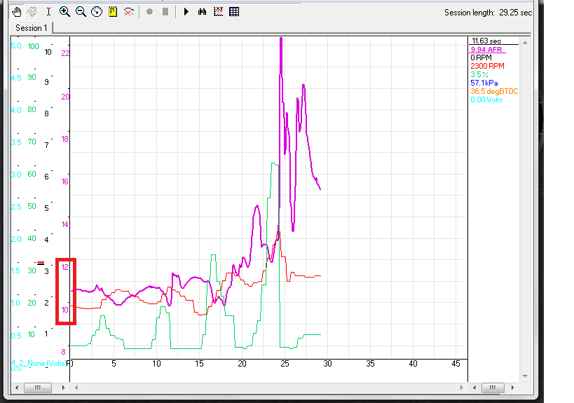

A customer asked me to have a look at her 438'ed Clio 182.
It had a very bad hesitation from cold start until warm. There were no fault codes, fuel pressure was checked and all live data from the sensors monitored and all was fine.
I decided to run an AFR log on the car to see if it had been Mapped correctly for the cams. Heres what I found. Even tho she had called the "mapper" who told her, without even looking at the car, the map was 100% spot on fine when she contacted them about the fault before seeing me.

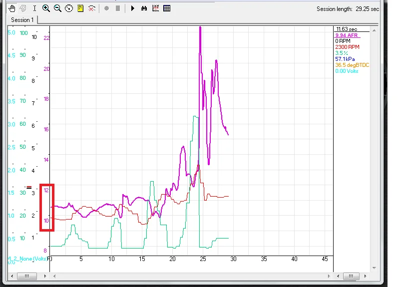

Here a screen shot of the hesitation.
Purple line is AFR which hit 9.5:1 when the car starts hesitating. As soon as Lambda is warm enough and kicks in its fine.

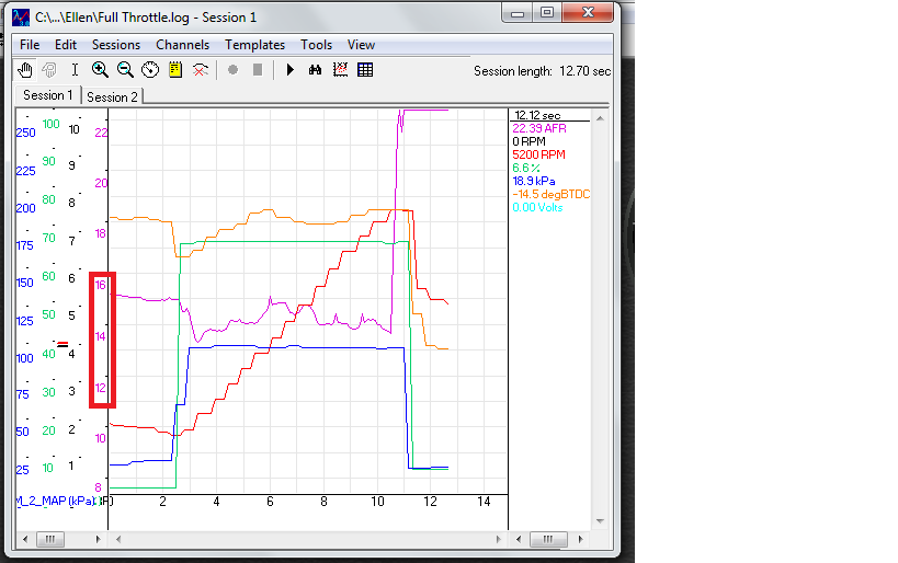

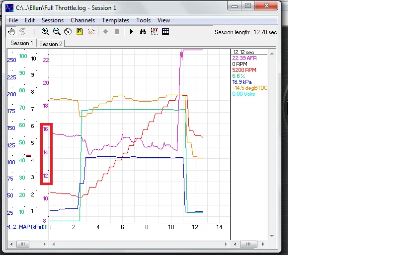

Here a run at full throttle
Peaking 15.1:1 AFR and the richest it gets just for a split second is 13.8:1. As you can see from the log this was held at full throttle.
I reported my finding to the customer who has called the company thats Mapped the car and told them what was found. I have also give the customer a copy of the log files.
The responce from the Mapper....... Theres Nothing wrong with it. Its perfectly safe to drive hard.

When Ellen first described it to me I said it sounded like it hadnt been mapped right so I cant pretend to be surprised, but that really is epically bad that, obviously when they mapped it the car was warm so they never did the part load mapping and just relied on the lambda sensor to correct it for them.
This is why IMHO when doing a change as dramatic as cam profiles mapping really needs to be done over a couple of days period.
If she ever has the lambda sensor go wrong of course it will mean that instead of just kangarooing around for a short while until warmed up like now that it drives like that the whole way until the sensor gets changed as it will have to live on the open loop map.
Im amazed that even they would think that data log was acceptable, I know from other threads on here they tend to have a bit of a reputation on here for taking money and doing half a job, but even so Im gob smacked they didnt just say straight away to bring it back and they would sort it when faced with such black and white proof that it was that far out.
What did they suggest to her was the actual reason for the problem then if they said it definitely wasnt the map as presumably they offered an alternative explanation for the kangarooing or did they just tell her she must be imagining it? lol
15:1 AFR under full load isnt just losing power either, its risking the ring lands on the pistons too IMHO
I would have thought it better to disconnect the lambda while mapping a car surely? The lambda should only really be there to trim the map not correct for a s**t one :(
