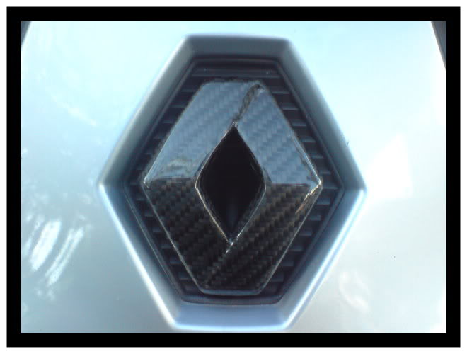

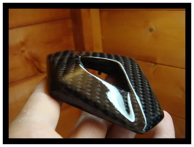

Front just pulls off, back is a pig, needs the boot release all removed then to be removed from the behind as its glued.. leave the paint.. add some carbon love instead

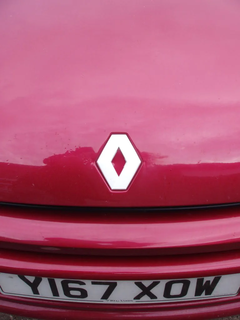

yea, just dull the badge, using essentially a kitchen scouring pad, if your going black just give it a few thin coats of matt or gloss, leave for however long the can says, then a few coats of lacquer. if you get dust in it and it really bothers you, maybe flat with 1500 VERY gently, its a tiny piece with raised edges you can easily sand through. TBH, it's small, and you'll prob get a stone chip in it anyway if you spend ages. mine, in white.
