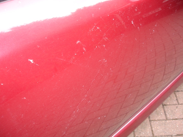

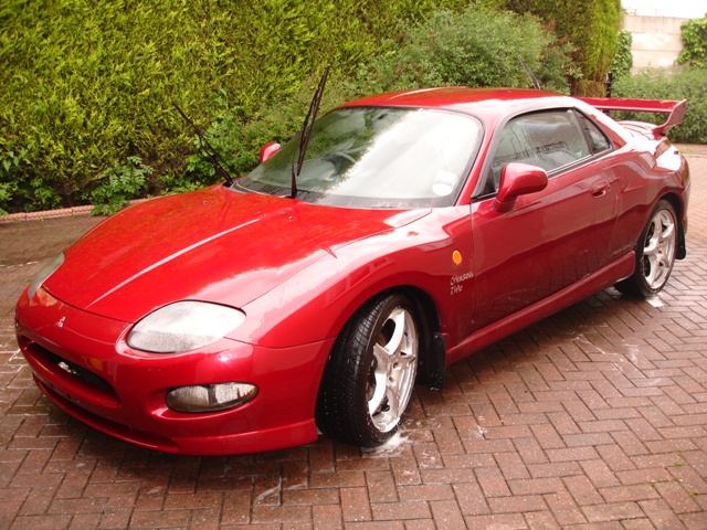

Evenin' everyone Today's bank holiday was spent working with my mate on his much loved "driven not detailed" FTO. However, he had agreed to let me loose on it with the few products I've been collecting over the past weeks. We were by no means after a full correction (there were plenty of deeper scratches and even clear coat failure on the bonnet).
Anyway, onward to a few before shots

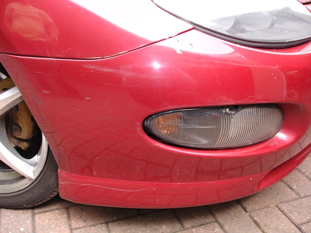

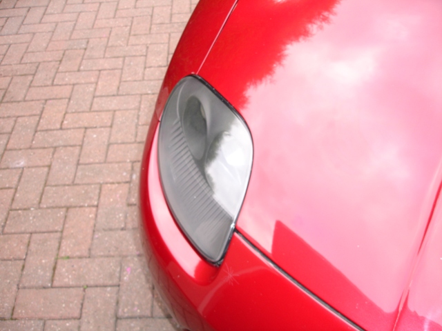

There were also a few issues with the headlights
Dirty
Dirty and swirly!

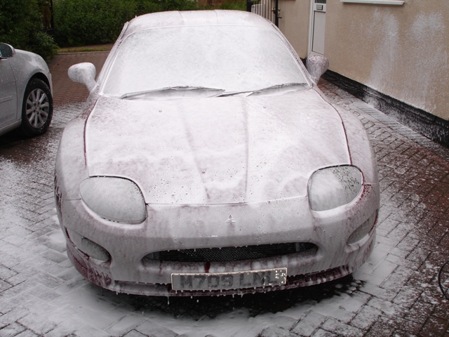

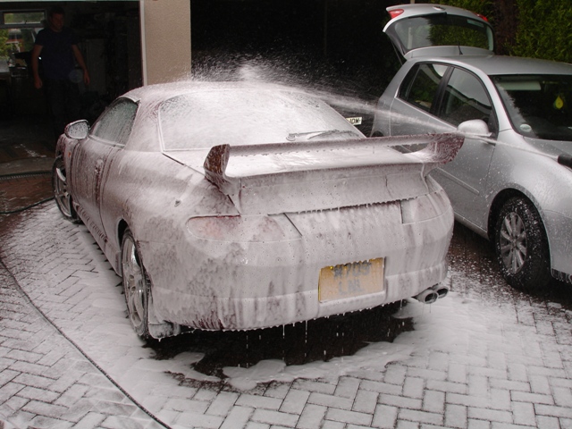

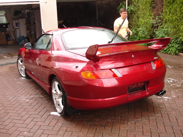

As you can see, not a pretty looking motor at the moment! Gave her a quick spray and snow foam to get the ball rolling. Also used some Valet pro wheel cleaner with a bit of agitation from the wheel brush the grime just fell off :thumb:.
I like the snow foam Here are a few shots afterward

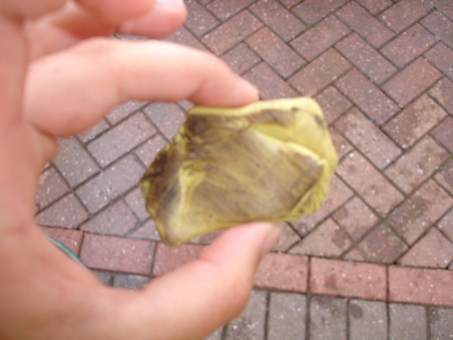

Next to the claying, the car was covered so had to resort to the tardis I've purchased from eBay a few days previous, never used it before but was pretty impressed with the results.
The clay!

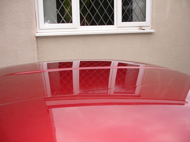

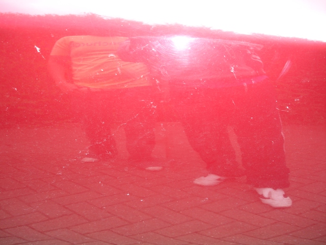

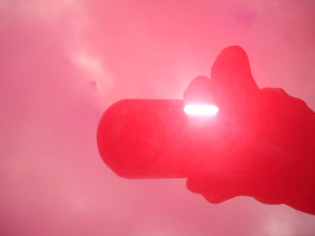

A quick swirly shot after drying, I can't remember which panel it was, oops!

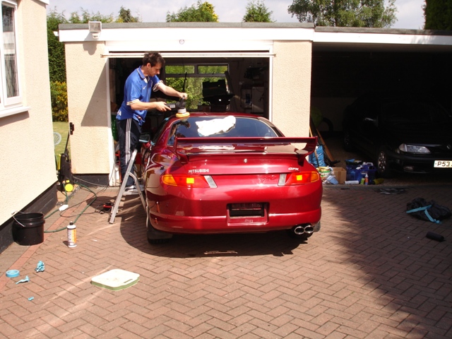

Had quick play with the products I had available but the damage was pretty heavy so ended up using Menz Power Gloss with my Das 6 :buffer:. I followed this up later on with Menz Final Finish.
Here is a quick 50:50 of the boot. It's not perfect under close inspection but it's pretty dam good. Good enough for what we were after anyway. :thumb:

Me in action! I'm not very tall

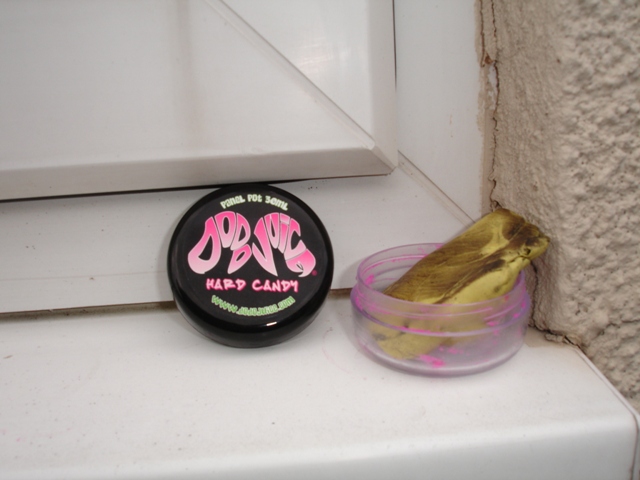

Gave the car a quick IPA rub down followed by some Dodo Lime Prime Light and then it was on to the waxing, we had a sample tub of Dodo Hard Candy (not 100% sure this was the best wax for the colour but it did the trick). We used all of it!

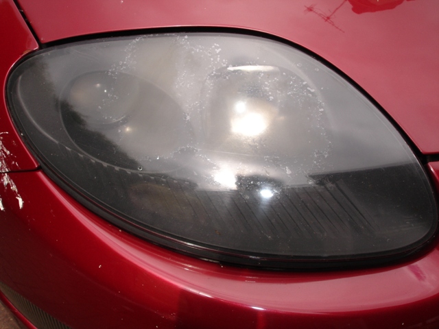

A bit of 1500 wet and dry, rubbing compound and some polishing left us with this on the front lights, much better

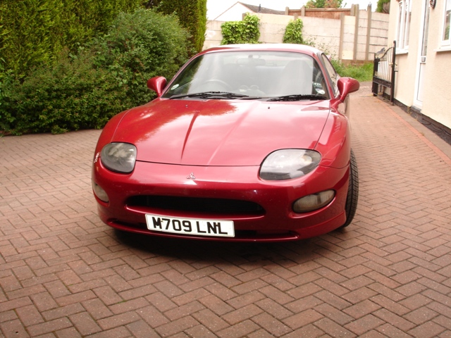

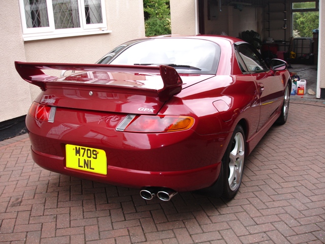

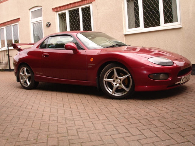

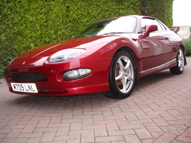

Here are a few afters.
