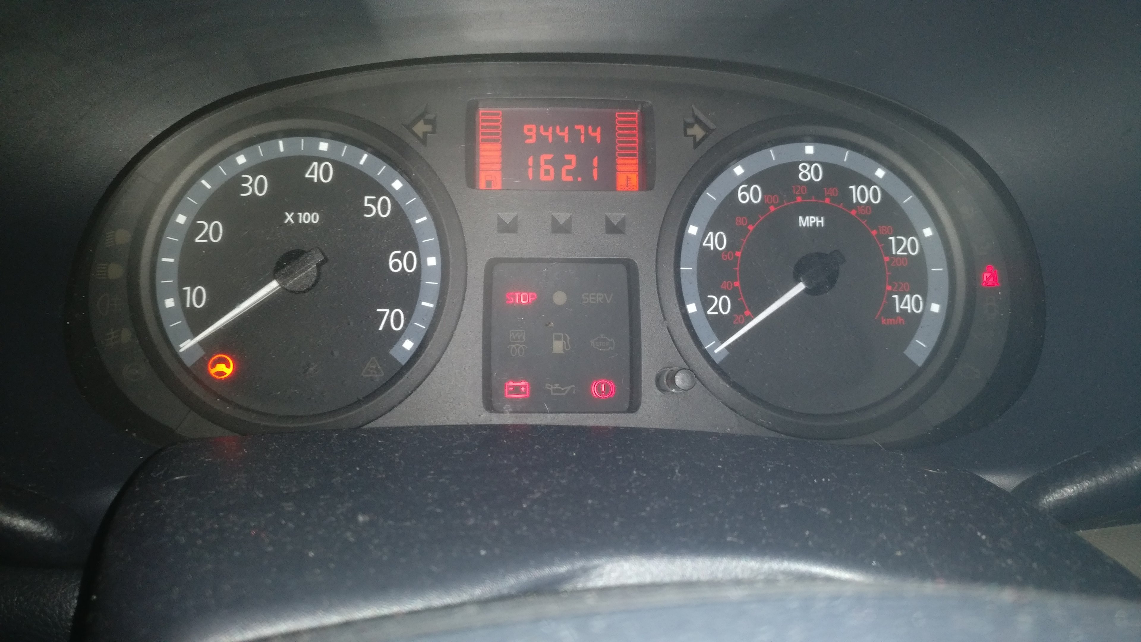

I've had the Stop and battery warning lights illuminate when turning the ignition on consistently since I first took it for a run on the motorway. The car was sat on a driveway for 6 months before I bought it and only did short trips before then.

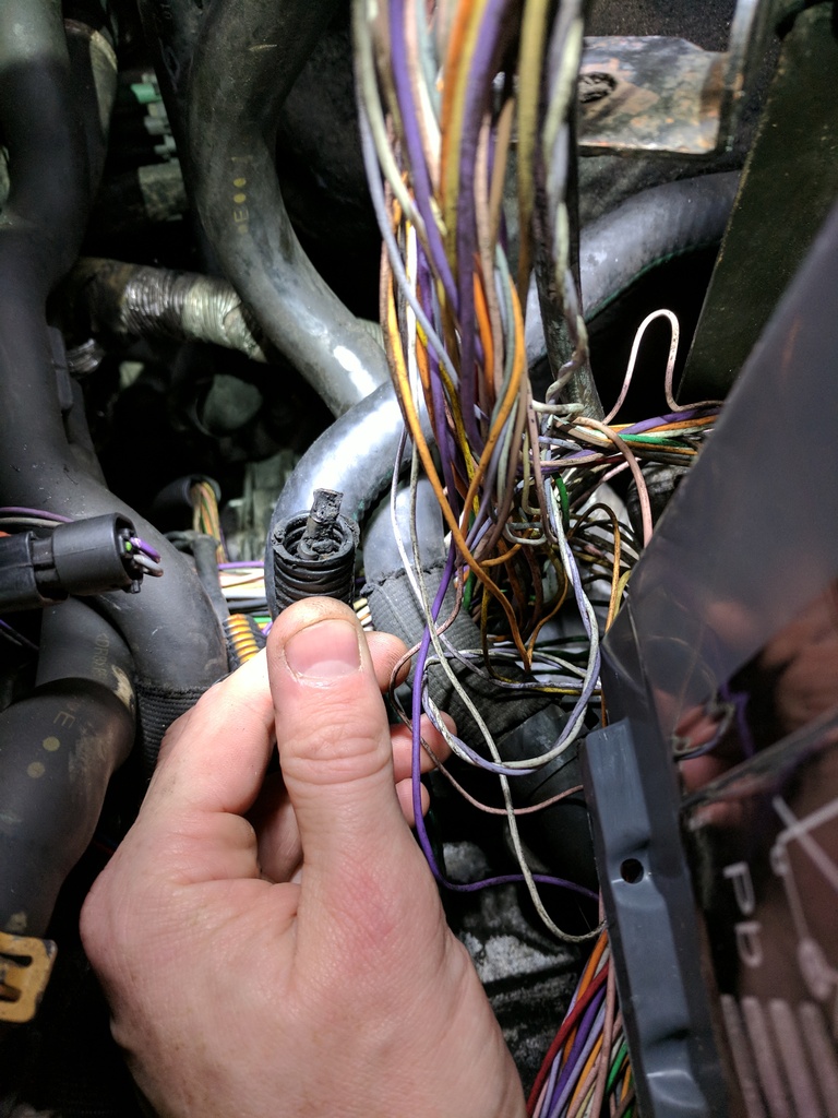

Instrument loom earth on back of the box connected?

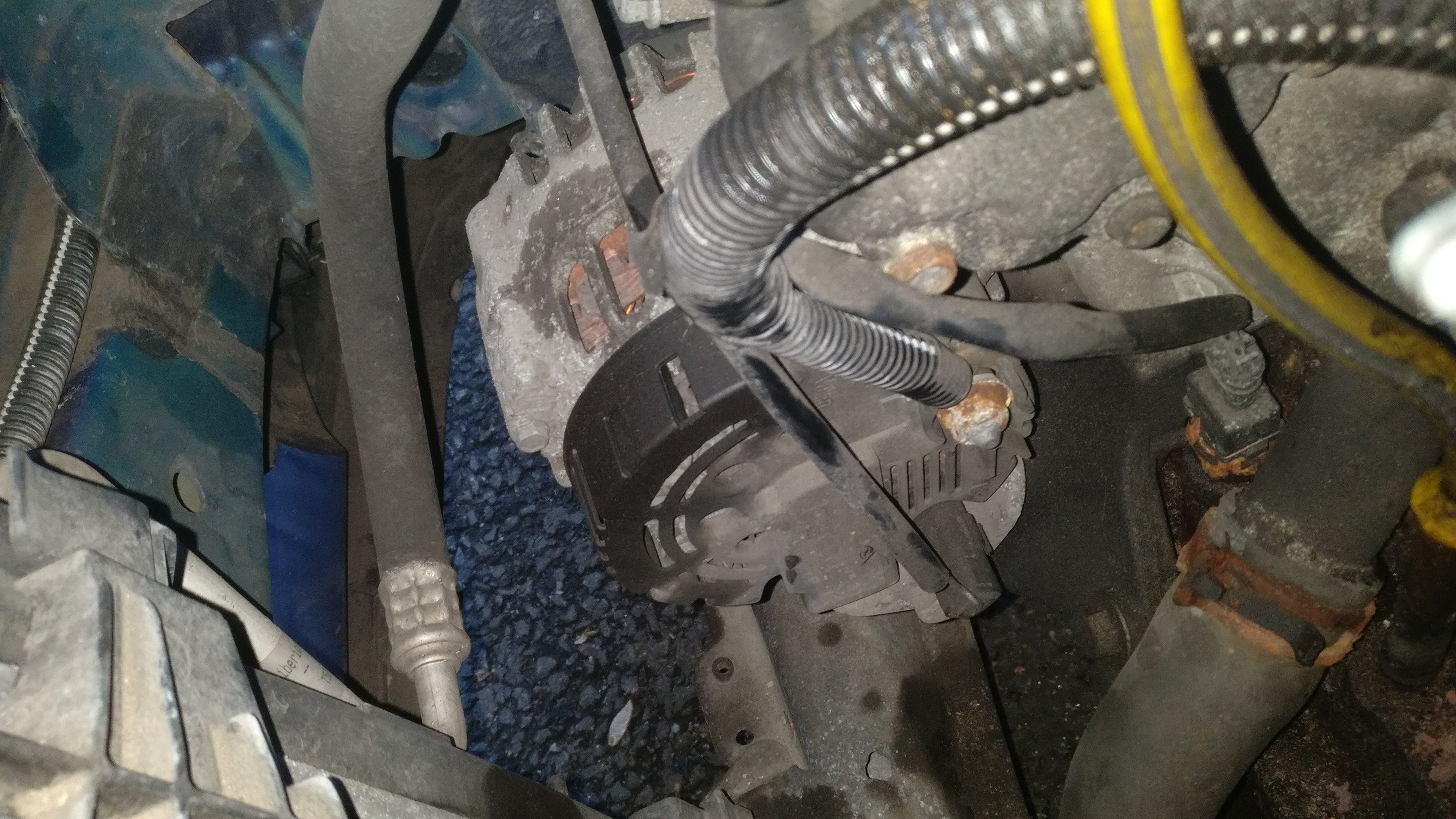

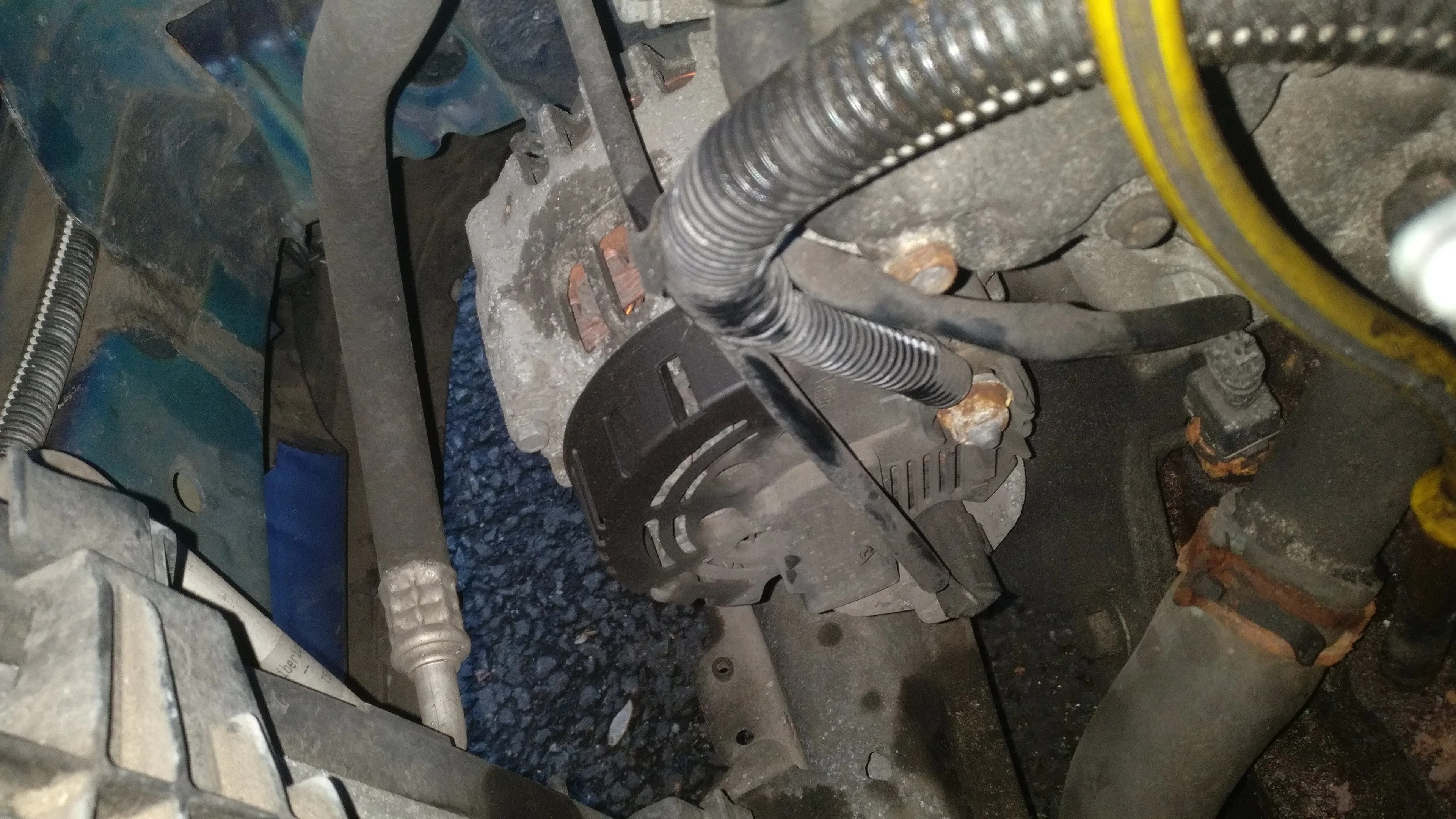

I couldn't see any broken connections from a visual inspection but the connections onto the alternator look rather rusty.
The alternator belt has about 10mm of play which I believe to be too much?

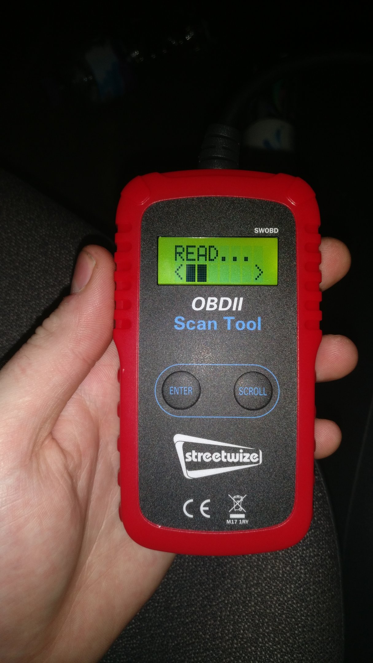

I don't have a code reader so no I don't know what faults are logging. Can you recommend a code reader to buy? I bought this car for £350 so one on the budget side would be appreciated if possible.

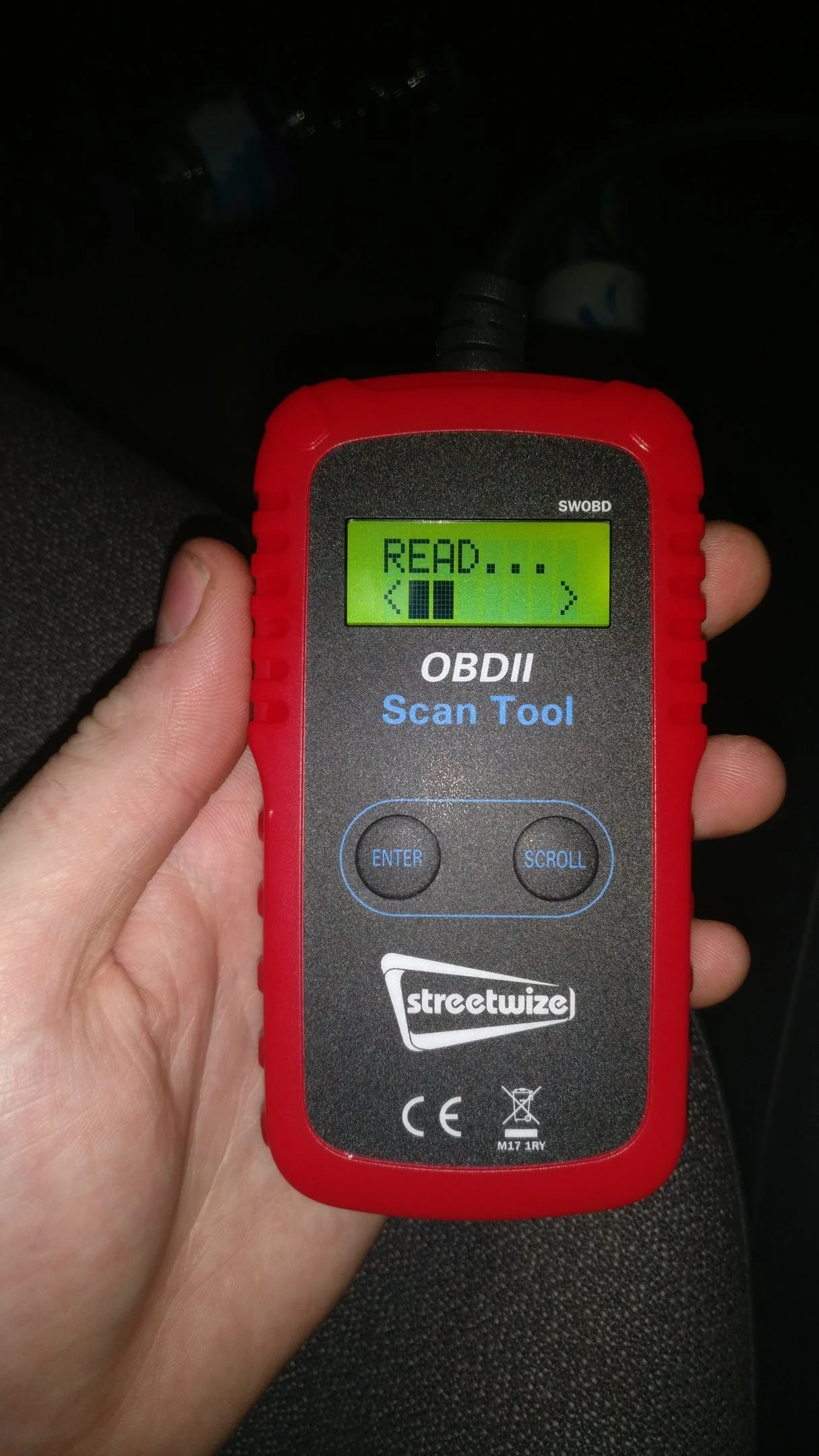

I went out and bought a code reader, it seems to identify the CAN protocol but then gets stuck during the reading process. It doesn't progress any further than this. Does anyone know what this means?

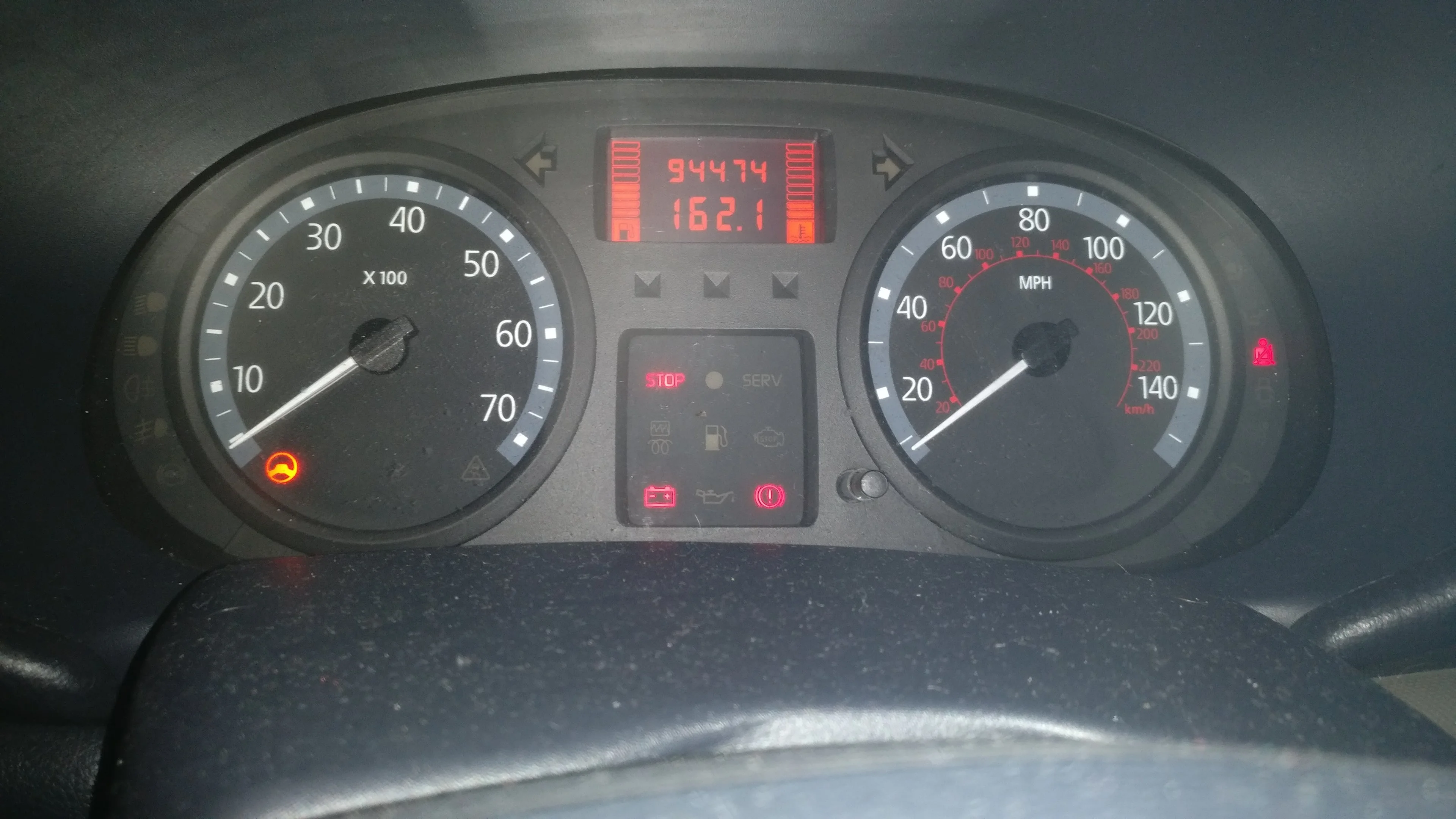

I've also attached a pic of the dashboard when the ignition is on.

So i cleaned up the code reader connector on the car with contact cleaner and actually got a reading. No errors!
The car still is rough when pulling off when the heaters/lights are on though, does anyone have any ideas?
