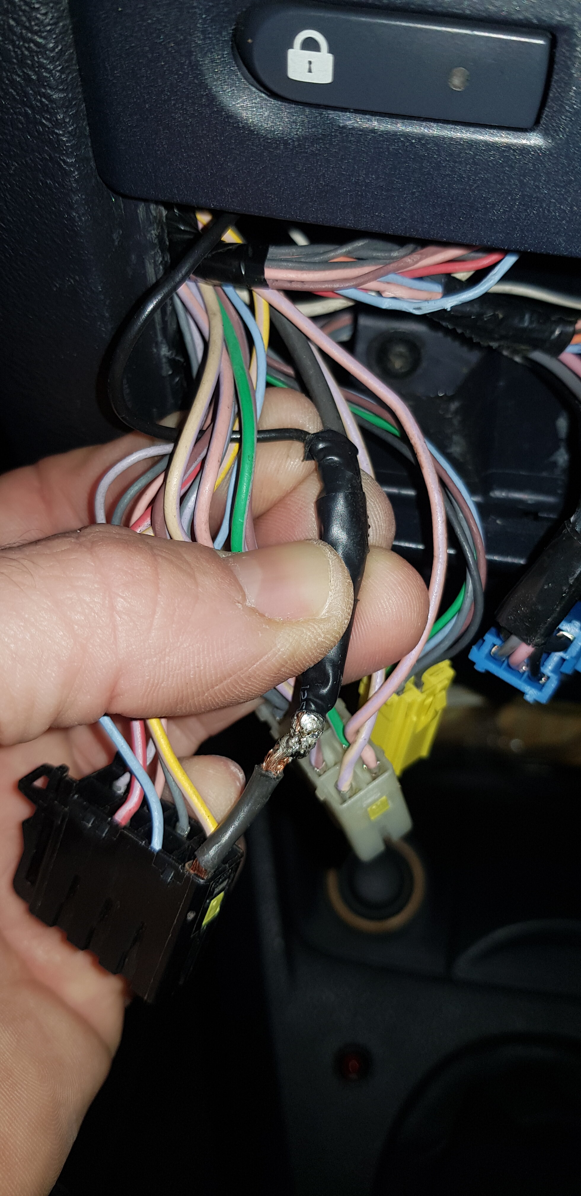

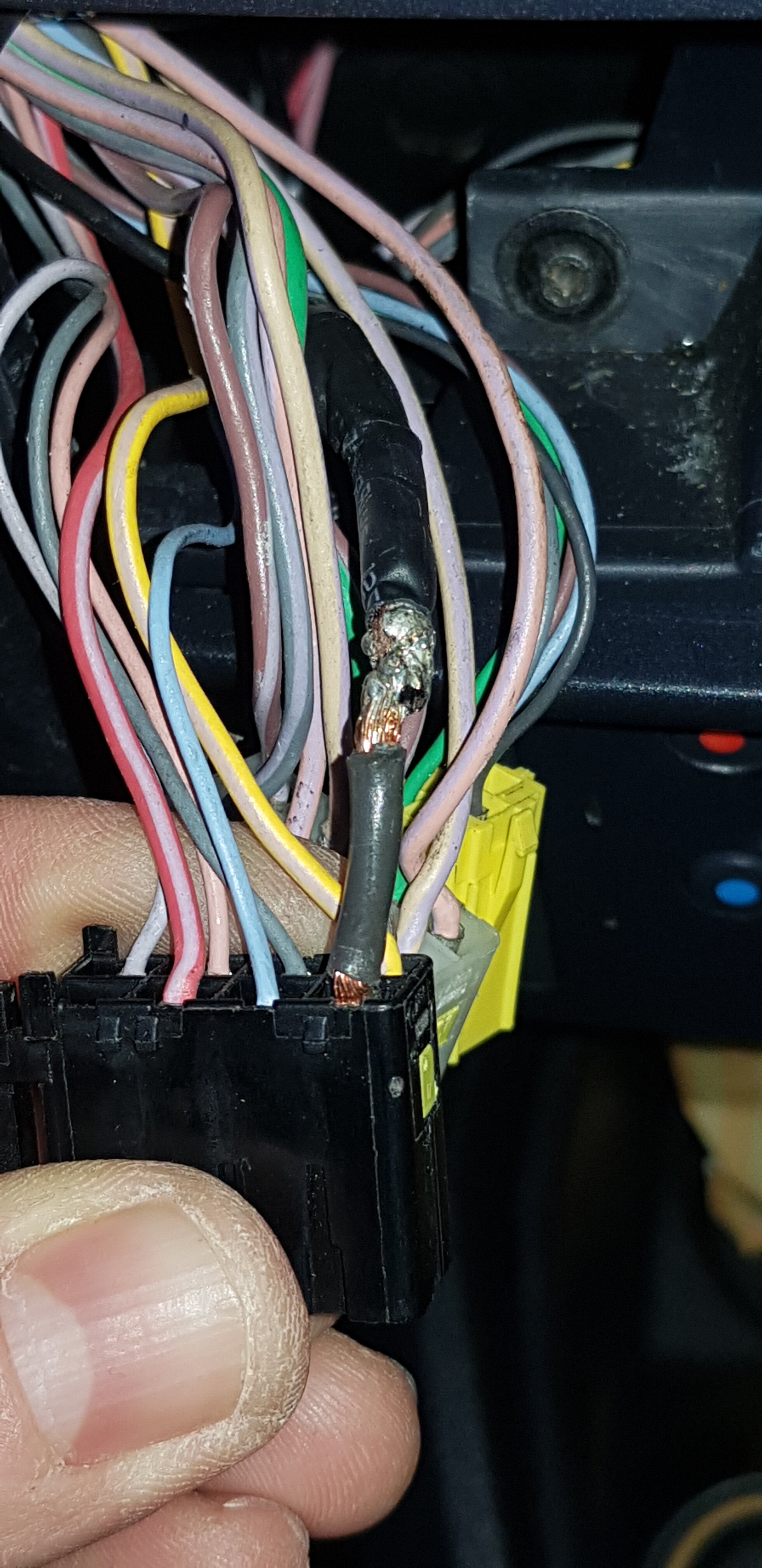

Sorry to bore you all with this, I've got a stinking cold so not in the best mood to be trying to trace the problem but I have discovered this mess on the radio (power in cable I think)
I removed the radio entirely but still get 80milliamps being drawn unless I pull the fuse mentioned above.
Disconnected both wing mirrors which had no effect.
Boot light is going out.
Pretty poor bit of soldering, what is the thin black wire that has been spliced in? Could this still be the issue even when not connected to the radio?

Would assume its earth. Confirm by buzzing from wire to body (door strap or something) with multimeter

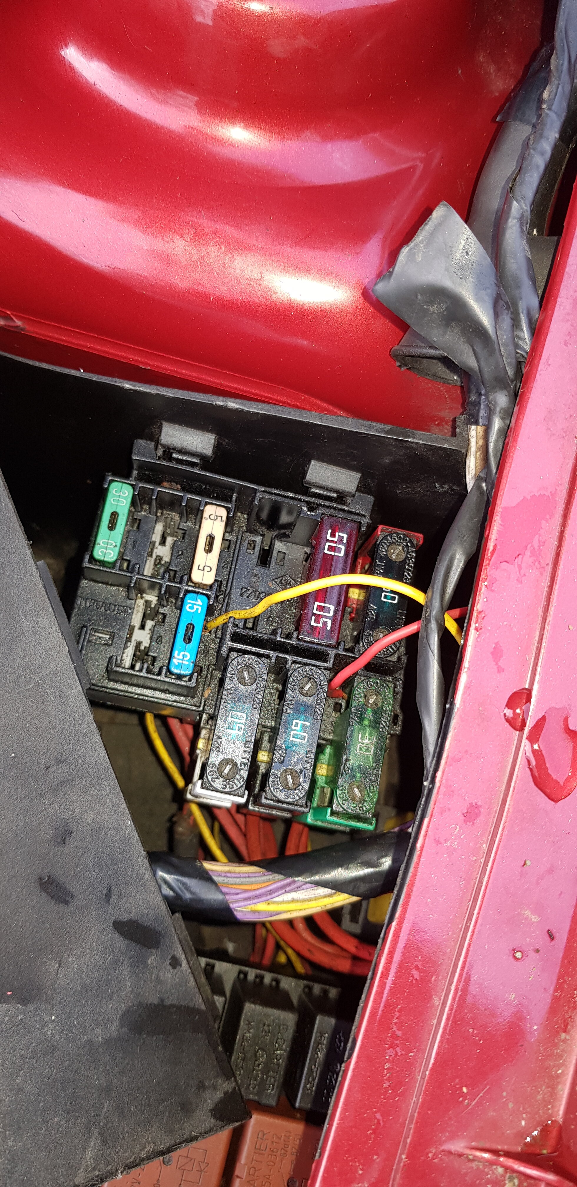

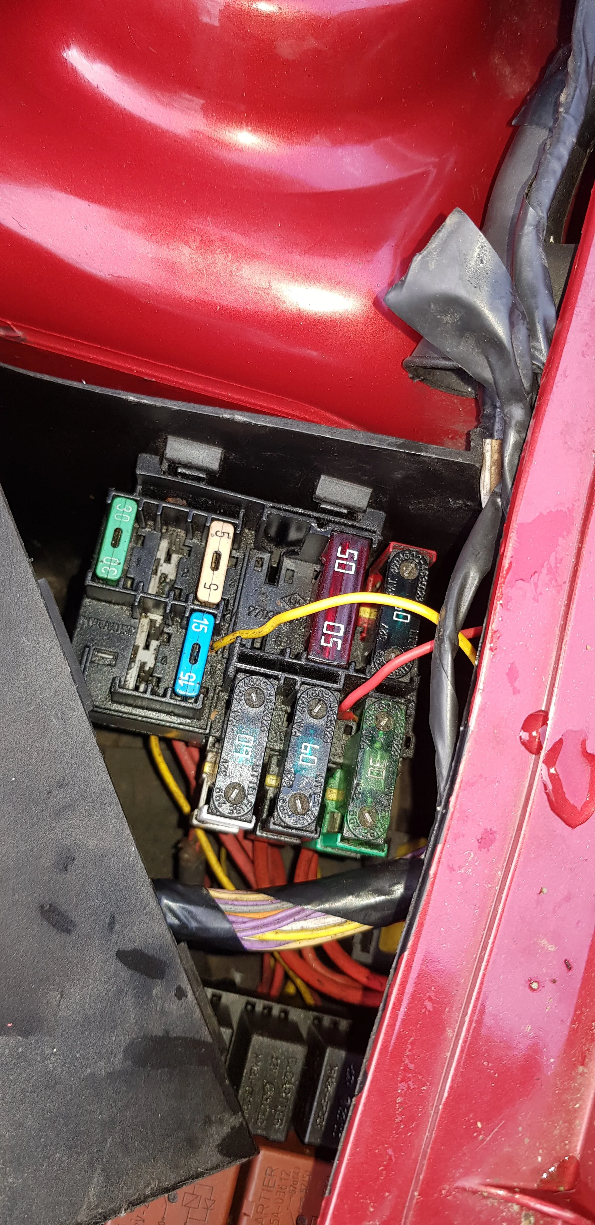

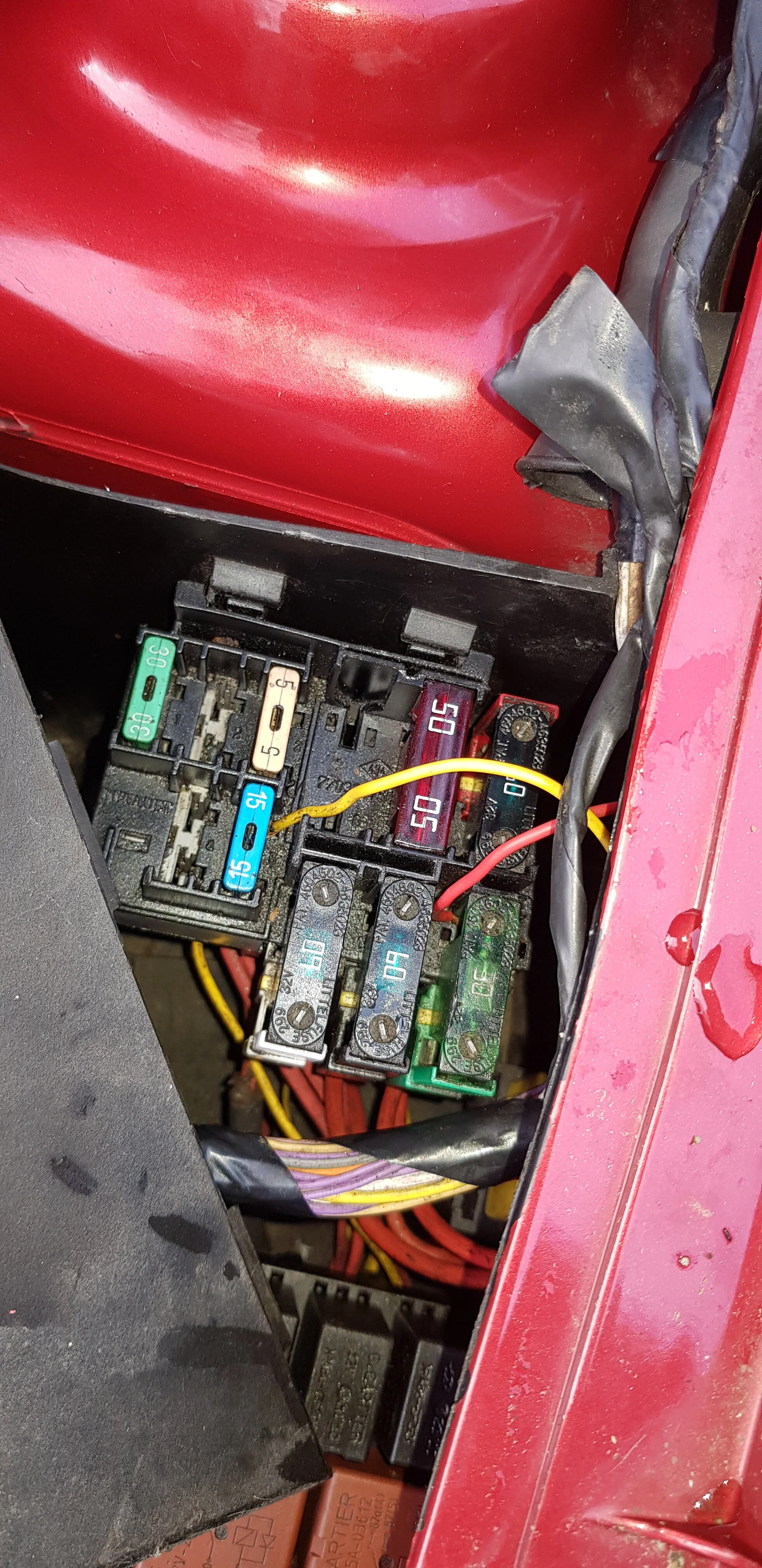

I'll try tomorrow, Ive at least narrowed it down a bit. One other thing that's dodgy is that there are two wires entering the engine bay fuse box and are then trapped under two separate fuses, proper bodge. I might try removing them to see what happens, I'll get a pic tomorrow
It was the earth but barely connected so I've sorted that and cleaned up every fuse in the engine bay fuse box as some were a but furry. I've attached a photo of the two wire trapped under the fuses that disappear through the bulkhead, not sure what that's about.

Those wires would have been the first thing to disconnect to see if it was causing an issue .

I unplugged the mirrors on both sides which made no difference, I've not disconnected the wires under the fuses as I'm not sure what they are for. Would be interesting to know but the disappear and I cant trace them.

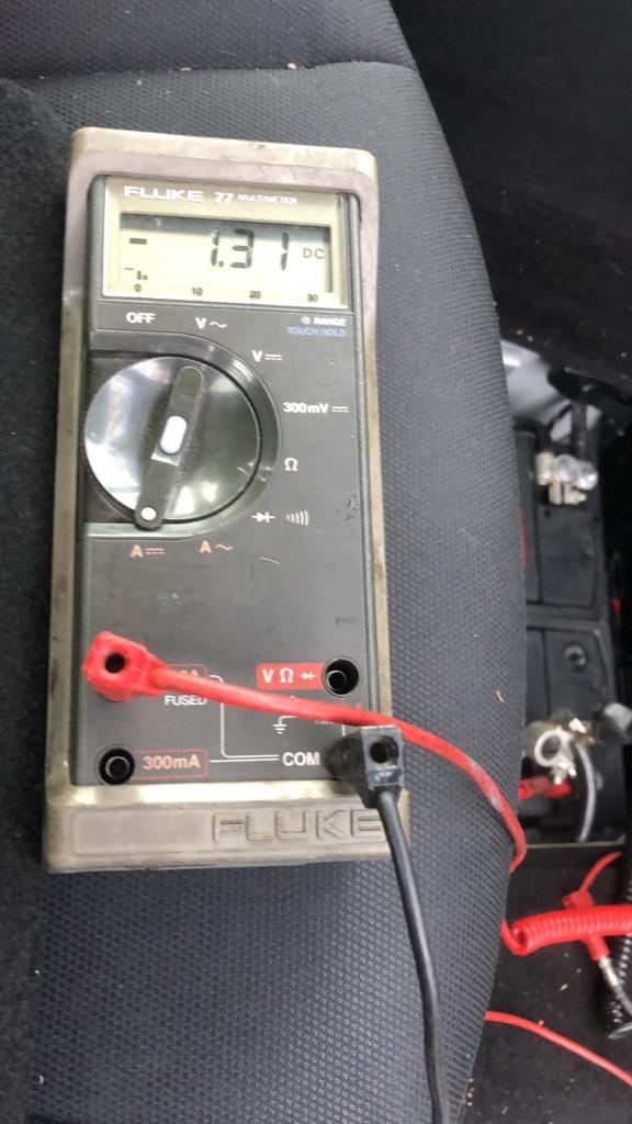

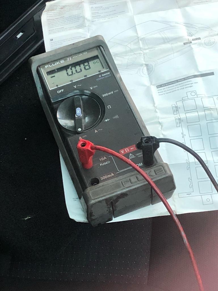

Here’s the Mrs car minimum, it’s a merc , as much as I’d like 00.3mA it isn’t coming down.
Here’s the cause
Yea, thats substantial, perhaps wire up a neat switch to the connects2 if you want to keep it but not have it flatten your battery etc.
Good work. 14mA is like 60 days on a slightly tired battery (20Ah), which is inline with the self discharge rate of the battery and so negligible.

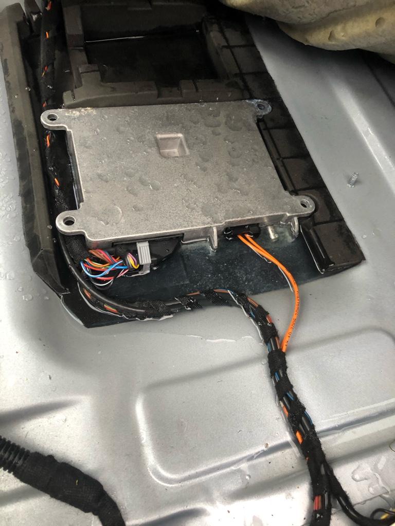

Is that an SL or SLK? I think they have quite a rep for filling their boots up with water

Any thoughts on what the yellow and red wires under the fuses are?
An utterly shonky bodge... if it's for your connects2 thing, I'd guess lives (ignition and permanent) ?
What fuses are they bodged into...
No I've got the connects2 into the back of the original radio.
That's under a 60 amp and a 15 I think the small blue is

It doesn’t matter where the power comes from at this stage , you can remedy that later , the main issue is , is what ever it’s powering is that the cause of the drain . It’s needs to be ruled out .

I suppose if I pull them out its only a case that something wont work, however I'm absolutely certain it was the connects2 causing the drain, I just dont like the untidyness/bodge of it. Probably a badly executed previous aftermarket radio or amp install

Trace the wires ,do they disappear into the car or under the scuttle ?

I'll have a better look tomorrow but they are wrapped in insulation tape and wrapped together with the two black bonnet switch cables. Looks to go under the screen wash bottle which makes me think it may be alarm related.
Maybe they're going that way to access the rubber grommet which enters the cabin?
So the red and yellow wires bodged under the fuses are indeed the Cobra alarm power feeds, I've removed them and the alarm led by the gearstick no longer illuminates.
Next question is where should they really be spliced into as I want them tidied up, done a fair amount of Googling but cant find an answer yet.

Probably not the answer or daft thought but any chance the wires are in the correct place but have snapped off the fuse base. then maybe bodged back over the top and pinned with the fuse.

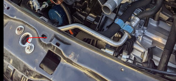

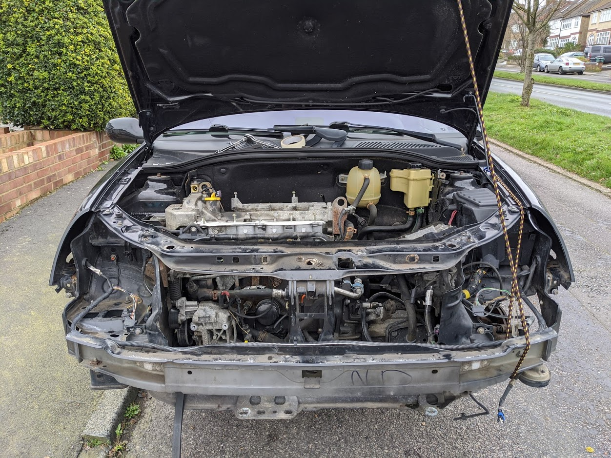

Seriously though, theres recoil on the release lever but not much. I think the bonnet pin is misaligned in the mechanism, tried a wire looped round it to tug it but no joy. I cant quite see how getting the bumper off is either possible or going to get me access
Wonder if with the bumper off you will be able to get a bent wire (coat hangar or something) around the latch from below to pull it free of the bonnet pin, would imagine with rad in it will be tights as.
Before using a can opener I would push down on the bonnet and lever the front edge (taped up screw driver pocked between passenger wing and bonnet edge near to head light) over to the left (drivers side) then get her to pull the lever.
