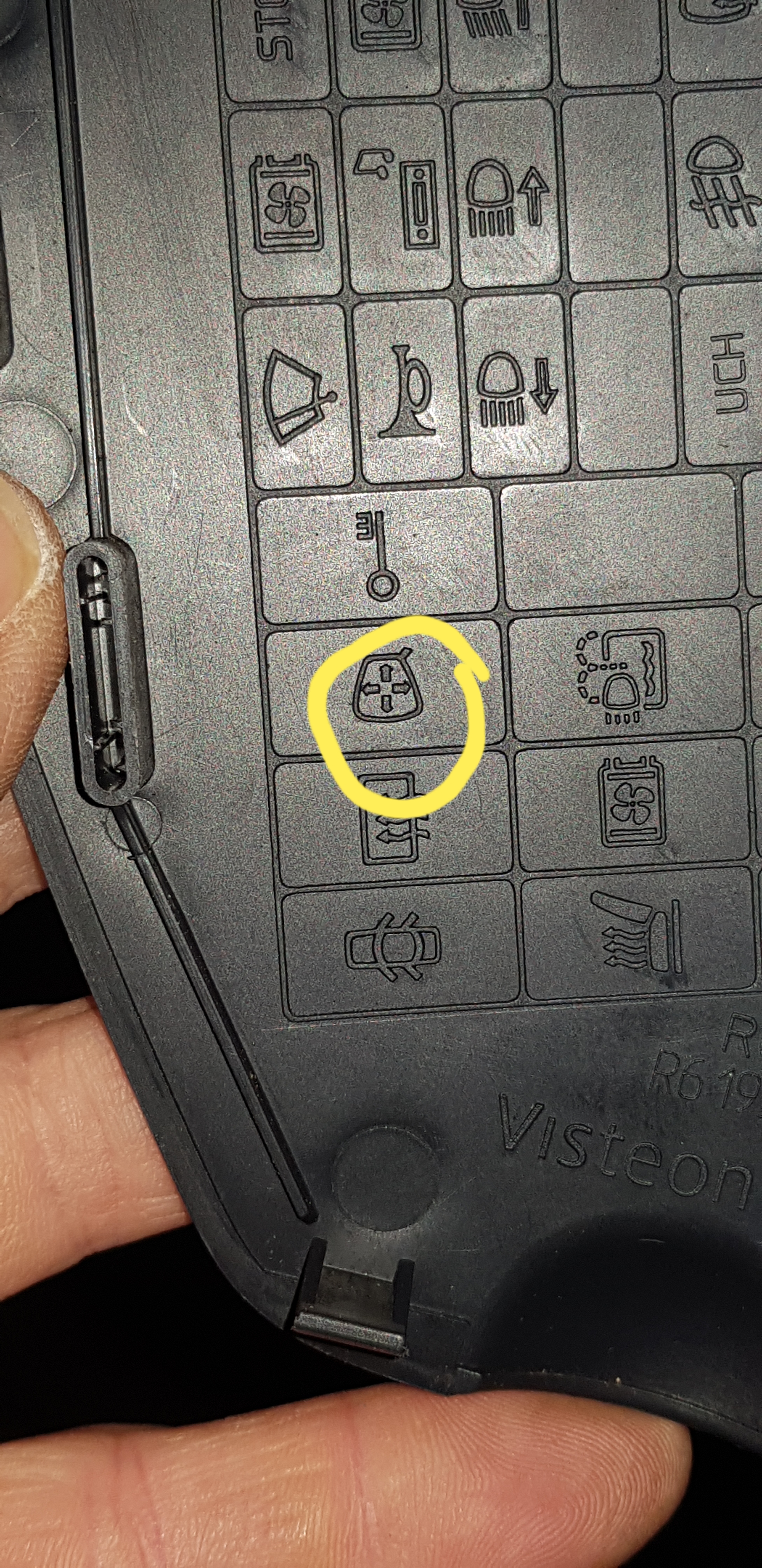

Today seemed like a good day to stand out in the cold testing the parasitic drain, so I connected my multimeter inline with the battery before opening the passenger door, heres what I found.
The fuse on the mA setting has blown so used Amps and straight away I was getting 0.08Amps (80 milliamps? )
Opened the passenger door and this went up to in the region of 0.12A so I clamped the door interior light switch assuming when iyhe light faded down the Amps would follow drop back to 0.08A but they didnt?
At this point I began pulling fuses, all fine except this fuse which I think is related to the interior lights or alarm sensors? This brought it down to 0.011Amps.

120mA is still low, higher than you would like but still not a huge deal in the scheme of things.
to put this into perspective. If you had a 1Ah battery, it would be able to supply 120mA for 8.3 hours.... You likely have something like a 40Ah battery so with 120mA drain your at 300+ hours.

Definitely something up with something running off that fuse

Is it maybe a case of the power taking a while to shut down on that circuit? Modern cars can be like that.
Like on my 182 I noticed I can still open the windows if I press the switch just after I've turned the key off.

Yes could well be. Could also be the part of the keep alive cct. with the radio or alarm has failed (often an old capacitor etc). You could try unplugging the radio to see if it falls.
