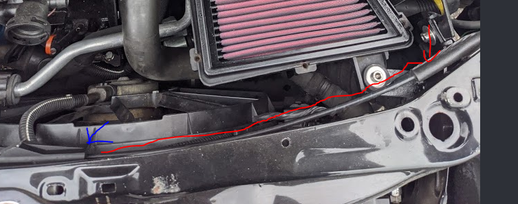

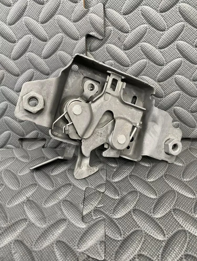

Getting somewhere now, the cable is snapped so in fading light I've got the bumper off leaving the grille behind so I have better access to the release mechanism. Any idea which bit I need to lever as I have very limited access and view. Just a photo of the mechanism would do.

Too one looks like a mk2 to me, opening it should be easy now cheers! Hopefully RPD have a cable otherwise theres one on Ebay
So red is the cable, blue is where it goes into the catch. You might be able to cut the outer and yank on whats left of the cable through the grill assuming is hasn't broken right at the catch (which obviously it has because why would it do anything helpful).
Did you try levering the bonnet over while simultaneously pushing down on it and pulling the lever?
I think I can get a screwdriver or something thin through from the front to lever the...lever over.
Trouble is the lower slam panel support (the vertical one) loosk mighty in the way. You can unbolt it from the bottom (crash bar 2 x 13mm) that might let you wobble the slam panel about enough to unjam it..... Alternatively might be time to begin the hunt for a nice bonnet..... I think after two days I would have lost my rag by now.
No chance you can squeeze a spanner onto the top catch bolts?
Alternatively if you can see the bottom of the catch I would be pounding seven sorts of s**t out of the rivet below to break the mech:

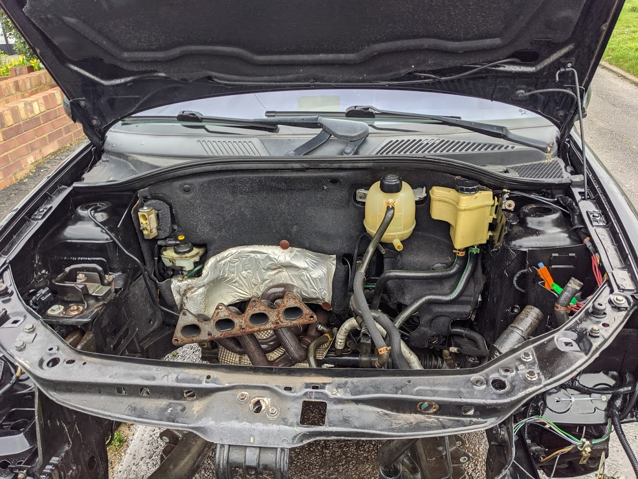

I can get in between the two parts of the slam panel as in pic, then lever over like in 2nd, I hope!
