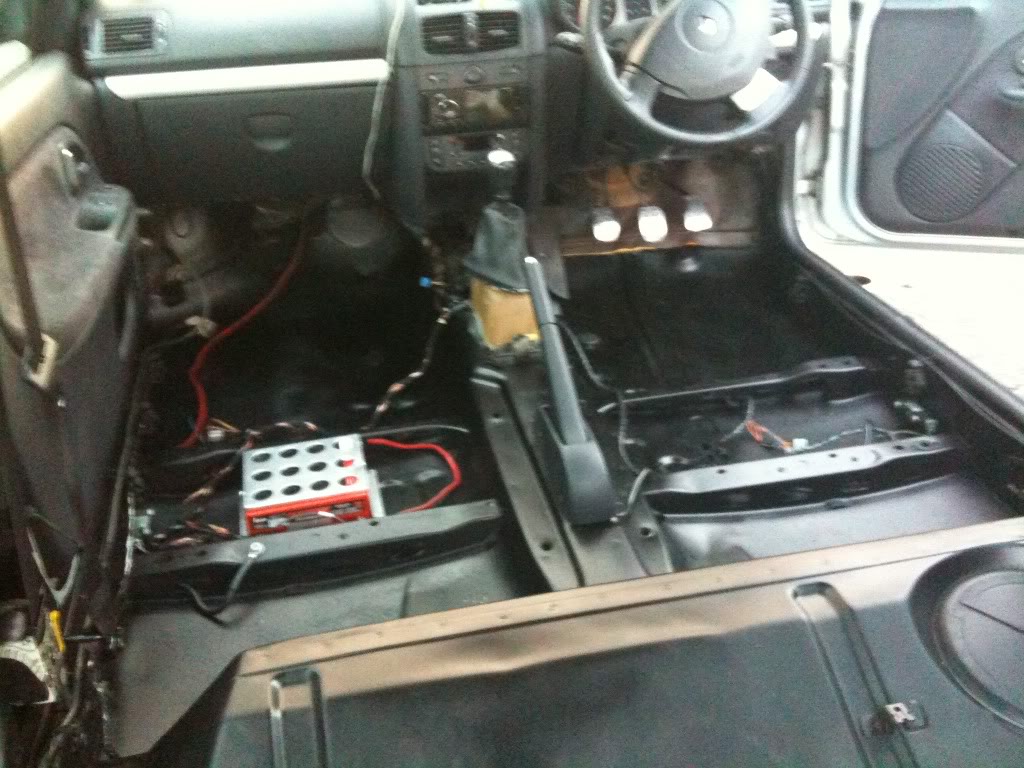

Can see mine here,

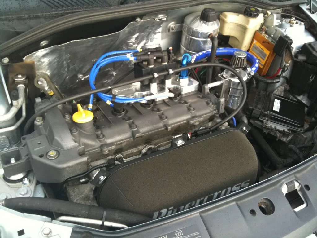

And can just make out the junction box near the standalone ecu

Thats the sort f thing I was hoping to do. Bit of a dumb question, but If i'm earthing the battery to the floor under the seat why would I need 3-4 meters of Black cable? :S
I ended up with to much, so yeh, that was a mistake :o
Got some left in the garage, and the eyelets to, i bought to much :)
Edit, you can see how long the earth need to be, about 40 cm's
